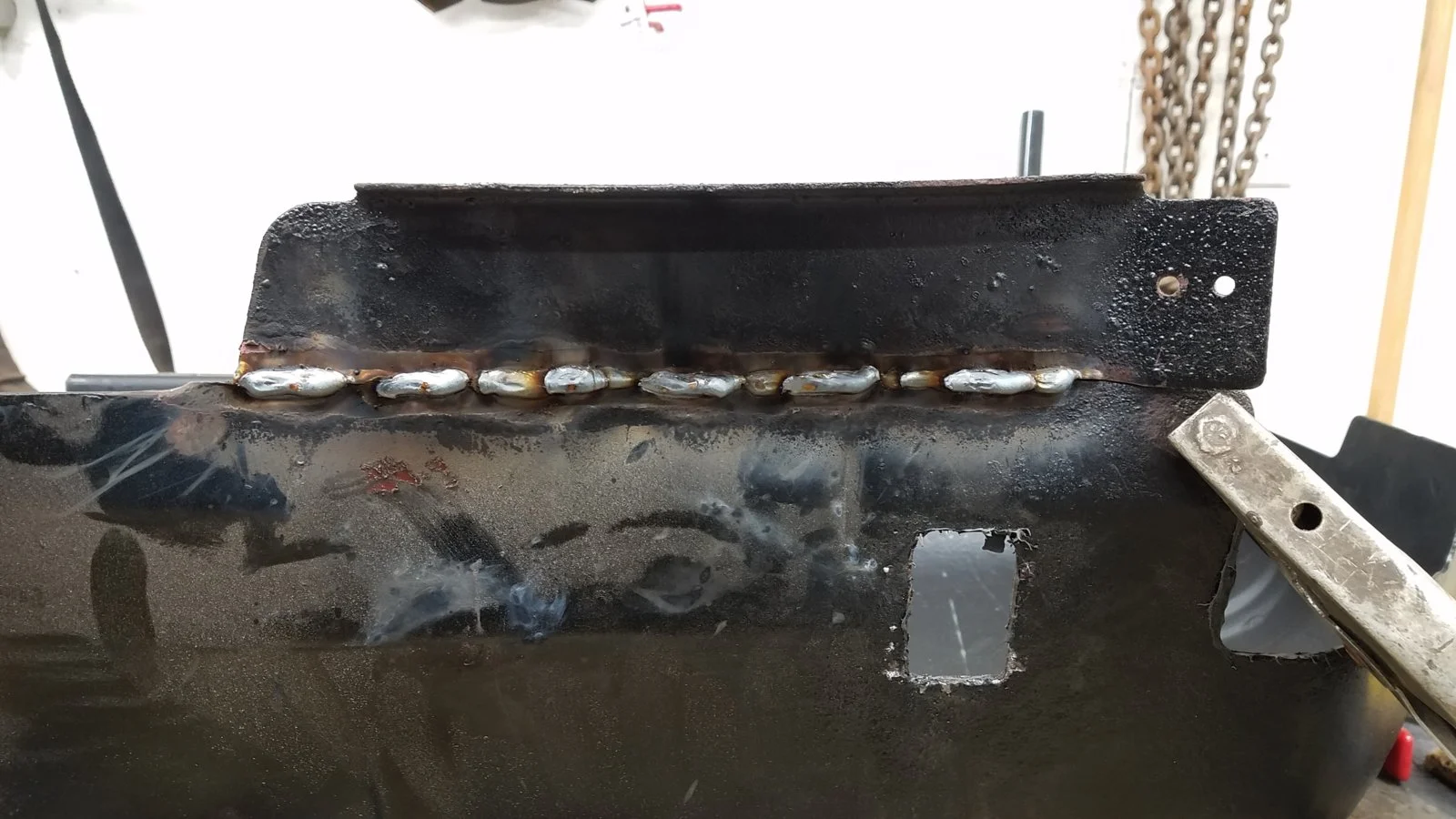

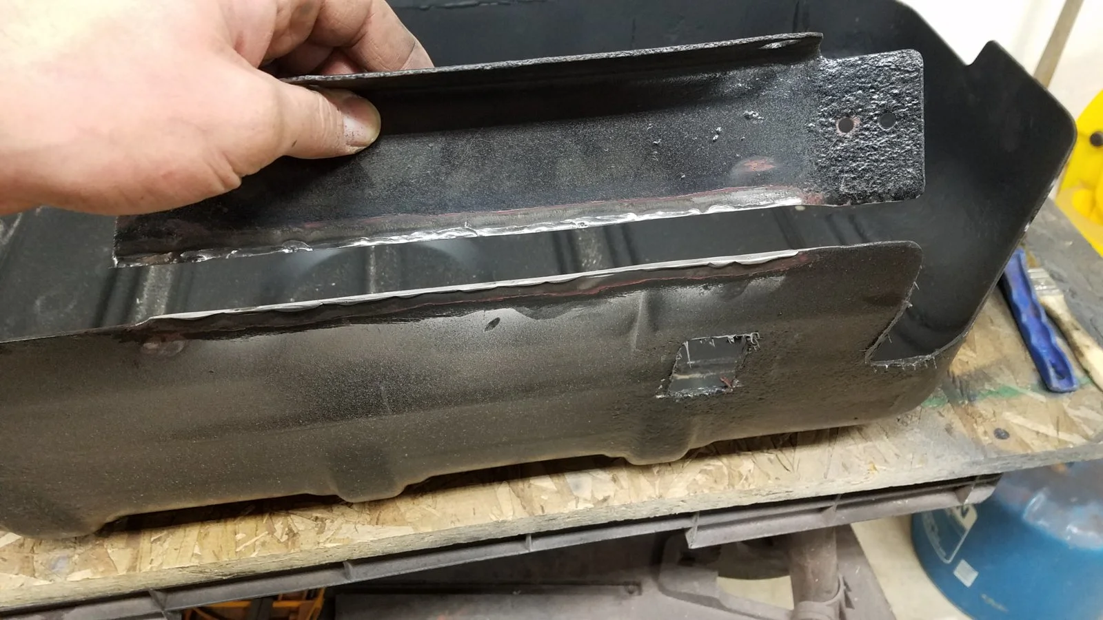

Welded that flange in the wrong spot. The section I cut out had an angle on it, but I thought it was straight. I lined it up as such, so the bolt holes were a half inch off. Had to cut it back off and reweld it.
Got it back together tonight though. This time, I tacked it together and put it in the Jeep to make sure the holes lined up!
Tomorrow, I'll have to clean and repaint the area...

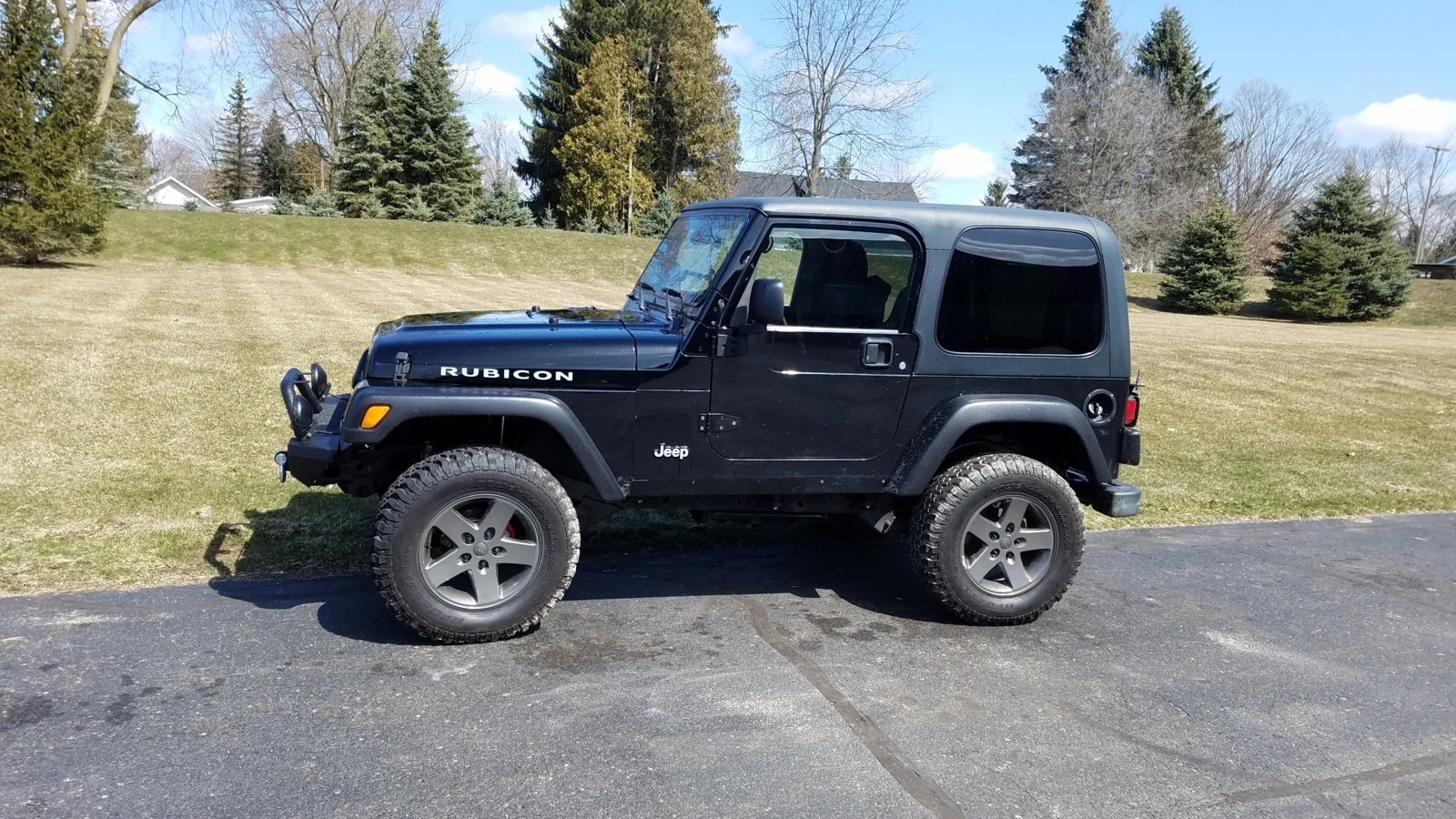

Finished measurements of my lift. Numbers were taken from the ground to the frame, just ahead and behind the LCA mounts. Front is at 18" and rear is 18 1/4" This is with a 3/4" full gas tank too (Yes...I've been wrestling with a 3/4 full tank this whole time).

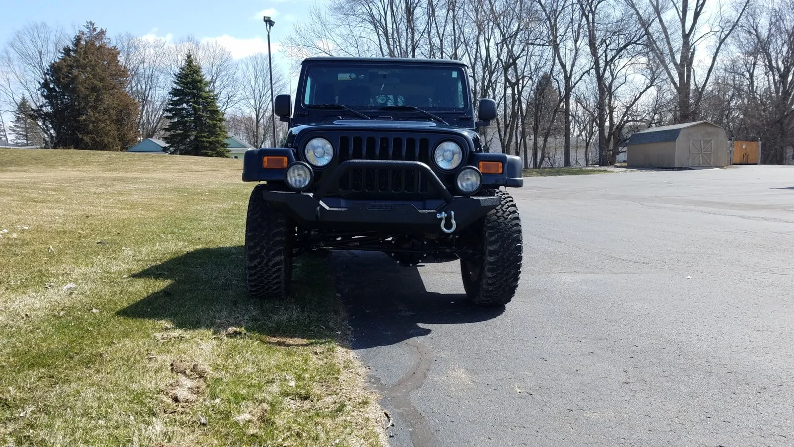

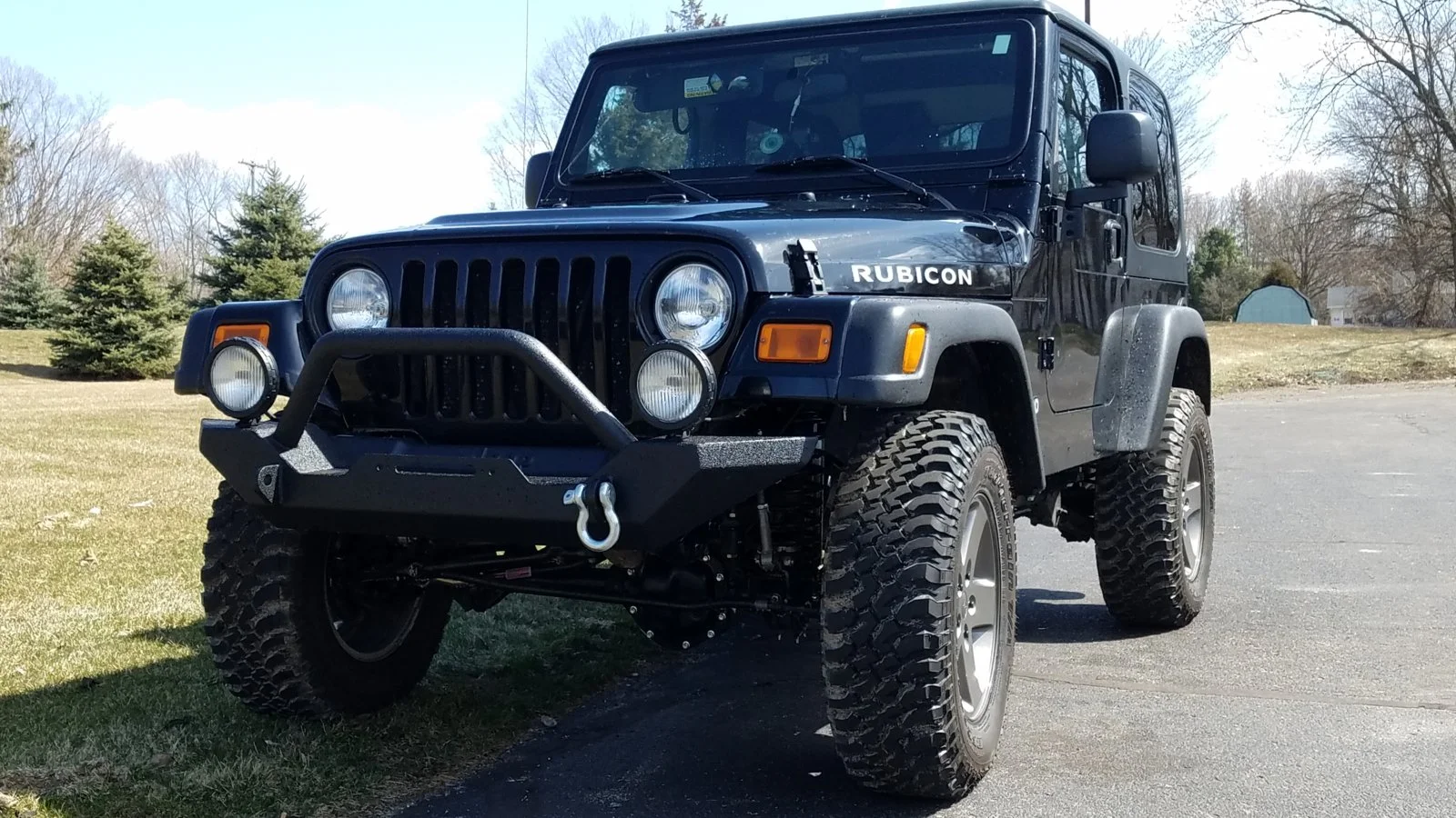

Took her for a quick shake down today around town. Went to an empty lot to check the 4wd... That cable is nice! Burned off whatever was smoking on the down pipes, and washed her. Got up to about 40 and no vibes yet.
I will say there is a bit more body roll now. It will take a little to get used to. The rear doesn't exactly feel like it's moving in concert with the front. I'll take some measurements and make sure my suspension is correct. I did notice some tire rub in a full lock RH turn too, so I'll have to recheck my track bar.
All in all, I'm stoked with the stance. I should have no problems with the tires getting into the fenders, my acceleration is still good, and they are a load range "C" tire. All good things.
I looked for a rock to take a poster shot with, but my town is fresh out!

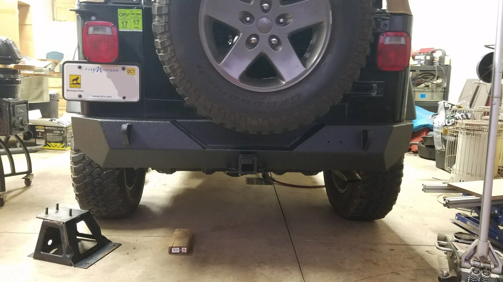

Finally, I got everything installed and back to normal. I love the bumper, and how it hides the body lift from the rear...but it was kind of a giant pain in the ass!
