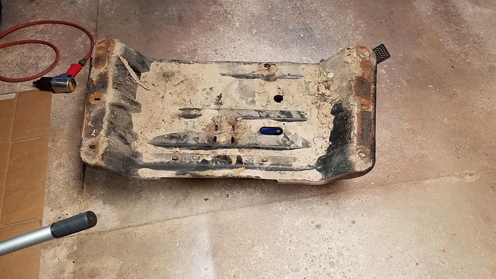

Now I've got a couple of days of cleaning things up...wire wheel the frame and skid plate, give them a fresh coat of paint. Replace the speed nuts and nutserts on the access panel, give the whole area a good scrub. Tired of filling my damn ears full of sand each time I touch something above my head. I gotta start saving for a lift!

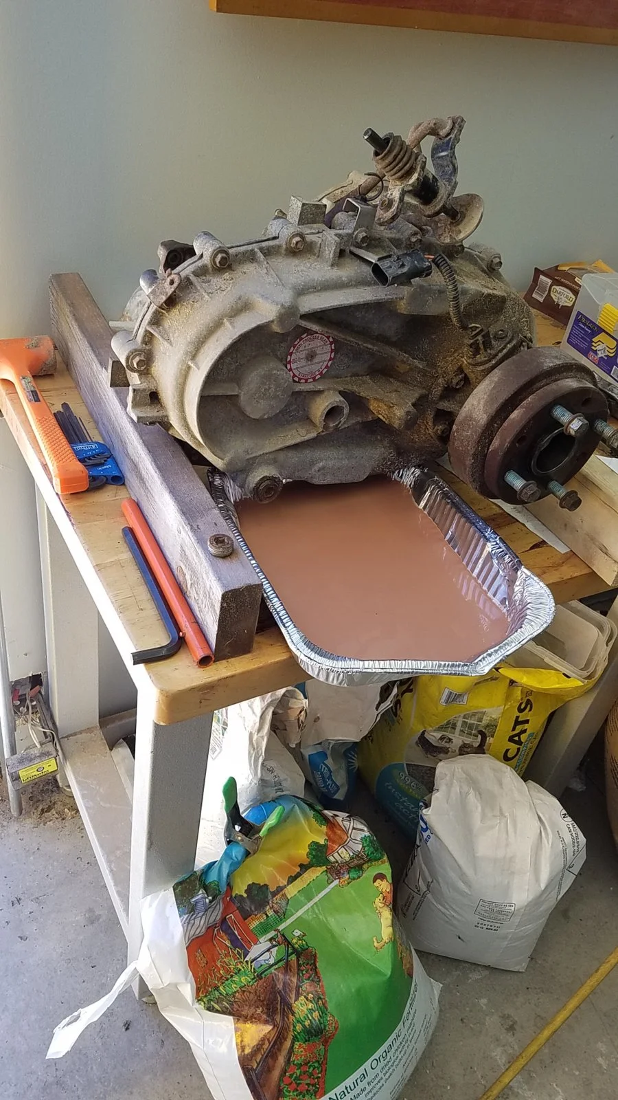

Good news today...with the transfer case out of the vehicle I was able to get it up on a bench and get a good grab on the fill plug. Was able to get it off without extraordinary measures. I did determine that the input shaft seal is leaking, so I'll have to replace that. It let some water in...
