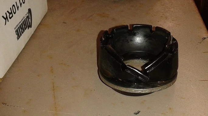

I didn't know that about over-greasing the arms. What is it about over-greasing them that causes that to happen?
Yeah, Maybe not overgreasing, per se, but there is definitely a pressure component to it. Blaine said the material extrudes due to the grease not going where it supposed to, and that he only greases them when he puts them together, and only between the ball and race. No grease in the shell. It might simply be that once they are greased, the fit of the ball to the Poly races is so tight that the grease can't squeeze out easily.

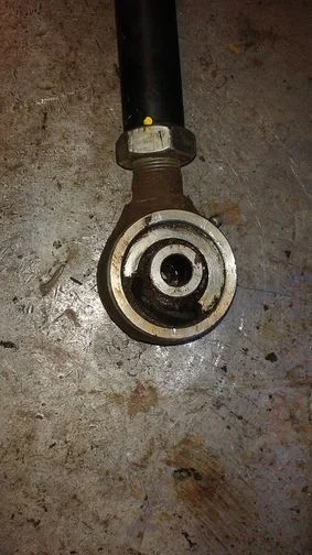

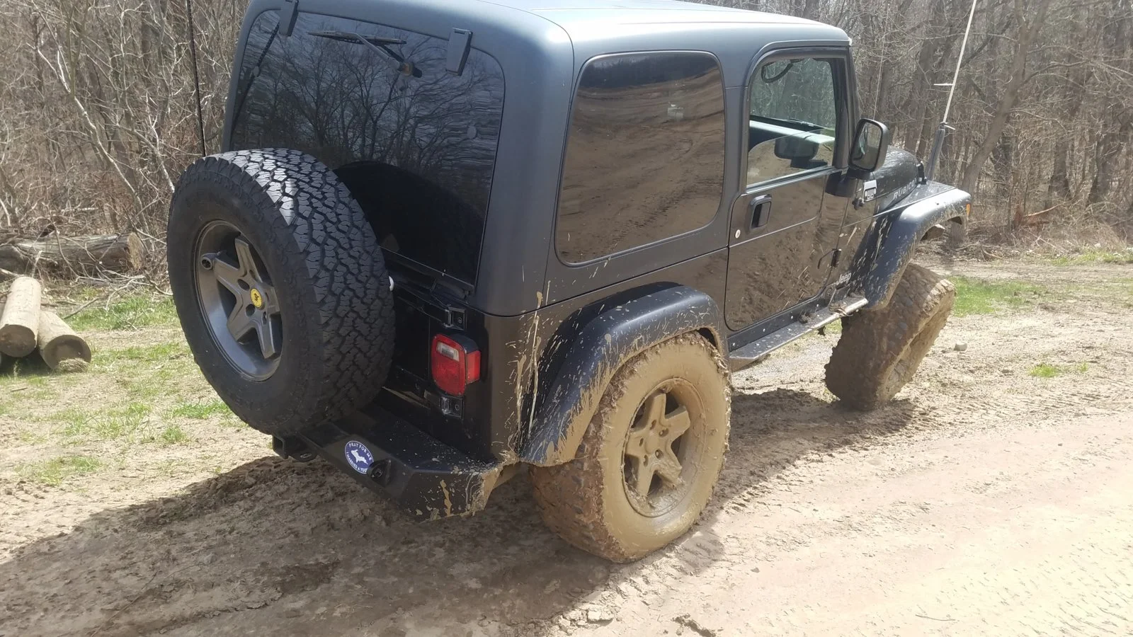

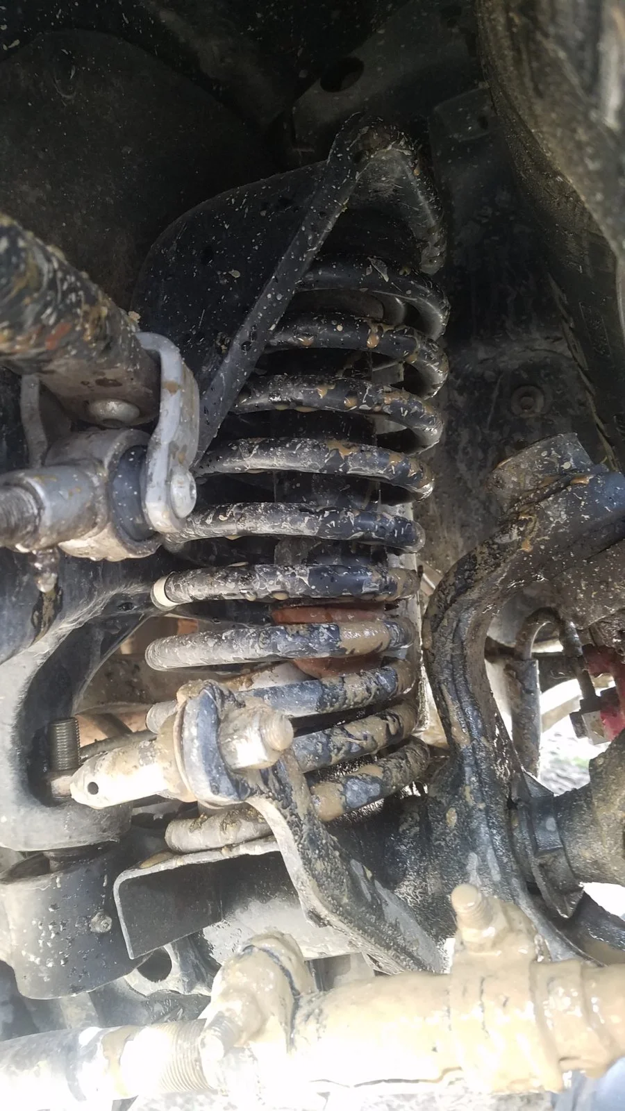

This is what happens when you over grease a JJ. Lesson learned.

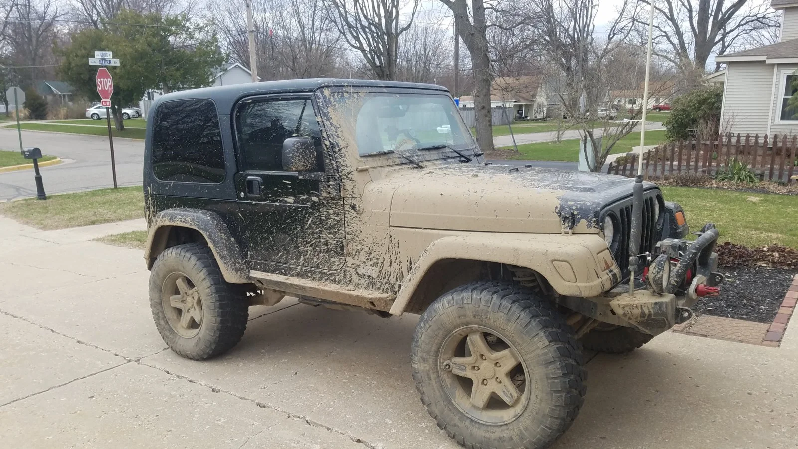

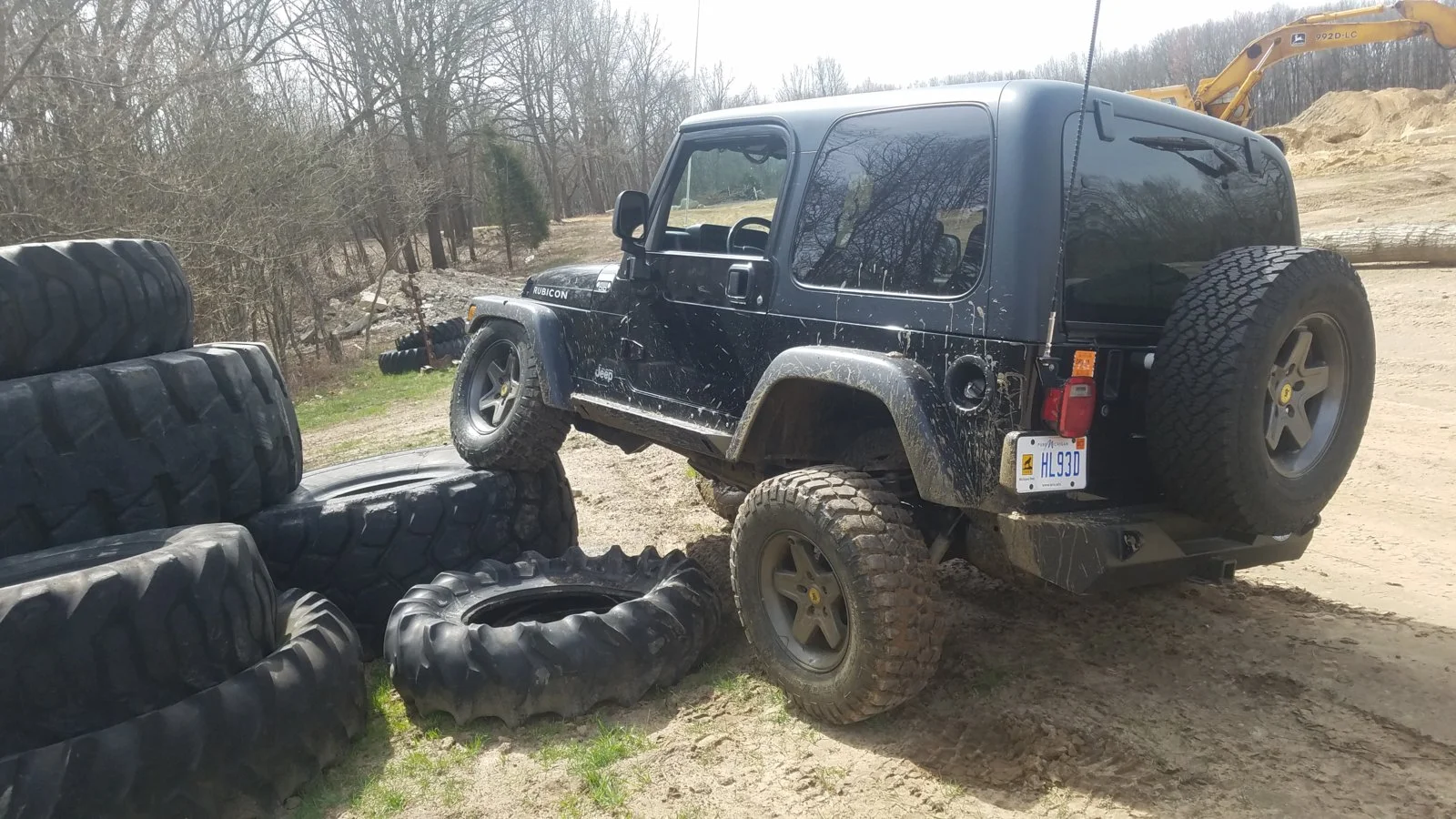

Mud is teh debil!
Until you drove it into the Flat Dark Earth. 😉

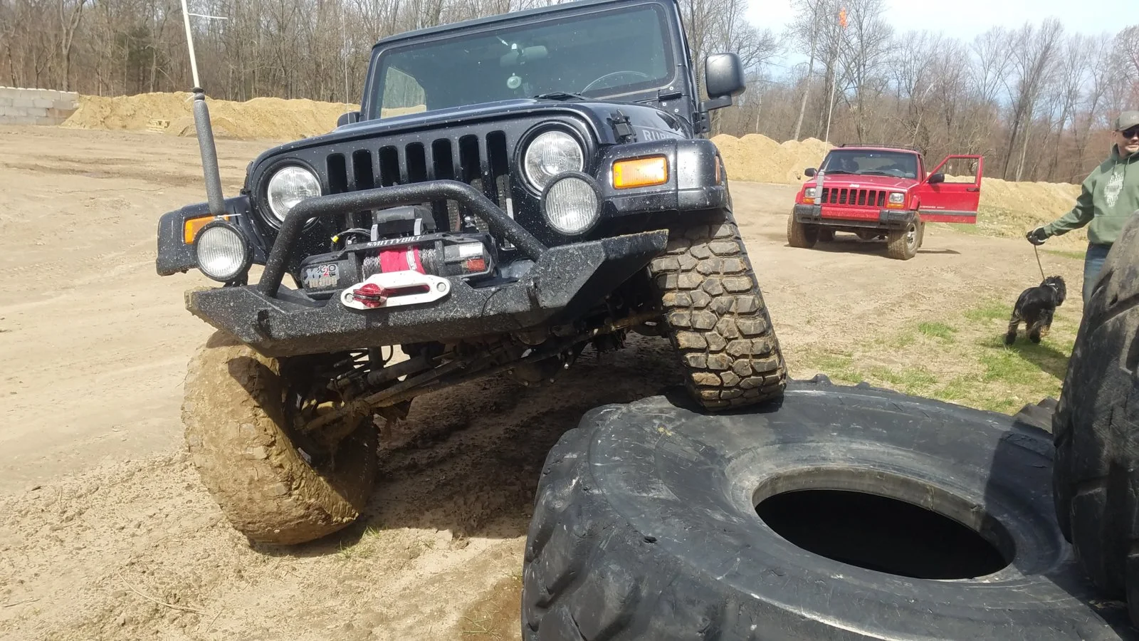

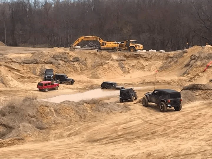

Mine wasn't nearly the worst of it. Traveled out there with my Jeep club. We were there for about 30 minutes and someone was already on the radio...asking for a pull.
About a half hour after that, I popped the cherry on my winch, pulling someone else out of that same hole, but a different spot. He was so stuck in there, that my winch was pulling me toward the hole. I even had someone on the brakes of my rig. Needed that second JK behind me as an anchor!

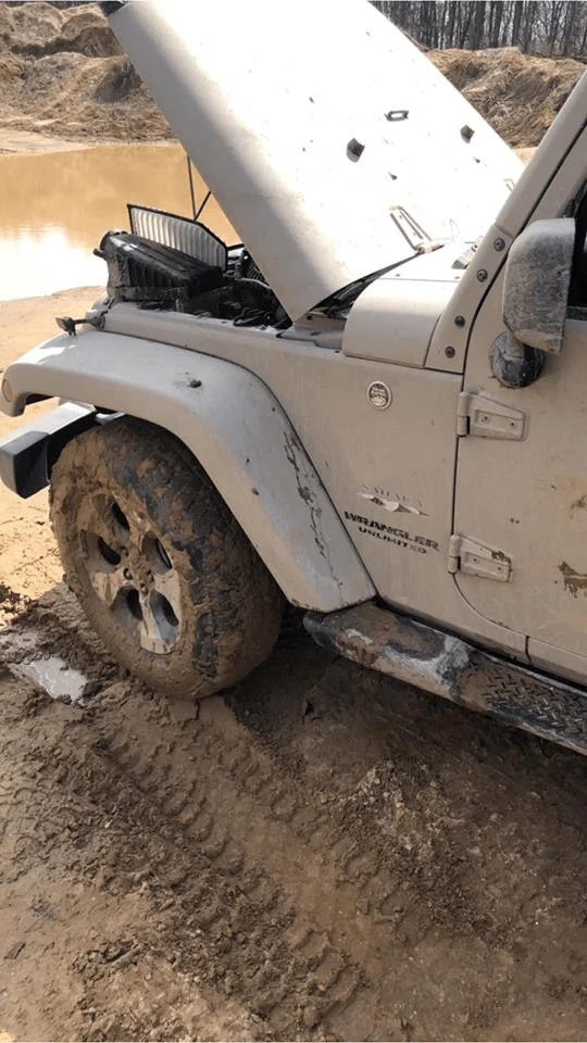

Finally, This poor guy tried too...Looks like its pretty stock.
Posting on FB came about 2.5 hours after we had left (2 hour drive from home) and his jeep wouldn't run anymore. They pulled the plugs, changed the oil. Posted again at about 7 PM, broke down on the side of the road. Feel bad for them. Mud and water is teh debil!
Man, that sucks. I feel bad for him too. Not cool to break down like that. I hope that engine isn’t done. What is it that every guy just has to get into at a site like that? That one mud hole. That is so guy. I’d have been in too.

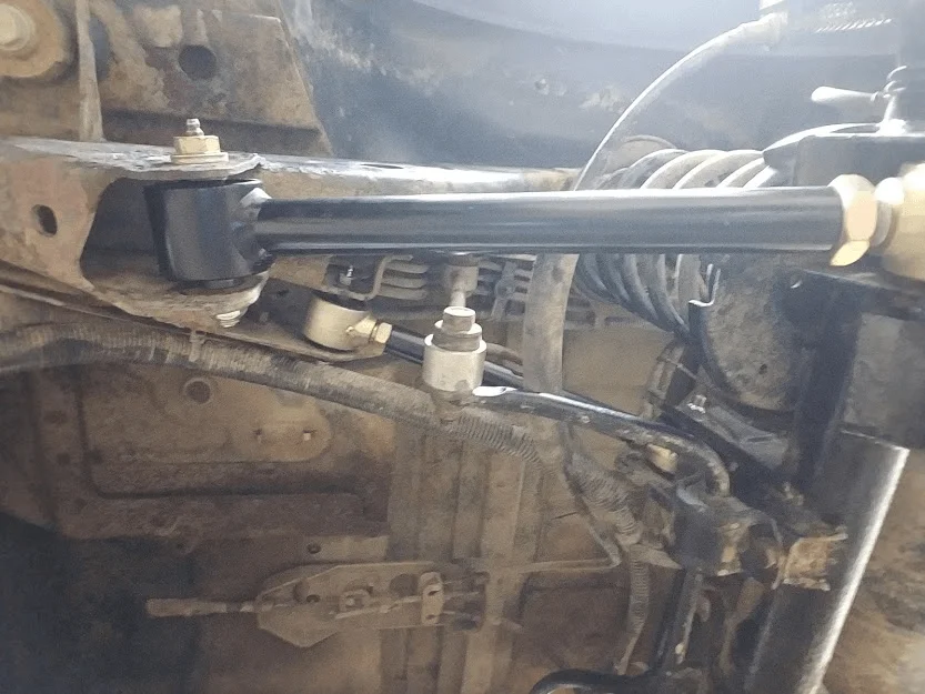

Quick update. I've had my suspension arms installed for a couple weeks now. Wow...What a difference. Everything just feels more "solid" I guess is the best word to use. No noticeable NVH and a definite increase in ride quality. It is kinda boring work, but I do have a few pictures.

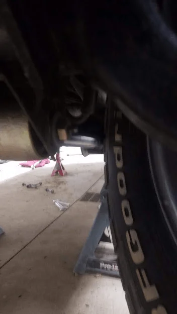

Checking axle position at full bump.

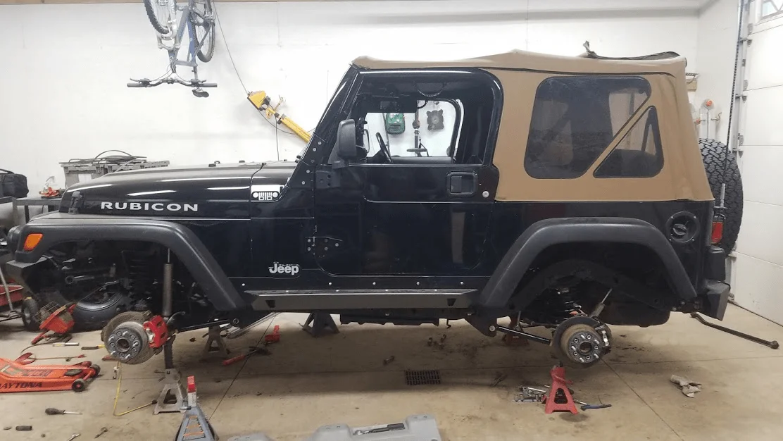

Rear's installed; notice the juxtaposition of the stuff I've rebuilt (axle, control arms) or replaced with the stuff I haven't.

Last wheeling trip, I heard the tire grabbing something. So, I took the opportunity to check my bumps again since I didn't really do it well when I swapped to these tires.
96151

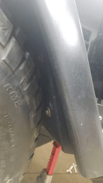

Full lock LH turn is where it gets tight...but it does clear. I think the noise I was hearing was the tires catching the stiffening flange on the factory arm. This will be the area I concentrate on if I do a DIY highline. Its easy to lift the fender up higher than factory....Getting clearance here might be tricky.

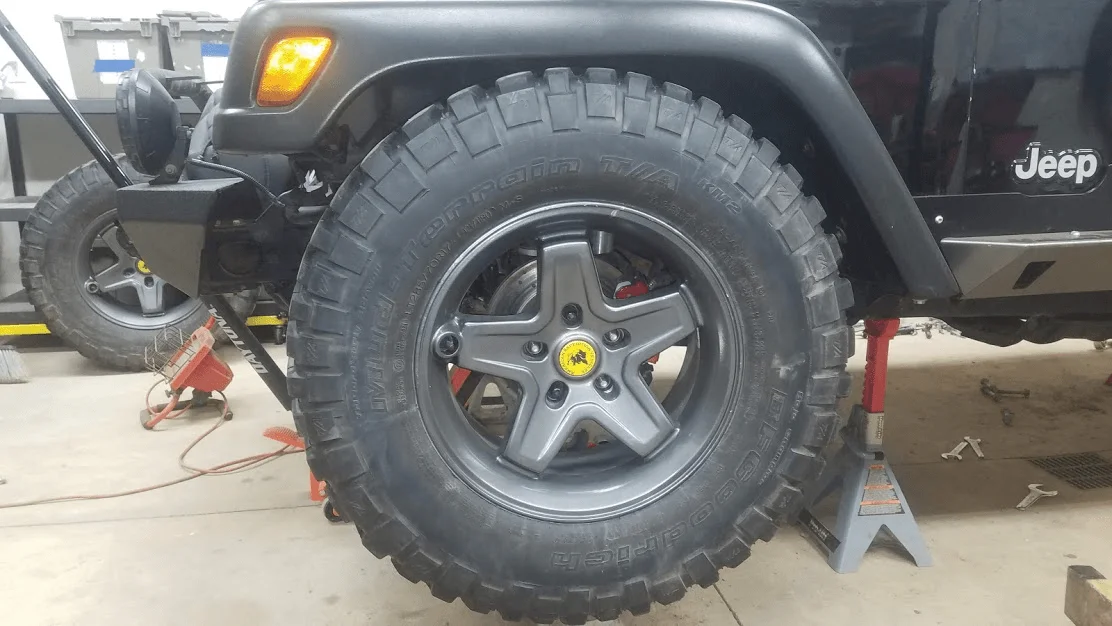

Here is a picture showing the additional clearance gained from the tubular style arm vs. Factory. This is at full lock, no washers or anything else artificially limiting the turning radius. If I did this with the factory arms, the lugs on the tire would grab the flange on the arm and make a heck of a racket.

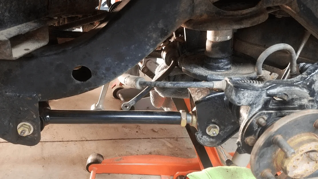

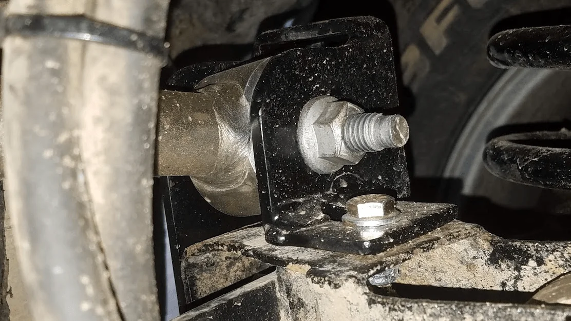

I also took the opportunity to install a new adjustable rear track bar. It was the one thing I left alone when I did my lift last year. I didn't like the bracket I used, as it was boxed where the bolt goes through. To make adjustments to the trackbar, you would have needed to remove both end, as the box prevented the adjustable end from lifting straight out. So, I cut the top off. Then looked at it again and decided that the nut side would be totally unsupported without the top. To fix that, I added a flange to reinforce the now unsupported side of the bracket. I bolted that flange to the axle, and Voila! Its really nice having a welder...I just wish I was better at welding. Practice makes perfect though. I gotta get some heavier steel to practice on.
96161
When I finally get my Tummy tuck and a DC driveshaft, I'll replace this bracket with the angled one that came with my Trackbar.

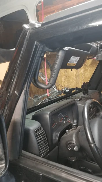

Added some GraBars today...Well, the knock off ones from Amazon.
https://www.amazon.com/gp/product/B07DZYYG5B/?tag=wranglerorg-20
They were less than 30 bucks, compared to the "real" ones at approximately 85 dollars. I wish I had bought the real ones. These are functional and look fine...Installation was a giant pain in the ass though.

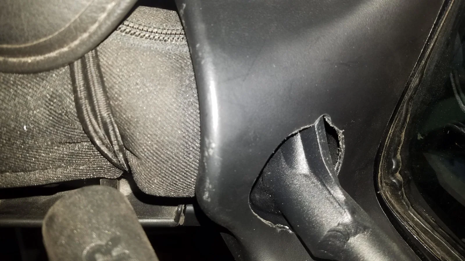

96163
I ended up boring a 2" through hole and notching around the brackets to get them to fit in my A-Pillar trim. It looks OK and its balanced, side to side, but the I'm sure installation of the GraBar brand would have been better.
