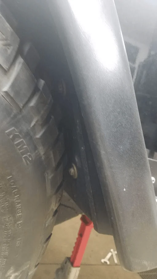

This might help illustrate...
98838
There is about a finger's worth of clearance there at full bump and full Driver's lock. A 35 wont fit. I don't want to sacrifice uptravel, and right now I only have 1/2" of bumpstop added. So, I'm moving the fender.
There are a lot of things I'm doing here that are different that what the "rules" say. I'm going to try breaking a couple and see where I end up. Pretty sure I'll end up with a rig that is a little bit of a sleeper...at least, that is the goal. In fact, I'm not sure I'd need to go with a 3" spring, but for the fact that I want some longer shocks under there.
Reactions: psrivats and Alex01
The tire hits the fender right where the abs tray / battery live. When I installed my MC fenders they supplied new bracket but the rear of the fender is still my point of contact for setting the bumps. I'm at 1.25 with 35s. 1/2 of bump seems fairly low for 33's and stock fenders...

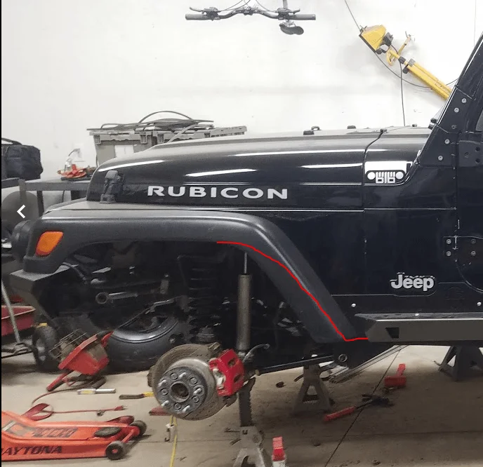

I think I follow. So, you'll move the fender up and back? Can you move the fender back without screwing up the grill area? Or do you just move the fender up? If you move it back you have to trim the JCR Crusaders too I guess.

Yes, Up and back. The starting theory is that I can increase the angle of the rear of the fender, so that the grill area stays the same, but as you transition along the wheel well, around the radius at the back and proceed to the bottom of the fender, mine will be swept toward the rear of the vehicle more. Like this...The red line represents the new "edge" of the flare. I will probably need to cut the sliders back too. I don't need much, I figure 2" should do it. The plan is to cut the material out of the two inner supports (the things that hold the ABS and Battery trays), and simply bend the Inner back to meet them. Then reskin or cut the outer sheetmetal to match, depending on how I want my fenders to look. When you're thinking about this, its helpful to visualize the fender as two pieces, inner and outer. The outer is just two flat surfaces with a 90° bend in them...The inner is what needs to bend and move.
When CasterTroy cut his rear wheel well larger toward the rear to accommodate the 36's, I remember he told me he trimmed the outer edge of the flare off, maybe 1.25" in order to decrease the rigidity so he could bend them to the new shape. Looked good though. I'm looking at your pic and wondering how much room you have between the flare and the slider/step. Doesn't look like much, hopefully 2".

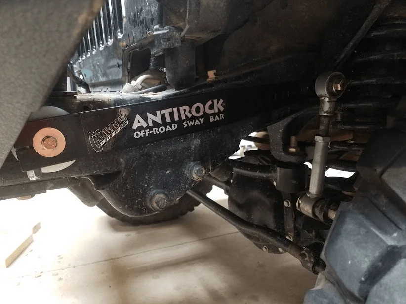

Not too much going on in the garage currently (well on the jeep, anyway) but I did get my anti-rock mounted. It went in without drama. When it came to mount the link though...Well, an Anti-Rock is not designed for a 2" spring lift. The links are far too long for such a short lift. So...I'm running my discos. Yes...I'm running discos on an Anti-Rock. I will replace them when I find a sale or free shipping.
Driving impressions? Its pretty uneventful. Yes, There is more roll. I'm running the loosest setting and I can feel (and see) the front of the Jeep moving more than it used to. Is it scary? Nope, not in the least. I am planning a wheeling trip next weekend, so I'll give a little update after that about how it works offroad.

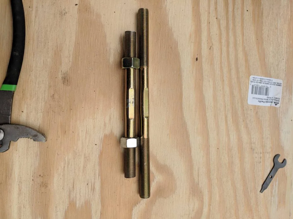

So, I purchased an Anti-Rock during one of the better sales. I also have OME 2" springs. Are you saying this is going to be a problem? I don't recall if the AR comes with links, or not. If so, they're too long? What options are there available?
I took the maximum amount off leaving room for the jam nut and link head, 2 inches off each link. You can also buy 6.5" links from Currie. Mine works fine
