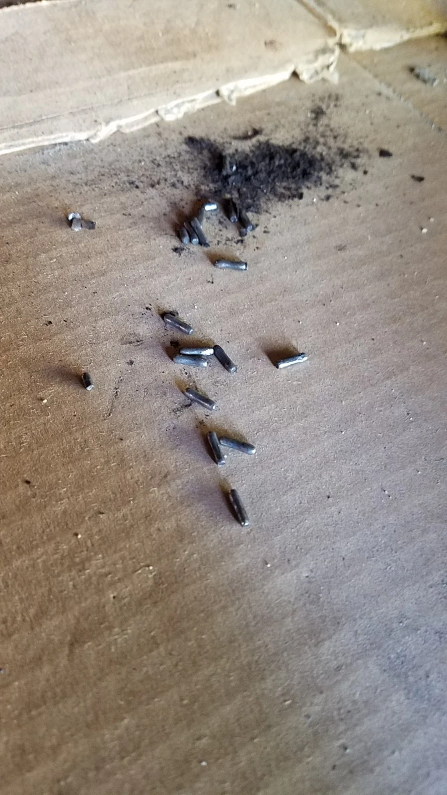

Found the source of my transmission issues...
Those little pieces of metal are the needle bearings from the pilot bearing...inner cage is destroyed, which left the needles free to roam all over. Now I understand why the tranny input shaft is FUBAR.
To add insult to injury...this is how the pilot bearing race came out. The puller I rented from Advanced Auto Parts just broke the edges, I assume because the inner race wasn't there. I ended up using a cold chisel and deformed it enough to spin in the bore. I was then able to use a small prybar to lever it out. SMH. Anyway, all new parts are in tonight. New pilot bearing, clutch and pressure plate.
