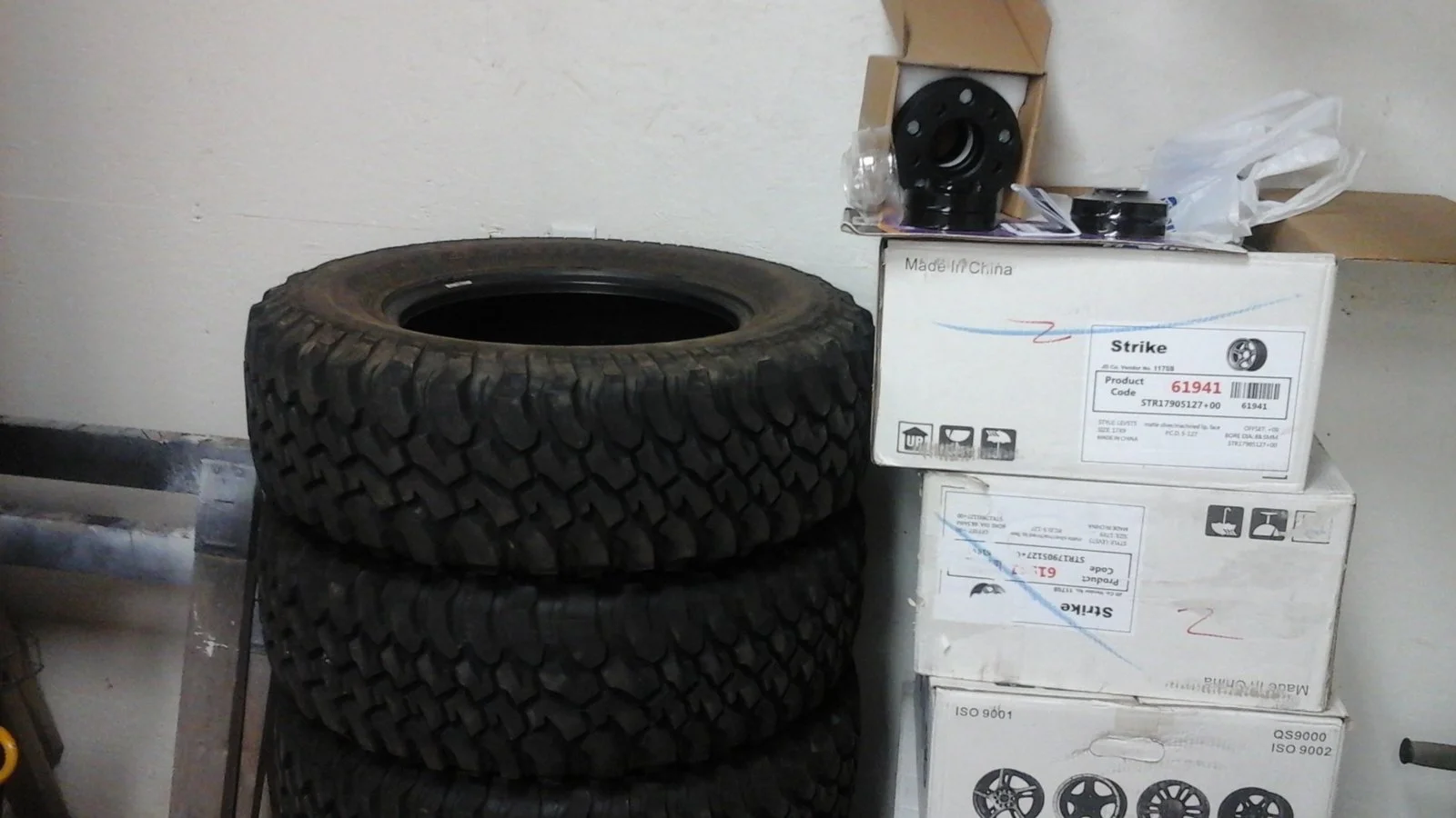

Tires are home...500 dollars for 5 BFG mud terrains with 15/32 tread left. They start at 19, so pretty new. Date code says 27th week of 2015, so good there too
Now, I gotta get some 17" wheels. Should pick those up soon. I do have a call into my local tire guy, to see if any of his distributors have anything they wanna offload cheap. Otherwise, I will go with JK wheels.

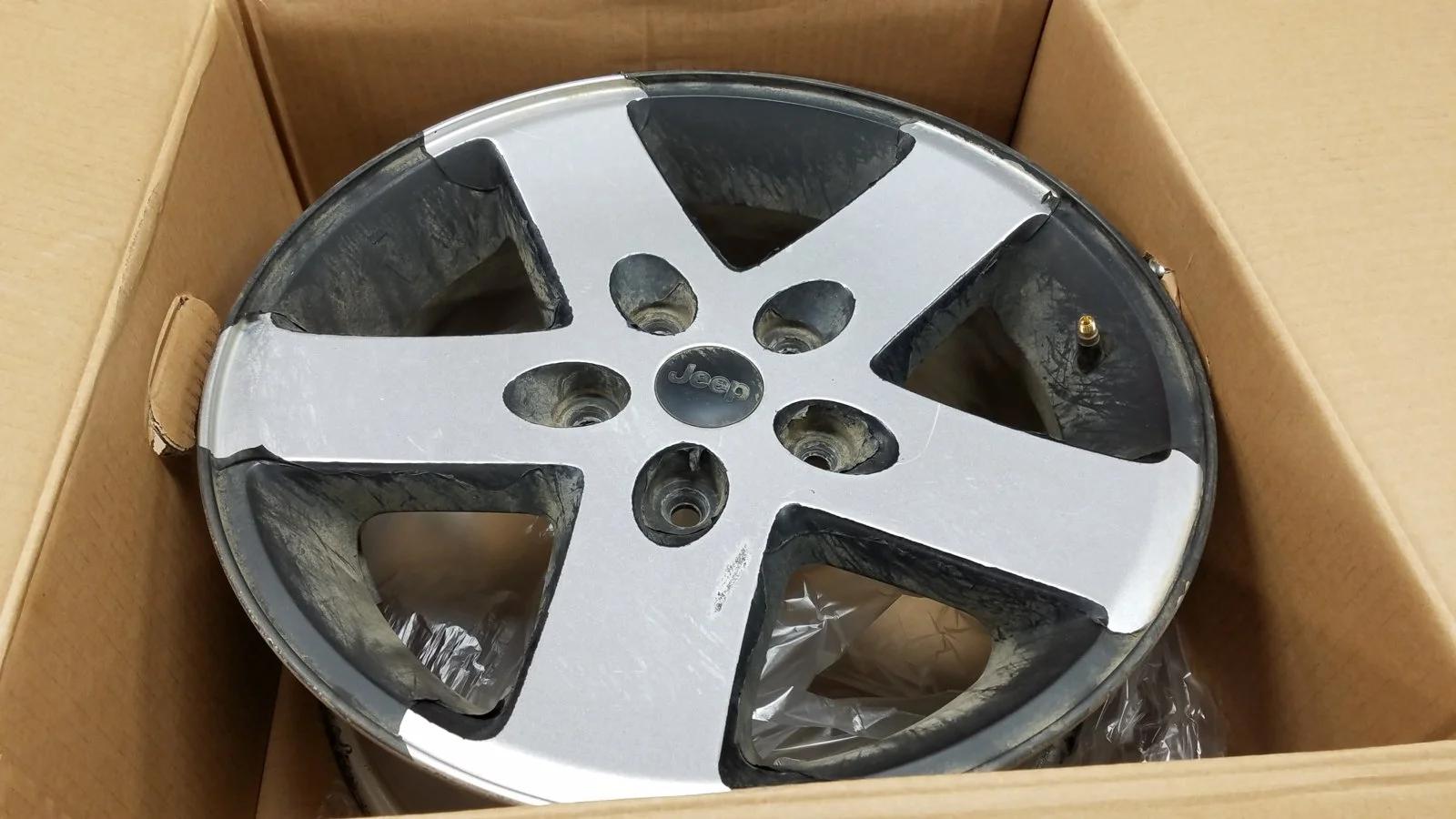

Picked up some wheels today. They are in good shape, but dirty. I'll clean them up and give em a coat of paint. 125 bucks for 5 of them!

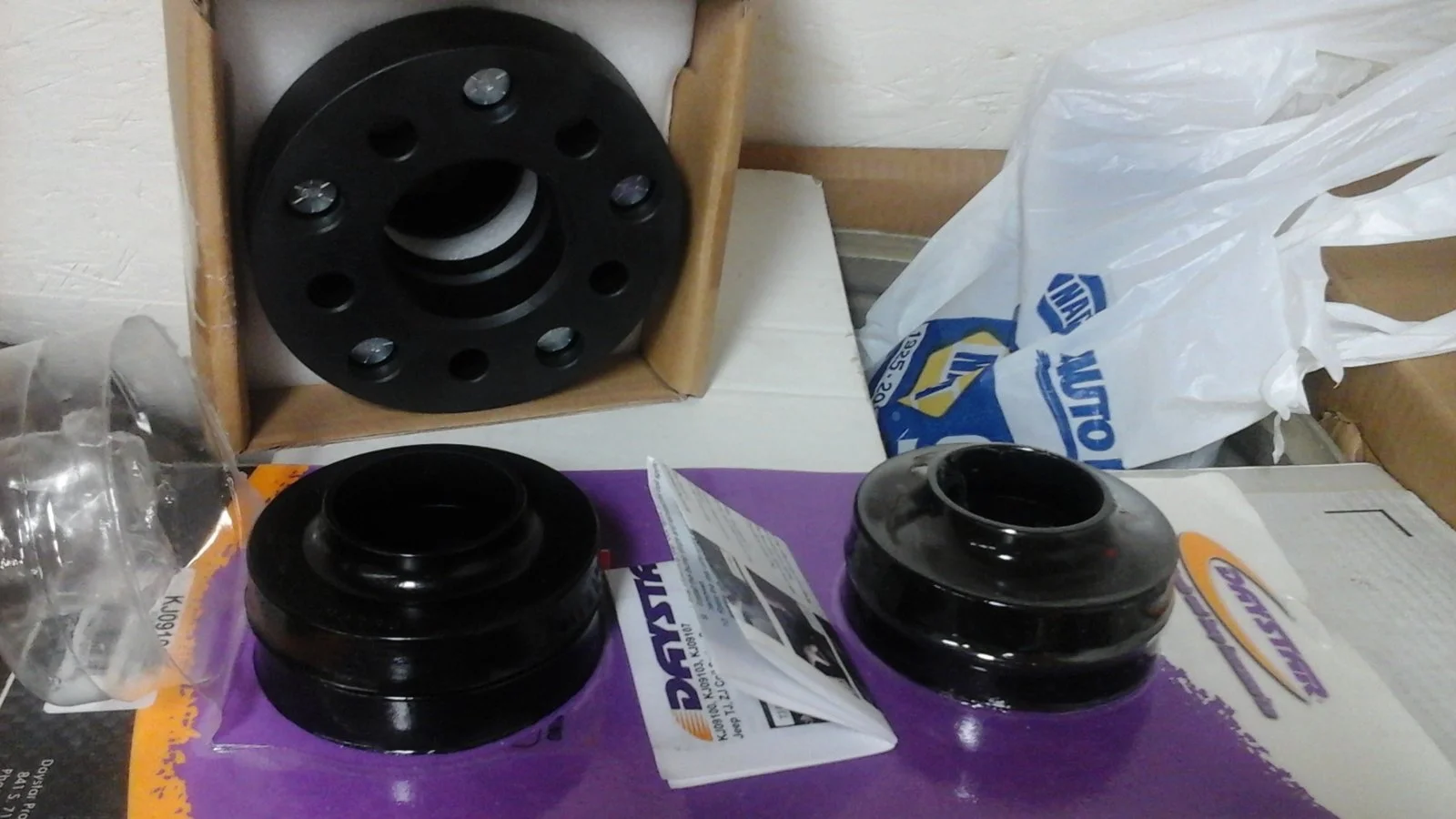

Also have some 3/4" spring spacers on the way. Still need to order the spacers. That should hold me over until I'm willing to take the old girl out of commission for a couple weeks and install a body lift.
I think I have all the parts necessary for this phase...The upgrade corner of my shop is filling up! Wheel adapters came today, 3/4" coil spacers yesterday. Gotta clean and paint the wheels first though.

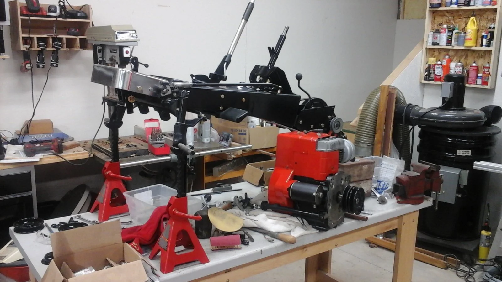

Its a 1964 Simplicity Broadmoor Lawn Tractor. Cute thing when its all together. Had a 32" Deep deck with three blades. It cuts my grass so nicely and WAY better than anything being produced now. I tore it all apart, sandblasted everything, and am re-assembling now. I'm close to getting the frame done, so I can start the body work. It has some modern upgrades too. Stock, it came with a 6 HP engine. That lump on the table is a 12 HP. I'm also adding a mulch kit ( which is why I also need the extra HP).

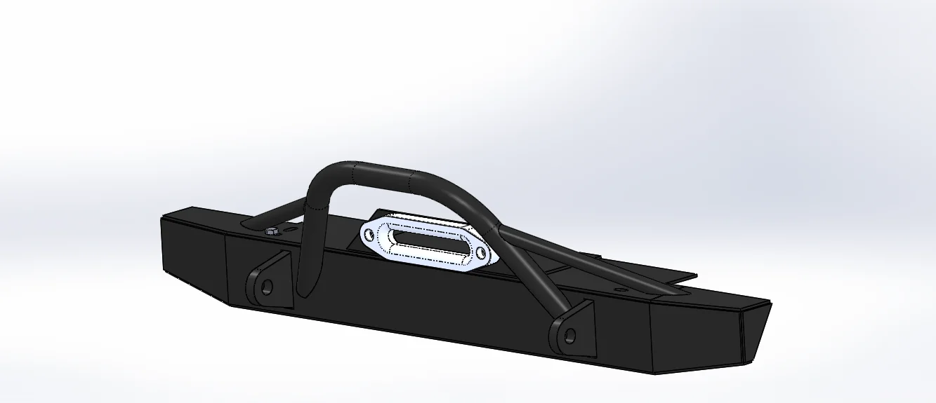

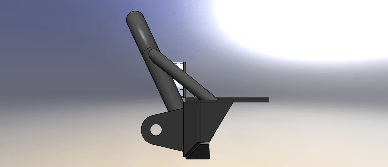

Spent a couple days designing a bumper...I'm an engineer even though I don't do any engineering at work anymore. I also like "making" stuff. So, I thought I'd build my own bumper. I really like the design of the dirtworx one, but don't like the 2 x 4 tube just bolted on to the frame. I like the JCR DIY bumper, but it looks a little too DIY for me. This design is kind of a cross between the two.
Next up will be patterning it out of cardboard. I haven't decided yet if I'm going to try to cut all the plate myself (I don't have a plasma cutter) or send it to a fab shop. My Uncle runs one, so I can probably get a pretty good deal. Anyway, I'm pretty happy with the design. It may change slightly as I get better measurements on the frame for the mounting points, but the overall intent should be the same. I may add a couple of square holes outboard of the shackle hooks too, for mounting some LED fog lights.
