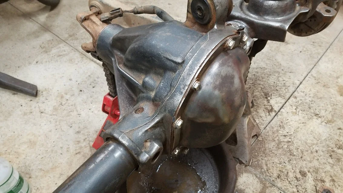

Finishing my weekend work today, Got a nice coat of paint on the axle. My knuckles are REALLY nasty...like I think I should replace them...anyone got a good spare set laying around? Anyway, once the axle is hanging under the jeep again, I'll pull them apart and finish painting the inside of the axle "C" and the knuckles. I'm not going to wrestle with it until I can use the power steering to pop the unit bearing...IF I can get the bolts out.
As a Reminder...Before:
4PWgSDntLtB9fzOEt1q8CkRI2kEz6k_8P_0bGbECXVaJe4HyHEGhTlhnjmx0KOo21KxE4r5_QBXs-ycVUl=w1133-h638-no.jpg
All cleaned up and ready for paint:
gzPa1RXjSWf_8lwOTJxrmROarUwPxrpqTPzVgx-_7xIb1kJ-k6vfHGXRl-C25zaXxAneDacR-C4K8O1yGj=w1133-h638-no.jpg
B8V5JPhhSnAJGzzZ9MjegbkzRBC9I6fB41cn9yRqzJZOa0GxQ1GKGpmKQIblOKrU6T7TNQcGmaDaTQm2fP=w1133-h638-no.jpg
Finally, PAINT!!! Its still wet here, but I used a semi-gloss so it should tone down a bit...I hope.
M7ZHWGIgPIueFMDItLToOkqF64tfnRoUcy9yqUd5whez-7v7eCbZYJtQ2LTGj2MbiWqi7xuKtt6_x7akb8=w1133-h638-no.jpg
CUtBsdwKMICU0wcOFoBbetg9f5J3gqjDuvZXFPnc3AOwKuKP6Dnj8bHTCOY2QjevEar3Xii46P7IngbG0Q=w1133-h638-no.jpg
