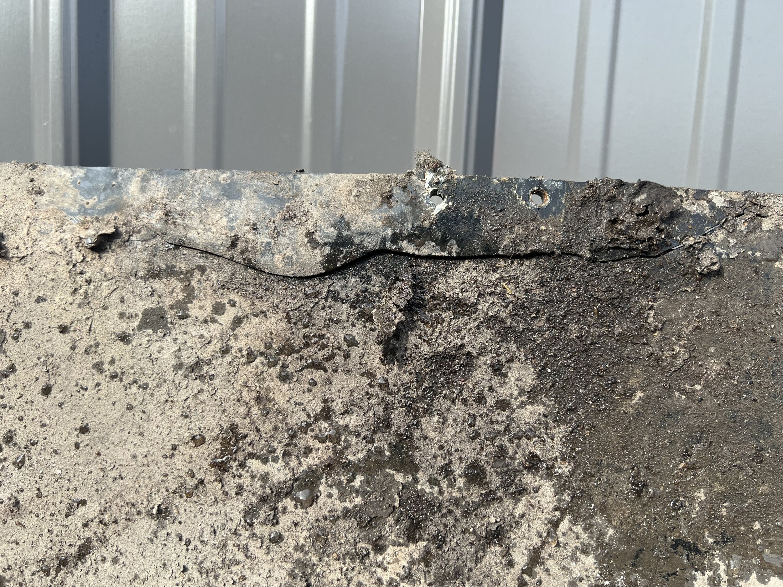

WTF it looks like they just cut a hole in that plastic then glued in a 1.5" adapter? How was it attached to the tank? Was that round piece a knockout on the tank in case of a larger pipe and it finally broke out? You can easily make something up with a larger plate and put silicone or Butyl on it and screw it to the tank, if it's accessible.

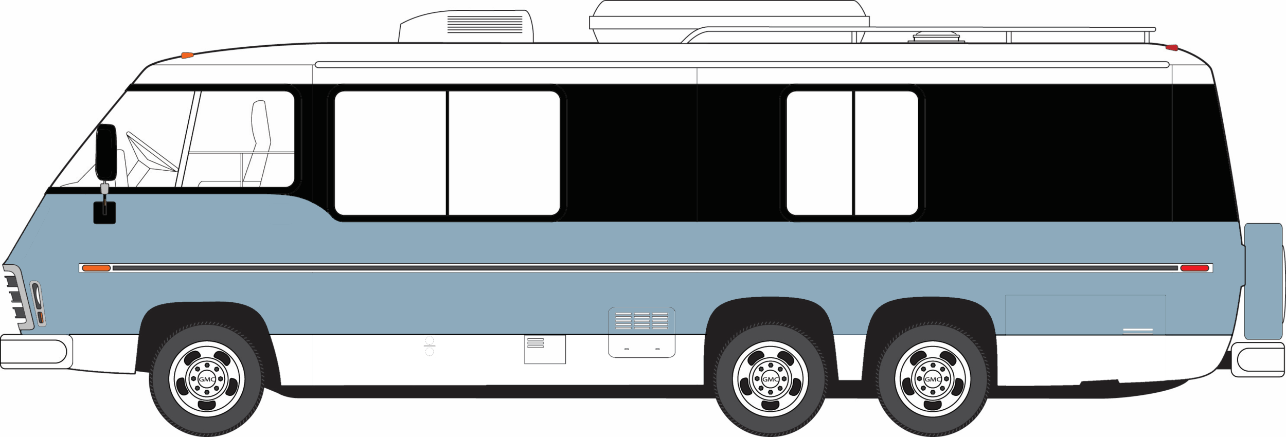

This one is pattered of a Bronco Sport, Heritage edition...its a good look...I really like it as it has a 70's vibe but kinda modern too. I don't think it would go out of style either...My wife looked at it and said, "Baby blue?" with that look in her eye...so we probably won't do this one, LOL.
Do what you can to convince her cause this is 😍

Pretty much...I gotta get the tank down and take a look at its overall condition. Its ABS, so welding a new fitting to it won't be terrible, if the rest of the tank is in good shape.

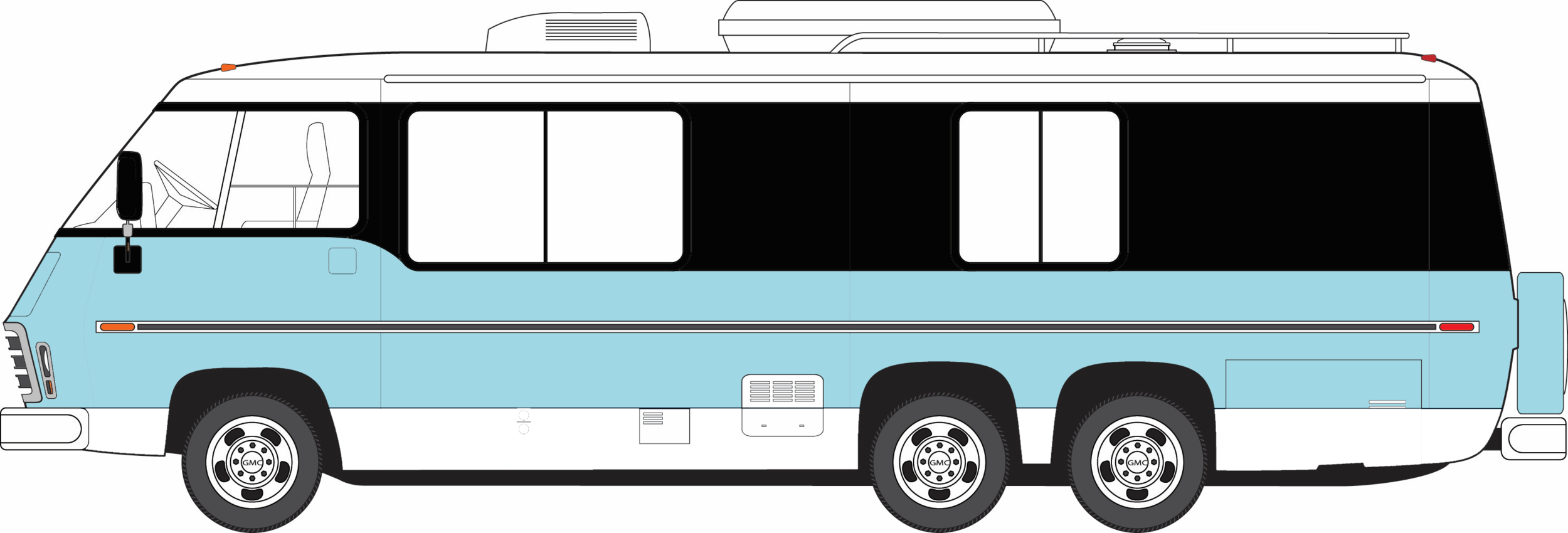

I made a slight adjustment to the blue...The scheme just kinda works!

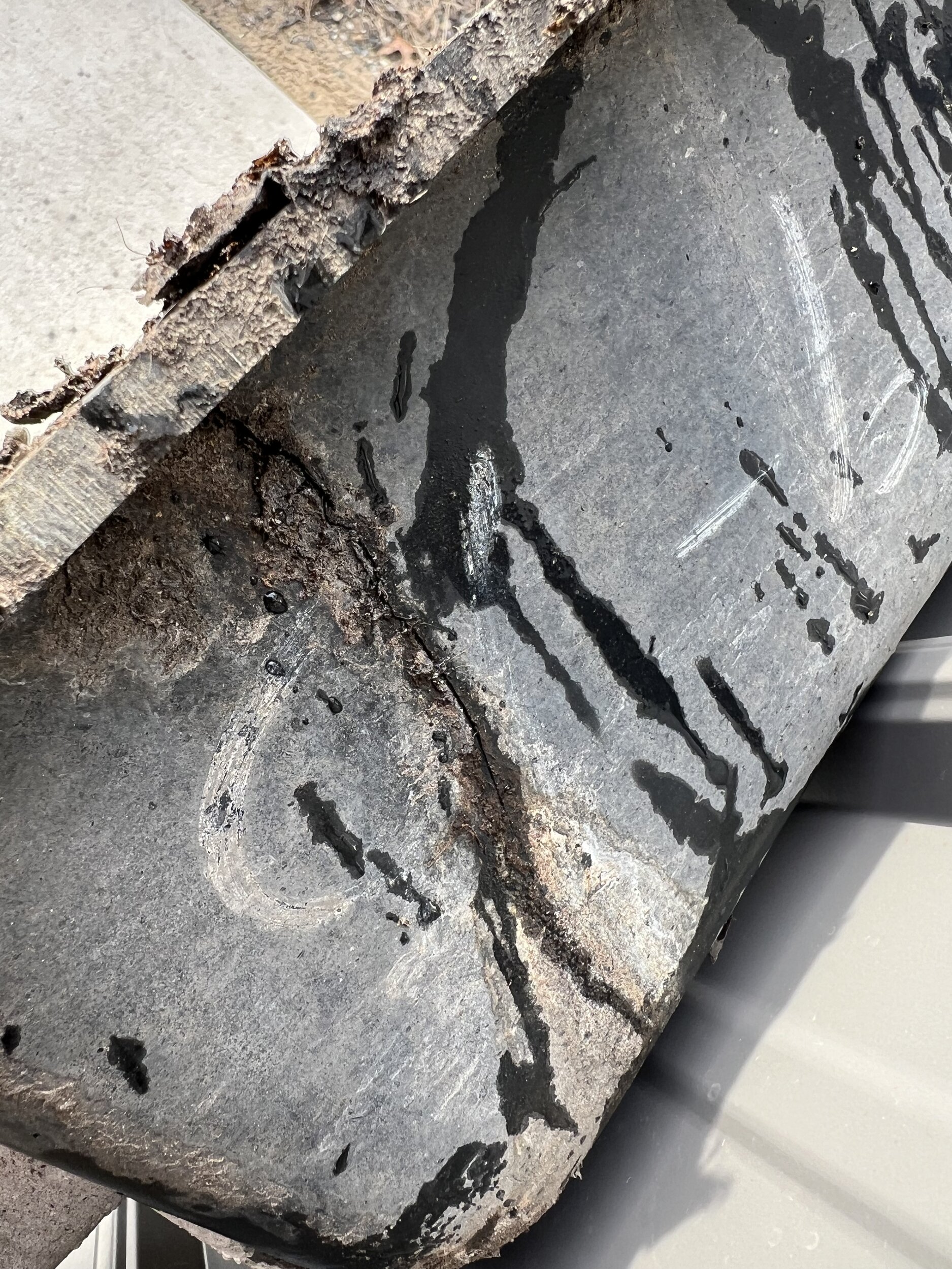

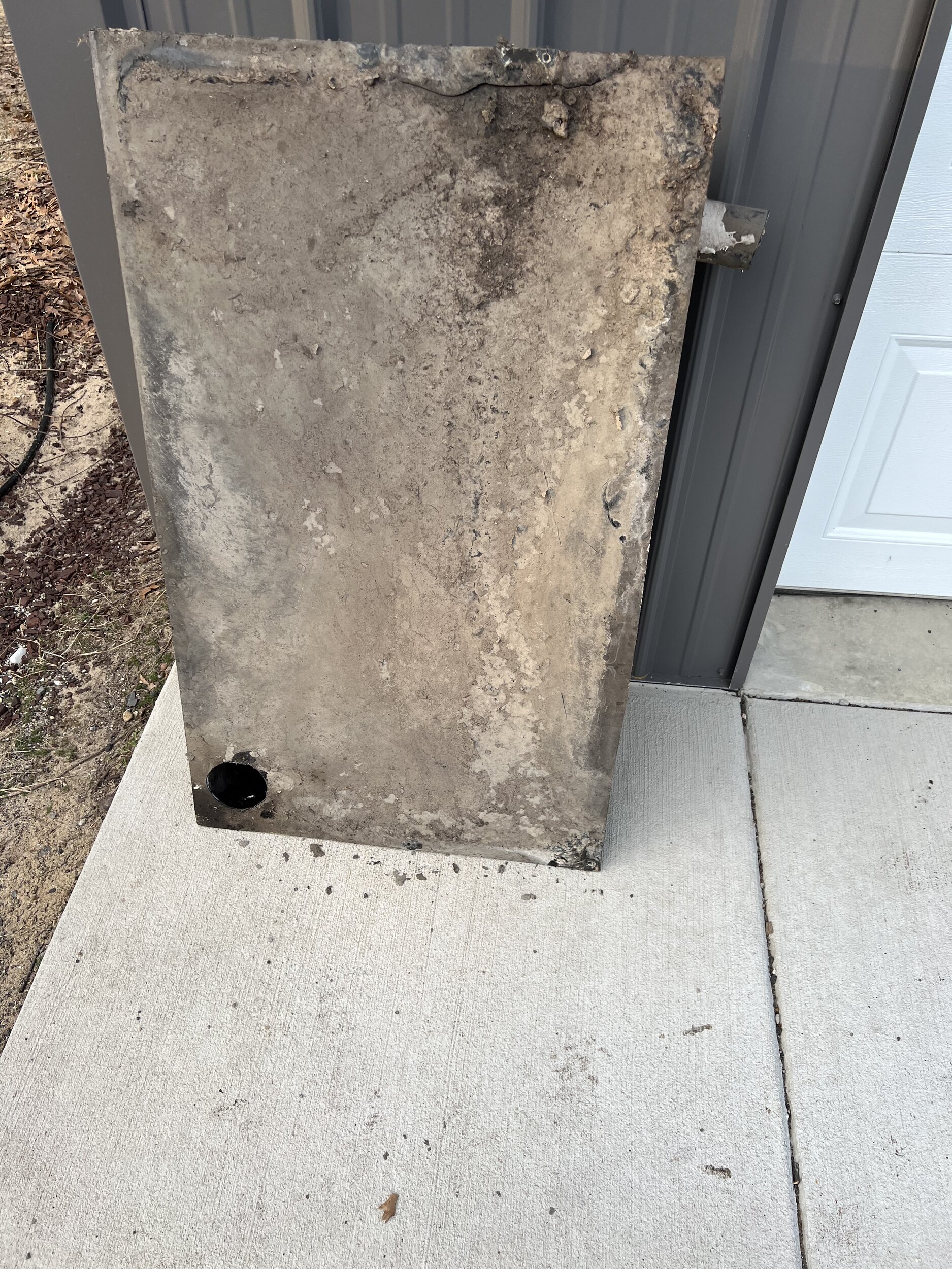

Got my gray water tank down last night. Surprised it didn’t fall down on its own…held in with four 1/4” self tapping screws…Yeah, a 19 gallon, plastic, water tank held by four self tapping screws through a plastic flange.
It’s terribly broken. The top is cracked, there is a big crack down the side, and the outlet had a repair done before we bought it. It’s going in the garbage.
While I was under, I looked at the condition of the black tank. It’s also not very good, so I will be to replace both of them. Not what I wanted to do, but now is the time, since I have zero amounts of plumbing installed and the opportunity to move things around if needed.
