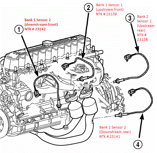

The below shows where they are located but the below part numbers are NOT correct for your '06. The above part numbers are correct for your '06.
