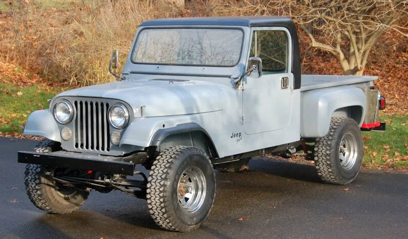

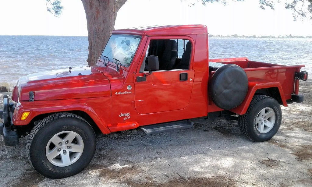

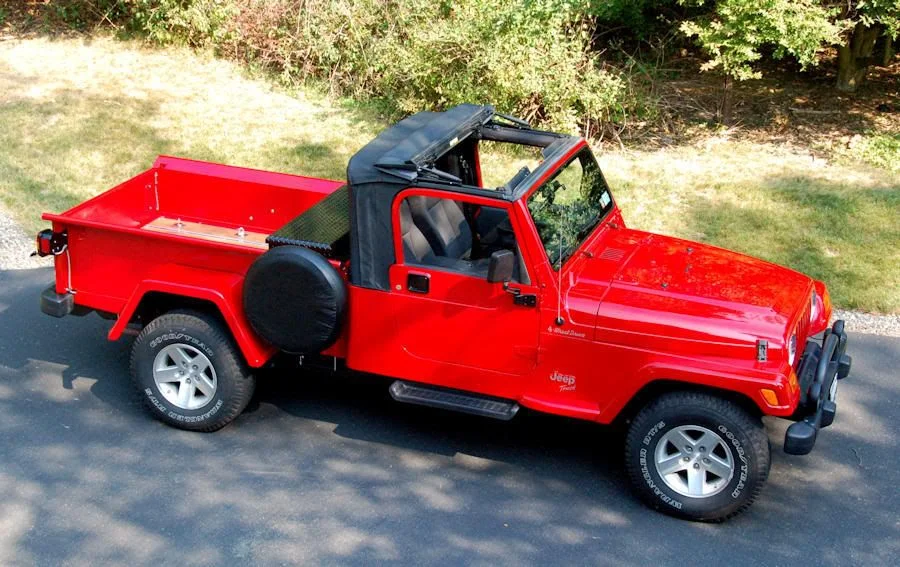

It's hard for me to believe but it was 15 years ago today that I drove my 2006 Wrangler out of my garage under its own power as a pickup. It's still a daily driver and has about 130,000 miles on it today. I did the conversion at about 28,000 miles, so it's been a daily driver pickup for over 100,000 miles.
These two photos are a few years old but the truck looks exactly the same today.

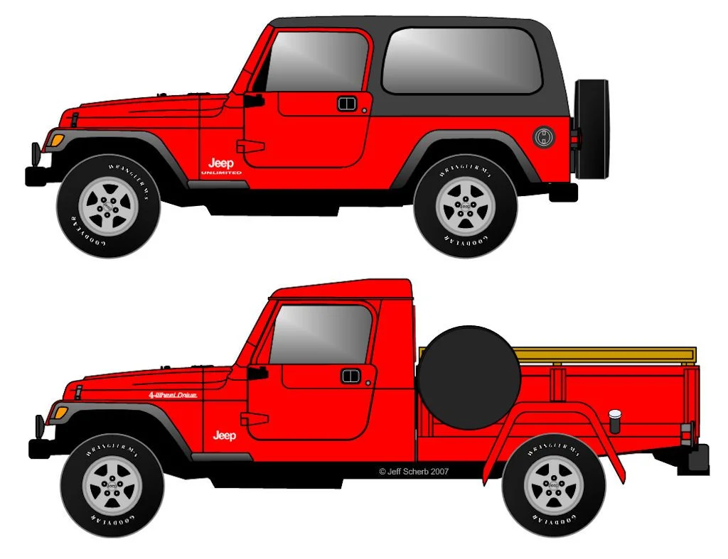

In 2007 I was living in London and about to return to the U.S. I decided that I needed a pickup when I got back and I wanted a Jeep but Jeep didn't make pickups at the time so I decided to design and build my own. My main design goals were that the pickup should have a 100% factory look, and it should be what the Jeep designers would build if they were to do a modern version of the classic Willys pickup.

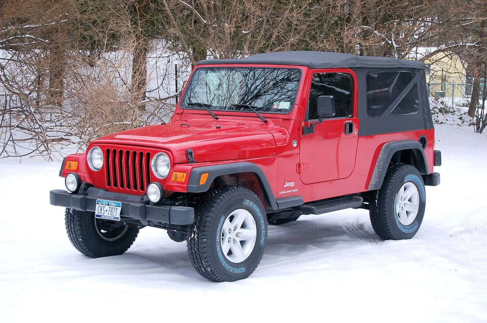

I started the design work before I left London and by late 2007 when I got home I began looking for a suitable LJ to convert. I found one that was just under two years old and had only about 10,000 miles on it:

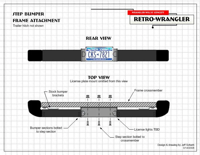

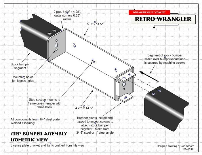

I did numerous concept sketches and component drawings - every part of the project was designed before I started any fabrication work.
Here's an example of the level of detail I went to in designing the parts; I wanted a factory looking step bumper so I designed one made from the factory bumper.

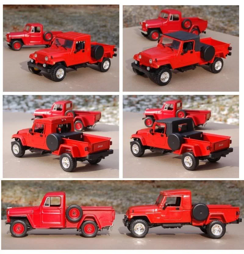

I also made a scale model to I could view the planned result in 3d and compare it to other scale models to decide if the look was exactly correct. Since my design goal was a modern version of the classic Willys pickup, I also made a model of a Willys to compare my model to.

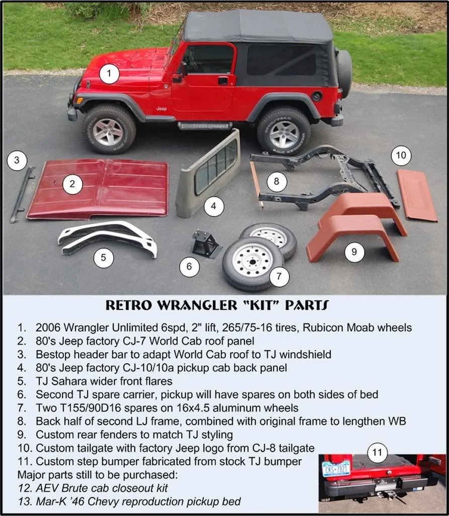

I started collecting the necessary parts. Some of the parts in this image have been modified and are ready to install (the custom tailgate, for example) and some have yet to be touched (the hardtop parts). A few parts I made from scratch, such as the rear fenders.
By late spring of 2008 I had essentially built a "pickup kit" - all of the components were built and ready to be installed on the Jeep. The mockup in my workshop:

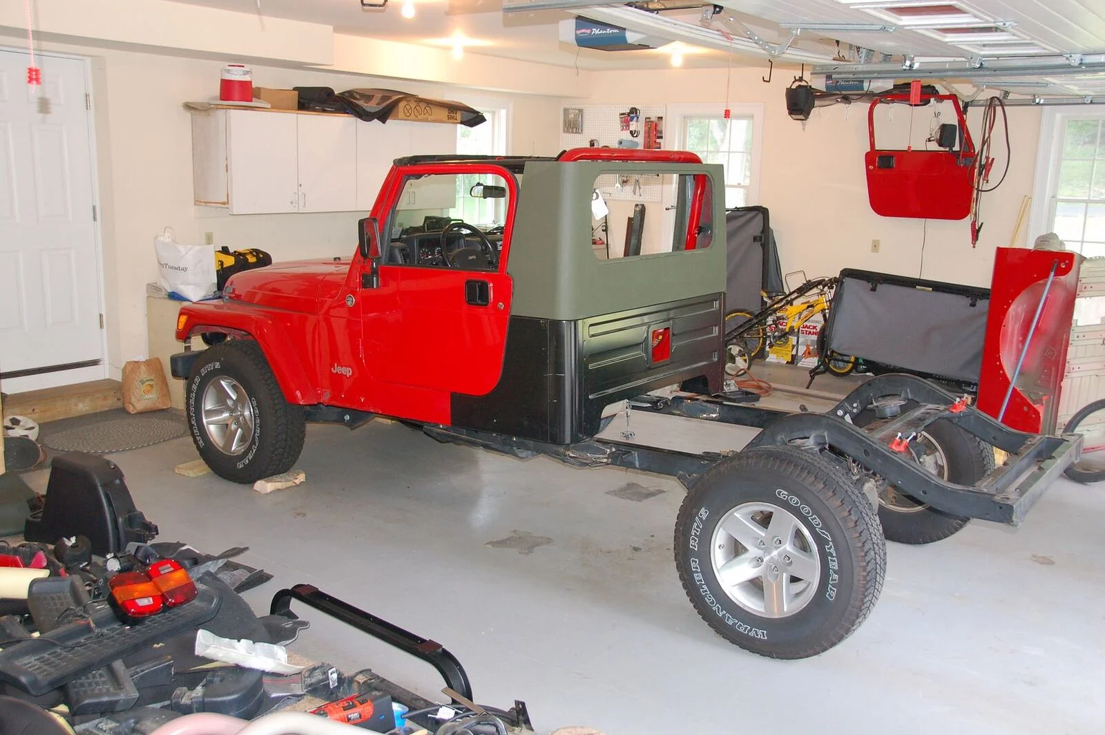

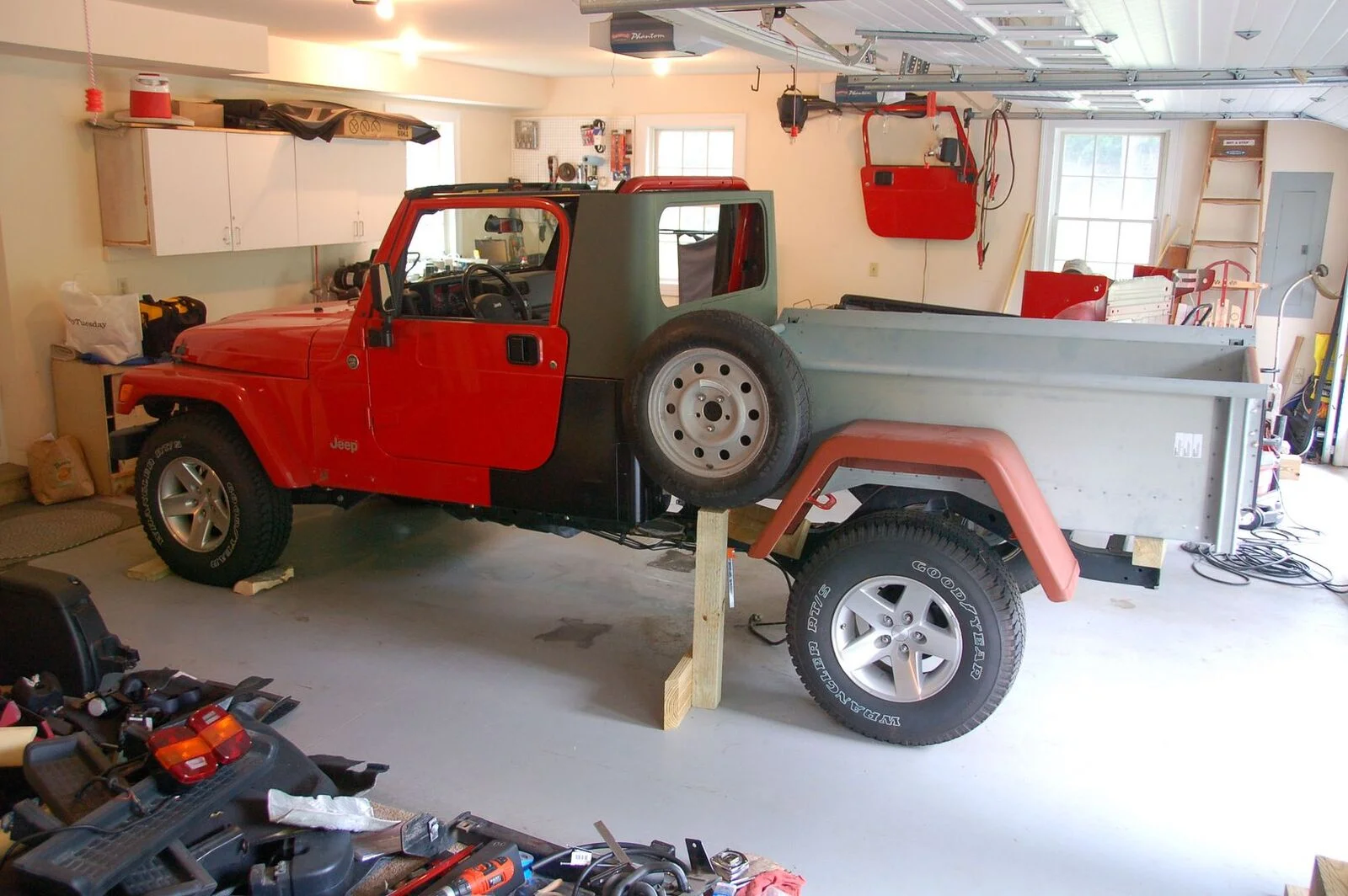

In July of 2008 I drove the LJ into my garage and 17 days later I drove it out as a pickup. The project went so quickly because of the detailed design work I did and the fabrication of the components to that design.

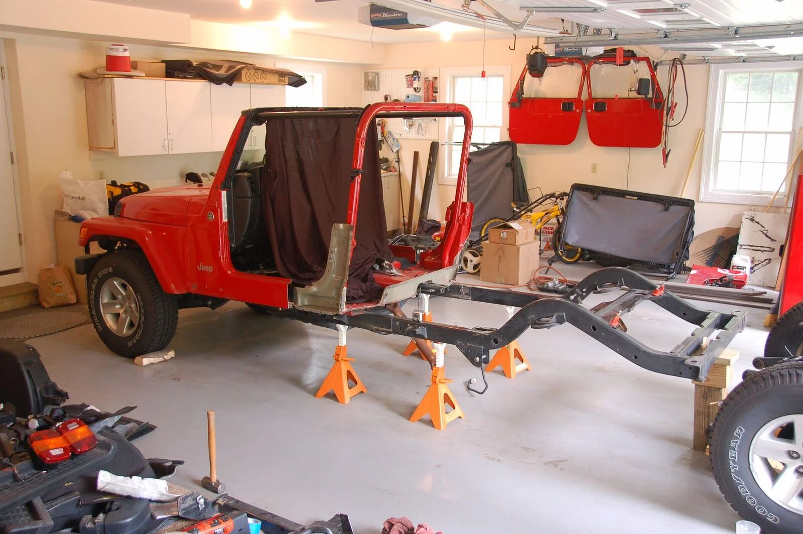

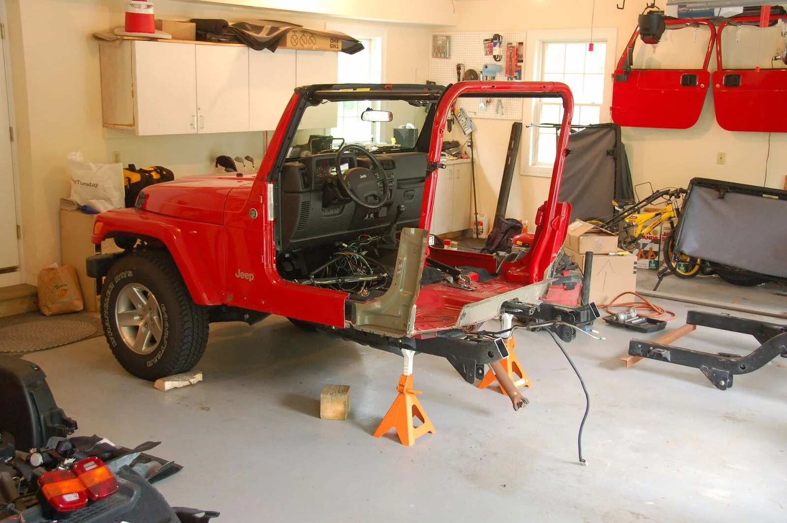

A few work-in-progress photos:
Lengthening the LJ frame about 24":
The cab and bed going together:

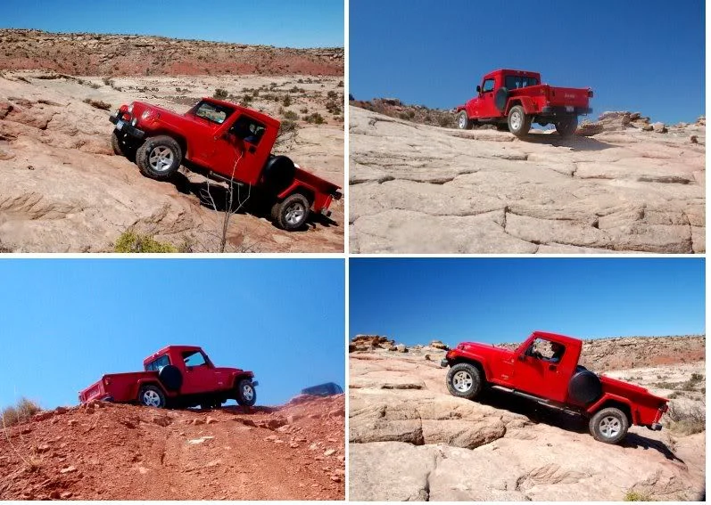

In April of 2009 I drove the truck to Utah for Easter Jeep Safari and for its trail debut.

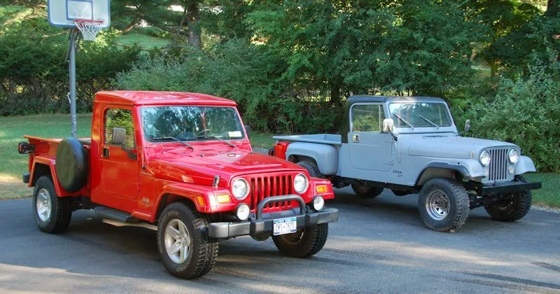

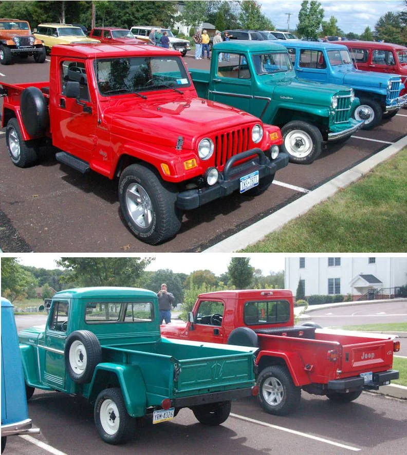

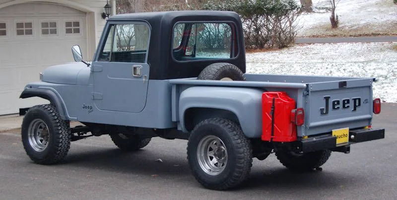

I posted photos of the Willys model and pickup model I made during the design phase above and after I finished the project I got a chance to do that comparison in full scale...

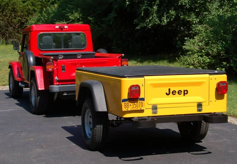

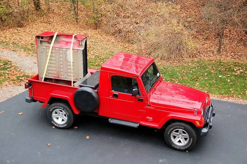

The pickup project spawned a quite a few more projects and some commercial products. In this next photo, I'm hauling the cut-off rear section of the LJ tub to a tonneau cover company, I took it there so they could measure and fit it a tonneau cover. More about the tonneau cover in a moment...

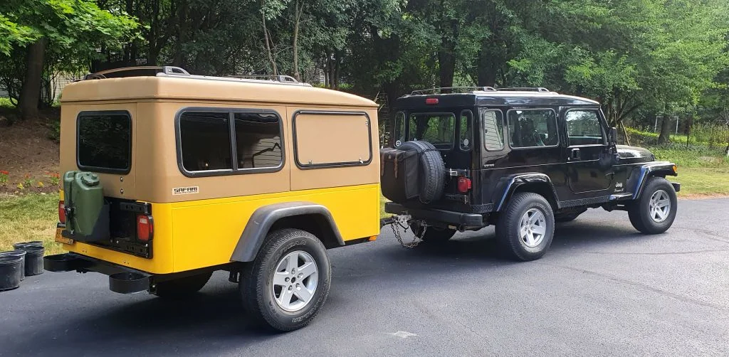

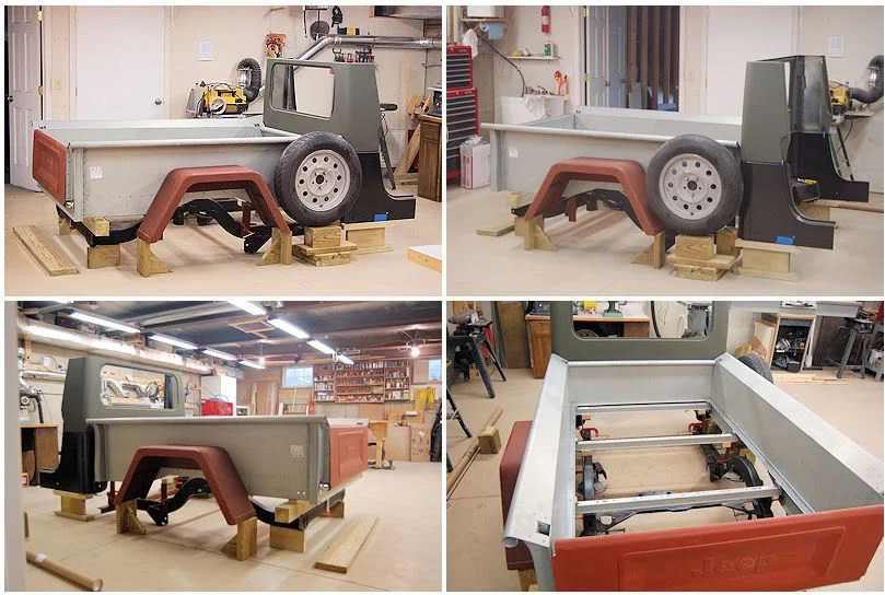

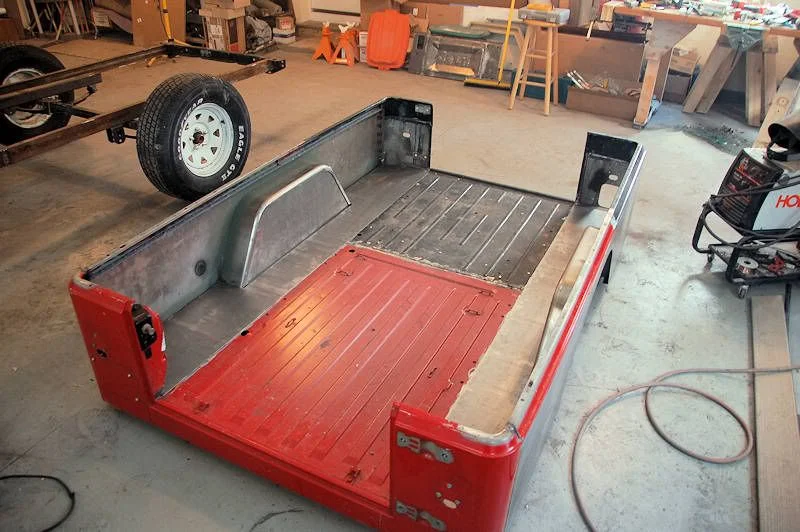

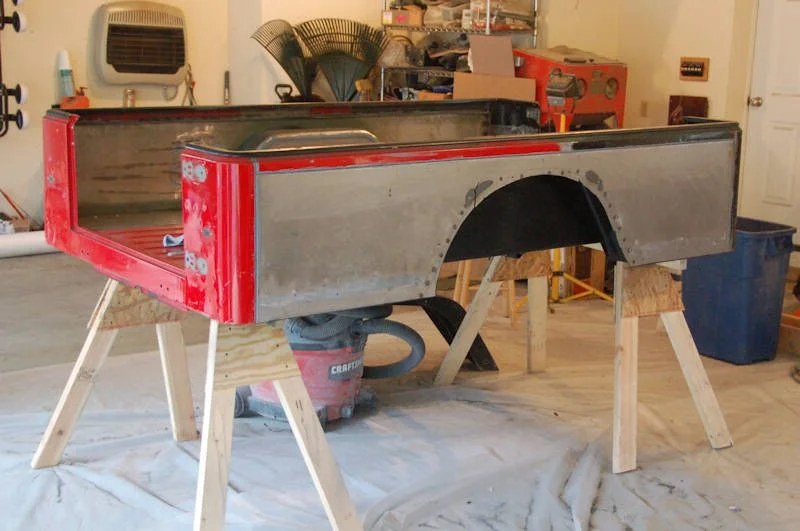

I couldn't let the back of the tub go to waste, so that spawned a trailer project:

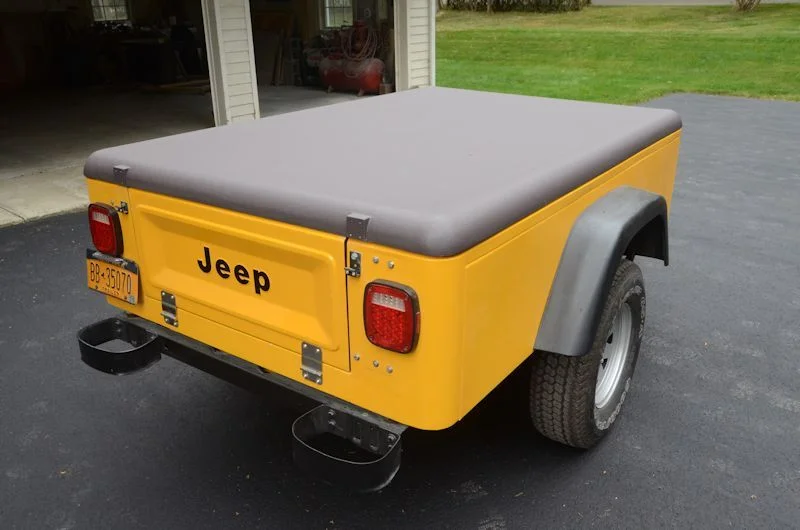

I widened the track width slightly over the stock TJ width so I could fit a 4x8 sheet of plywood between the inner fenders:

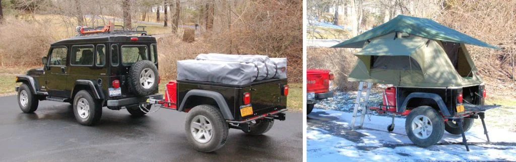

Notice the tonneau cover on the finished trailer in this next photo, that was made by the aforementioned tonneau cover company. This one is custom fit for my trailer, but the tonneau covers went into production to be sold by Dinoot trailers: https://compactcampingstore.com/products/soft-tonneau-covers (more on Dinoot in a moment also).

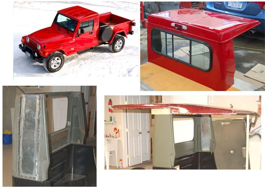

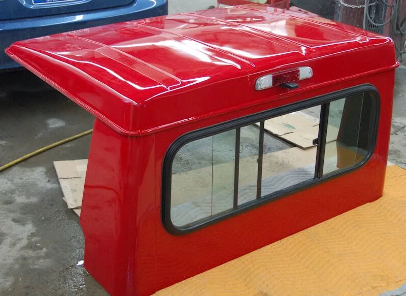

Having that trailer spawned a project I called TrailTop, which are fiberglass components for making trailer toppers and campers. The first prototype was this hard cover:
The cover was hinged at the front, and that spawned a sewing project:

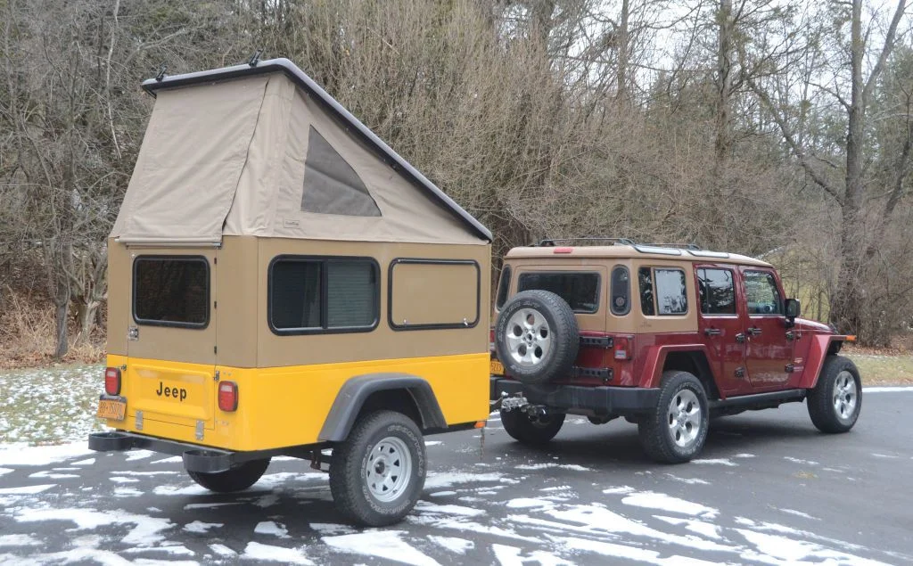

And that spawned a full camper top using the TrailTop components and the canvas from above:
A company put some of the TrailTop parts in production but they haven't done much with them: https://trailtopcampers.com/.

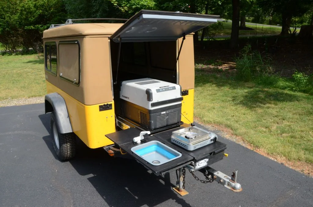

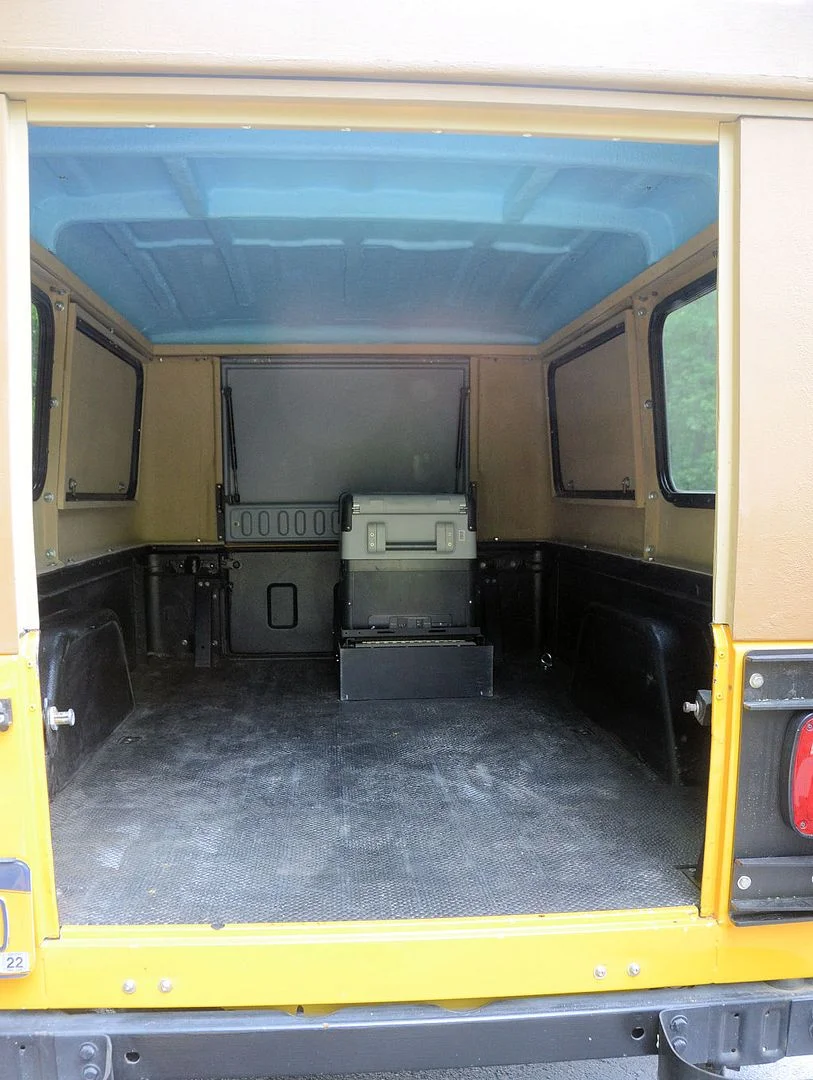

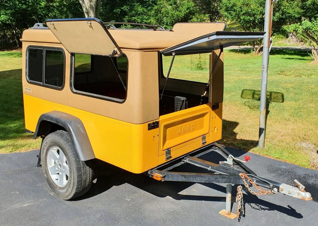

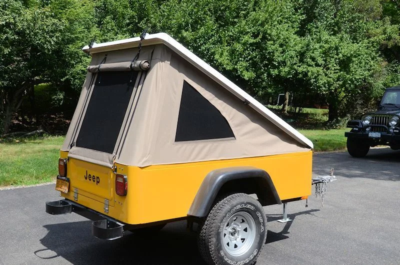

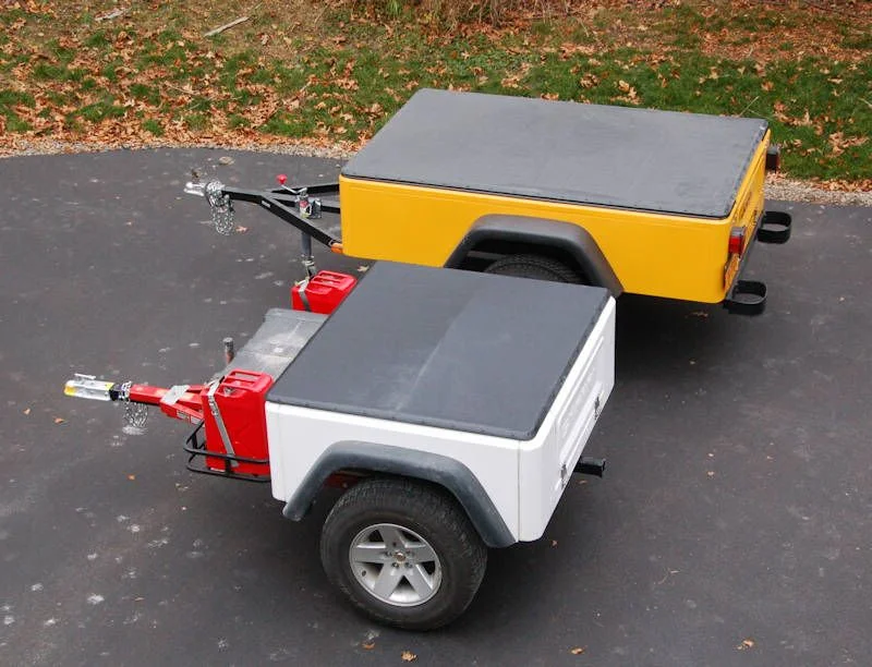

Another project the trailer spawned is a camper version of the TJ/LJ Safari Cab hardtop. I did this at about the same time Gr8Tops licensed the Safari Cab from me and put it into production, and they actually showed it at a Jeep show as a possible future product, but they decided not to put it in production even though the parts can be made in the same molds that the Jeep hardtop is made in.
This is the current configuration of the trailer; I haven't done the full camper interior yet because the trailer gets used as a cargo trailer too often, but someday I hope to finish it, and add the pop top from the TrailTop prototype.
BTW the trailer as it is above will be at the Smoky Mountain Jeep Invasion in a week or so, Overland Outfitters is using it to haul merchandise to the show so if you want to see it, it'll be in their booth inside the vendor expo.

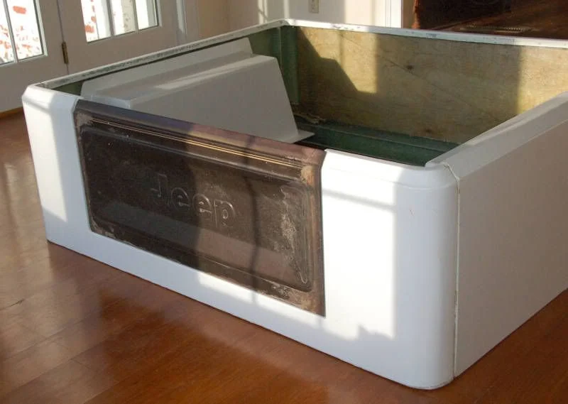

And one other project was spawned by the remains of the pickup - when I built the trailer out of the back of the tub from the pickup, I needed a second tub to complete the trailer, so I bought a YJ tub from a friend. And once the trailer was done the front half of the YJ tub was left over, and of course I couldn't let that go to waste, so I closed in the back of it and made another pickup, this time a CJ:
I actually never finished that pickup beyond the primer stage, I decided I really didn't need two pickup so I sold it as-is.
