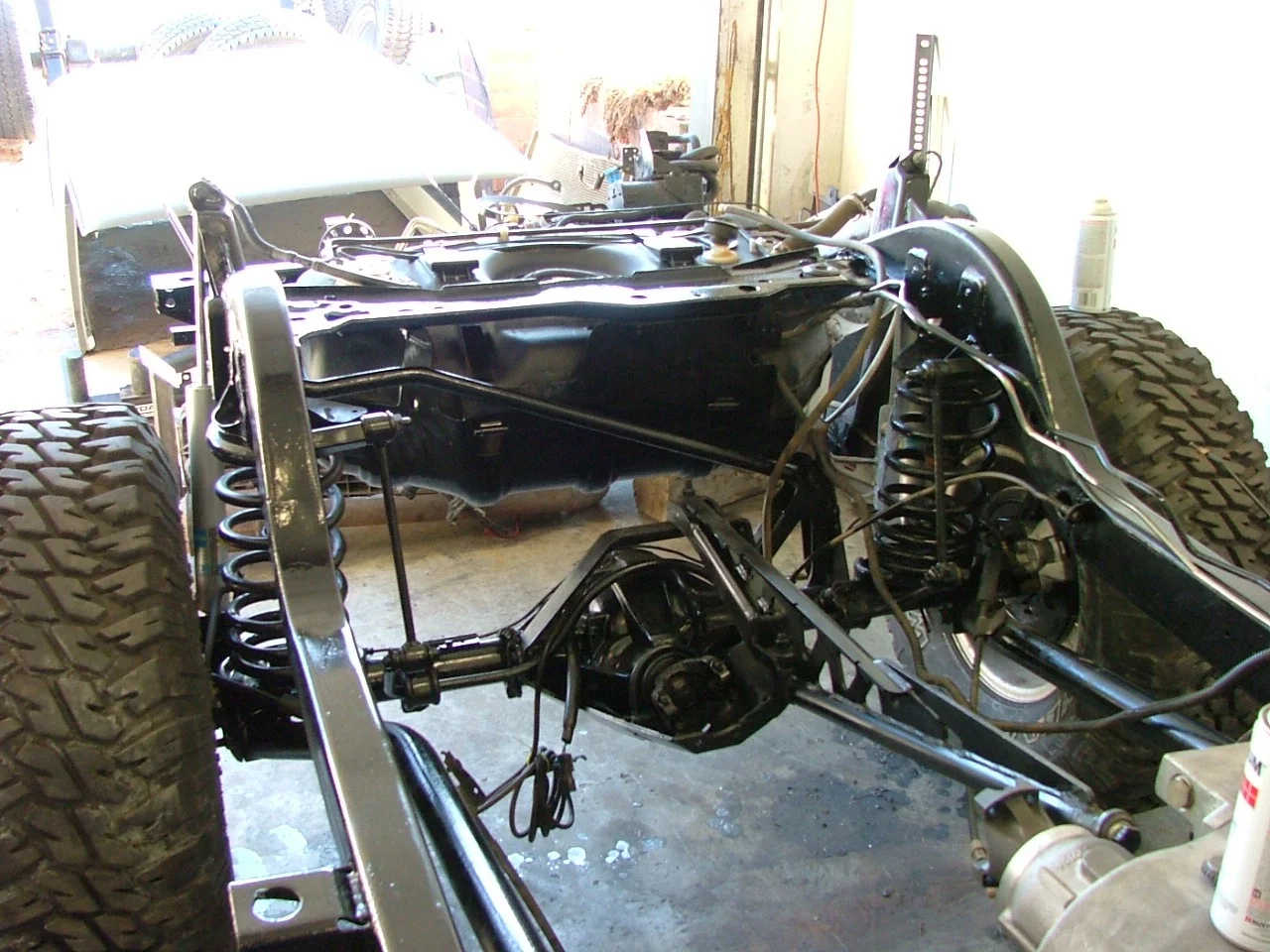

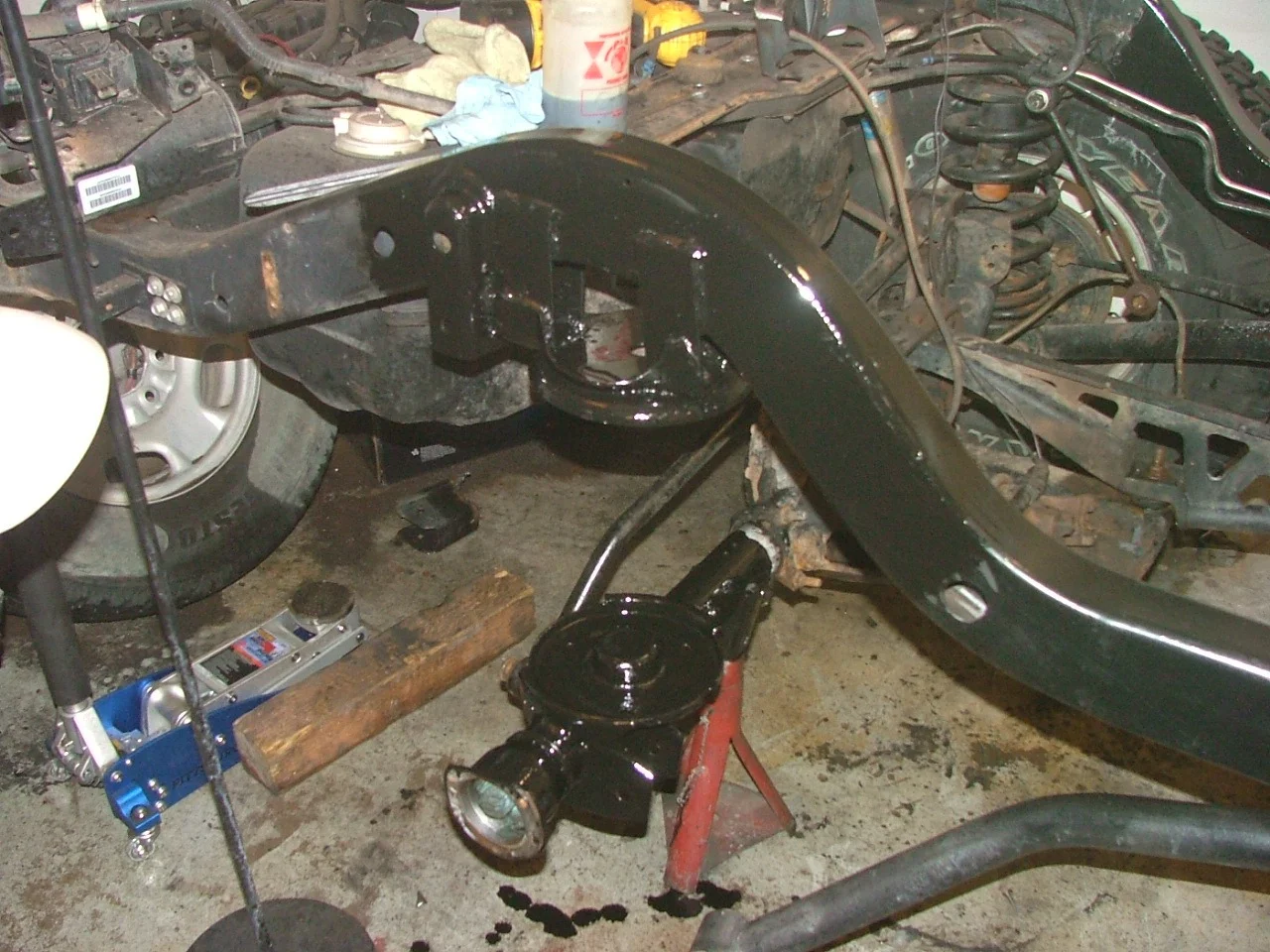

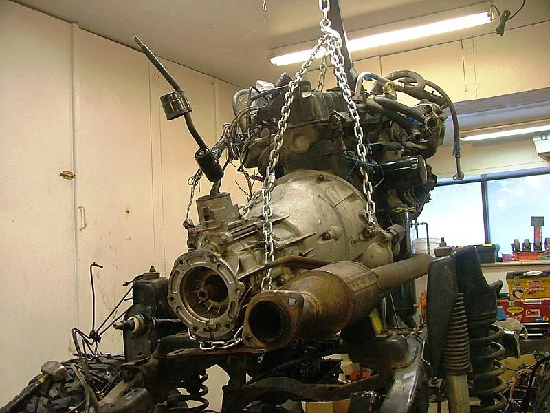

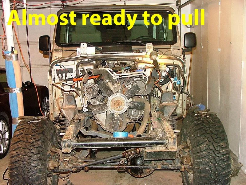

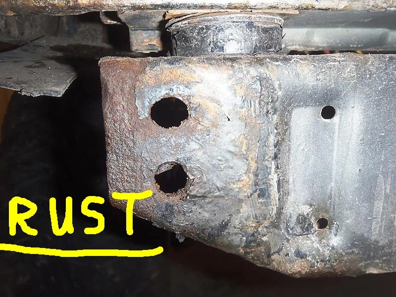

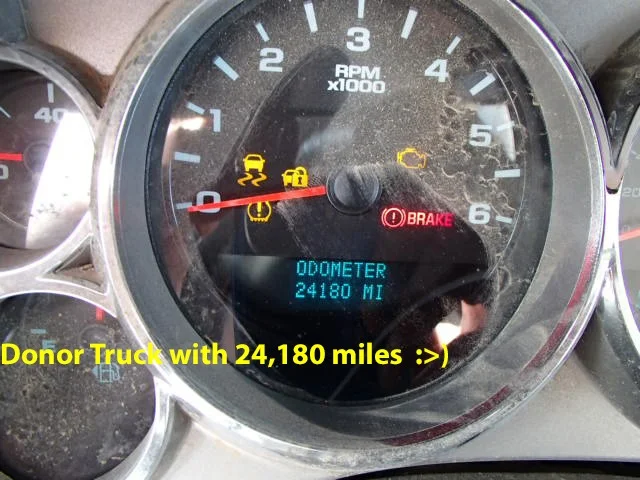

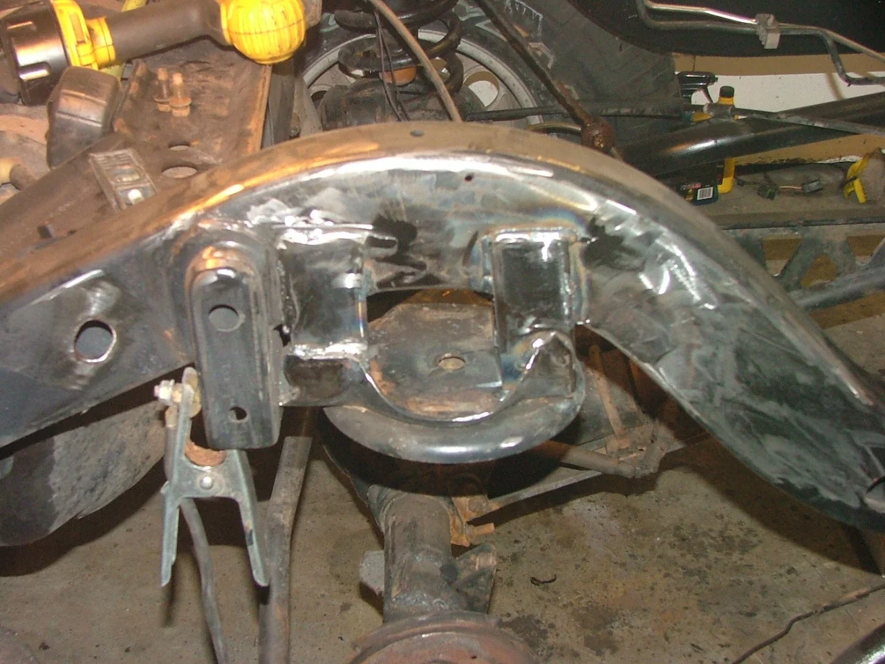

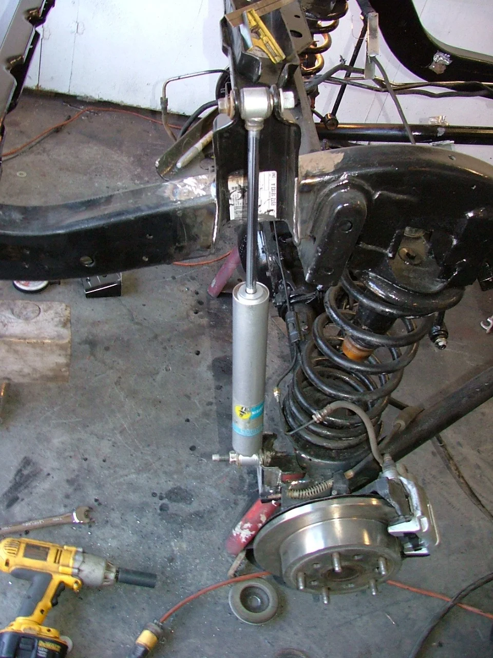

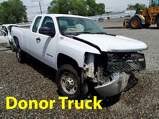

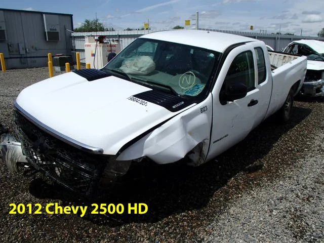

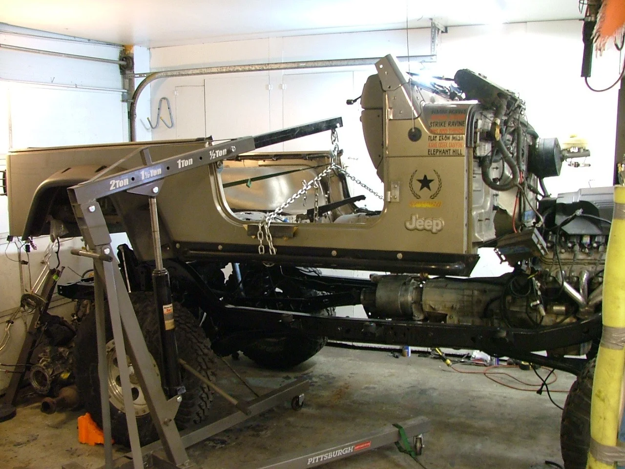

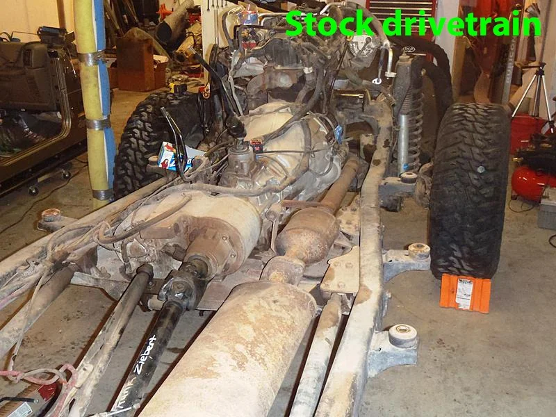

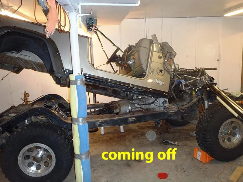

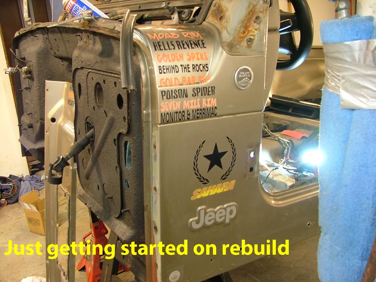

Started with an 05 Rubicon,Sahara, Unlimited number 009. Then bought a 2012 Chevy 2500 HD that had been totaled. Removed the 6.0 and 6L90 and stripped the entire truck and sold or scrapped every other part of it. Started to just do an engine conversion but after 8 years of full time ski patrolling I found the road salt had eaten my jeep badly from the inside out. So it got disassembled down to the last nut and bolt. Reassembled with out boarded shocks, relocated rear spring perches, all rust removed and sections of the frame reinforced. Applied Lizard Skin sound and heat shielding to entire inside, underside, and firewall. Painted the vehicle inside and out Sunset Orange.

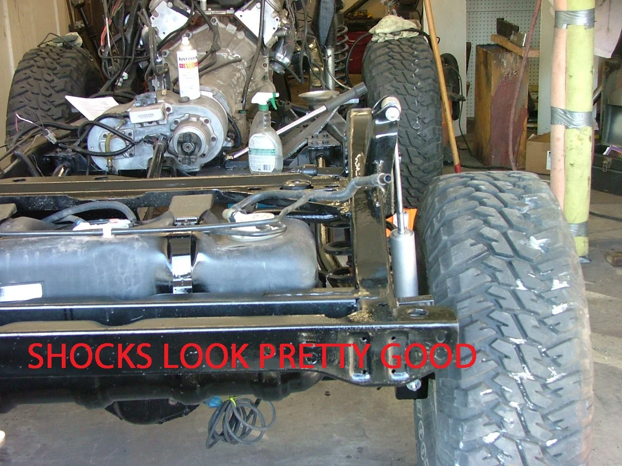

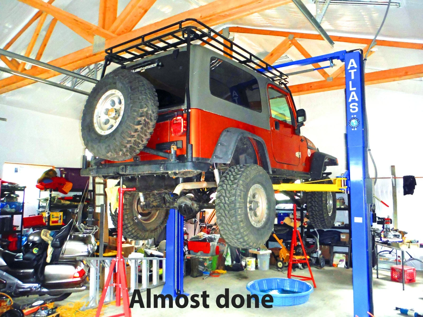

As I was almost getting it done we moved from Utah to Oregon and built and new home and shop. What started out to be a 10 month project is over 2 years in process. Almost ready to start off-roading it. I lost nearly all of my photos in a computer crash late last year. However, the entire process from acquiring the truck to assemble to follow up is documented on the ROF forum.

All I can say is that is going to be one bad ass rig!

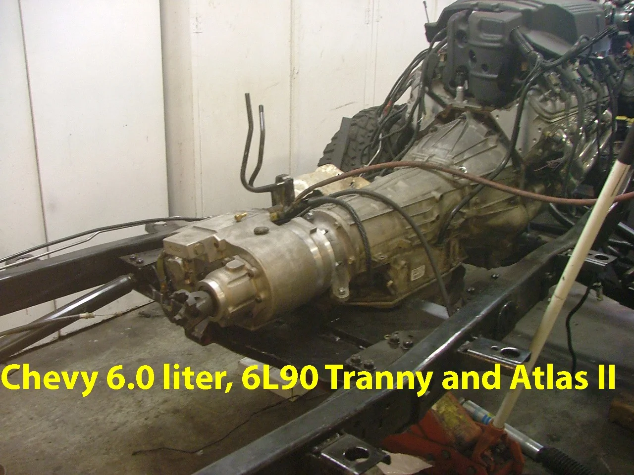

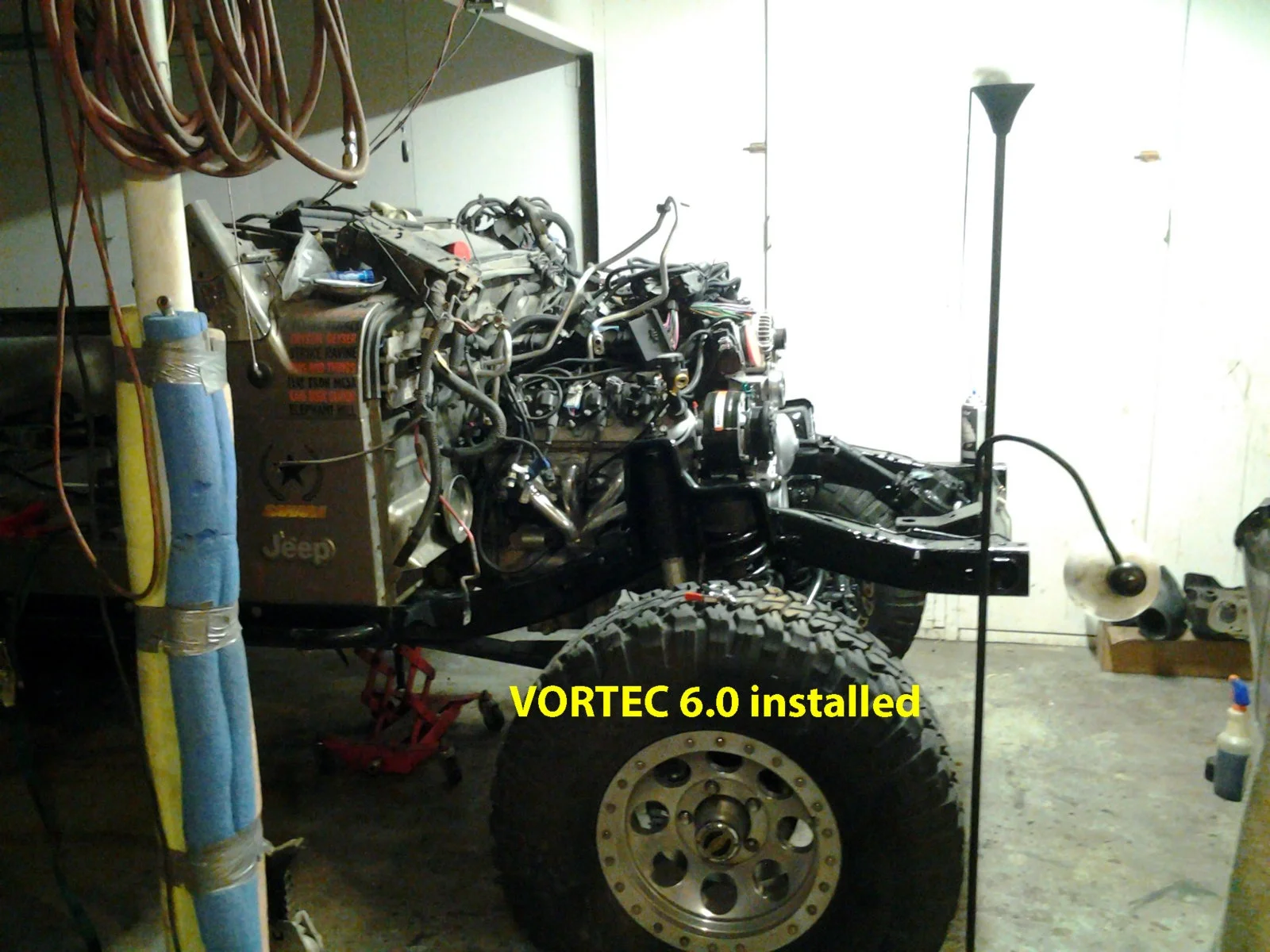

Chris this engine is slightly over 100 pounds lighter than the 4.0. A Cummings would make this 4900 pound rig a real pig! Plus I got a great deal on the truck and I know less than nothing about converting a diesel to a jeep. Plus this jeep is smog legal in Utah. Not sure if I could have pulled that off with a diesel.

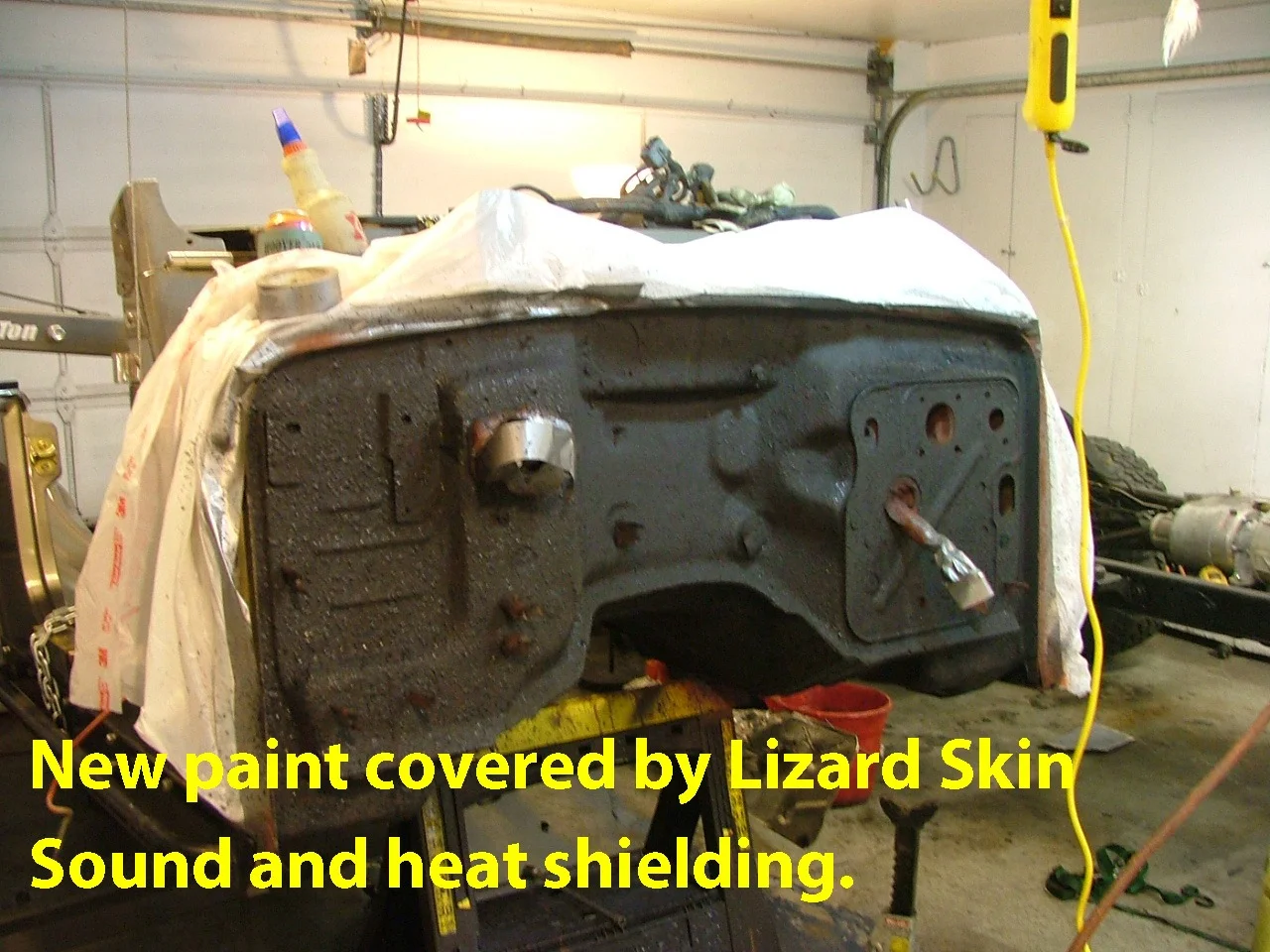

BTW, that Lizard Skin Sound... Is that some sort of sound deadening? Why did you put that on?
I'm just curious because I was thinking about adding some sort of sound deadening to my Rubicon just to make it a little quieter when we take it on highway trips with the family.
Chris the Lizard Skin has two separate products. One, is a sound deadener, and the other is a heat shield. You may use either or, or both. I used both to help with both aspects on my rig. That 6.0 with headers isn't the quietest thing and the cat is hot. Why LS? I had a lot of my initial tuning etc done at Novak in Utah. One of the bosses there had a really nice TJ with a 500+ 6.2 in it. He also has sprayed LS and said it helped in his application!
Thanks! I'll keep this in mind during my build. It would be nice to have something there to keep noise out and heat in / out. I hadn't heard about Lizard Skin until now.

I am still battling a CEL code of 150A so the computer hasn't really learned actual run data. This makes it difficult to get a MPG figure. This jeep is 5,000 pounds with 4:88 gears so mileage isn't going to be great anytime. FWIW at 60 I am right at 2k RPM.
I may go to 3:73 or so gears. With the Atlas and 4:88s my 1st gear is almost useless even going down steep grades.

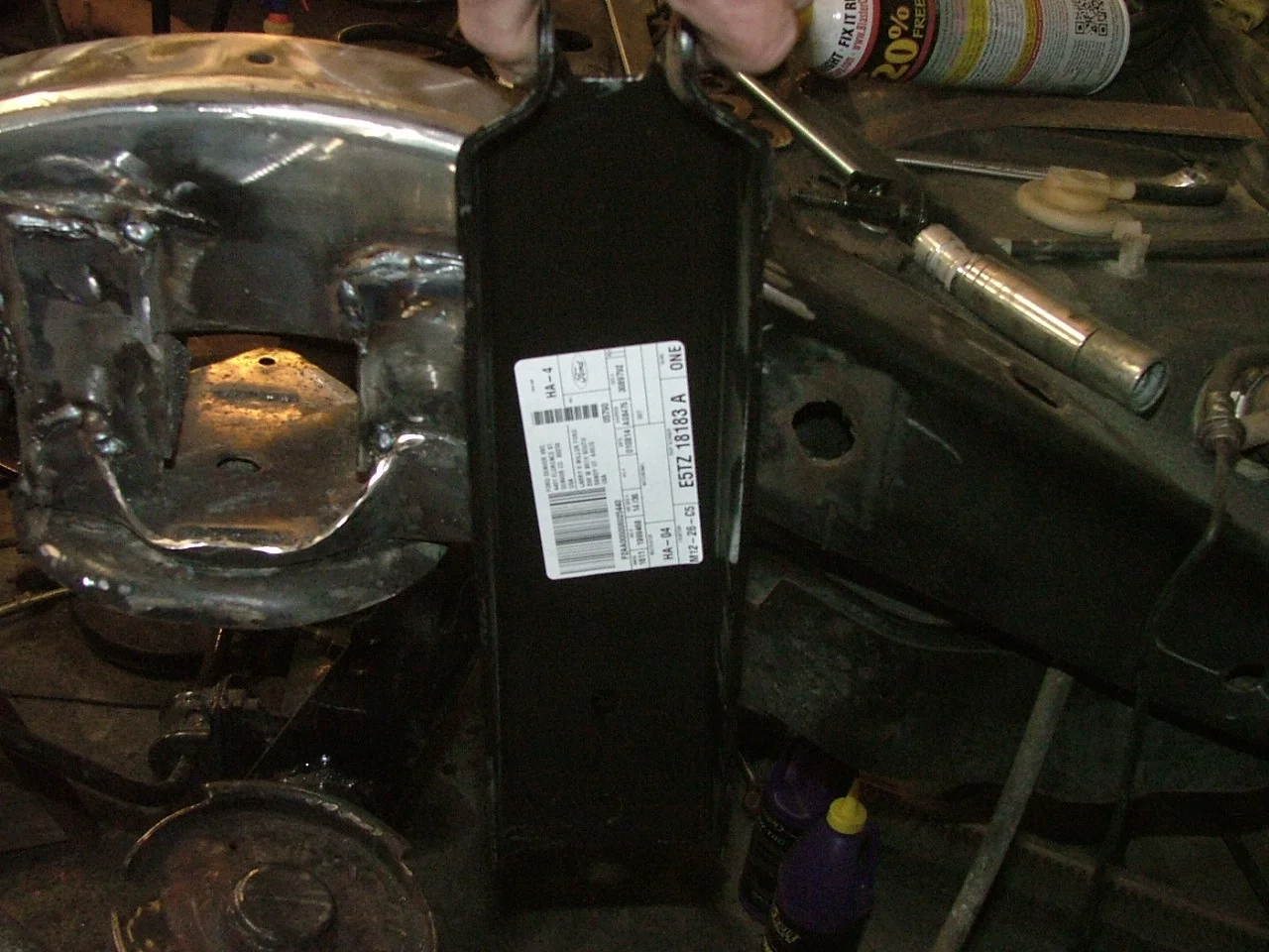

I got my mounts premade from Novak. However it took a lot of time and trial with errors to get them just right. Then for me to weld them in. If you are not going to pull the tub then it makes it a bit easier because you don't have to drop the tub back on for test fitting. And of course you need to mock up the front end to make sure the cooling system will fit. Except for taking the engine to Novak for the first engine harness run and wiring and for towing the whole thing back to get computer issues resolved I have done all of the work by myself. First in Utah in the 2 car garage and now in my new shop complete with a 2 post lift.
This will take time so plan carefully for the down time.
