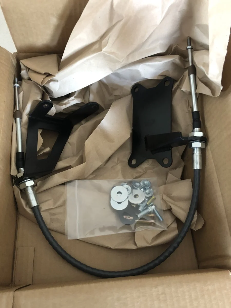

Installed the savvy shifter today! Super easy install. Much more intuitive than I thought it would be just looking at the parts in the box. Shifts smooth as butter now although my stick linkage worked just fine. I’m probably the only one to say this but not sure I would have justified the $170 if it wasn’t necessary for the tuck coming up.
Reactions: JMT
I hate the stock linkage so much, it's so notchy and just a big POS.
Either way, it complements the tummy tuck perfectly (y)
Reactions: starkey480
Haha yeah it’s definitely a POS looking at the design... but mine still worked pretty normally! Definitely welcome the improvement though!
