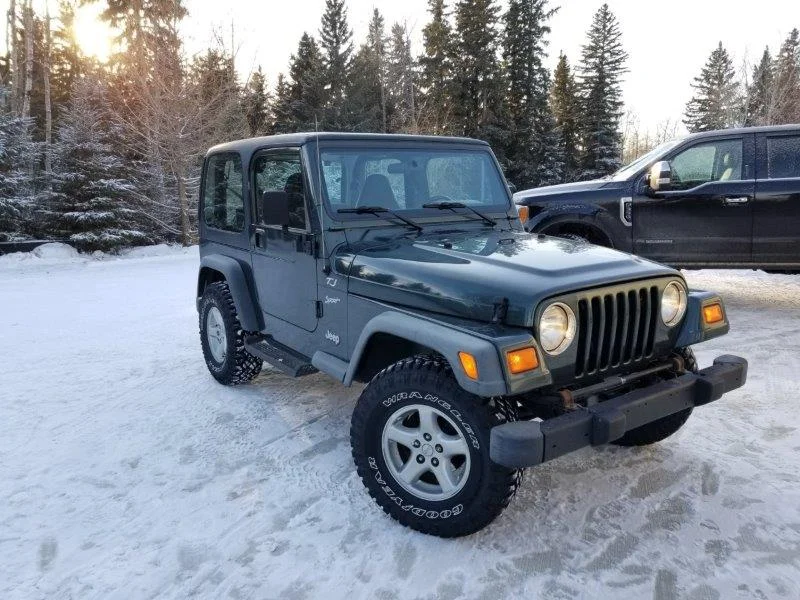

It's amazing how much of a difference tires alone makes in regards to looks. Yours is a perfect example with those before and after photos.
I like your plans though, they're very similar to mine! Keeping it mild, which in my opinion looks good and will perform very well too.

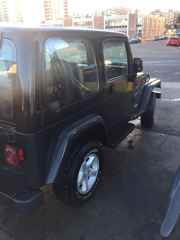

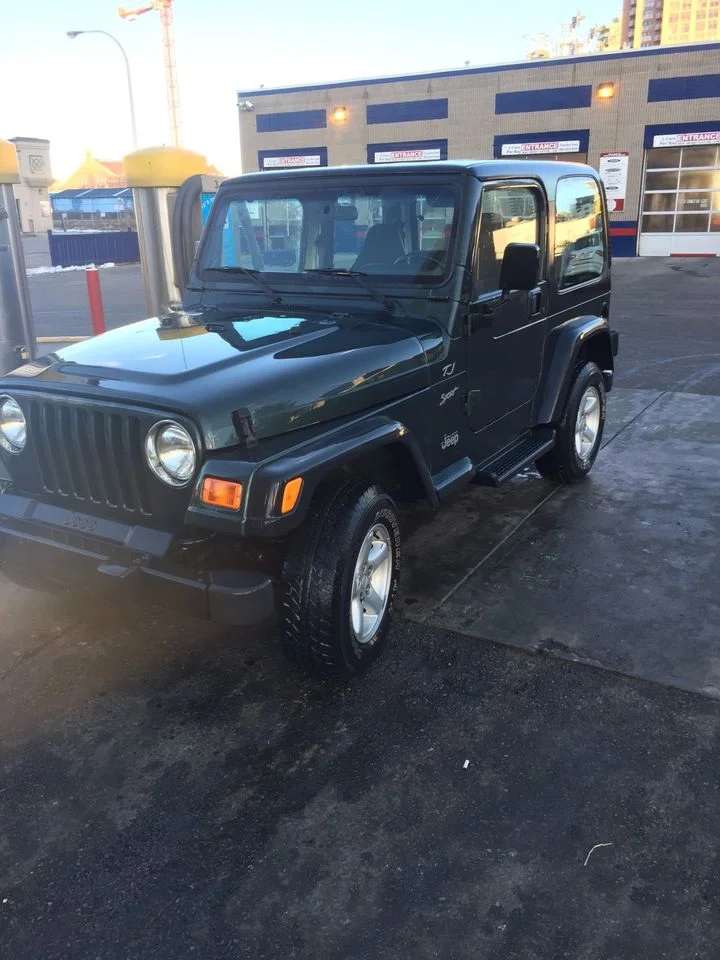

Great color TJ by the way. How come the fender flares are faded in one photo, and look painted in another?
Thanks for the reply. Maybe I will install first and see how far off the axle goes. First I have to get the fuel tank down to trim the skid plate. Any tips on disconnecting the fuel lines so I don't break a fitting on the pump?
The flares are quite faded... the first pictures were taken by the seller and I think immediately after it came out of a car wash so they are wet. I have tried a "restore to black" product with little success... I guess I will just paint them or maybe spray with a bed liner type of product.
