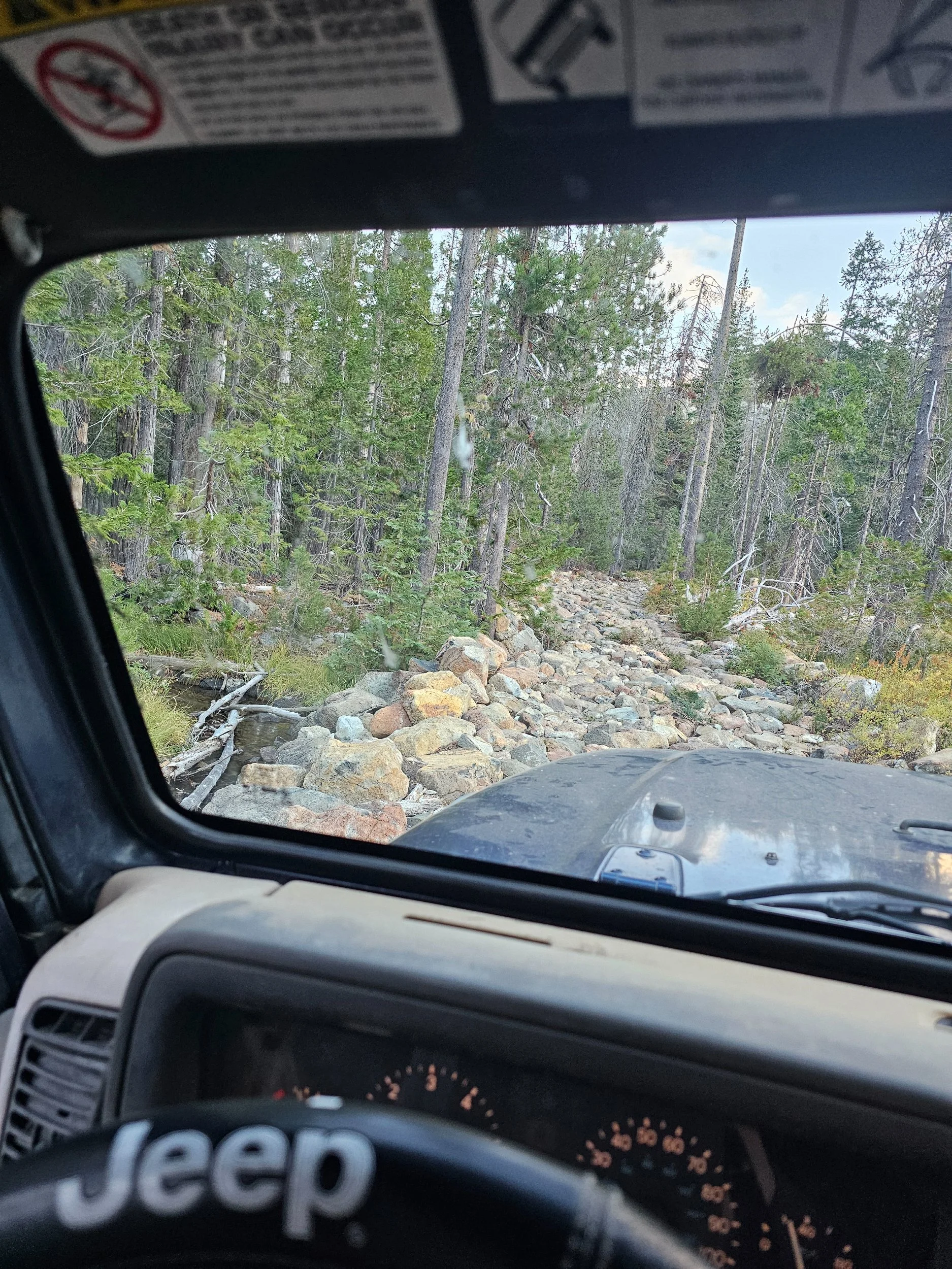

Actually before I fixed anything, while I was waiting for parts I was learning how to drive stick and went out on my first real off-road adventure! To a lake about 40 minutes from my house (and half of that is slow, off-road) that I've never been able to get to before. That tree in my first picture is 500 years old and fell 2 winters ago. That also marks as far as I've been able to go down that road in my daily driver 🤣

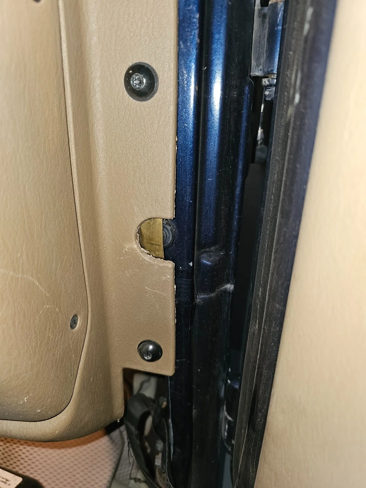

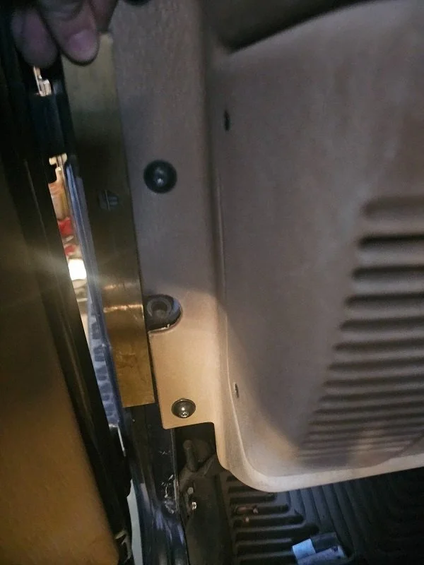

Took me a minute to figure out one of the previous owners installed these pieces of sheet metal over the door light switch instead of just removing the fuse when they took off the doors. I usually like creative fixes but in this case I'm just left wondering why...

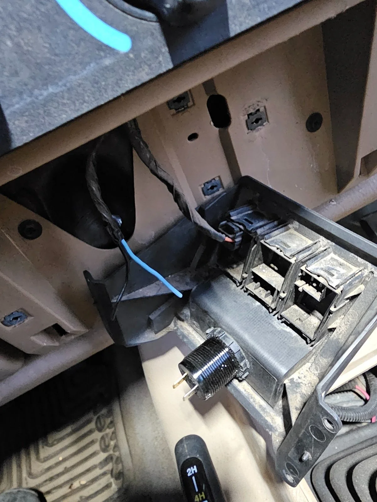

Installed this dual USB port in place of the cigarette lighter that I would never use (Also a question, what is this plug that goes to a blank switch panel? Is my Jeep pre-wired for something that I can easily add?)

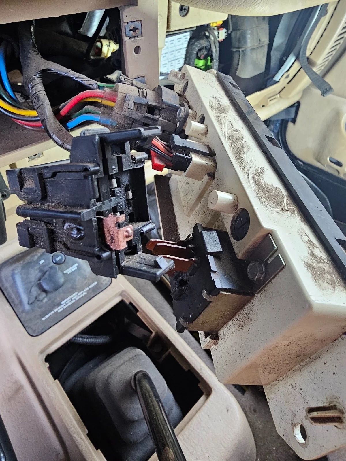

Sure enough as I read about on the forums the problem with the blower motor is a melted switch. I replaced the switch but then I realized I need to order a new connector for it too since it's also melted. I think I'm just gonna go ahead and replace the blower motor while I'm at it because I read that an old worn out motor can cause a higher amperage draw and cause this problem.

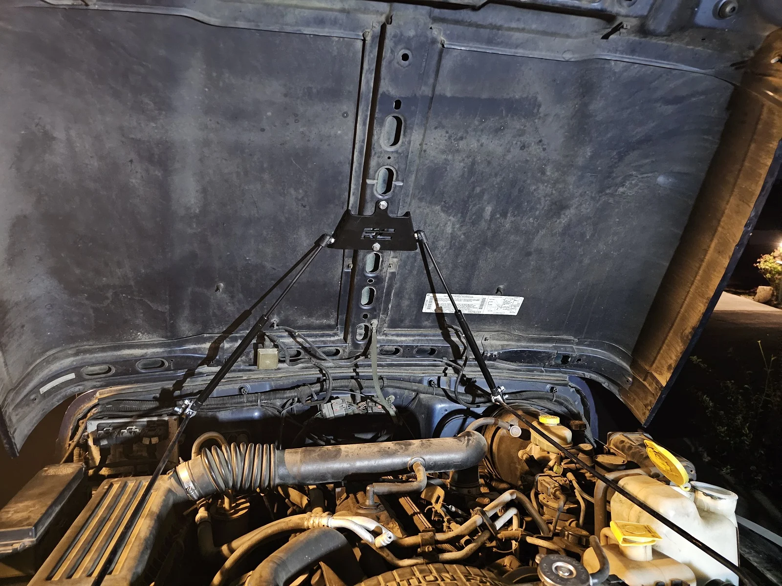

My Jeep came with just a loose hood prop, so I wanted to fix that. I am soo clumsy I am guaranteed to drop the hood on my head if it's not secure 🤣
I found this strut kit before I found a place to buy the prop hinge so I thought what the hell, might as well upgrade it!

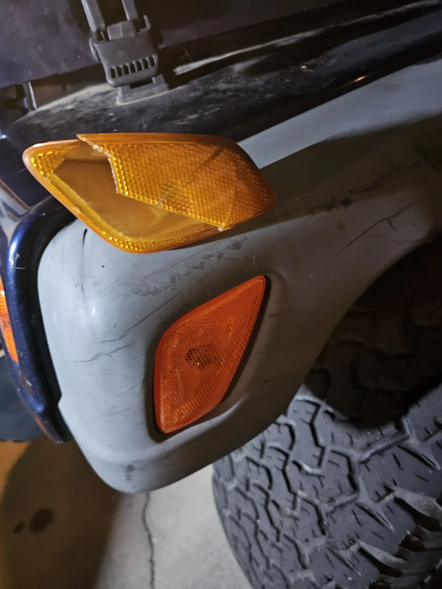

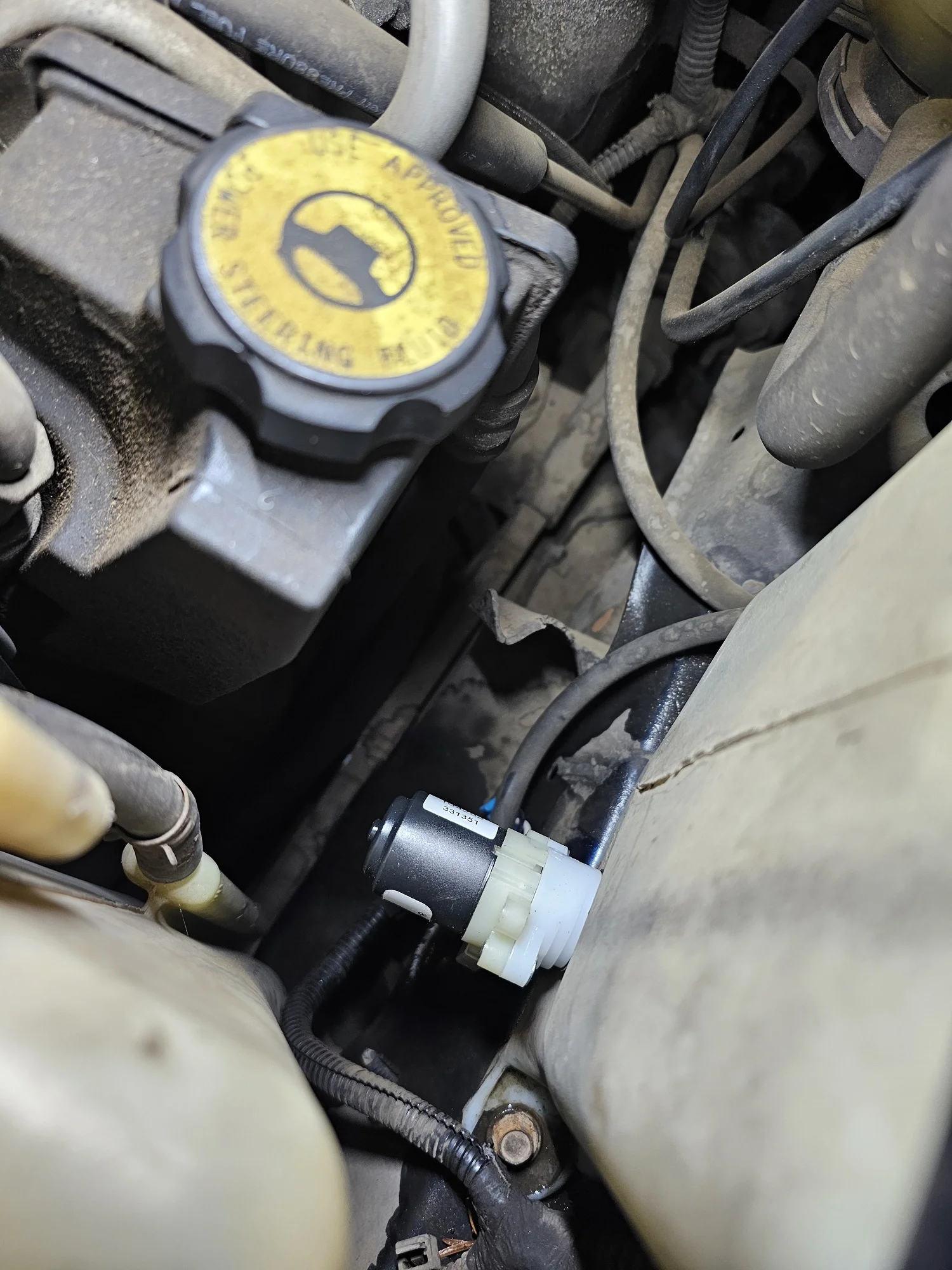

Replaced this broken side marker light for a whopping $2.58! And replacing the windshield washer pump was even easier and cheaper than I expected as well.
