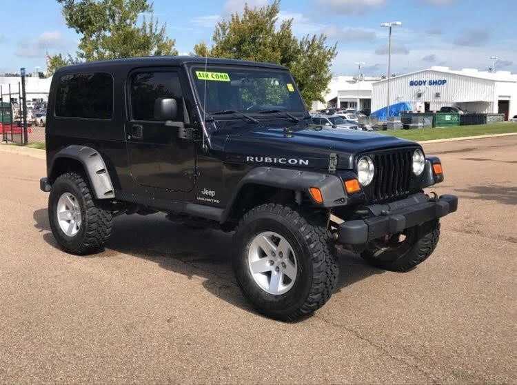

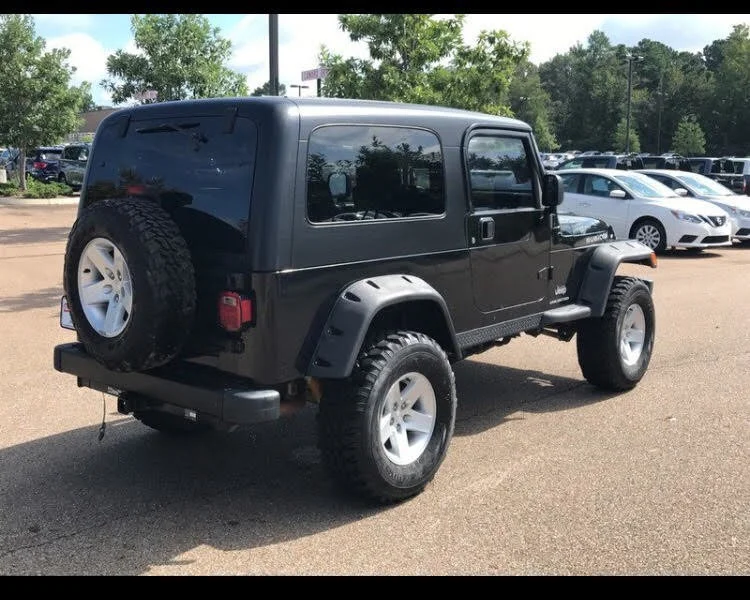

This is how the LJ project starts... I spent a couple few weeks looking around for a LJ Rubicon which is a fairly rare vehicle. I extended my search nationwide looking for an inexpensive starting point. I needed to have a reasonable number of miles, hardtop, and an automatic transmission. I was hoping for a color I could love or black, because black is kinda easier to paint considering the firewall and interior can be left black while changing the outside.
She looks pretty good in the pictures, but for $14,995 I wasn't getting a pristine factory LJ rubi. I expected some issues and my primary hope was finding one without rust. I hate rust and fortunately this one from Mississippi showed up full of mud underneath but not a spot of rust in sight. It also came with dented up hood, cowl, and tailgate. The paint is pretty much hammered and the suspension kit installed was totally junk. I spent a few hours driving it as one day and the handling wasn't great. It has fixed length arms with stock uppers and a t-case skid drop. It was a real mixed bag of poop!
The mud packed in under the rig was pretty healthy as it was previously owned in Mississippi. The good news is we have yet to find rust anywhere on the Jeep despite the mud. Based on the condition of the vehicle I think somebody owned it on a ranch or used it as a hunting vehicle. I've got a friend from a previous job who moved out west from the Florida panhandle Alabama area. Hunting is a right of passage for men in the deep south so I'm wondering if this LJ was used for the same. It kinda looks like Dad bought it used it to get around during hunting season which generally falls into the time of year where you would have mud and muck to contend with. We didn't see a single sign of rock rash under the bottom or on the axles so it looks to have been purely used in the mud. Perhaps it was handed down to somebody's 18 year old man-child who decided he didn't care about the body panels... it looks like somebody stood on the hood and cowl a few times hooking up a winch line to get it out of the mud to me. Either way it was available and a reasonable starting point to get this project going.

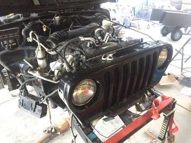

With respect to the build things are going full tilt at the moment. The beginning of the project started with some miscellaneous work to sort a few things out with the computer. The stock computer must have been causing some issues, which I've heard is a problem with the late model TJs, so the owner looks to have swapped it out for a re-manufactured computer. When they did the swap they put in a regular TJ 4.0 auto computer and not one configured for the Rubicon package. That means the locker switch doesn't work like the factory which is hopefully something we can fix. Blaine was also able to get a miserable problem with a factory recall and the wiring sorted out it could be smogged. There was some noise coming from one of the circuits in the wiring which would trip up the computer and keep the monitor on and it couldn't be smogged. As always Blaine sorted it out and was able to get the smog done which was a big win.

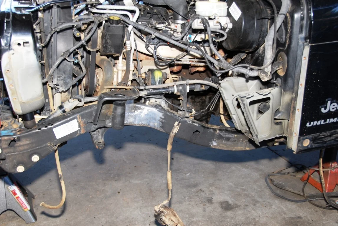

At the moment the Jeep is in full hover craft mode up on jack stands with the suspension having been removed.

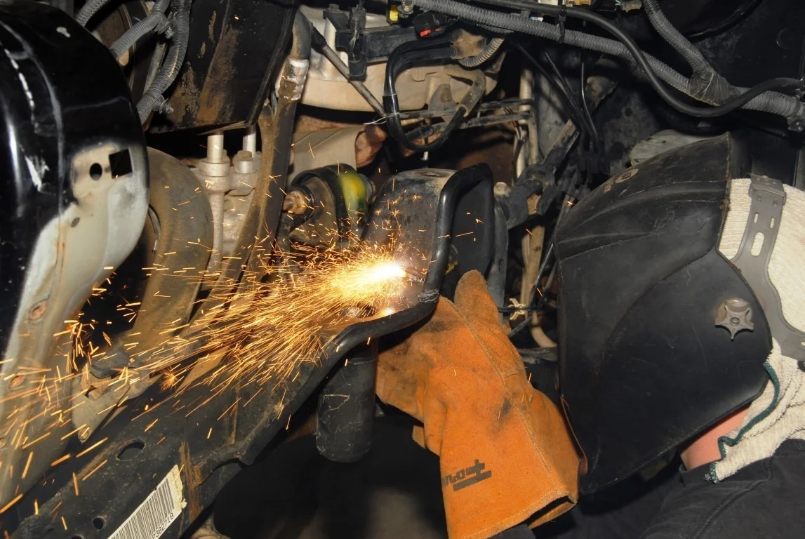

Here are a couple more pictures from the build. I'm really stoked on how clean the work is. Everything is done the way I would do it myself.

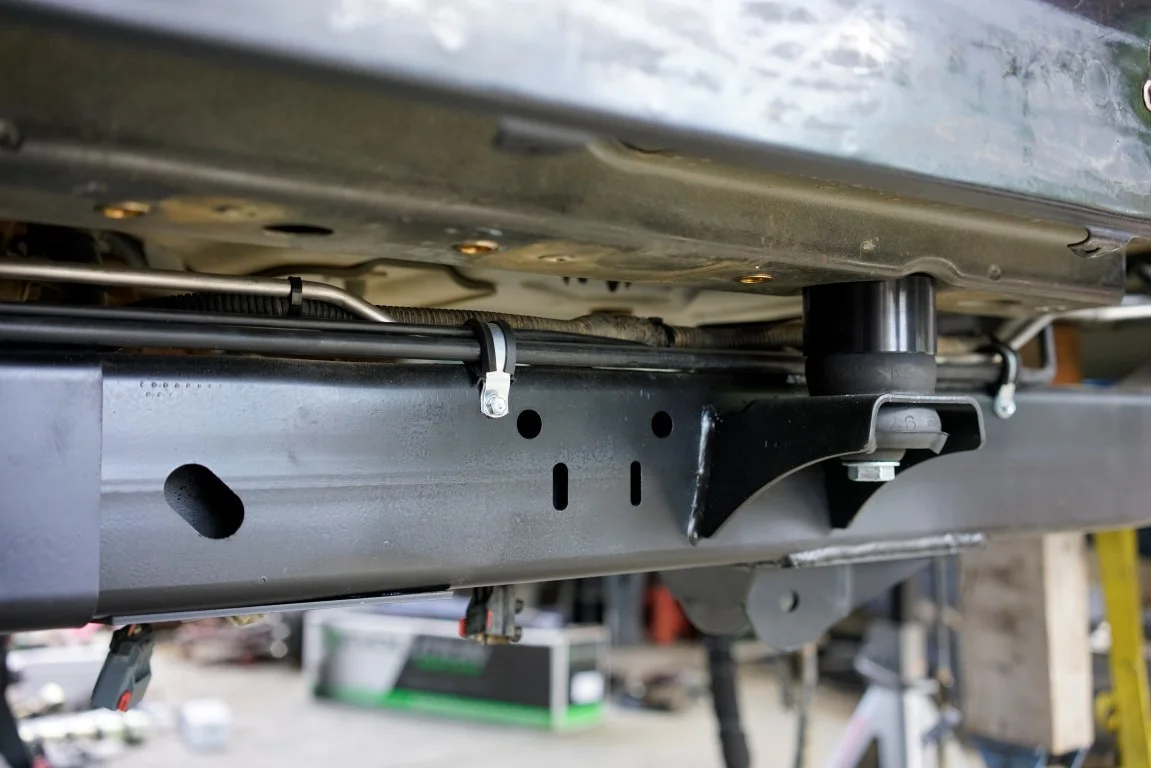

Brake line solution for rear. Blaine moved the line bundle to the top of the frame, straped it in place and then the rear hard line gets bent so the bend is under the brace on top of the frame and then he wraps a 360° circle in it to shorten it without cutting and re-flaring. He can cut and flare but the black plastic coating has to be peeled back which exposes the hard line to rusting. They do cut and flare the older model non coated lines.
Here you can see the p-clips used to route the lines along the top of the frame. All the bits and parts of this setup have been really well thought out as you can see.

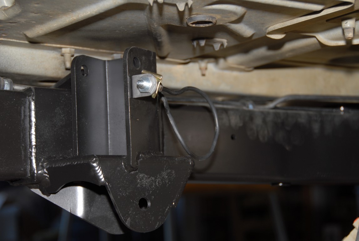

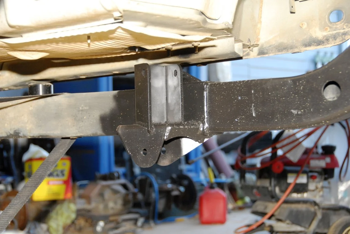

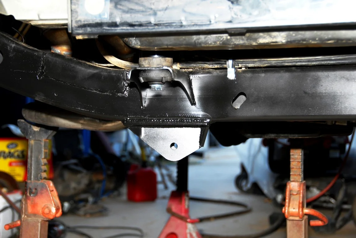

Here is the front LCA mount all welded up. Blaine has done a kick butt job getting extra paint on the frame to keep rust away in the PNW.

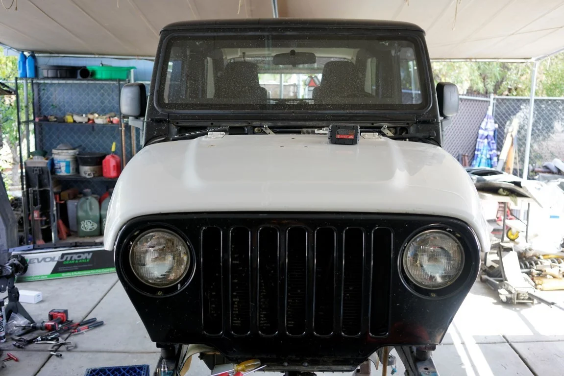

The LJ build continues to march forward with the only snafu having been self inflicted. The hood that came with the LJ was all dented up so I needed to source a new one. I found the white one in the picture below at an auto recycling yard. Turns out I didn't notice a few imperfections when I picked it up. Blaine got it installed and I stopped over to have a look at things in person. Well it turns out the white hood was pretty straight but it had three areas with dents and dings. One of them was a bit of an oil can effect causing the center to pop in and out a little which means it would be hard to fix. It is hard to see in the picture but once I noticed the imperfections in person I couldn't stop thinking about it. I'm a perfectionist at times and just couldn't live with painting an imperfect hood. Naturally I'm also a moron sometimes and realized I never called the dealership to see if they could get a factory new hood. Turns out the local Jeep dealership was still able to get one and they could have it the next day. Live and learn... so I bought the factory fresh one and will have that installed and painted. The other Green TJ I mentioned at the start of this post has a pretty dented up and paint faded hood, I might end up being able to put the white one on the Green TJ. Duplicolor makes a factory matching spray paint for the Green TJ and I used that paint to do the steel highline fenders and rear corner armor. It has lasted well over almost 10 years so maybe the white one will end up being useful.

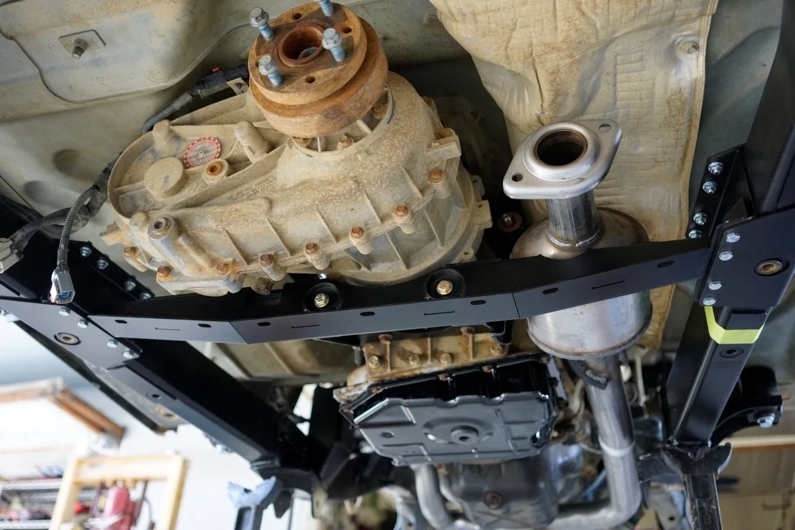

Blaine was also able to get the new cross members installed at the transfer case. I'm going with the off the shelf Savvy engine and belly skid. This Jeep isn't going to see hardcore use on the rocks for at least 5 years which is the period of time I plan to use it as a daily driver. Blaine builds a really nice heavy duty belly skid out of 3/8 aluminum but it wasn't necessary for this build. If I was going to play at the Hammers I would go that way.

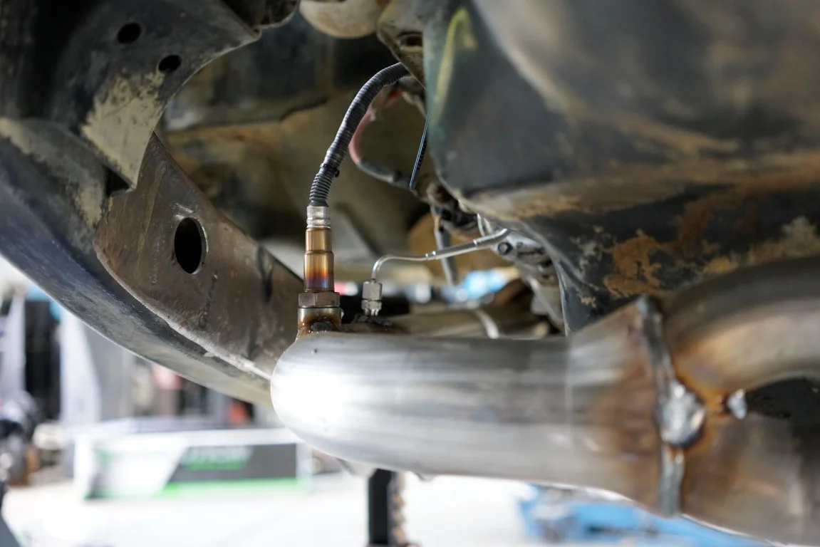

Sure enough one of the most common things to fail on a late model TJ are the catalytic converters. The LJ came with exhaust which was marginal at best and on the way to total failure so it was a good idea to replace it. Especially with the planned forced induction from a supercharger. You can see the two sensors which have been added as well. These are for air-to-fuel ratio and exhaust gas temperature to help tune the fuel map when in boost.

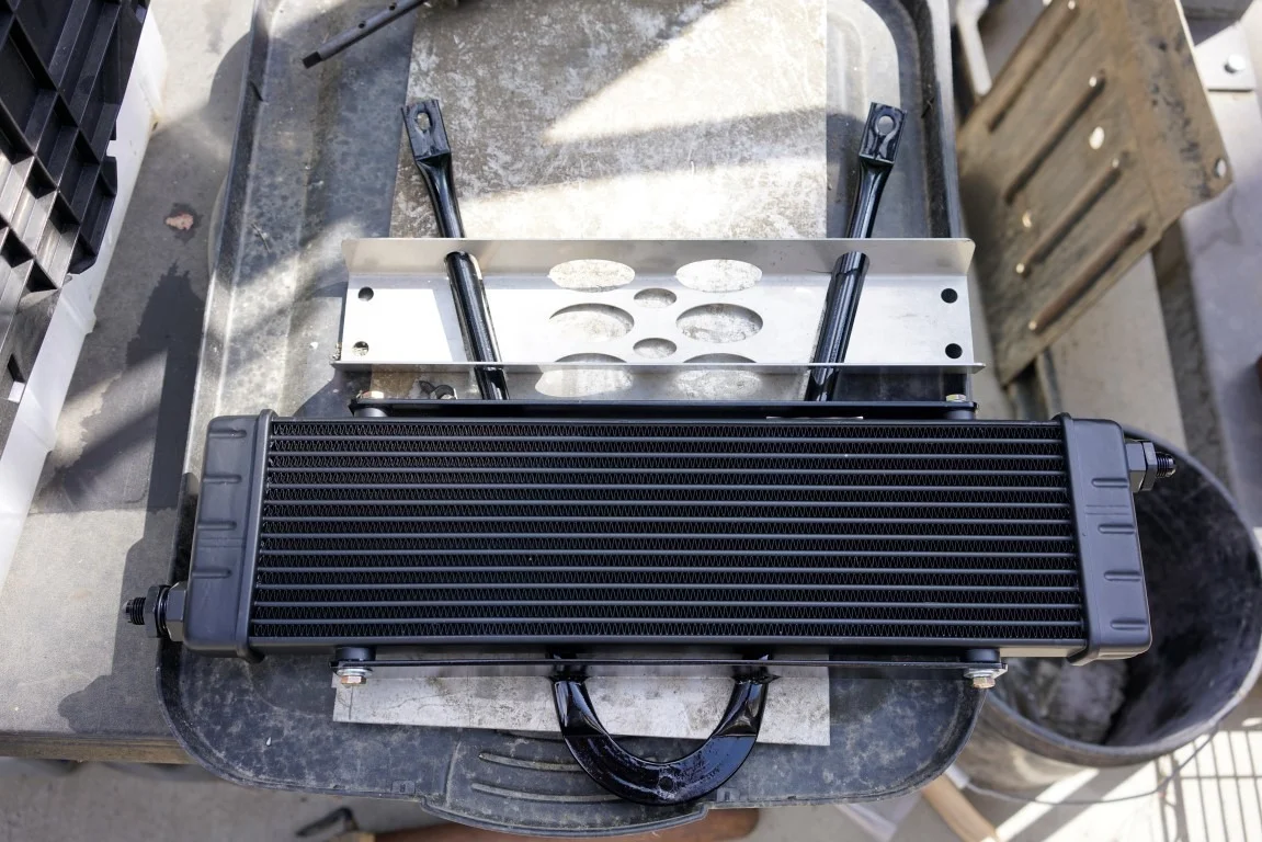

The automatic transmission is also getting a nice cooler and a temperature gauge to keep an eye on it. The cooler will live in front of the radiator in the grill area.

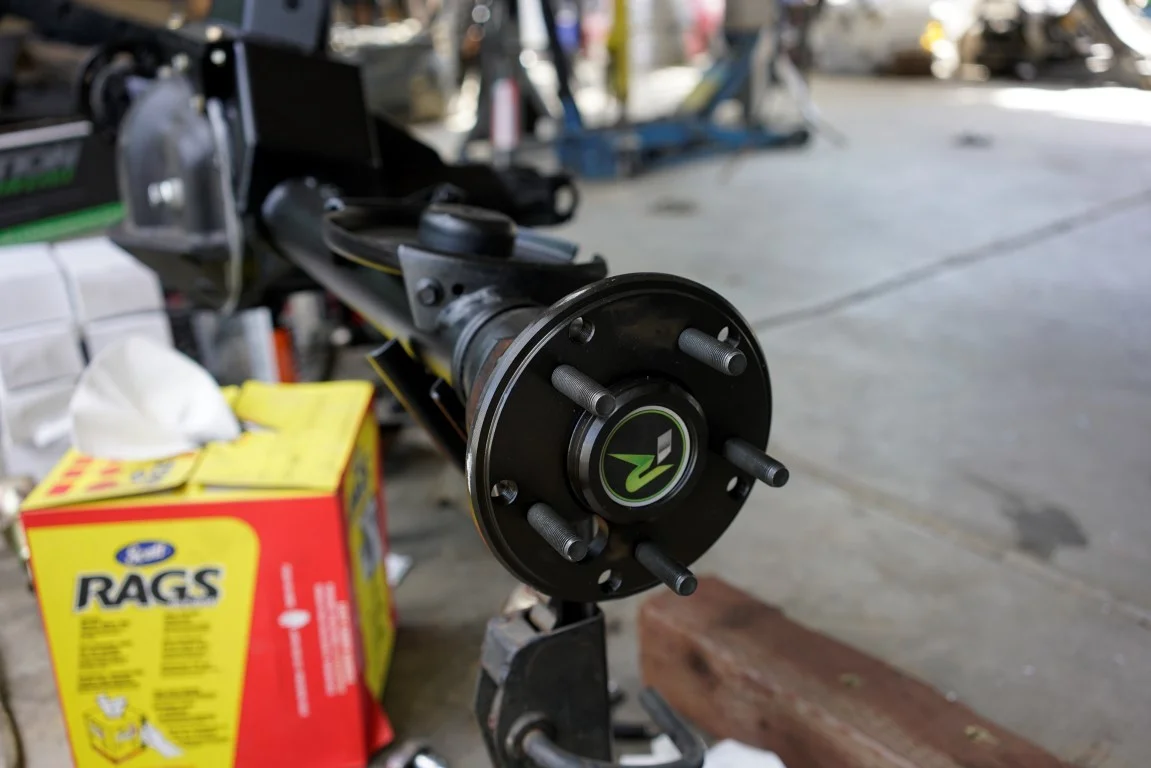

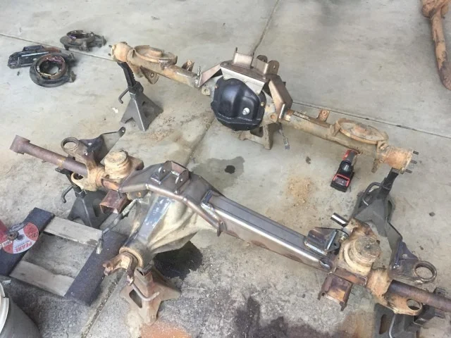

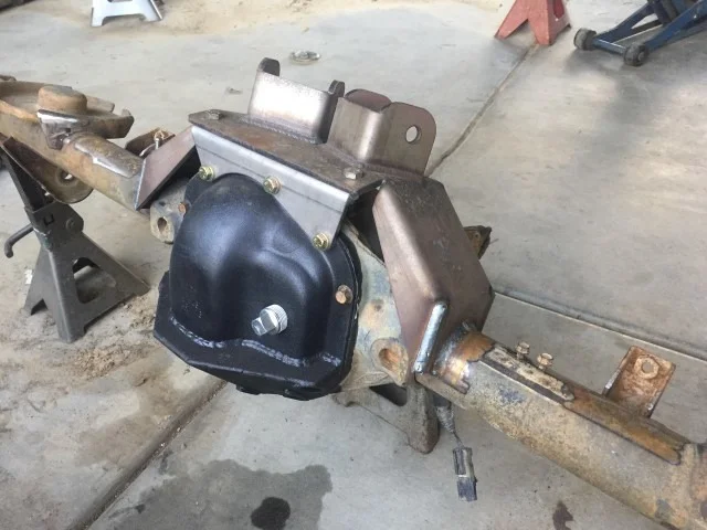

The rear axle is coming back together as well and was painted up. It has been geared to 5.38 which works best with the automatic transmission. Blaine has done testing between 5.13 and 5.38 with 35" tires and the automatic transmission. He finds the 5.38s are the best with the automatic but would choose the 5.13 in a stick shift application. Again, another reason to work with somebody who has personally tried every combo of parts under the sun.
The rear axle also got a nice set of alloy shafts from Revolution.

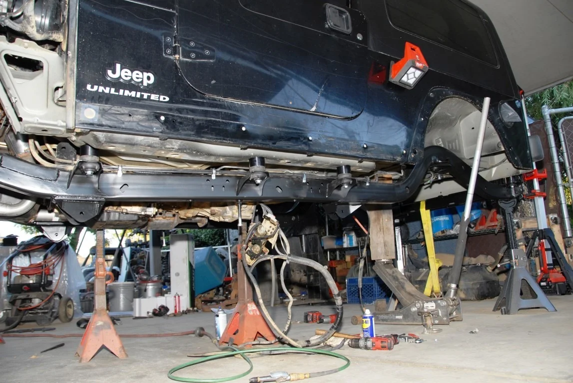

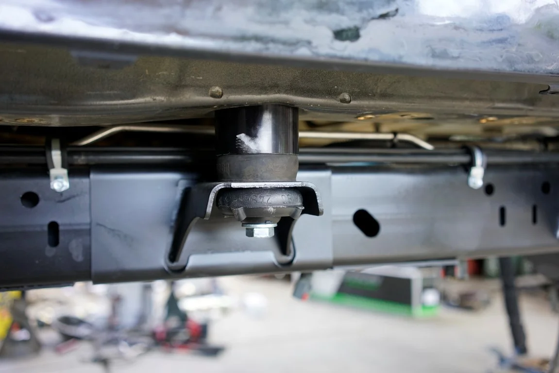

Here are a couple shots of the new cable routing and body lift. I really like the way Blaine has designed the body lift. It retains the factory duromter bushings and adds a spacer. On other Jeeps like the Green TJ I've used various body lifts. The ones in the market all change the durometer to a stiffer bushing. When the rig is used hard and the suspension is cycling it tends to put more stress on the body tub. The Green TJ has had the tub bent around enough by the stiffer bushings to cause the doors to need some shims/spacers at the hangers to get it to latch and shut. I'll go with the MrBlaine design for any future builds. Savvy sells them.

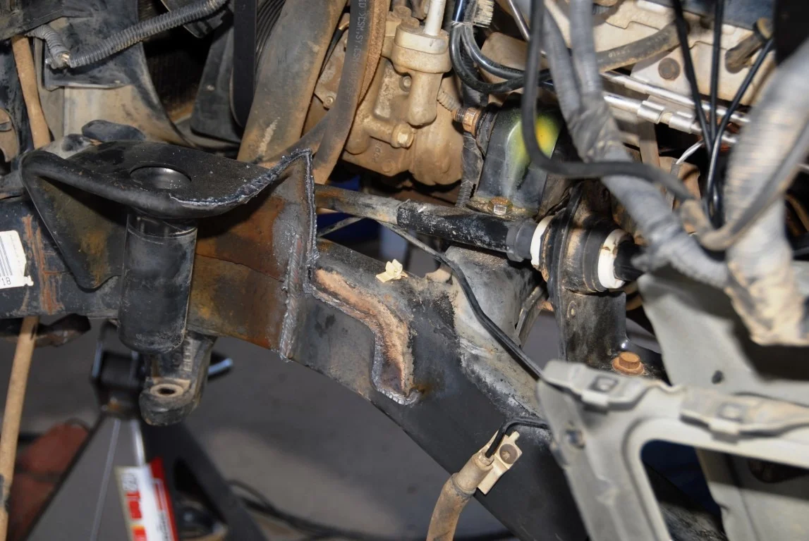

Here is the pile of parts removed from the Jeep and heading to the recycling bin. The joints on the lower control arms are totally shot and have quite a bit of free play in them. Having tried a number of things the only joint I'll use on any Jeep is the Johnny Joint from Currie. Just don't waste your time on marketing hype and experimentation with something otherwise. The JJs have been bullet proof on KOH race trucks so I just don't see the justification to try anything else. If it ain't broke don't fix it!

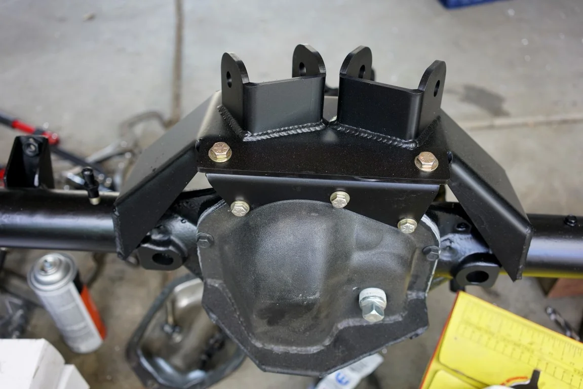

Bitchin so far! Blaine lays down some nice welds. Question: How do you get the rear diff cover off and back on? Does that bracket flex out of the way?
The truss brace unbolts from the cover bolts and the two bolts that hold it to the back of the truss and it is fully out of the way for any maintenance work inside the diff.

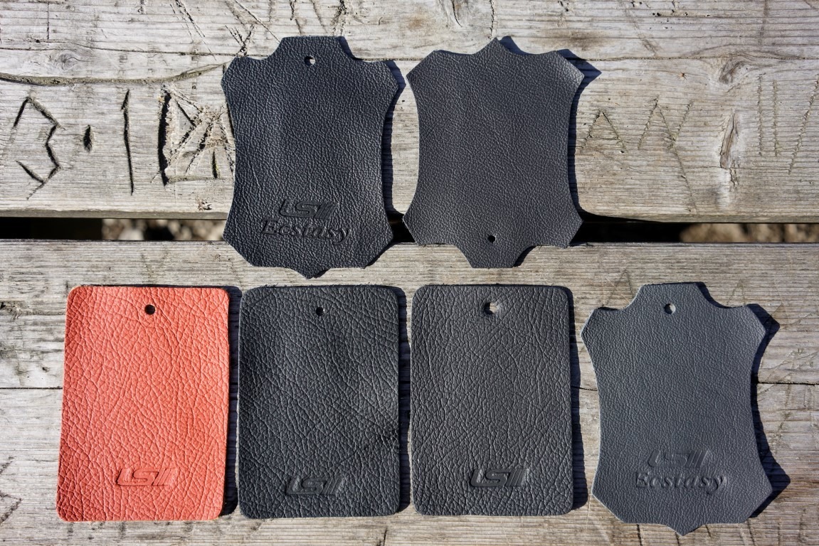

For the seats I'm going to buy a leather kit from https://wrangler.leatherseats.com/
They are reasonably priced and the seats need a going over anyway. Since we are living in a colder climate at the moment my better half will really enjoy some seat warmers so I was planning to rebuild the seat anyway.
I'm looking at using the orange color to match the desired Impact Orange paint on the outside of the rig. Then using the off black charcoal color which is the lighter of the shades in the green grass picture. The inside of the rig is black so the off black charcoal will add a little bit of contrast and give it a custom look.

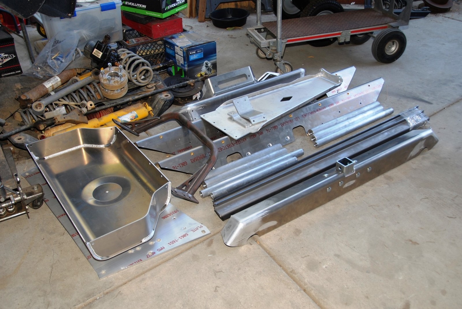

This pictures is sweet... a pile of MrBlaine designed parts from Savvy going out to powder coat. Look at the detail in the gas tank skid between the planned weld gaps, dimple, drain, etc.
They are getting coated with a black color recommended by Blaine. He has tried a number of things. It won't be a full gloss when new and retains its appearance better over time. Bumpers and skid plates live a hard life. The control arms are getting coated as well to keep a low key look. Factory arms are black and blend in from a side view at a distance.
I'm a little OCD about trying to have this look factory enough at first glance that the average person wouldn't think twice about it. The aluminum part of the rock rails had all the edges broken over and sanded neatly to prep for powder coat primer and then automotive paint. The steel part is going to be black like factory. The factory Rubicon had the stock rocker guards which are only a couple inches tall. There is a distinct body color paint gap between the bottom of the door and the rocker guard. I feel that is a necessary part of the sleeper look and plan to have the taller aluminum part painted to match the body in Impact Orange. That way the black section is similar to the factory size and shape.

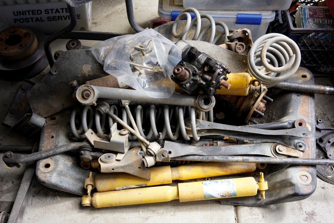

Do you have plans to surpass 35” tires on the dana 44? Curious why the Dana 44 was trussed, not against it, just curious :D.
