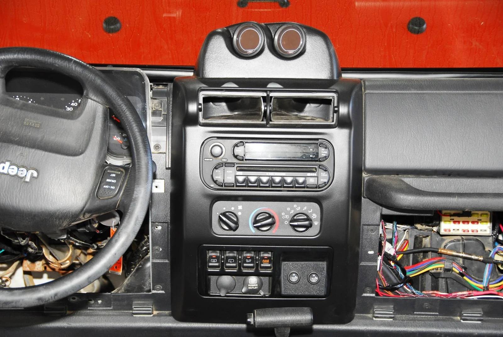

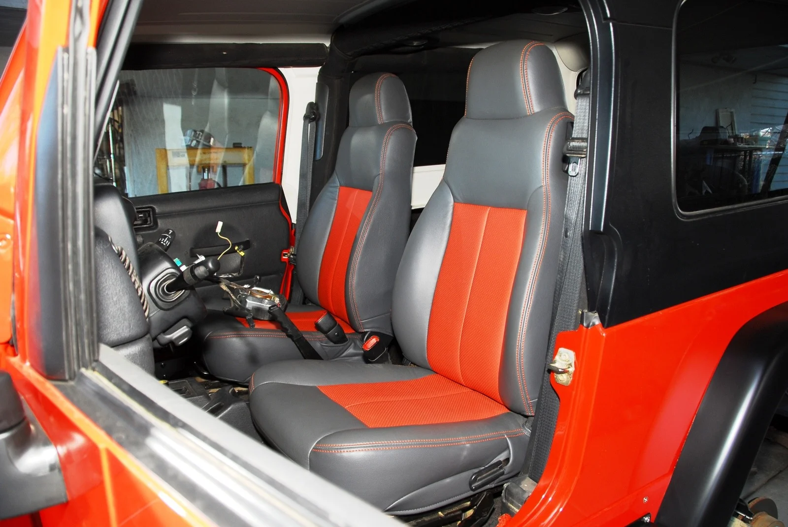

What kind of seat covers are those?
Leather full replacements with Dorman upper and lower seat heaters. I built a small face plate panel and mounted the switches over some crappy holes that held crap switches. We also molded in the gauge pod so it looks like it is part of the factory center bezel and I painted it afterwards. It has exactly the same textured finish that the cluster bezel does.
Leather full replacements with Dorman upper and lower seat heaters. I built a small face plate panel and mounted the switches over some crappy holes that held crap switches. We also molded in the gauge pad so it looks like it is part of the factory center bezel and I painted it afterwards. It has exactly the same textured finish that the cluster bezel does.

We wired in keyless entry with door lock actuators and contact buttons, seat heaters, Split Second box, 4 gauges, Oil temp, AFR, Boost, and EGT, switched aux power for all of those, under hood lights, Jet Accuspeed, and we did not solder a single connection. To sorta put that in perspective, there are 12-15 new grounds and it took 5 relays to make the keyless entry work.

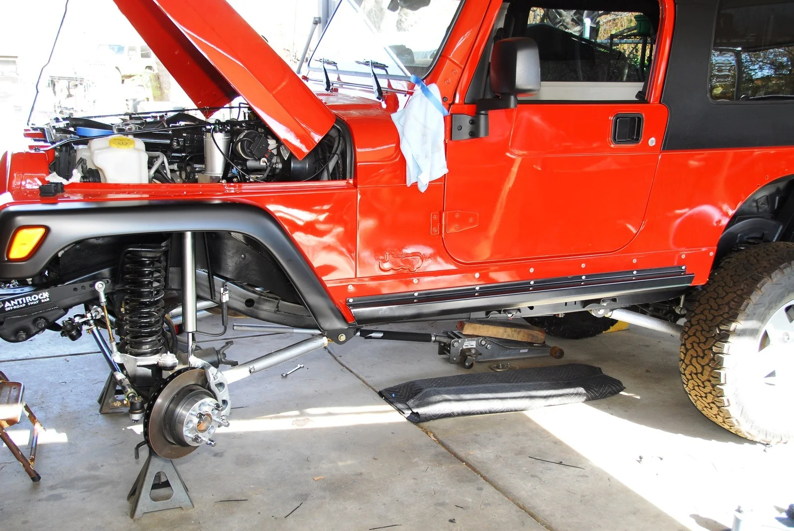

It is certainly the nicest one I've seen or been around. At this point, there isn't a single thing I would change. The color scheme is balanced with a nice contrast with just enough stainless fasteners showing to make the chrome headlight bezels belong. The rock rails are the best looking we've ever done.

It’s a piece of art. What rock rails did you install? Savvy? It’s interesting the paint scheme. I had already decided to do the same scheme come May. I really favor keeping the OEM paint color up teh sidewall, then a textured black or dark gray, or perhaps satin silver on my flame red. What you’re doing looks great! Some great work all around.
