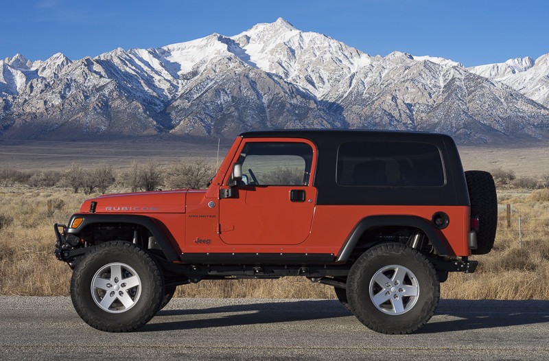

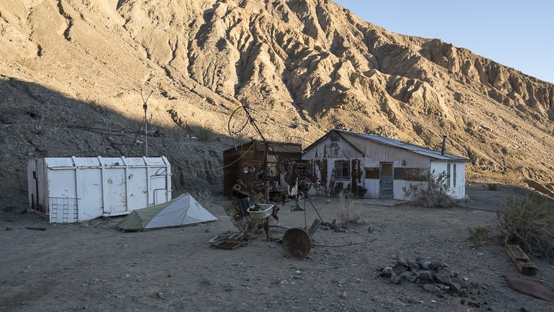

On the last morning we made a killer breakfast and rolled out of camp. I had some serious miles to drive. Our remote desert compound was a pretty glorious home while we stayed, until next time.

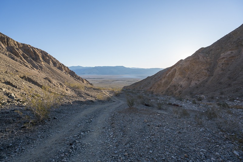

On the road again...
Finally back onto some pavement after a million miles of dirt roads. HWY 395 in CA is one of my favorite scenic drives. It was fun taking it north in the LJ with the view of the Sierra Nevada range along for the ride.
