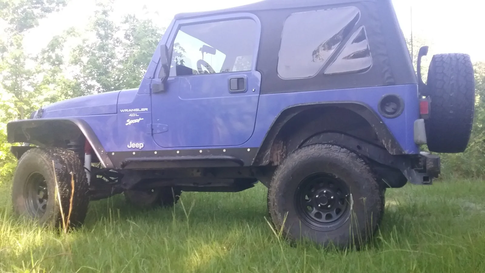

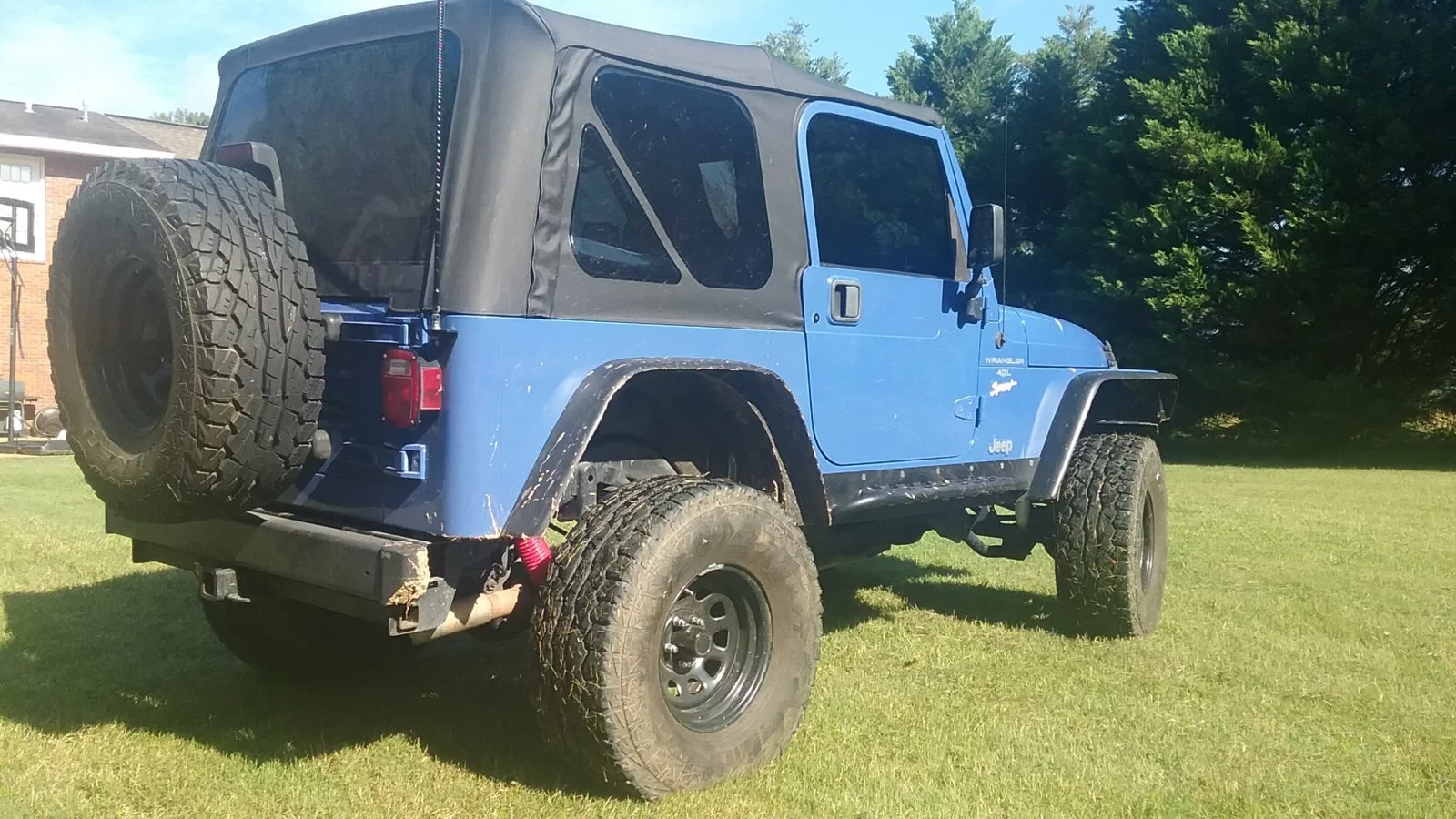

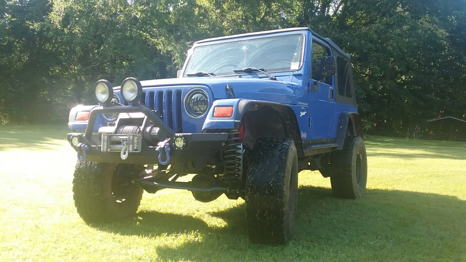

So about 1&1/2 years ago i bought a 5 speed 97 tj. It seemed to be in perfect shape and had a new 6cyl installed along the way of its life. So I figure it now has about 12,000+ on the engine. It came with a rough country 4" lift and falken a/t 33x12.50x15 tires on some steel procomp wheels. It had also been regeared with 410 gears (but little did I know the gears in the rear had to be replaced due to a poor install) so at that time I took it to a very trustworthy shop and had new everything put into the Dana 35. It runs great now!! and till this day I have not found one rust spot.
Along the way so far these are the things I have added. My son drives it about 14 miles a day back and forth to school and we are always in it on trails (very light trails) most every weekend. So its a daily driver and I want it as best as I can have it for any trail around MS, AR, & AL, but probably wont be mudding it or on extreme rocks for sure. So here are the things iv done so far.
Front bumper with warren winch and D rings,
Home made rear bumper with swing out tire carrier.
New led lights,
Aussie locker in Dana 30 ,
Beefed up tie rod and tie rod ends From 4door Jeep
HD-front adjustable track bar,
Savvy upper rear adj control arms,
Core 4x4 lower adj control arms
New soft top,
New radio and speakers,
Rock sliders,- Stout Fabrication
extended front and rear brake lines,
new rancho shocks RS5000x I cut some 4" fender flairs down to make flat fenders.
CB radio and antenna
Ford 8.8 w/4.88 gears , OX Locker , Yukon super 8.8 kit (C clip eliminator)
Chromoly Axles
Tera-Flex super short SYE & Adams CV drive shaft
Currie AntiRock
D-rings
rear adjustable track bar w/ johnny joints - Core 4x4
Goodyear KO2s MT 35" & Interco SS SX2s (35x 13x15) f wheels
1.25 body lift Savvy
1" Motor mount lift blocks
Belly up skid plate
Savvy aluminum Gas tank skid plate
New Bosch fuel pump
(Doors off)-mirrors
Grab bars
fire ext. recovery rope, snatch block, tree saver
M.O.R.E. ,transmission & oil pan skid plate
steering box & dana 30 dif skid plate
