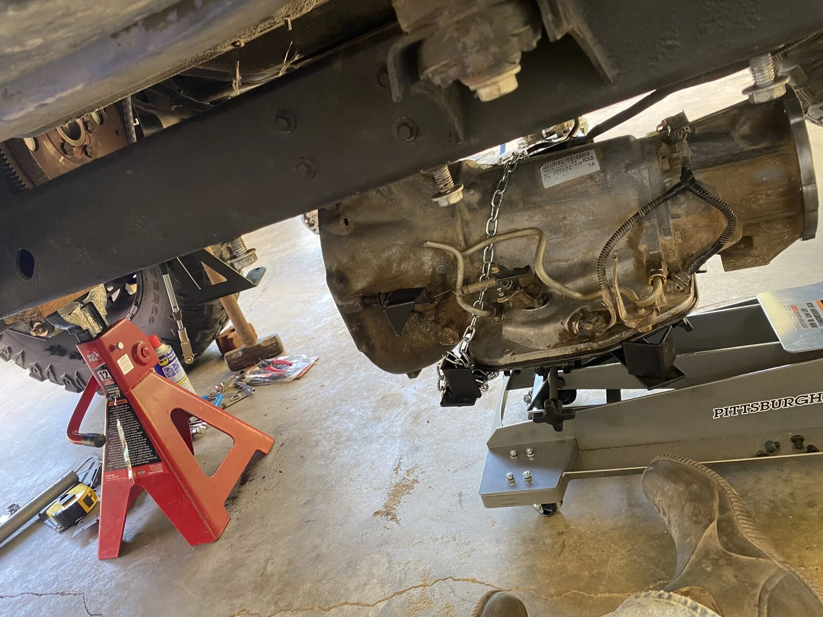

At this point I’m getting things together to install a 32RH transmission & out boarding shocks. & maybe adding high line fenders.
Reactions: Vasq
This was something Ive been wanting to do for some time now. Reason is because I’m really wanting to see how it works on the trails. Just in the past 2days that I’ve had it back running , it has been such a rush ! I’ve been like a kid in a candy shop.
I still have a little fine tuning and modifications to do , but it has been so nice to start a huge project (in my eyes) and complete it ( with some awesome help from this forum) . What a rush ! If you have any questions please ask.
PS adjusting and testing the kickdown cable is a lot of fun. Just ask.
Glad it went good for you. I've never dealt with the 32RH so I couldn't help. It's looking really good.
How do you like it with those new tires?
So a Super 8 install and now a manual to auto swap. What's NEXT? Time for a V-8? 1 tons?

Probably a 44 in due time plug & play
Tires are great and also have the SX2s also.
the auto is awesome
