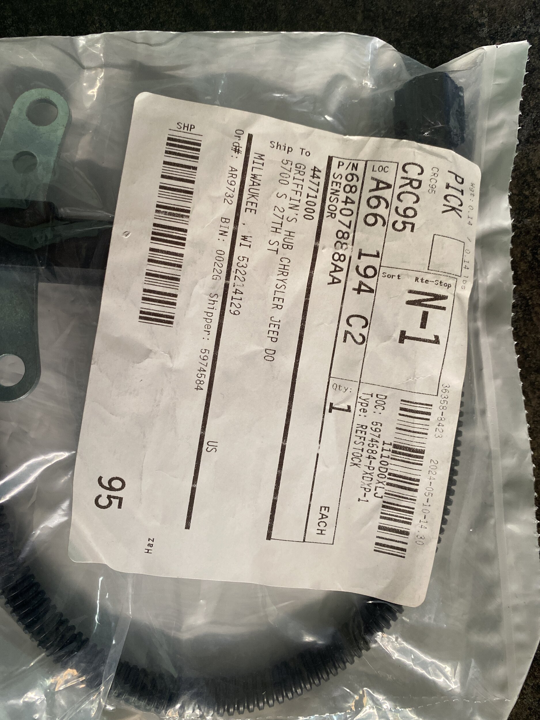

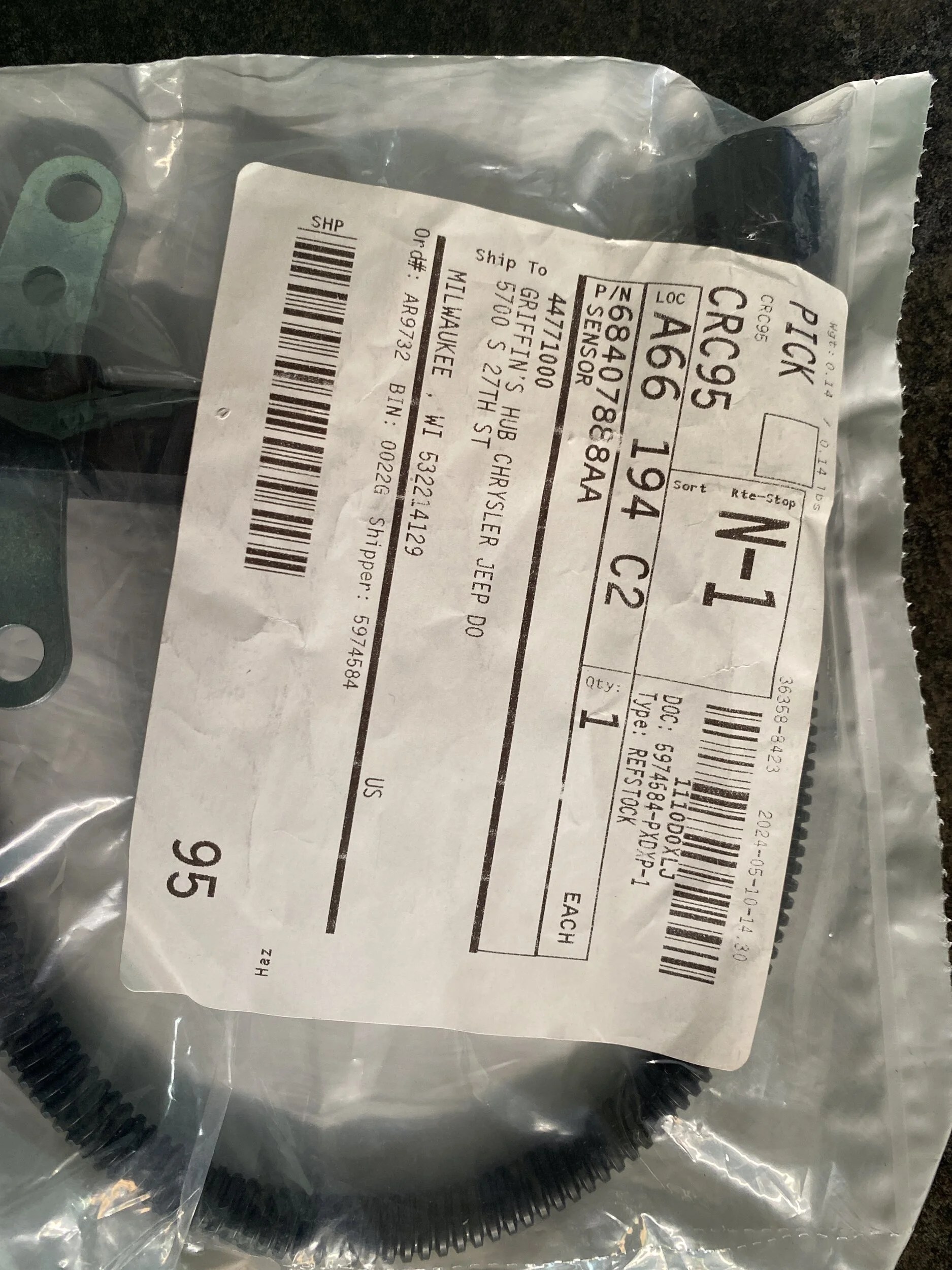

I went ahead and ordered a Crank Sensor from Rock Auto Part# 56027865AB Mopar# 68407888AA 120.79 (just an FYI for anyone who was looking) Allegedly its a Mopar part. Should have that today.
After I dug around under the hood some more the Napa Crank Sensor appears to have stopped sending a signal to the PCM. I now have a no crank ref signal at PCM code... So we'll see how the Mopar part fares. Hopefully it solves the issue, walking everywhere has become tedious.
Just arrived going to throw it in shortly.
Ok, installed new mopar crank sensor. Ran perfect to operating temp. And back to existing problem. Runs for a few seconds sputters and quits like the key is turned off.
