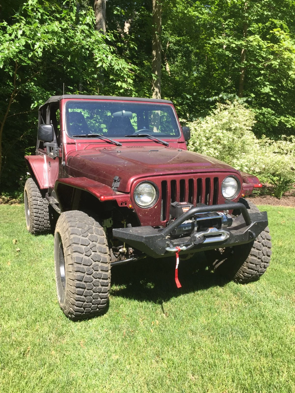

I did have the axels / gears redone. I hit the wall with my mechanics skills and wanted to wheel the thing. My pride may be bruised a bit but he did a good job for me. I installed my winch this afternoon and am just about ready to roll.

Metalcloak overland fenders. They claim you can run 35s with no lift. My first easy wheeling trip revealed slight rub in front at full stuff. I may need to add a bit more bump stop. My plan was to keep it as low as possible with 35s. Time will tell if it works.
