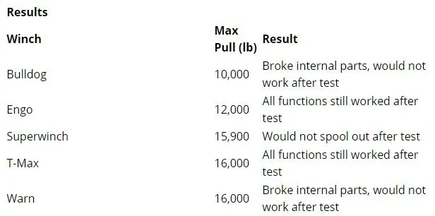

Warn may be the best and wonderful, but, for the price I can carry 2 more spare winches and still have cash left over for lunch. I have a cheap Engo winch that I put on 6 years ago and always works when I use it despite always being in the elements and never any type of service or oiling. Used it last week to pull an engine out of a pickup. Bought it after reading a 4-Wheeler winch shootout article from around 2011 where all winches failed except the Engo, although they still named Warn the winner because it was faster or some other ambiguous reason. I don't contest anyones' beliefs in their Warn winch, just saying that for the price, it is not the best choice.
What you left out was that the Warn 9.5xp (9,500 lb. capacity) only failed after being subjected to a 16,000 lb. load. Engo's max pull was 12,000 lbs. where it stalled. They kept the 9,500 lb. capacity Warn pulling until it finally failed at 16,000 lbs.
This was copied directly from 4Wheeler's Winch Shootout article.

You're right. Having read many of your comments I highly value your opinion. But, the Engo lived to fight another day. The Warn didn't know it's limitations and died.
