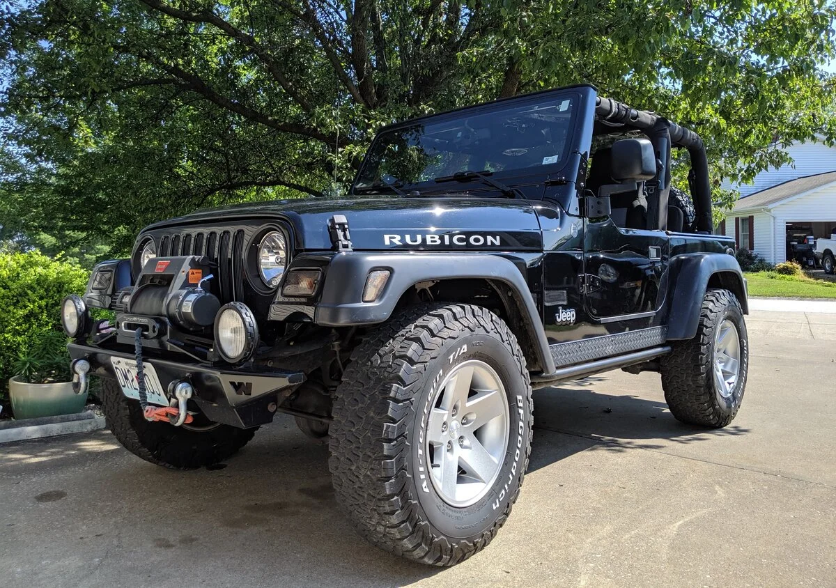

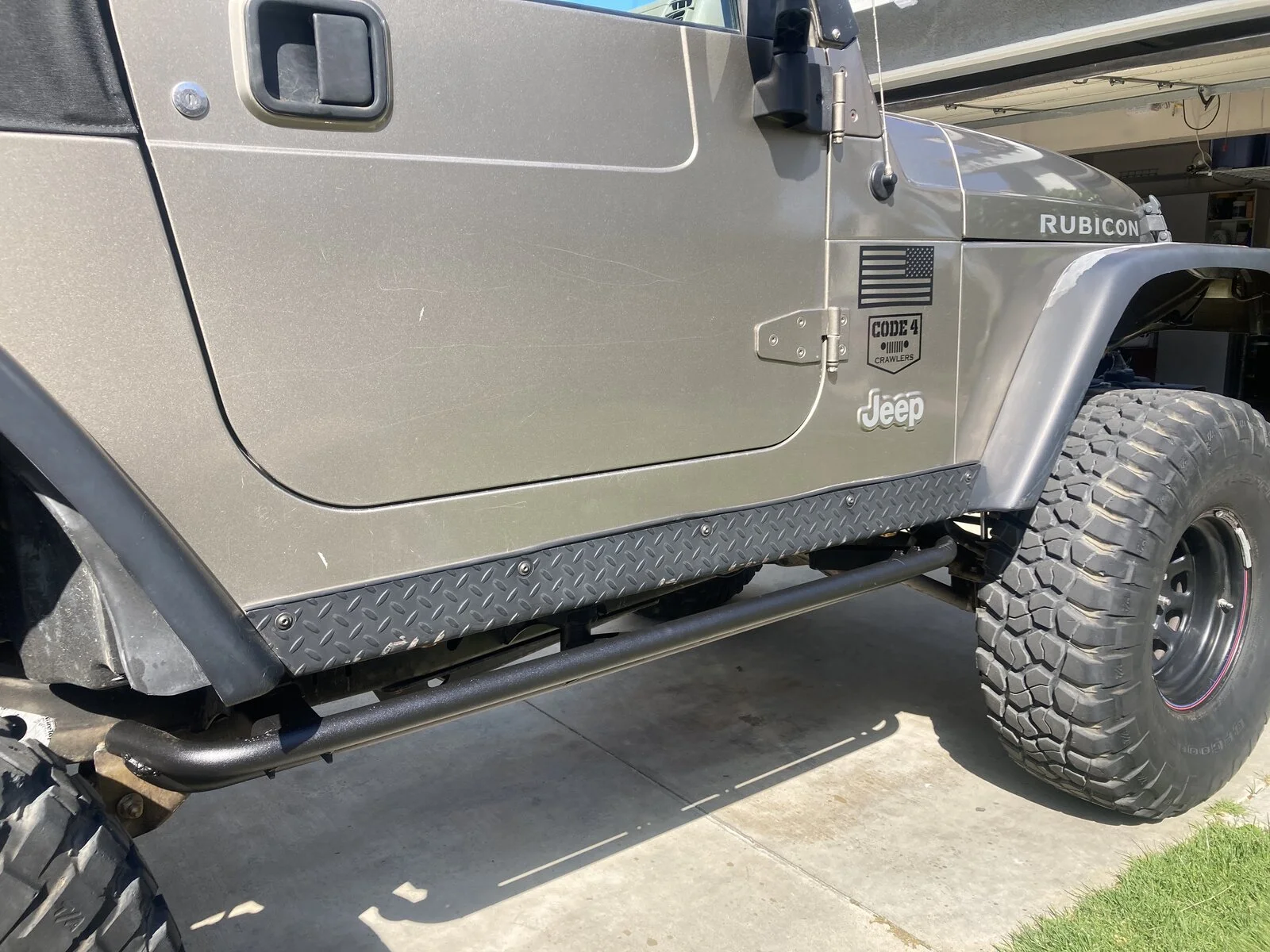

I have the N-Fab rails on mine and I'm happy with them. Even picked up the modular steps to mount later when I get a lift and larger tires.

I have the N-Fab rails on mine and I'm happy with them. Even picked up the modular steps to mount later when I get a lift and larger tires.View attachment 172295

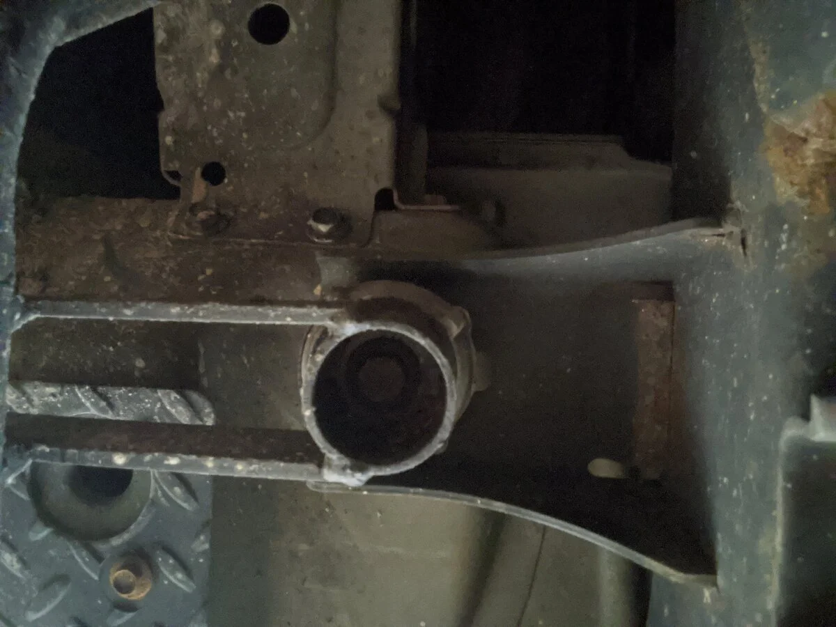

Do they just bolt to the bolt for the body mounts the website didn’t really have any good pictures of them i was wanting to see what the looked like underneath too, do you have any pictures from the bottom side?
72afr
Jul 17, 2019
234
MO
Yes, Straight to the body mounts. I don't have a underside pic with me, but I'll see if I can get one this week. Pretty simple install.

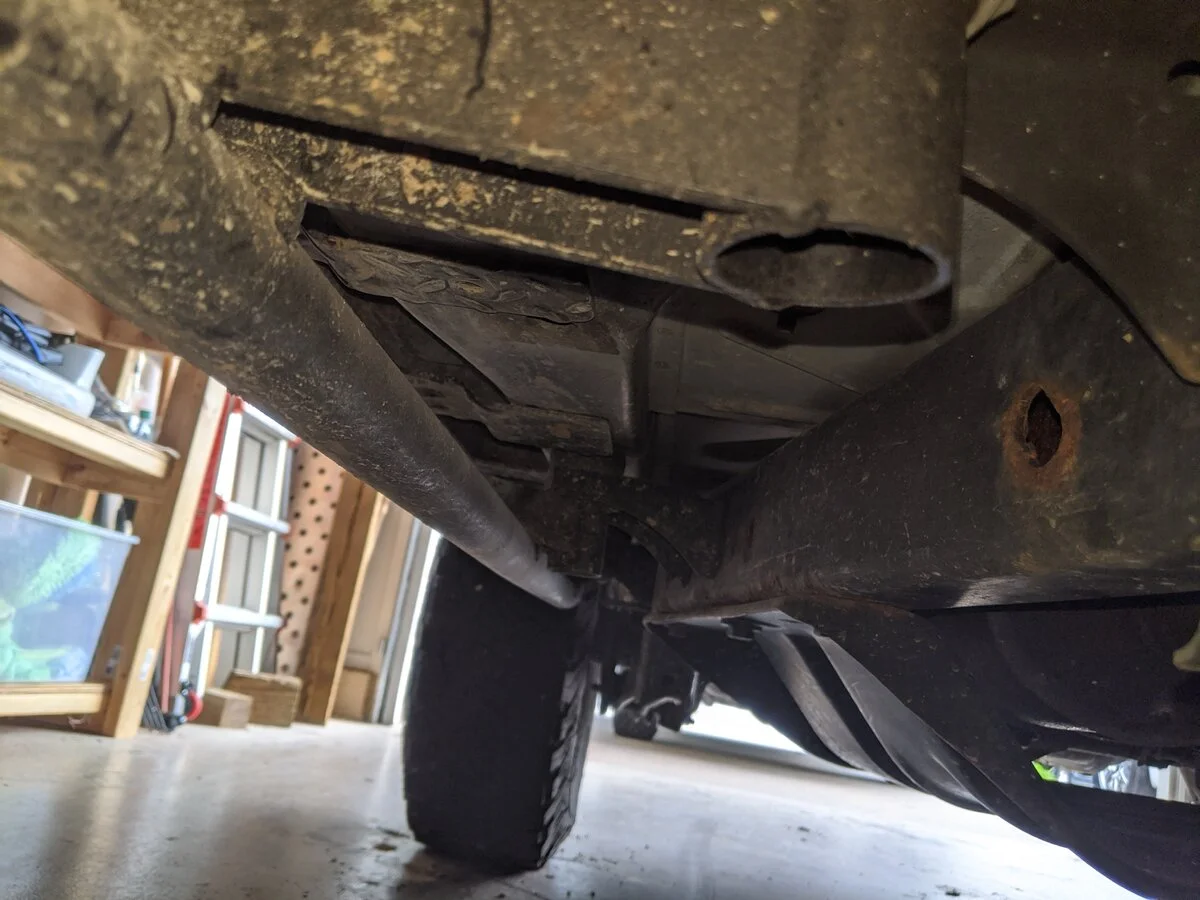

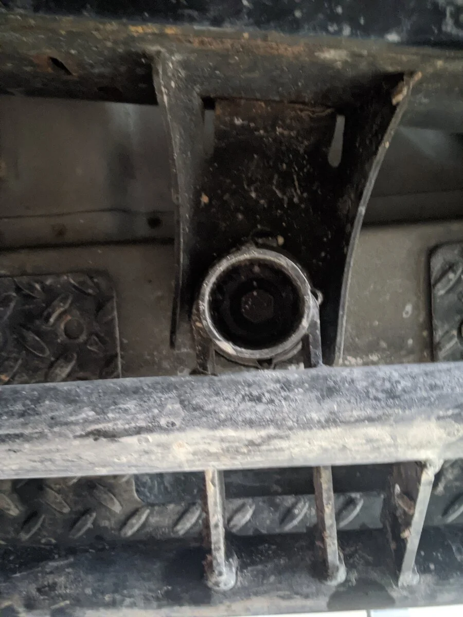

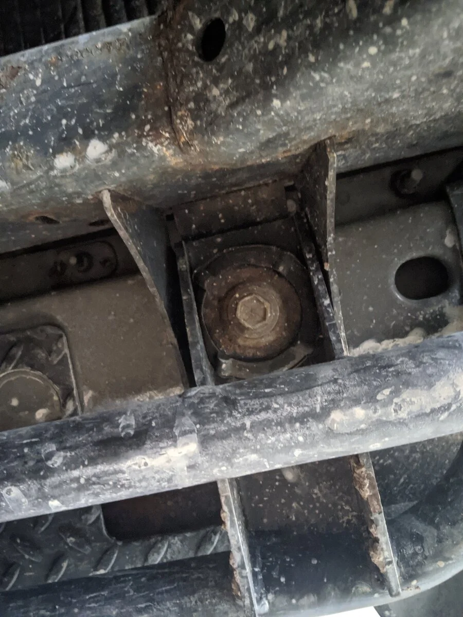

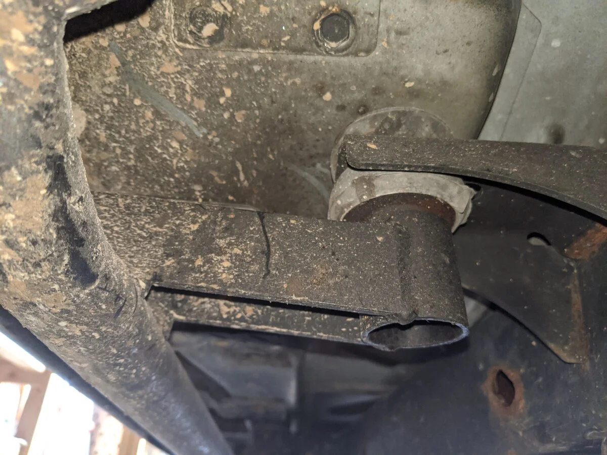

The body mount bolts are a very poor method of attaching steps or sliders. Bolt on the top end and the even loading across the body mounts is disrupted (even if they are trimmed). Attach to the underside and you are putting a lot of leverage on those bolts that was never intended.

Body mount rock rails aren't going to be very good as actual rock rails.
If you just want a step, then it'll work. Otherwise, you need tub mount to actually use them for its purpose.

I wouldn’t take that risk. Damaging more than the rails is the consequence of attaching a supposed rock rail to the body mounts
