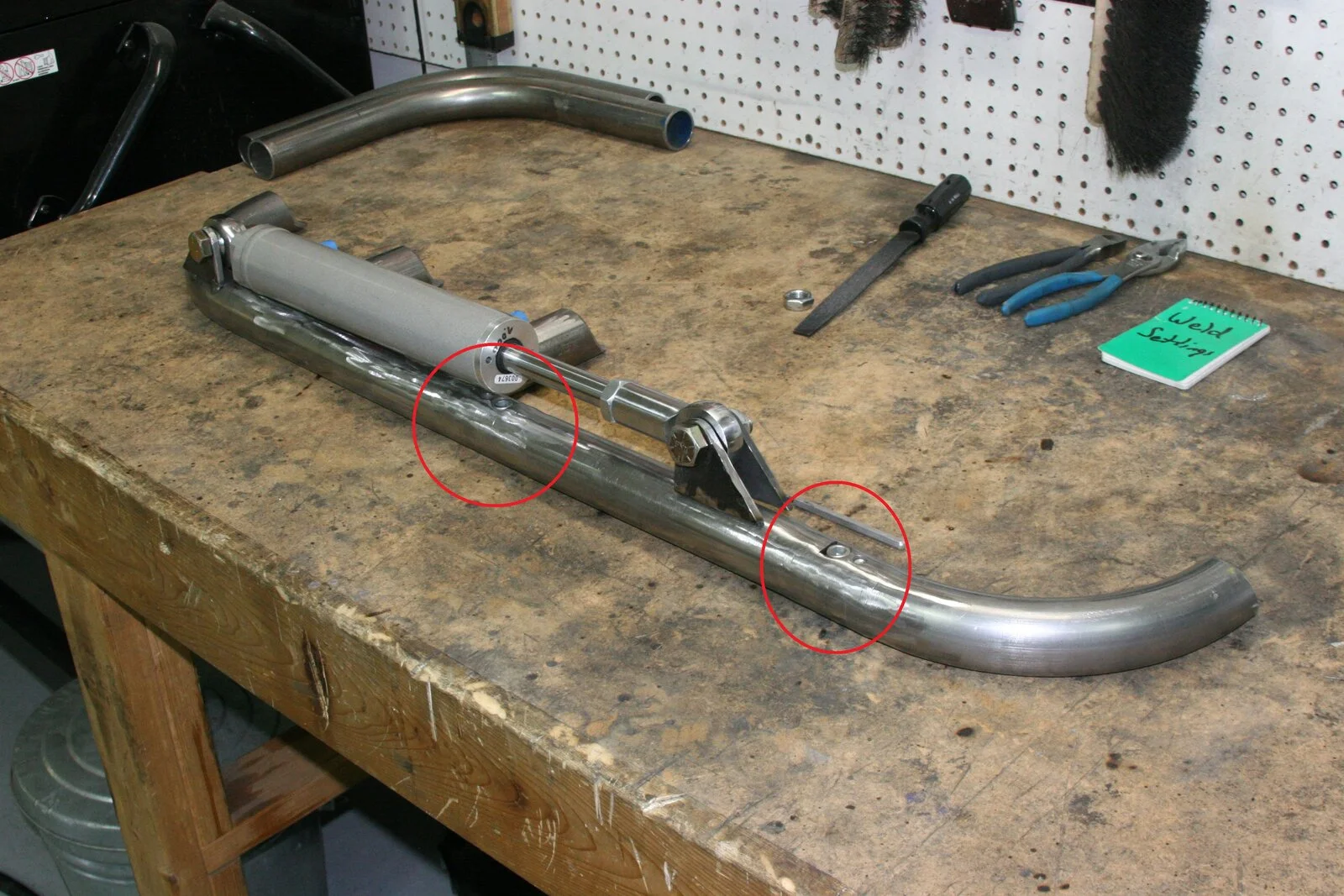

Ermm... what is it? :)
It's for joining tubing, allowing the joint to be disassembled. Hard to see here, but I've circled the two in my hydo mount. This allows me to remove that section of tubing to service the diff.
That's the section of tube I have to replace to fix my front end damage from the last wheeling trip.

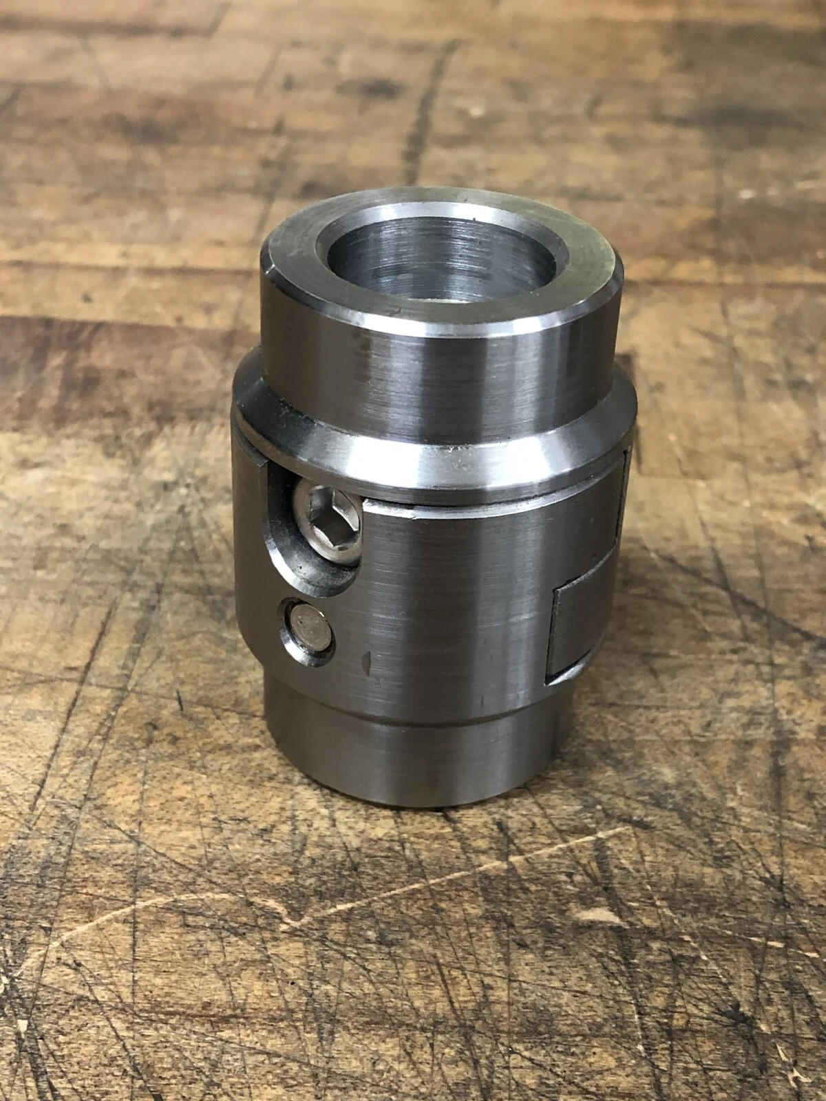

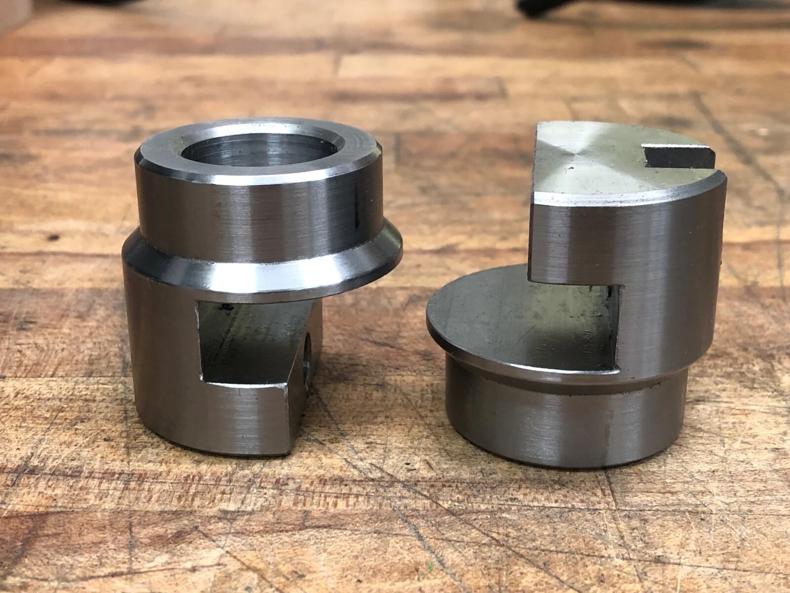

Here's the joint separated. Each half welds into an end of the tubing. This one is for 1.75x.120 DOM.
That's pretty slick, haven't seen something like that before.

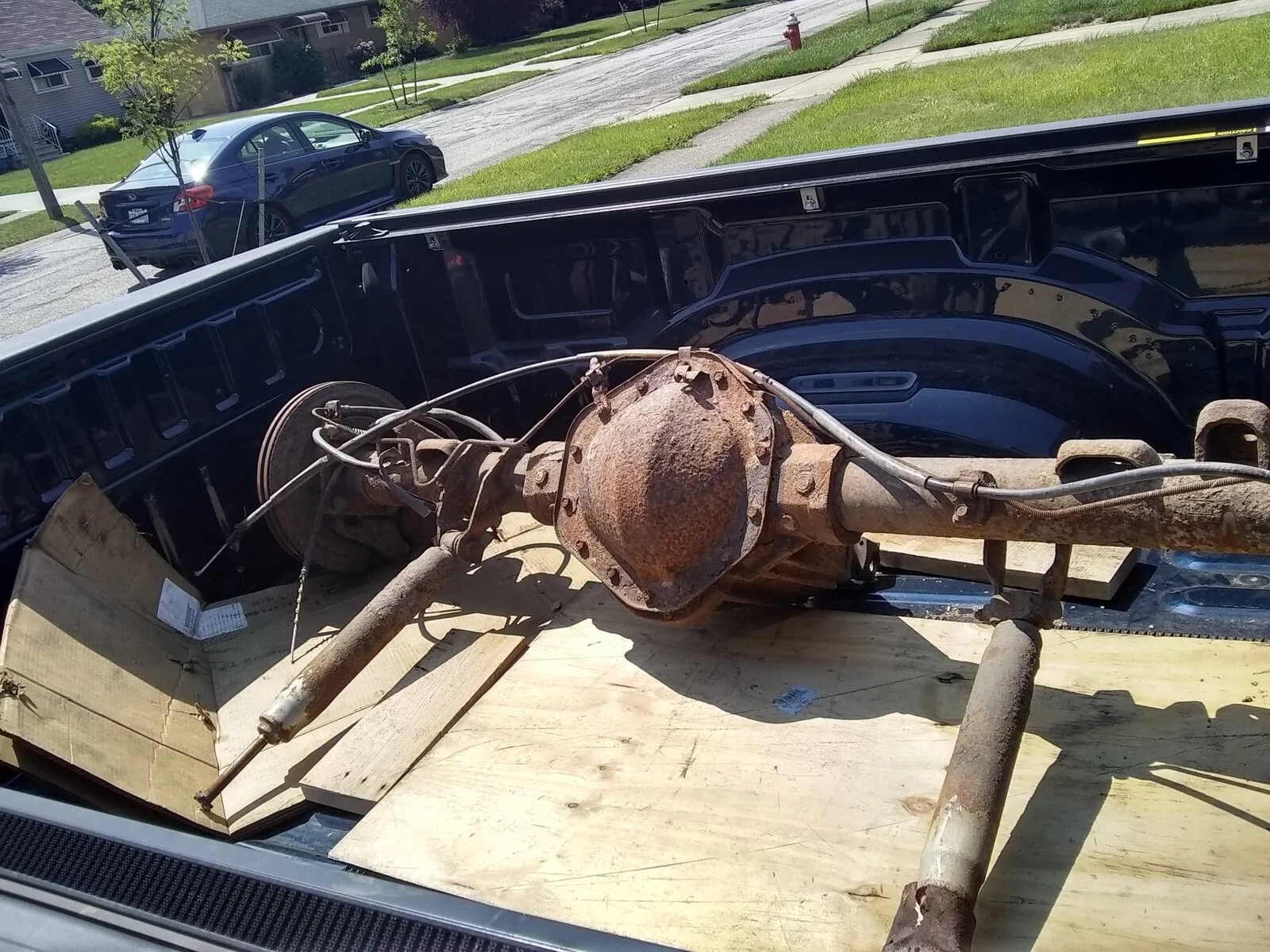

a rear 14 bolt with disc brakes came up last night on FB for 150$.......................thinkin about it.
What year is it? And do you know the truck?
waiting on an answer.
can't get these out of my head either........ i don't have the funds at hand to drop outright, but the $ is a good deal, IMO.
https://www.facebook.com/marketplace/item/1163565817456981/?ref=saved&referral_code=null

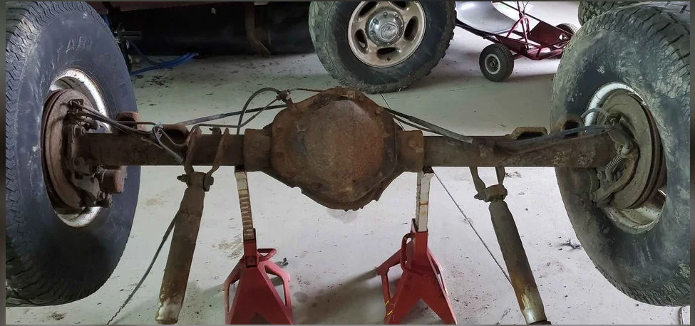

update: seller says it's an 01 but they did switch out to the AAM axle for the 01 series. so it's either a used leftover from 00 stock or he doesn't have any clue.
he doesn't know the width either, the info i find says it could be 67.5 for a SRW or 63.5 for a CnC axle or 72 if it were a DRW.

That look exacly like mine, which is an ‘03. My guess is it is the SRW at 67.5”. For $150 I’d jump on it. I paid almost $300 for mine from a pick and pull. They nailed me because it had the rotors and brake calipers - which I did not use.
Reactions: someguysjeep
You must have a nice pick and pull. Was at my local one the other day and asked for a price on one of the newer Tundra 10.5" rear axles. $1500...
odds favor it being a SRW axle. the rotors and calipers look like crap, but it gives me some cores.
trying to find out what kind of options the seller might have if any for loading that pig.
edited: got confirmation this eve it's a 67.5, and unless cash beats me to it, it's mine this wkend. guy's all down for that and got a tractor to load it.
