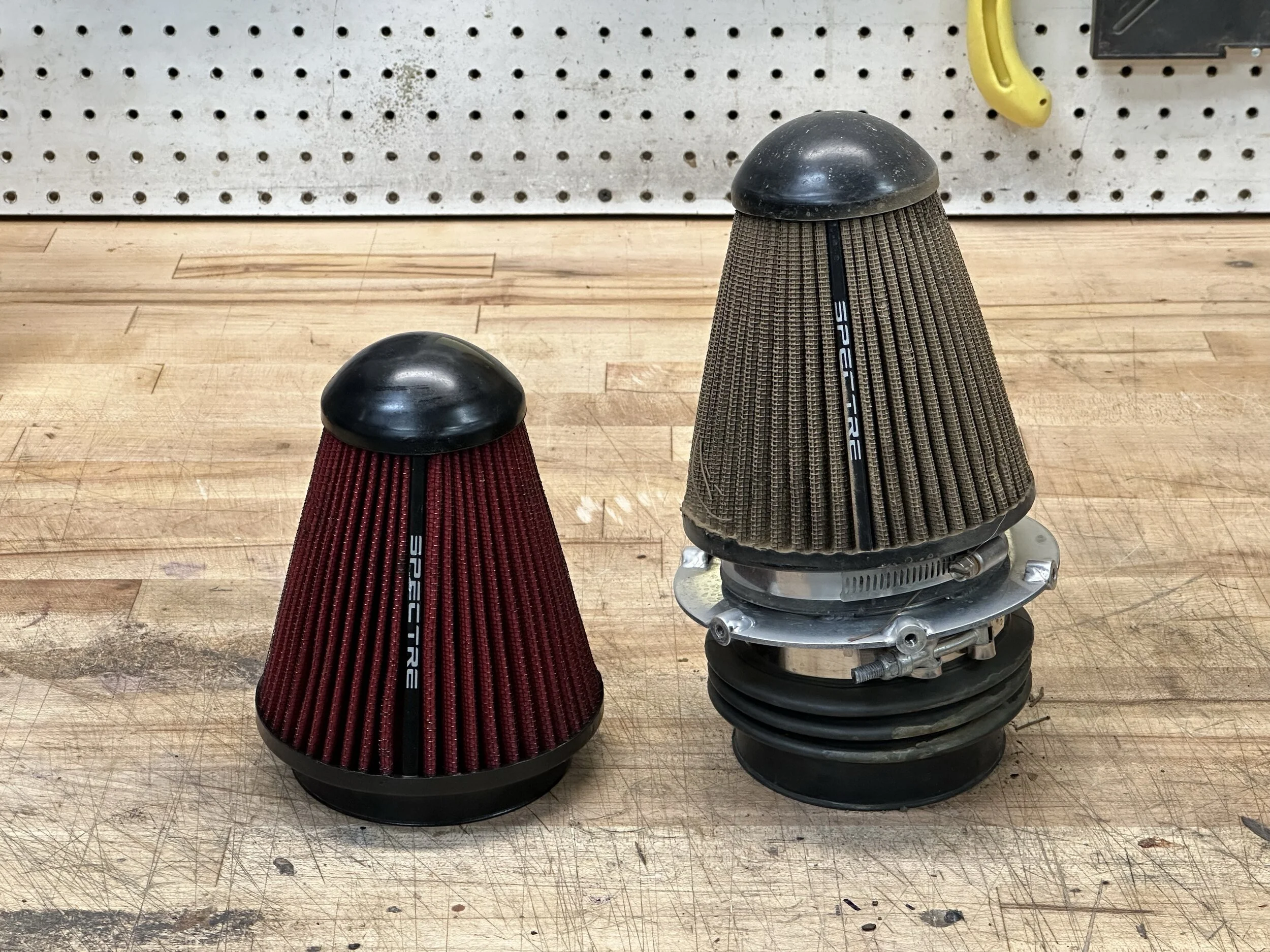

I ordered another filter from aFe Power to try out. The last one I ordered was way too big - this one looks closer to being able to work. We'll see.
You're the MAN... I'm watching.
I hope it fits. It appears to be very good quality, and much more surface area than the oiled Spectre. I'll just need to see if there is enough space left over with this thing in the filter assembly to actually allow air to pass through... :unsure:

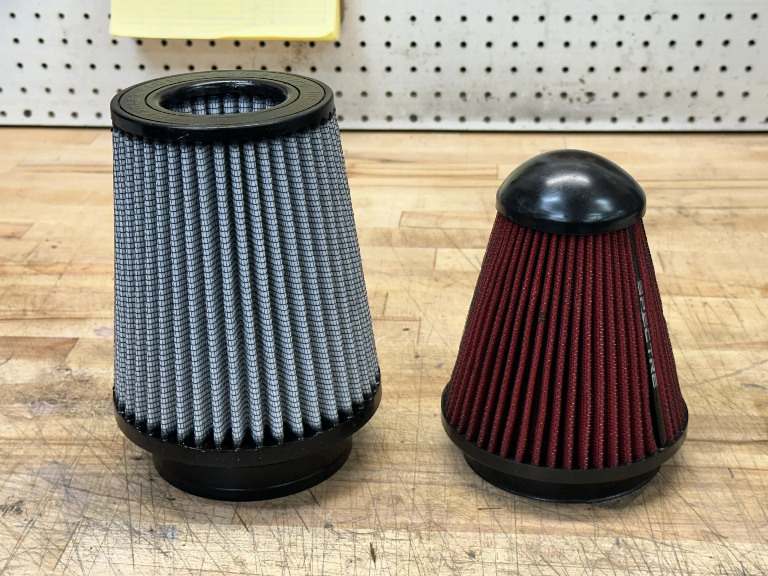

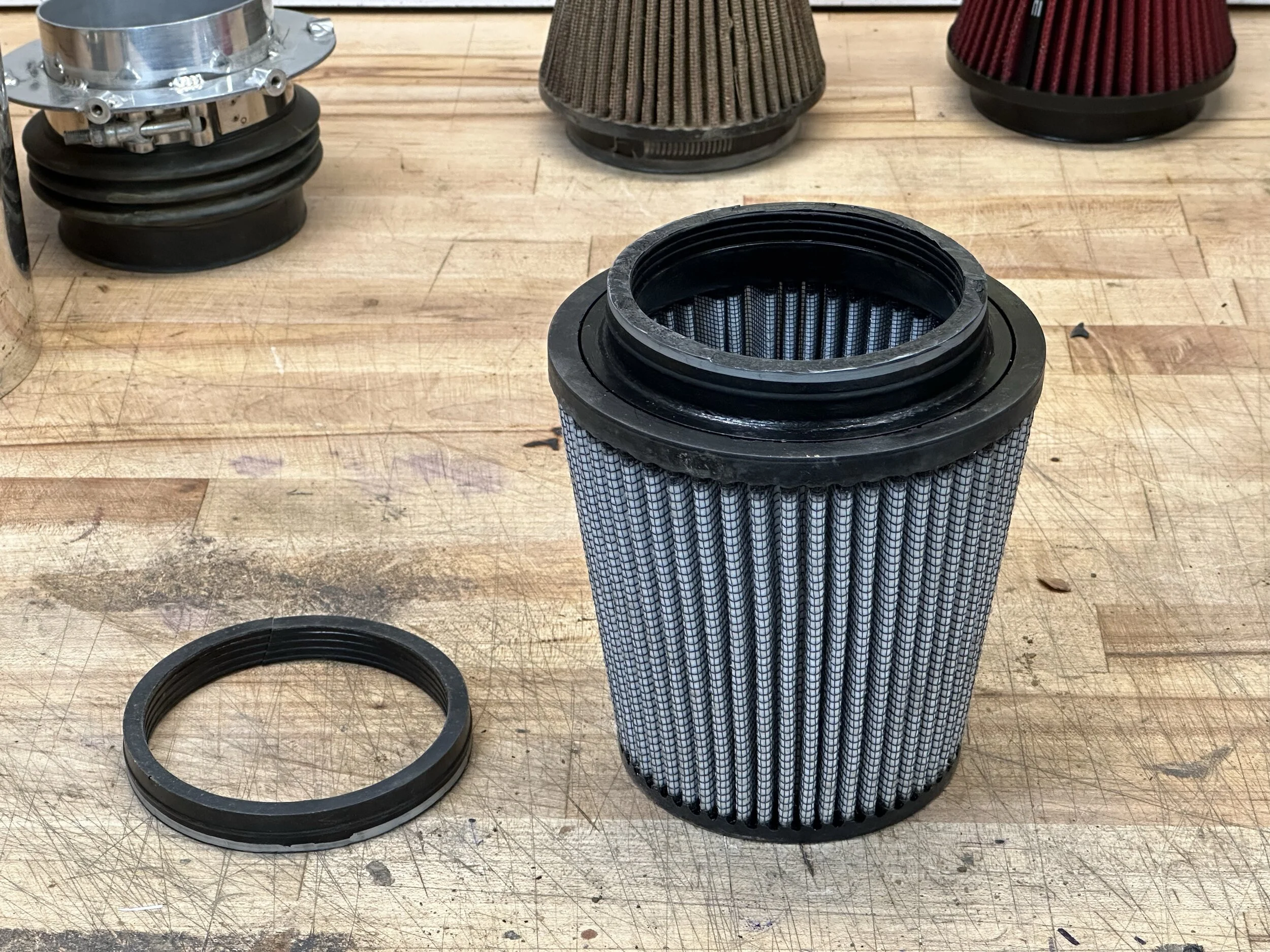

Oops. You know what? I posted the wrong picture. This is the filter I just received:
The pic I posted above was the first filter I received - which was way to big.

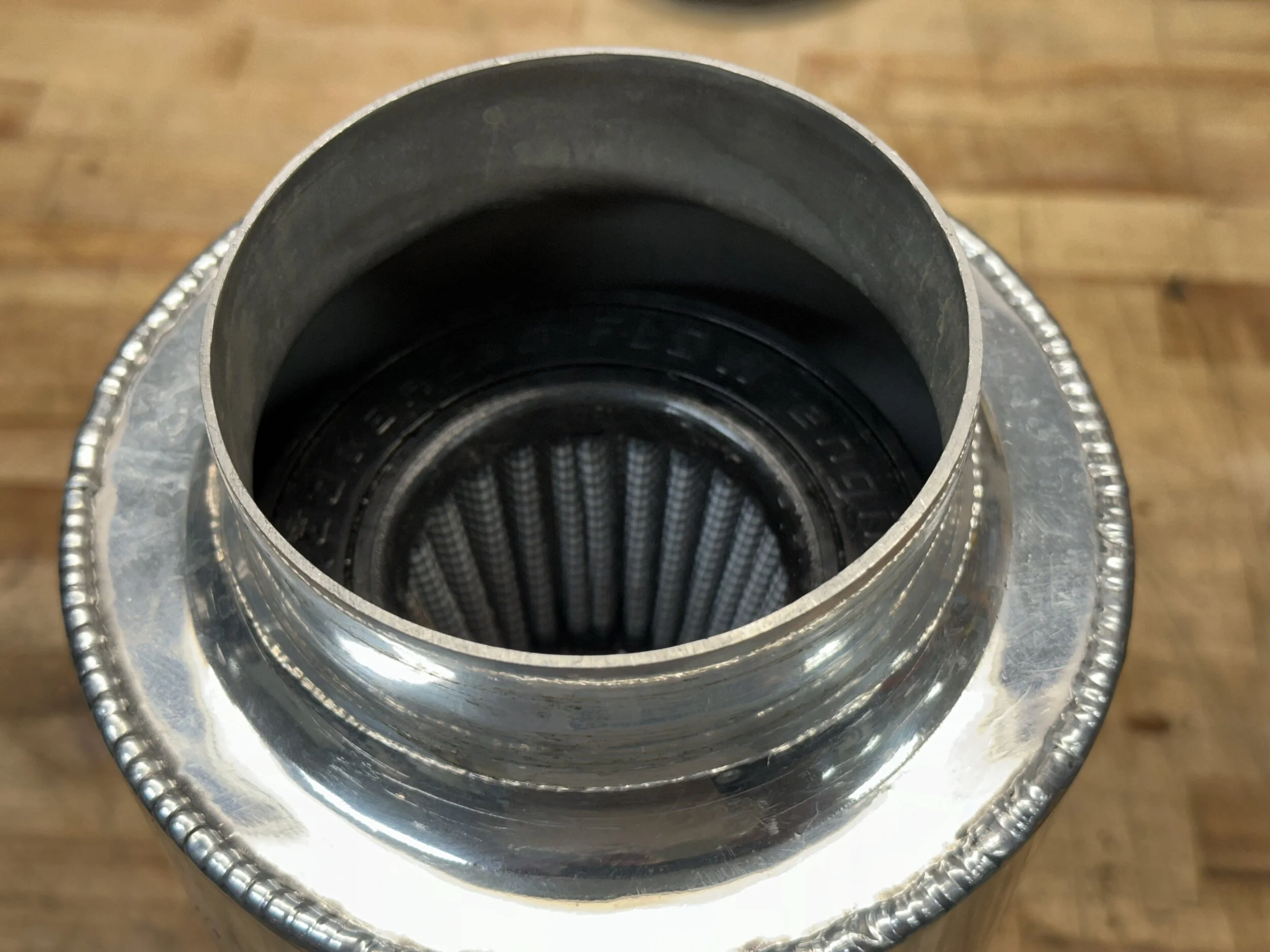

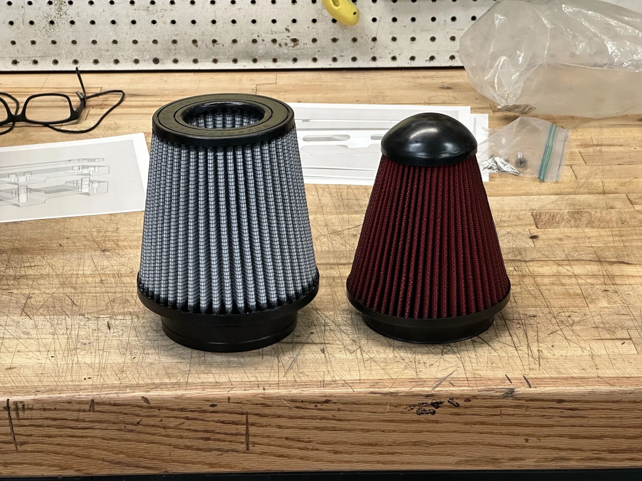

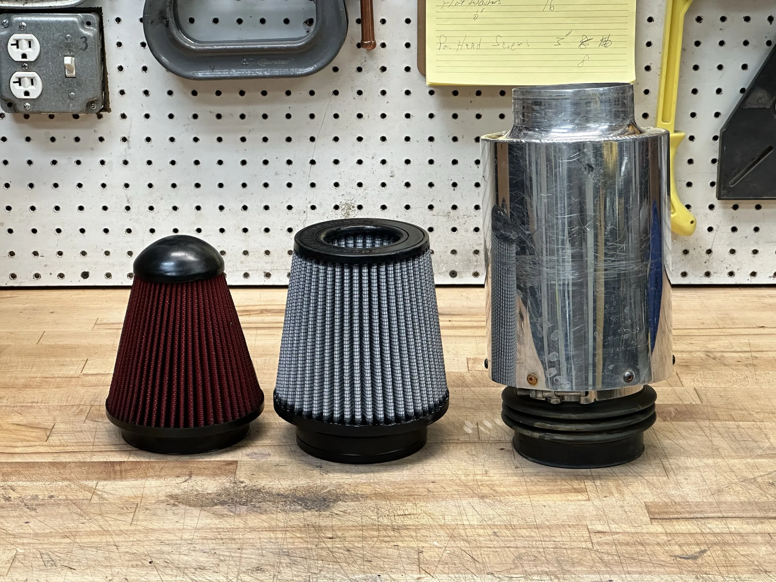

This morning I test fit the new aFe Power air filter in the rig. Here it is next to the original Spectre Oiled cone filter, and the enclosure.
The aFe is just a bit taller, but most of that is in the flange. which is a half inch taller.
This is how the filter mounts inside of the enclosure. And no, I've haven't cleaned the thing since Moab... 🙄
To create a bit more clearance at the top of the enclosure, I trimmed 500 thou off of the flange (and yeah, I mic'd it... ;)):
I missed getting a pic of the original fit, but here it is after the trim: It looks like plenty of clearance - especially given the additional inverted cone in the end.
And all back together.
So I'm pretty stoked. At long last I've found a high-quality dry cotton filter to replace the high-maintenance oiled cone filter element.

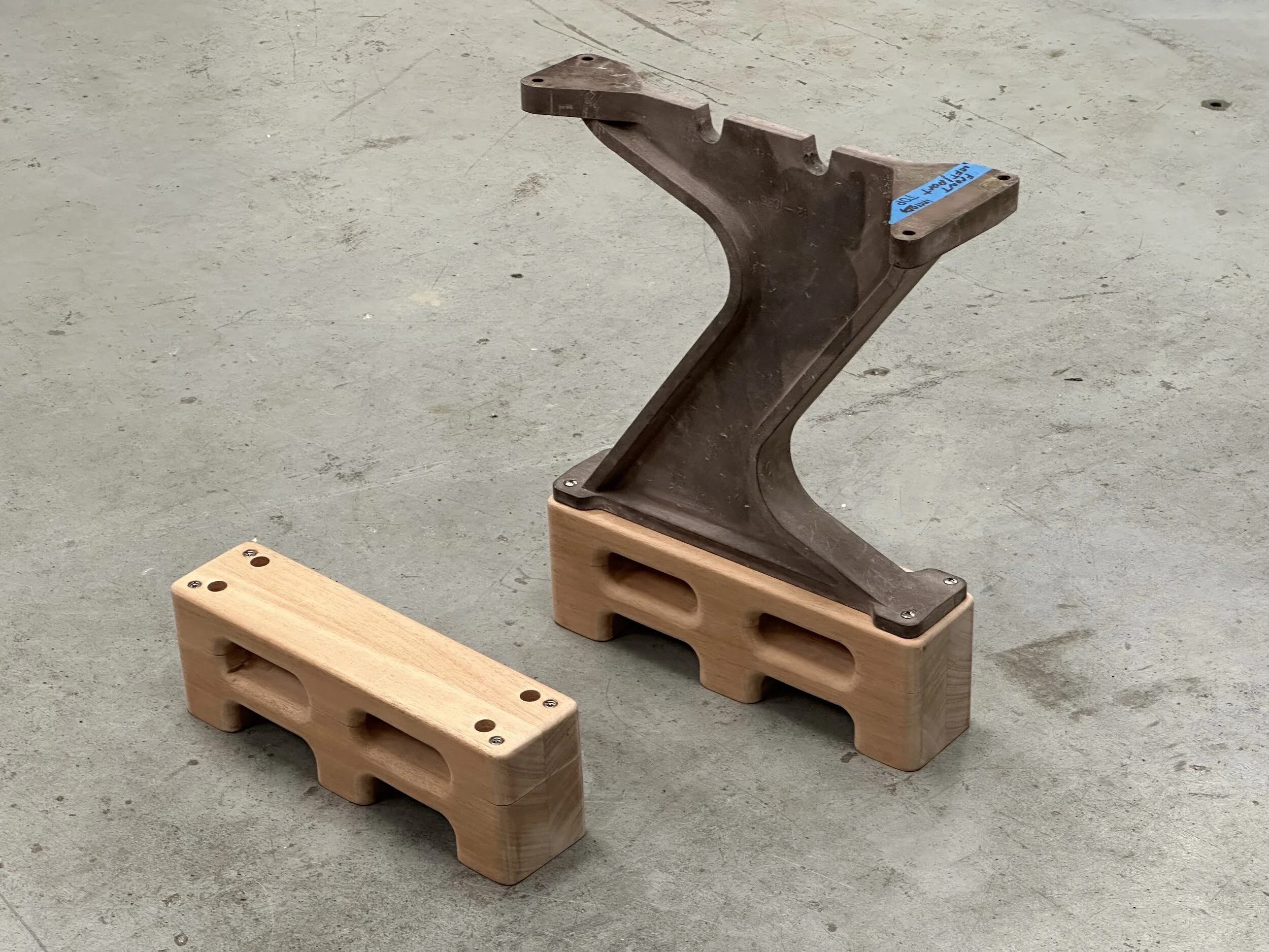

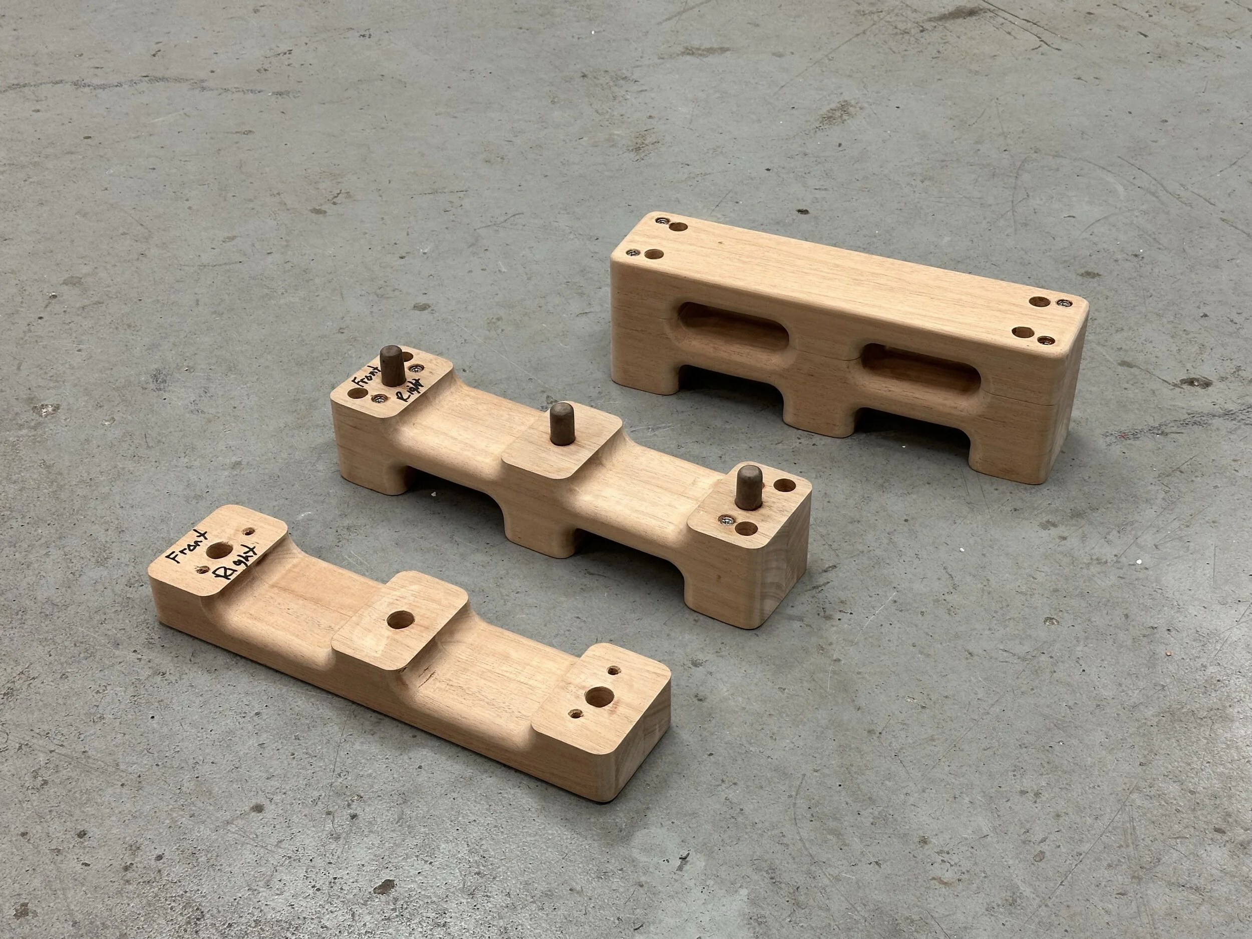

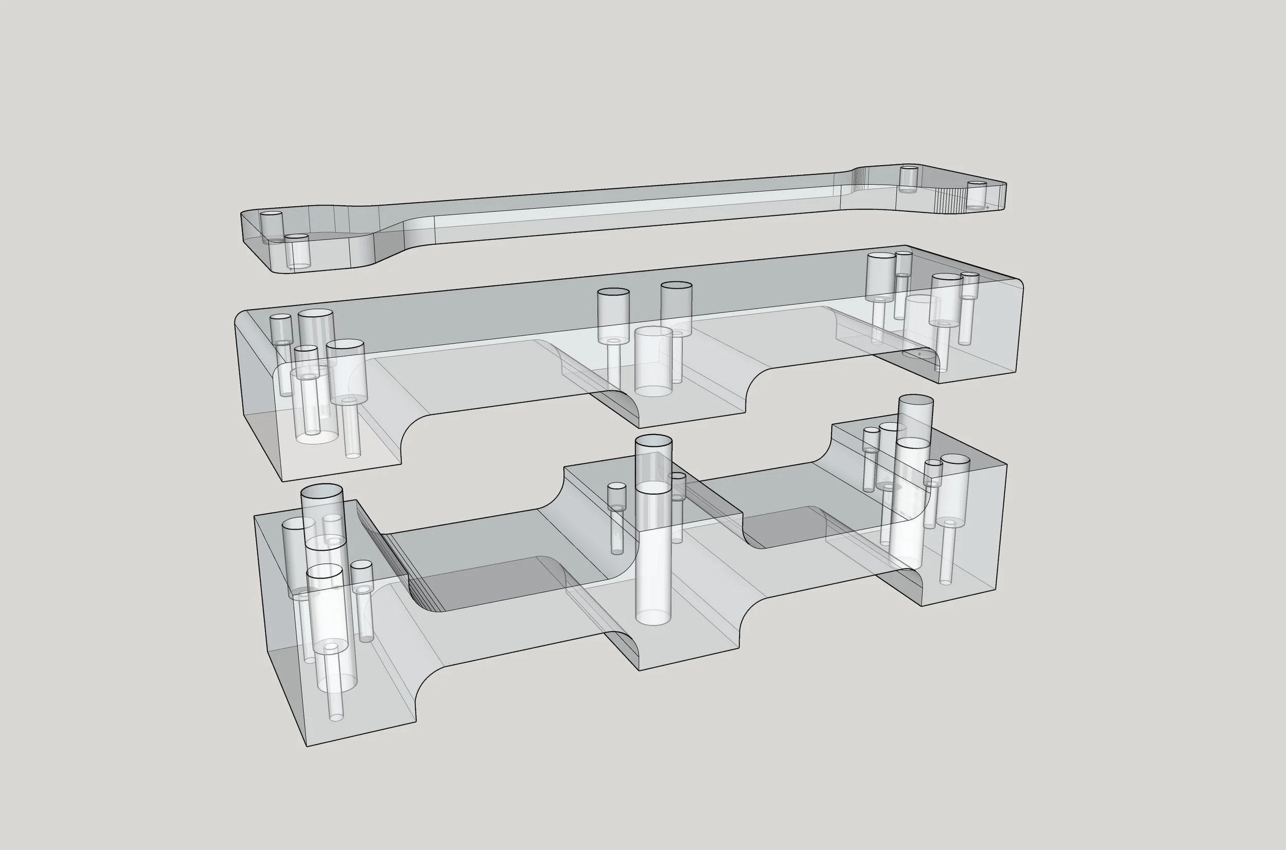

I posted this drawing earlier for a set of seat risers I built for the boat of a good friend up on the Eastern Shore of Maryland.
For anyone curious, here is how they turned out. The wood is Mahagony.
