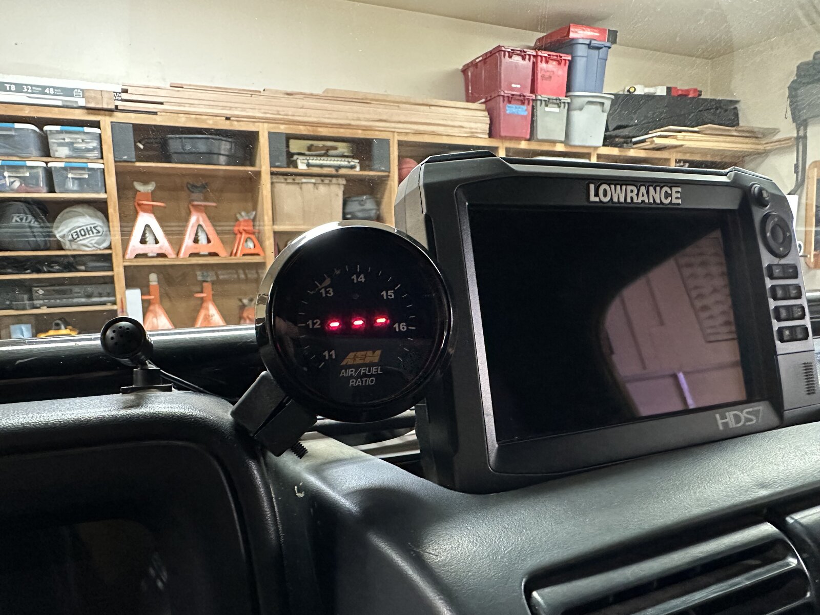

For the last couple of weeks my AFR gauge has been reading very lean. At startup it appeared to be fine, but as soon as I began to drive it would slowly climb and ultimately max out - indicated by this display:
While driving I would see 15's and 16's, and then back to —-. So, obviously my first thought was:
"What the *$^%%^ did Flyin' Ryan do to my tune!!!!"
Not really - tunes don't work that way.

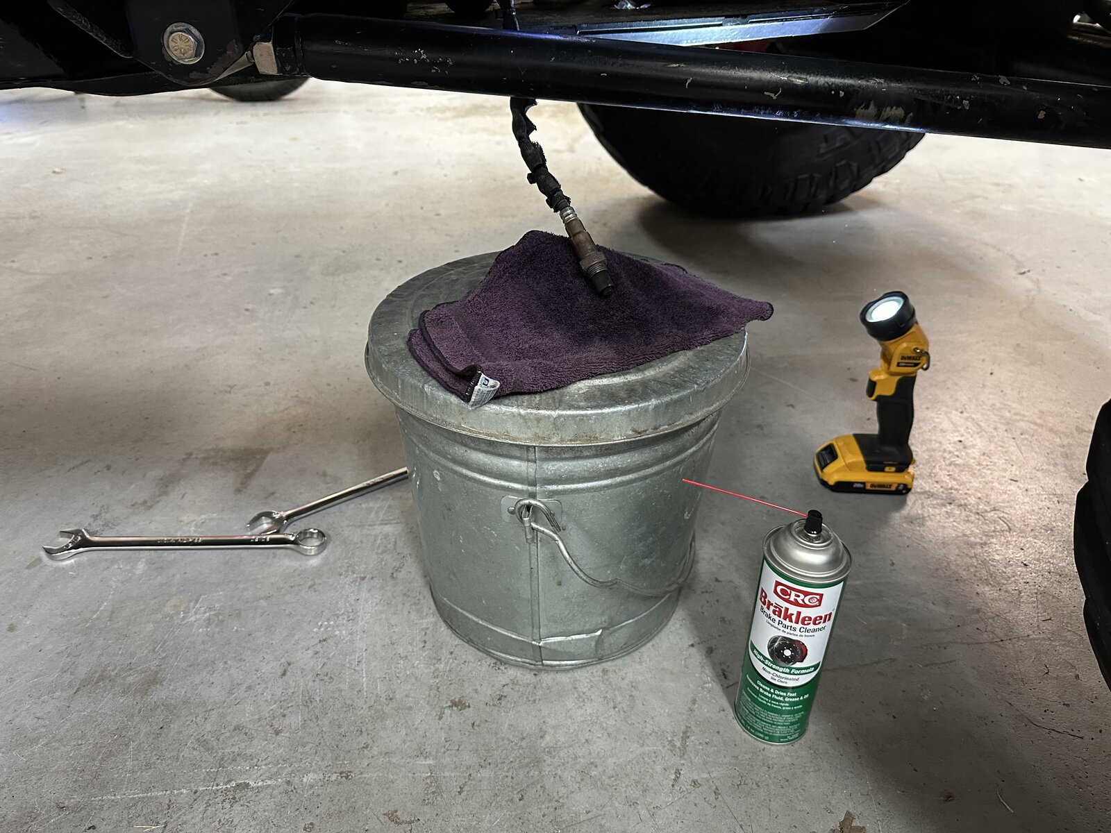

After checking all my connections, and looking for and finding no vacuum leaks, I figured there was something wrong either with the gauge or the wide band O2 sensor. Just the same - I was not throwing to coal to it, just in case.
An easy test for the sensor is to pull it and check the gauge. It should read full lean - which it did.
Next, soak a rag in brake cleaner (safer) or fuel and wrap it around the sensor - a properly functioning gauge should go full rich and stay there until you remove the rag.
Since I was home alone, I had to take a video to see what the gauge was doing. Here is what it did:
It goes full rich as soon as I wrap the soaked rag around the sensor, but then it immediately goes full lean - and then no change at all when I remove the rag. Definite indicator for a bad sensor.
So bad sensor - after just a year and a half. Well, $130 later for a new Bosch wideband and the mill was strangely back to running a good AFR. ;)
