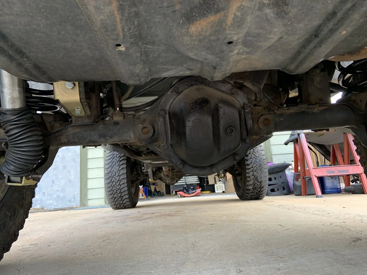

So last week, I was able to complete my lift upgrade by myself. I did have to sawzall the frame mounted rear track bar bolt as it was frozen inside the sleeve, that was PITA. Right now, I am running Metalcloak dual adjustable aluminum control arms, Metalcloak front and rear adj track bars, OME 2939 front springs, 2946 rear springs, both 4" and Bilstein shocks from a JK which while on paper are similar in collapsed and extended length, give the worst ride imaginable. So I just bit the bullet and ordered some Fox 2.0 Adjustable Reservoir shocks for 4 corners.

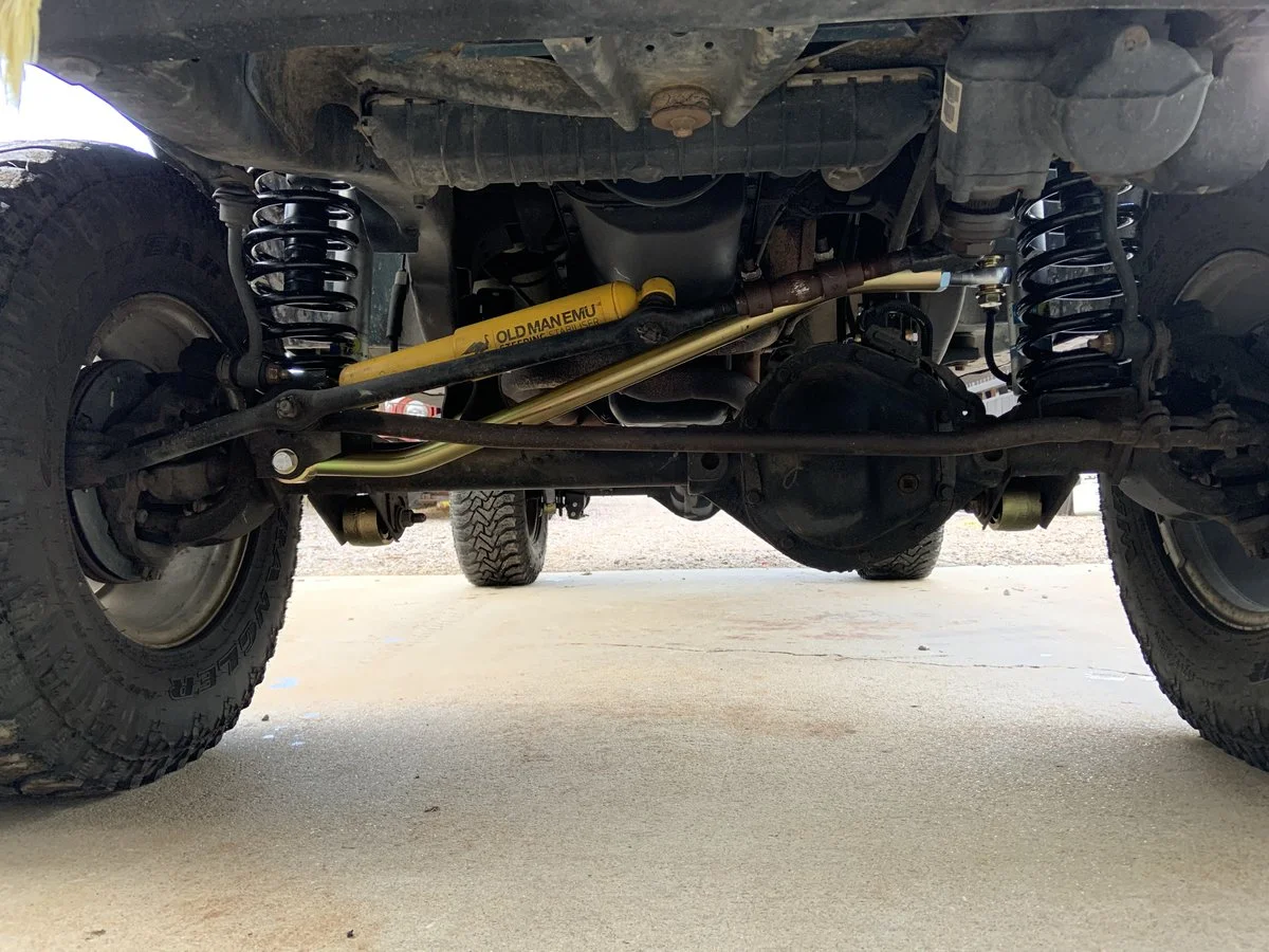

I haven't done a body mount lift (or motor mount) yet, but I have a completely new set of stock height body mounts to install as mine have essentially evaporated to dust as they are most likely original. I also installed the very expensive )($100) Synergy grab handles which are nicer than anything else I've seen and was sold on them after having something similar in my JK's. I also installed 10.5" rear sway bar links, but haven't gotten anything for the front as I can't decide whether to spend $150 on quick disconnect links or $500 for AntiRock. And I have to figure out what to do with the front steering, Currie Correctlync or just upgrade tie rod or wait until I break something. Which I am sure I will because though I am running 265/75/16 right now and will go 295/75/16 (prob BFG All Terrains) if I stay with my stock Rubicon wheels.
Hopefully this weekend, I am going to mount my ARB compressor, eBay 6 switch panel both under the hood, and another set of lights. Next weeks activity will be to mount the Fox Reservoir shocks when they come in but I have to do some research on the best way to offboard the reservoir. Perhaps people have ideas on how to best accomplish this. My soft top has a lot of old age tears butI have another used one in good shape that I need to swap, so there's that to do as well.
Thanks to everyone for the offers to help. I'm glad I was able to do it myself, but I probably overdid it a bit and am pretty sore.
