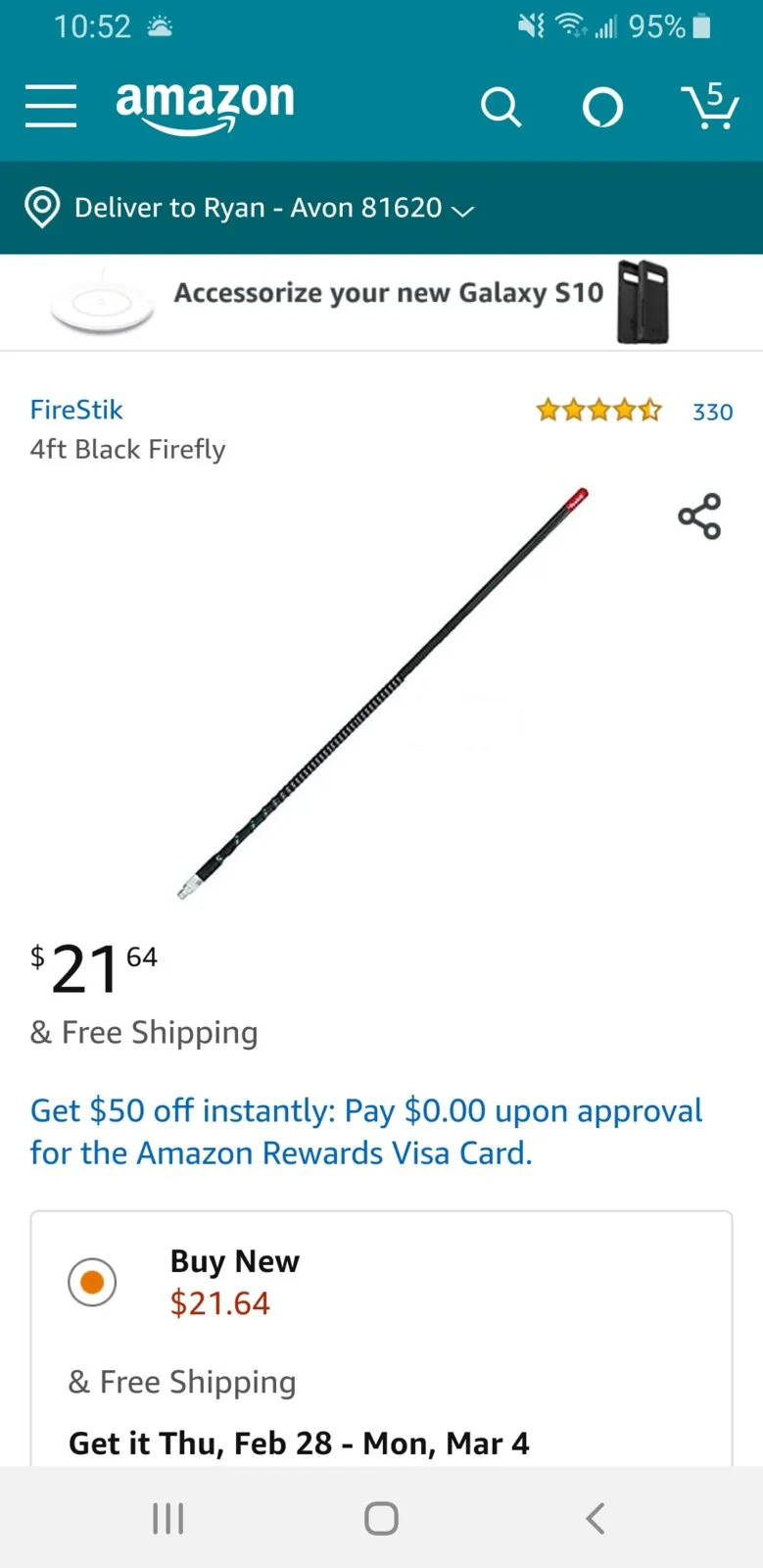

How hard is it to tune the antenna? I am looking at the 520xl, 18' Wilson cable, and 4ft black firefly.
I would use a firestik. Its very simple if you have the SWR meter. Just need to make sure the mount is properly grounded to the body (requires sanding away the paint) and that you have the washers on the antenna placed correctly

Guess I didnt realize firefly was firestik:ROFLMAO:. That would work. If you plan on getting into the trees though I would recommend a 2-3'
I have the rock hard 4x4 rear carrier and with the mount near the bottom of the triangle swing arm, a 4ft should not stick up too high over the roof line, I think. Is an swr meter something you use more than once, or should I just come visit you and use yours Haha

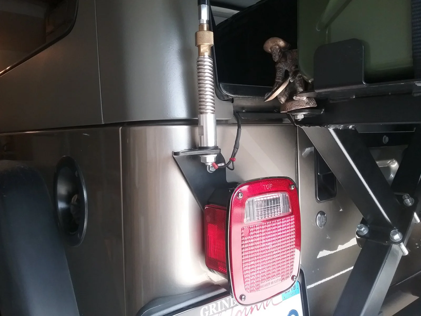

The Rockhard 4x4 rear tire carrier antenna mounting tab is so low that only 6" of a 4' antenna will extend above the jeep top (if you have one). It is also more difficult to obtain a good RF ground with a mount on a swing-away tire carrier than an antenna mount affixed directly to the body. [Not impossible; just more difficult.]
For these reasons I elected not to use the Rockhard antenna tab and decided instead to use a Teraflex tail light antenna bracket. By doing so I know that I have a solid RF ground, my 2' Firestik II antenna extends just to the height of my hard top, and my 4' Firestik Firefly extends about 22" above the top. The 4' Firefly has enough flex to withstand hits on overhead obstacles without damage even without a spring.
YMMV
_
Photo of Teraflex tail light antenna bracket, Breedlove stud mount, Firestik heavy duty spring, and Breedlove solid brass quick disconnect. Since my 2' antenna is protected in that location and the Firestik Firefly is so flexible I no longer need or use a spring.
78719

Good to know. I have led tails, no mounting bracket for me that I'm aware of. Could I run a jump cable from the tire carrier mount to the body for a ground?

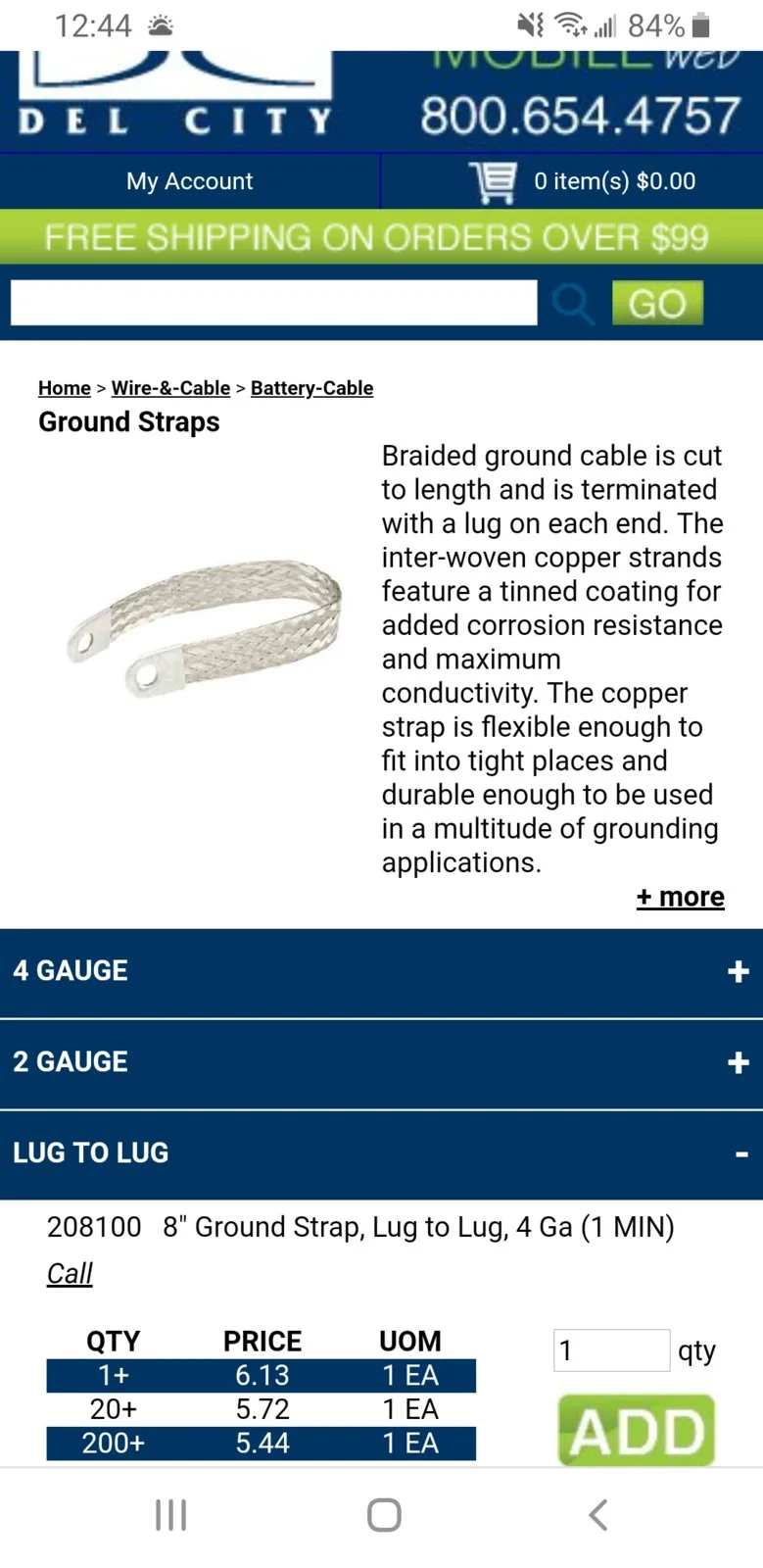

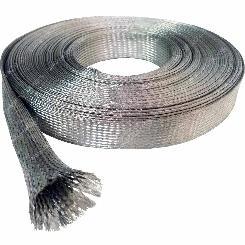

Absolutely. Tinned copper braided ground strap is better for an antenna ground than stranded wire because RF waves travel on the surface rather than through the medium, but 10 or 12 ga. primary wire certainly works.
FYI, some people use a simple "L" bracket or piece of angle bolted to the tub near the tailgate rather than a tail light bracket.

Good to know, I will keep that in mind to look for a tinned copper braided ground strap.
