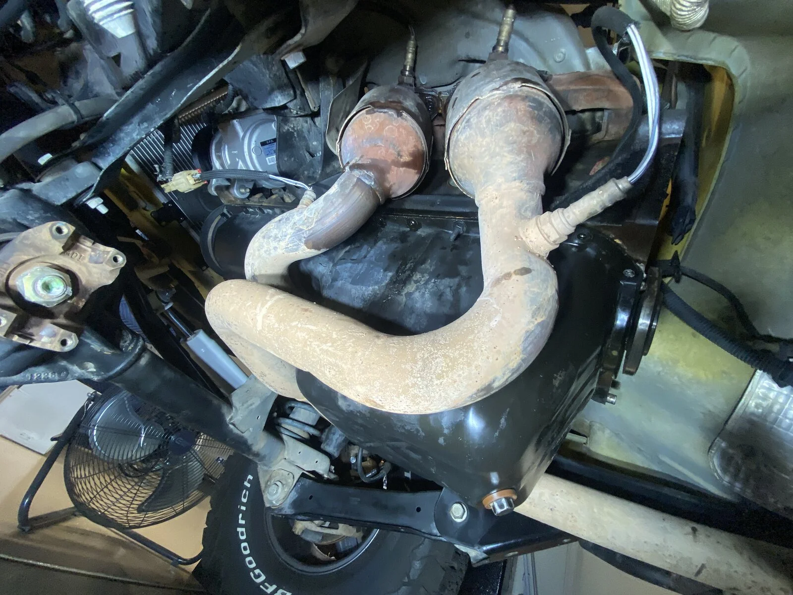

Removing oil pan or at least trying to. This darn exhaust showed up out of nowhere and decided to get in the way. 2002 Sport, has two downpipes from the exhaust manifold that join into one before the catalytic converter. There’s a flange on both side of the cat before going back to the muffler and tailpipe.
Do I need to completely remove the header from the engine - disconnected at exhaust manifold and flange in front of Cat?
Thanks in advance

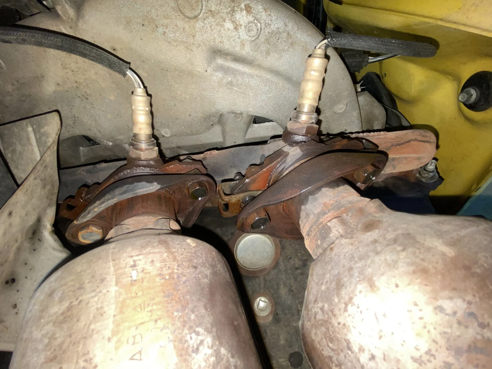

Don’t disconnect the header just undo the four bolts holding the y pipee up to the header down pipe and at the skid , check the cats while its off, and be careful with your sensors-

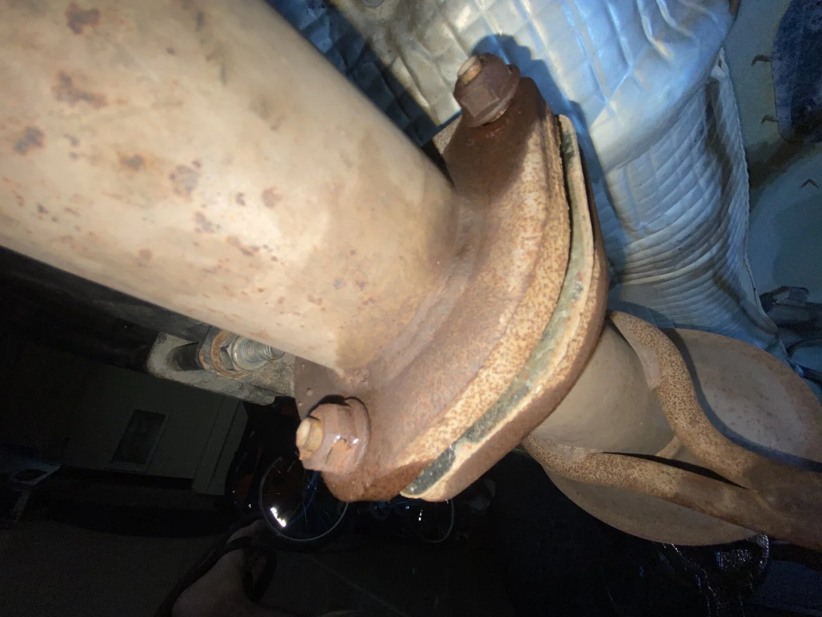

Ok so the 4 bolts right next to the upper o2 sensors; and the 3 bolts at the flange in front of the cat?
As you can see I sprayed them with PB blaster and loosened the car flange. Man that was stuck good.
Yes and you did the right thing by using the penetrant- Kroil Is rumored to be even better- I had to replace that assembly recently
and man and those were incredibly hard to get off-
The 4 you showed above
the cats are 14mm I think, a swivel impact socket with a 6 and 12” extension helps, a 14mm gear wrench is handy too- its a job- Be sure to disconnect your 2 downstream sensors before you let the thing drop down

Ok cool I got it. Not too bad getting those upper exhaust bolts after all.
