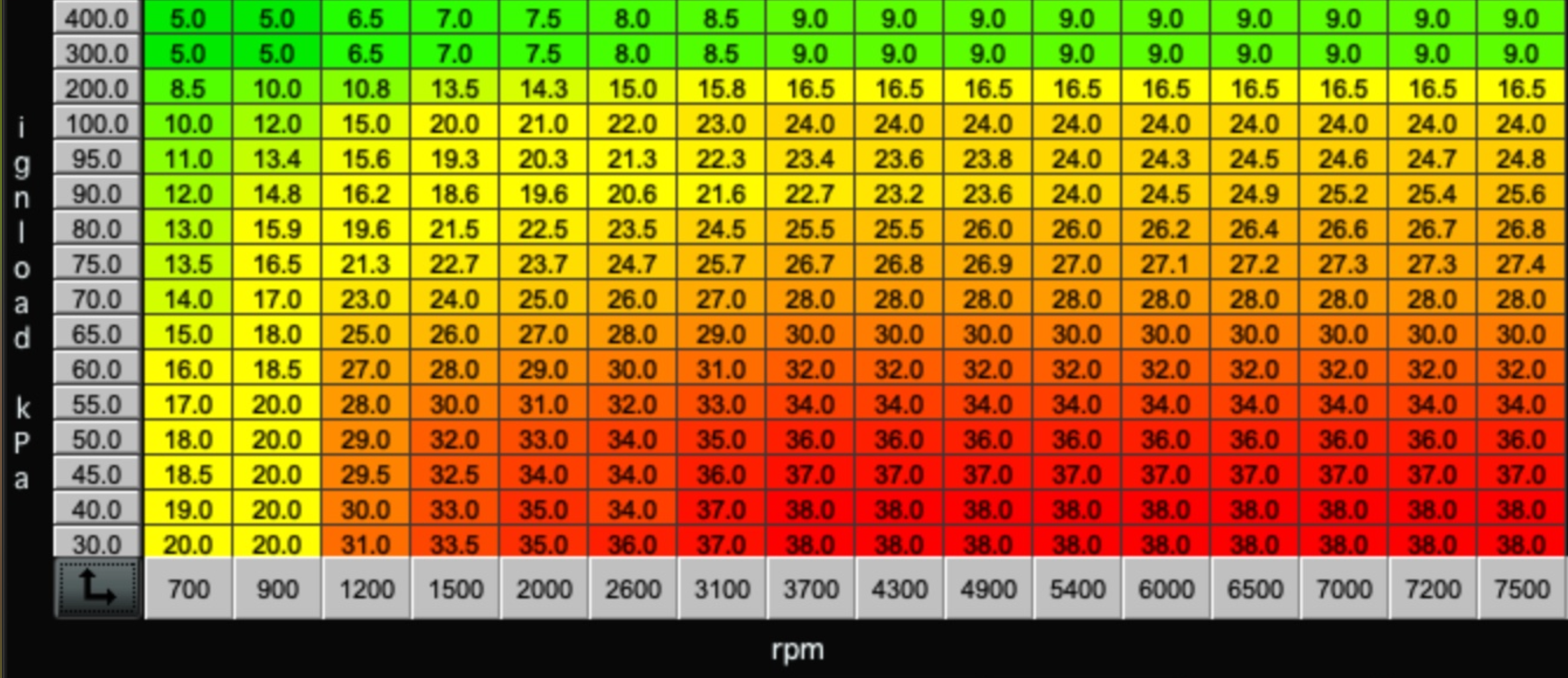

I'm sorry, I thought somewhere I read that the problem was in vacuum. I guess maybe I inferred that as you were asking about stock maps. I tune my own stuff. I'm running AEM Infinty. My setup may be a bit different as I have a 4.7 stroker with an Edelbrock head. I'm also running 93, but with methanol injection. So, it may be apples and oranges. Does the MS have knock control? This is one of the base maps, however I am using flex fuel, boost and lambda to control spark timing as well, so these numbers get modified a bit more.
Some of your Timing your running hotter than I am even. Probably some of that liberty is from the A:W cooler and Meth. Definitely going to help you a lot. What's your Target AFR's?
