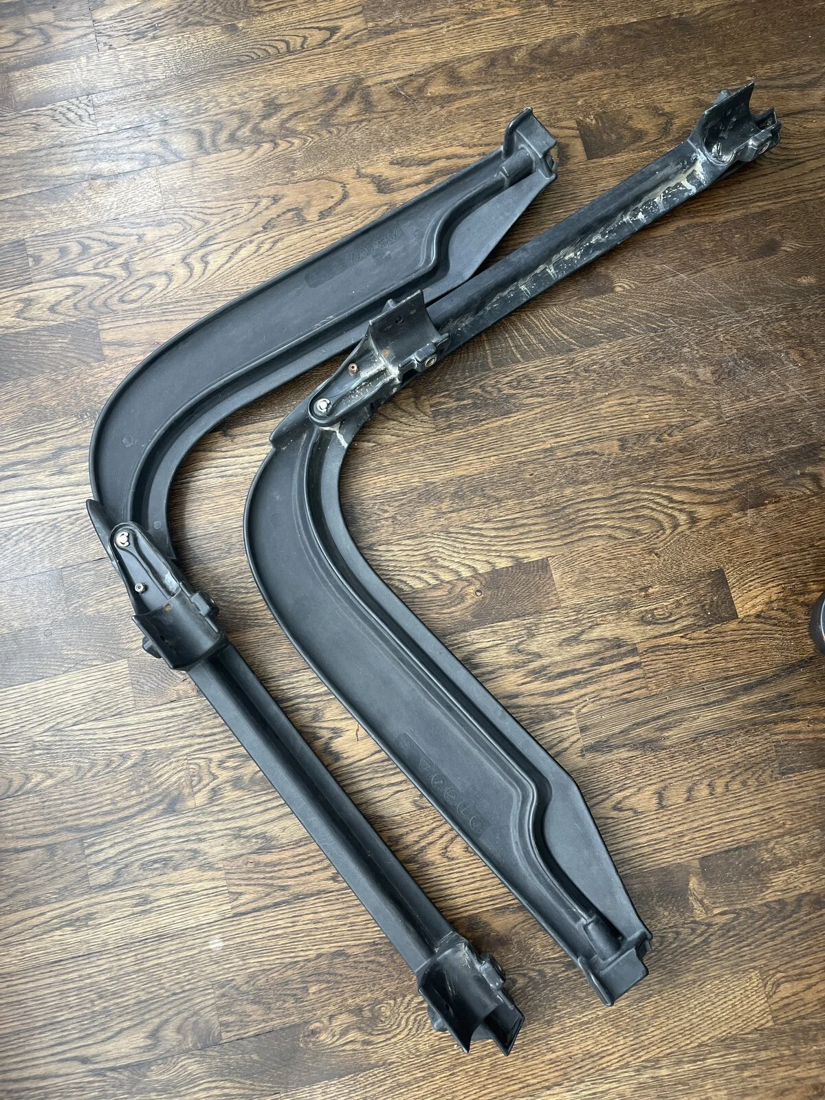

I just remembered that I had these pieces that came with the car. I didn’t know what they were for and so I put them in a corner. When I looked to price out hardware again I remembered them, does anyone know if I’m right about these being part of the soft top frame. And if so what other pieces a would i need.
Door surrounds, it should have 4 "door surround knobs" with it.
You could call https://www.bulldawgmfg.com/
They make nice hardtops in Chattanooga but I've seen them list soft tops for sale. When I was searching a few years ago they seemed to have a good price.

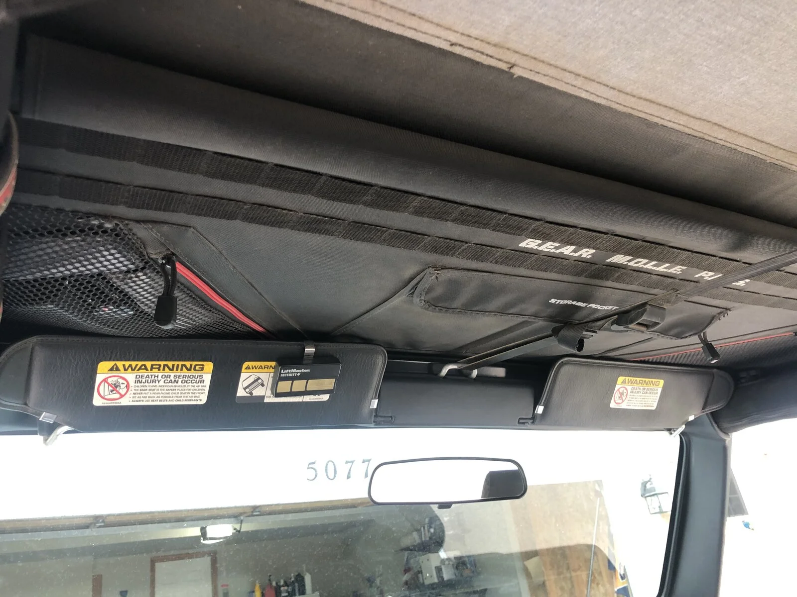

I've owned my Jeep since it was new and bought it with a soft top only. I don't have AC, so I run a safari top spring through fall since I need open air, but also want shade.
I know Smittybilt is generally a brand that receives much criticism, but I have this top and absolutely love it.
https://www.amazon.com/gp/product/B00L81T4G6/?tag=wranglerorg-20
The unique features of this top are the interior, overhead storage compartments and the fact that the side and rear windows store in zipped pockets within the safari top when not in use. My top is almost 3 years old (3 winters and now on my 3rd summer) and it's still super tight with zero stitching or fabric issues.
Overhead storage
The saggy front window uppers are Bestop and in need of replacement, but no sag in the top at all.
