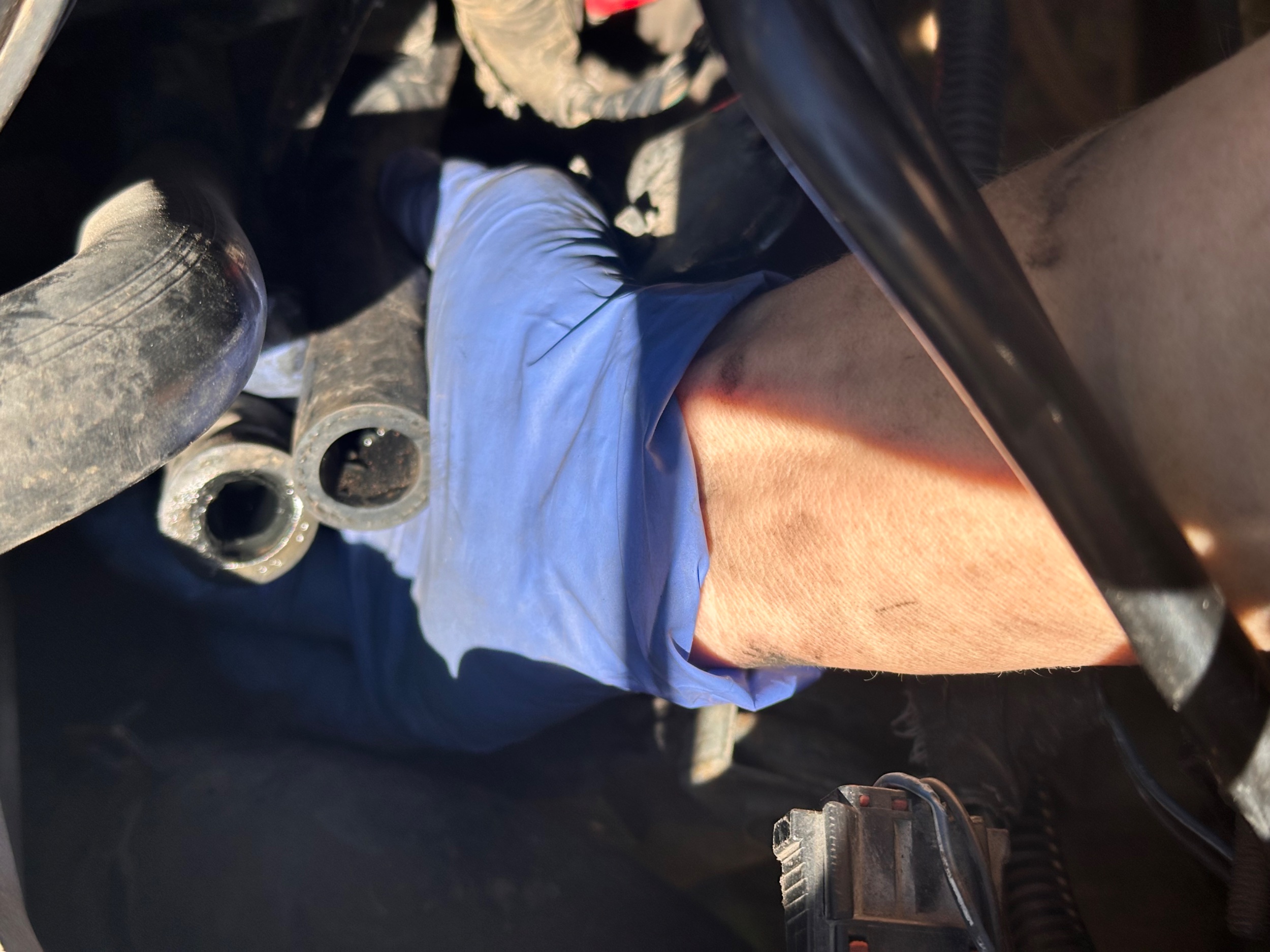

I have bypassed the heater core and it is still leaking from the aluminum part where the hose connects to the crimped aluminum. Idk even if there was a an ORING that has just been worn out or other then temporarily fixing to stop it from leaking.

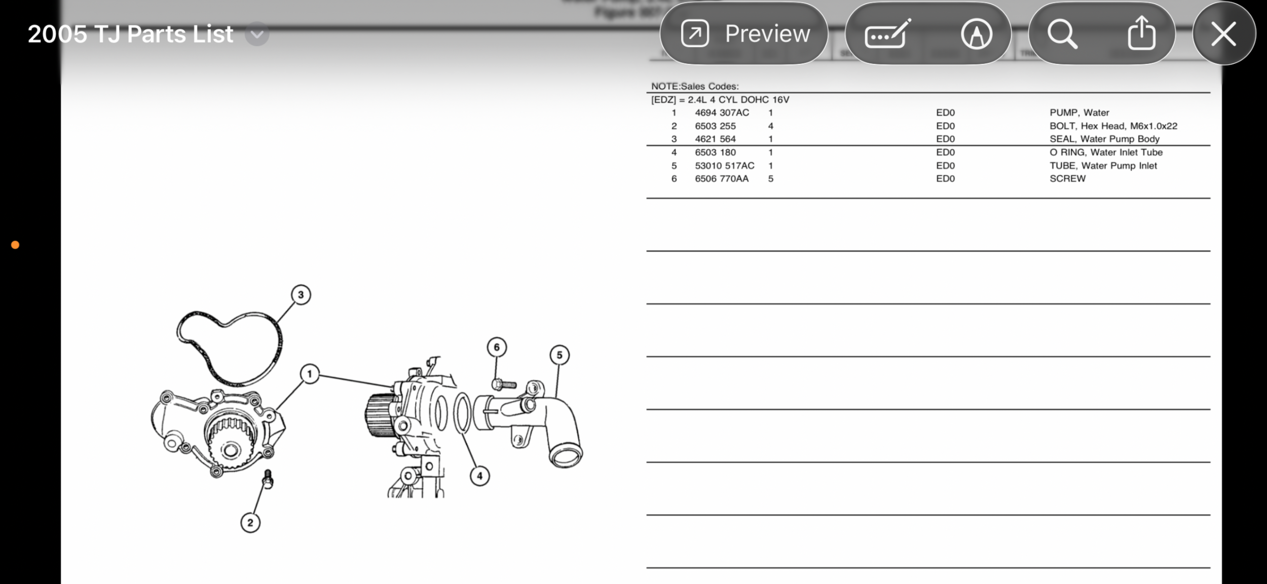

Sorry for the long post, just trying to make sure I explain it properly. I try my best to DIY what I can. The aluminum heater core hose is NO LONGER available. So I decided to try and replace the entire inlet hose let and delete the aluminum part. The inlet elbow broke taking off the hose clamp!! UGHHHHH - but it is 21 years old! Brittle for sure
Part number is 53010 517AC labeled #5
