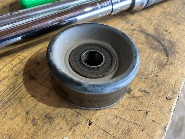

so the water didn't work but I pulled the stethoscope out again & the idler pulley was screaming so I'm pretty sure that's it. Once I did that I could hear it more distinctly without the stethoscope, definitely sounded louder the closer I got to it.

Could also be the idler pulley
Winner Winner Chicken Dinner!
My thanks, and gratitude; somehow you nailed that from a crappy 12 second video clip while I had my actual head in the engine bay for a half an hour & couldn't figure it out :LOL:
$14 & about 5 minutes of work & she's quiet as a church mouse:
