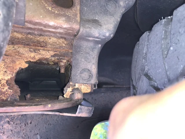

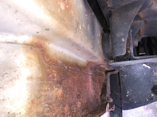

So been researching to try and identify this panel but am not sure what this is.
On my TJ I’ve got one bad rust area as in the images. It’s right at the rear passenger fender well where the torque box ends but it isn’t the torque box. Looks like the passenger side rear Floorboard but when you look into the hole you can see where the seatbelt bolt is so wasn’t sure.
Could use some assistance in which panel this is so I can replace it.
Thank you.

That looks to be the main floor pan that the torque boxes are spot welded to.
i was wondering. Seeing an interior wall had me confused though. I have been leaning that was based on a diagram I saw.

I have contacted people selling parts cars and more then once I was able to have someone cut out a section and ship it. Did 2 Triumph TR6's many moons ago.

I think you're going to be best off either buying a new tub or making your own panels.
