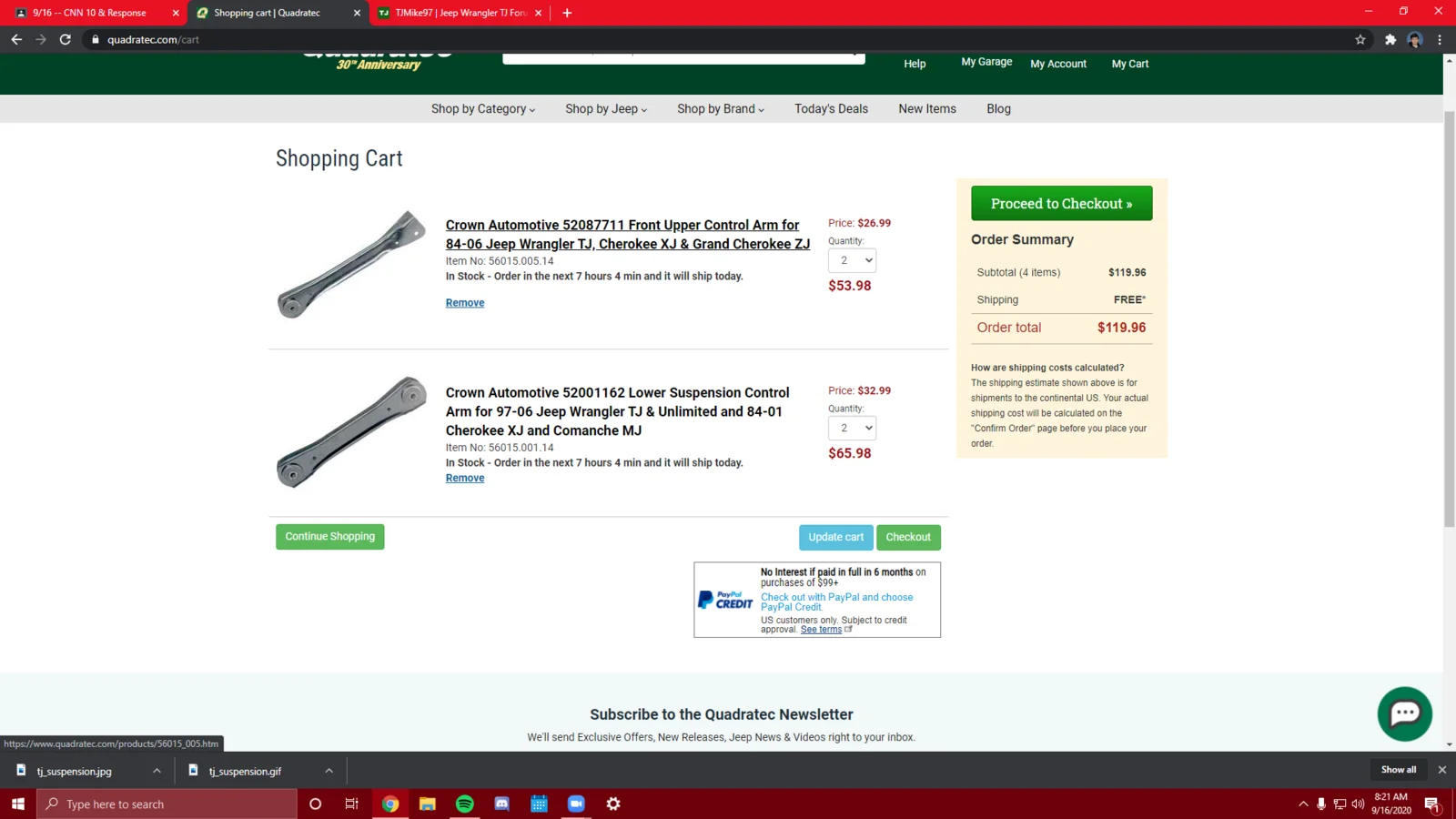

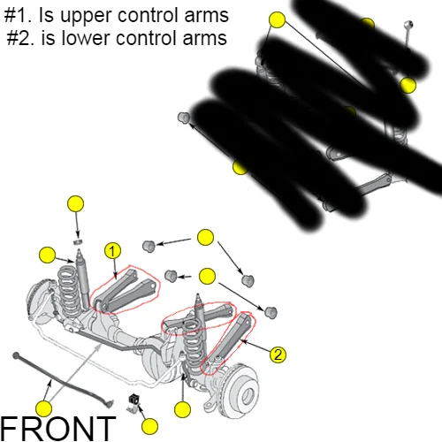

So my bushings on all my front control arms have gone out. And my lower control arms are dented up pretty bad. So i would like to replace them all! i know i need 4 but are the upper control arms the same and the lower 2 are the same?
I also attached a JPG so you can understand. And what would yous recommended upgrading to? i dont wheel a lot and i use my TJ as a daily so i dont need anything beefy or strong.
Also attached a image of what i was thinking of buying.

Need more info on current suspension set up and/or photos from underneath. Your profile lists a 3 inch lift but your looking at Crown replacement stock control arms. To answer one of your questions, upper control arms are not the same as the lower control arms. For the front you will need 2 upper and 2 lower of whatever you decide.

Let me save you the trouble:
Comes with all 8 arms with bushings already pressed in.
Not all 8, there is 2 bushings you have to buy to press into the mount on the axle for the front upper control arms

If you just need stock control arms you can buy Moog arms and bushings for front and rear from Amazon for $262. Go to Moog’s website and put your vehicle information in and it will show you the parts you need.
