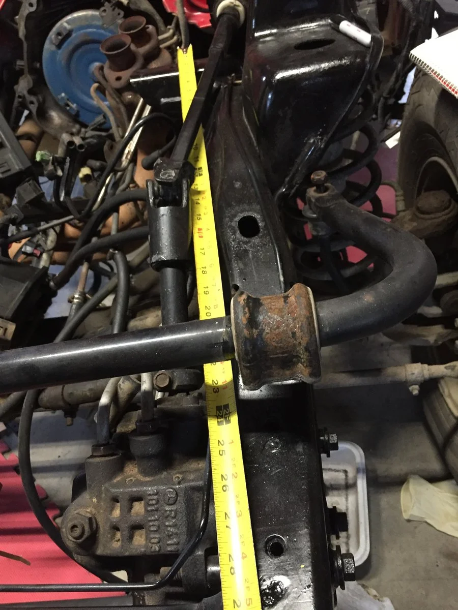

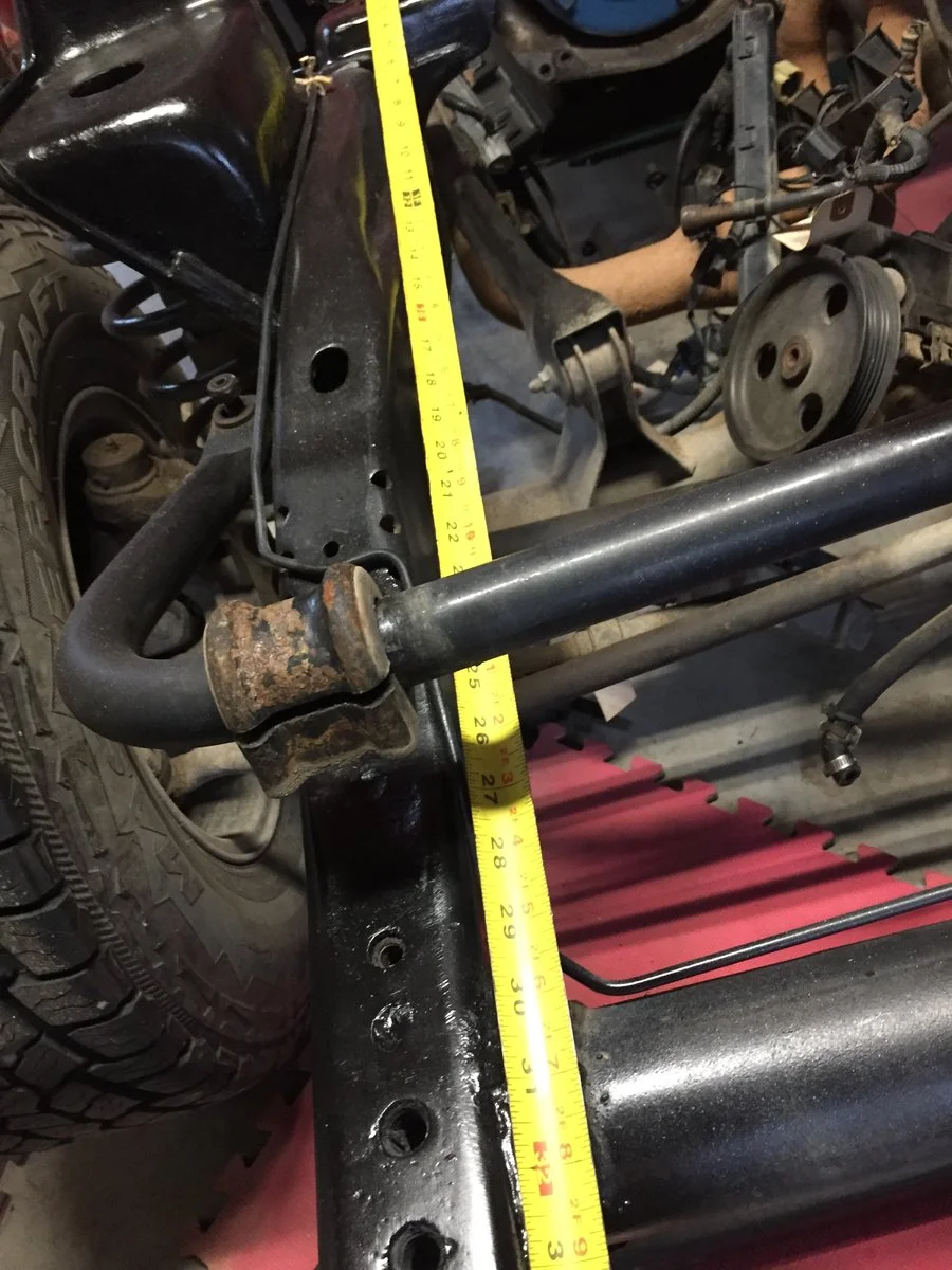

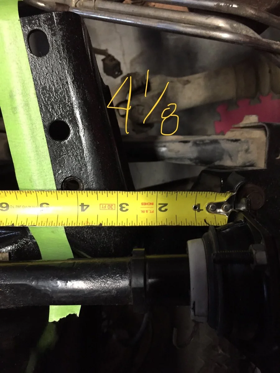

This pic and one below show how I ran the tape to get the measurements

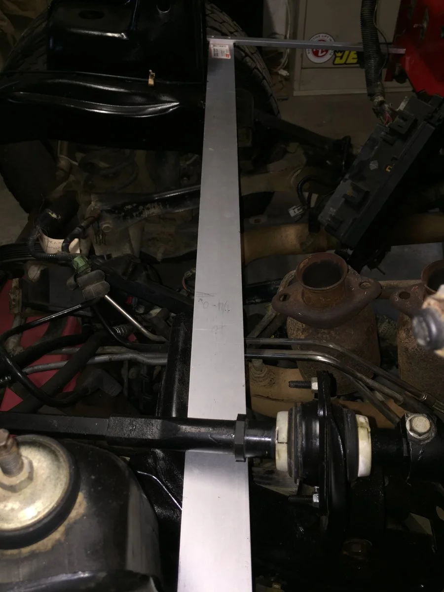

Measuring from steering bearing bracket parallel with steering shaft

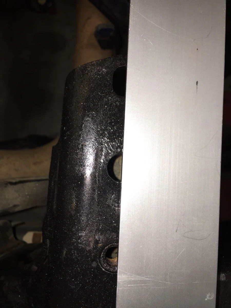

this shows where I measured from. Pass side for reference
^^^ this pic pass side, showing how straight edge lines up. was actually centered on holes

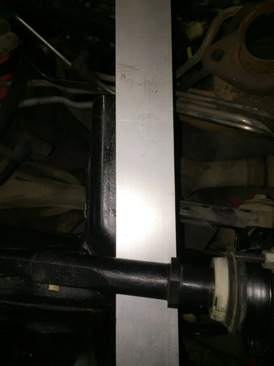

^^ these two show straight edge lined up with shock towers

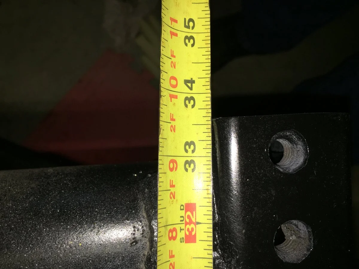

Centers of outer holes are 24.25 center to center
Passenger side is 33.62
Driver side is 32.0
If anyone needs clarification let me know.
Reactions: Njeanette
I realize I posted some doubles and missed a pic . Trying to post pics from phone and then add captions from PC 🤦‍♂️
View attachment 122464View attachment 122463
View attachment 122459View attachment 122459View attachment 122460
Driver side is 32.0

thank you so much. This is exactly what I needed!
