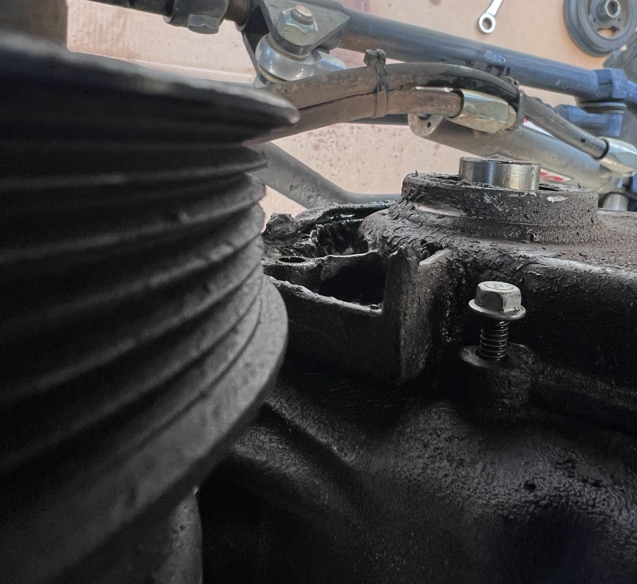

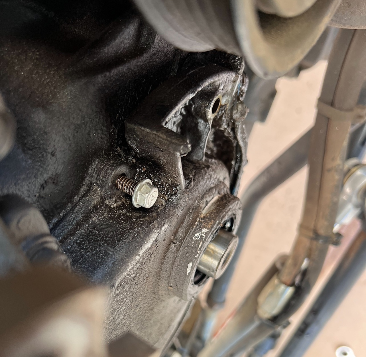

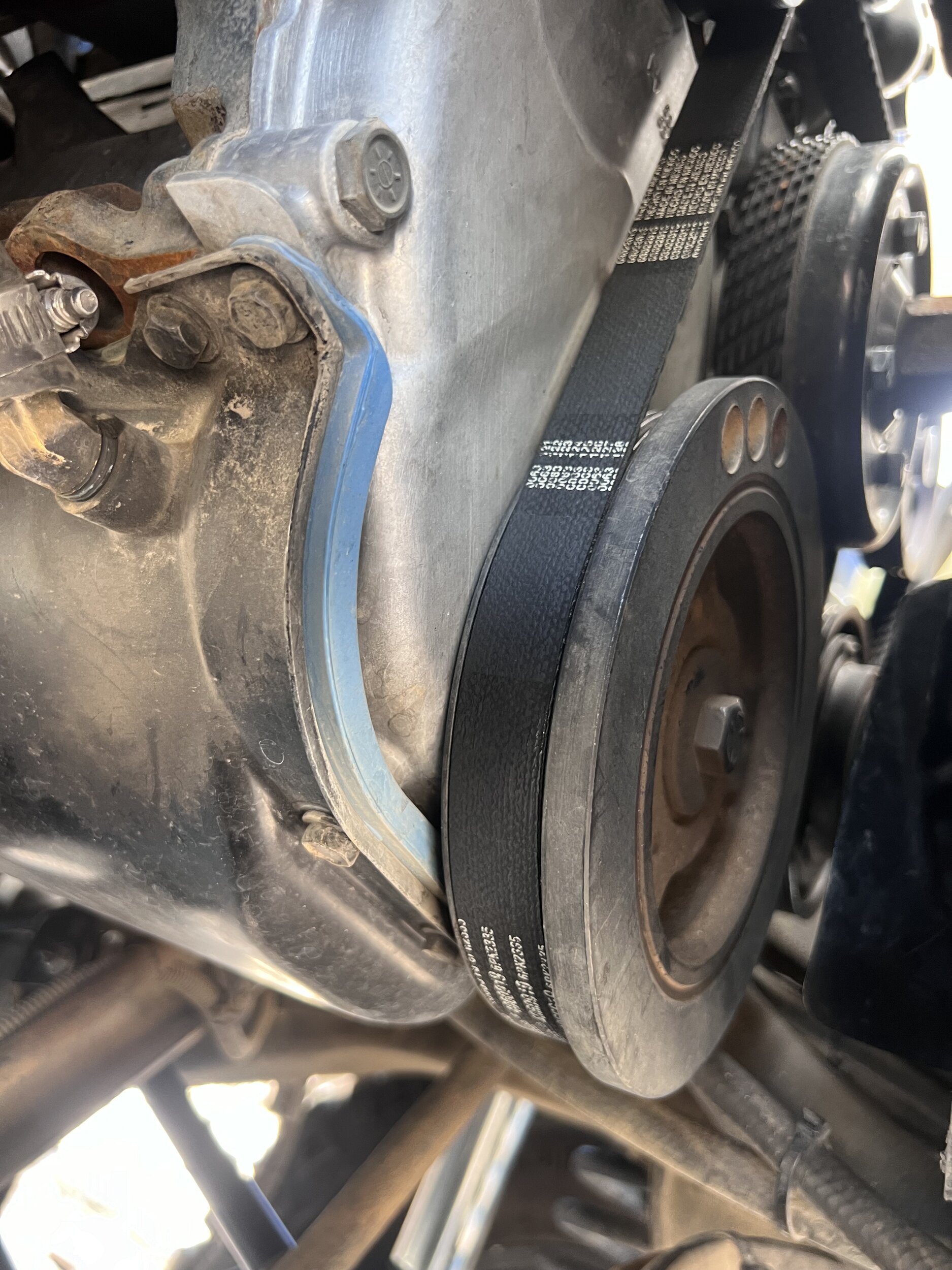

He's likely got multiple leaks going on.
My timing cover looked like his for a long time. Notice where the dirt stops accumulating...which means it's likely coming from the front crank seal instead from above at the valve cover. He likely needs a new seal in the timing cover. As it gets worse, it will run along the bottom of the pan and even can get to the transmission pan.
That's not to say he doesn't also have a valve cover leak or leaking RMS.
For the front seal:
- pull the fan and radiator
- pull the harmonic balancer / crank pulley
- pull cover
- clean gasket material and pull seal / or buy a new cover
- Install seal in cover
- install in reverse order
(this is if you don't change the harmonic balancer or chain and sprockets)

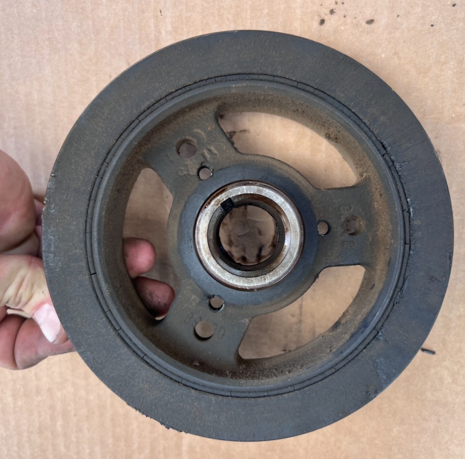

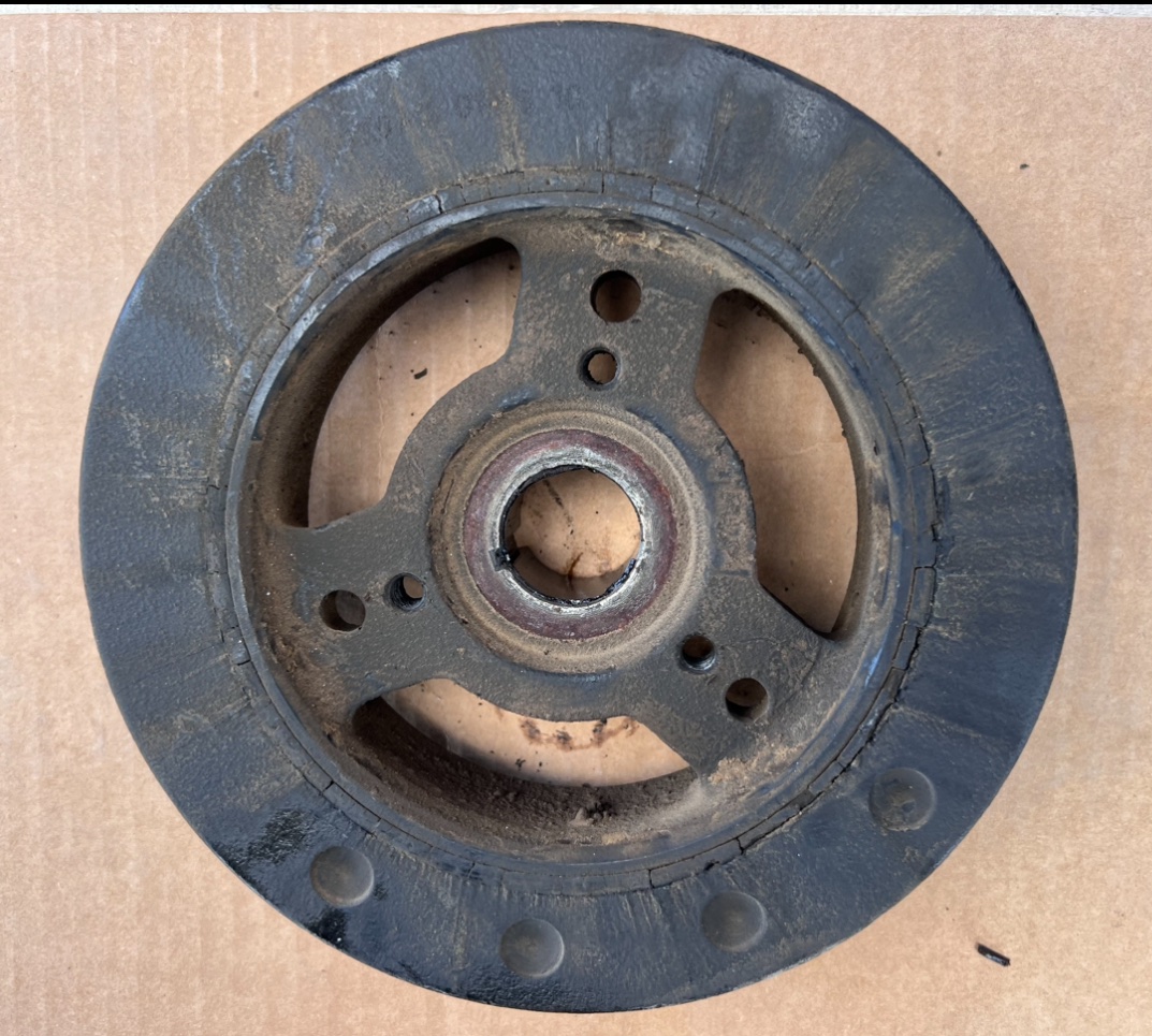

Before:
The leak got really bad at the end sending oil to the back of my pan and to my transmission pan. The harmonic balancer flung oil all over, including up, which is why things are wet above the cover and on the WP pulley. The valve cover was not leaking.

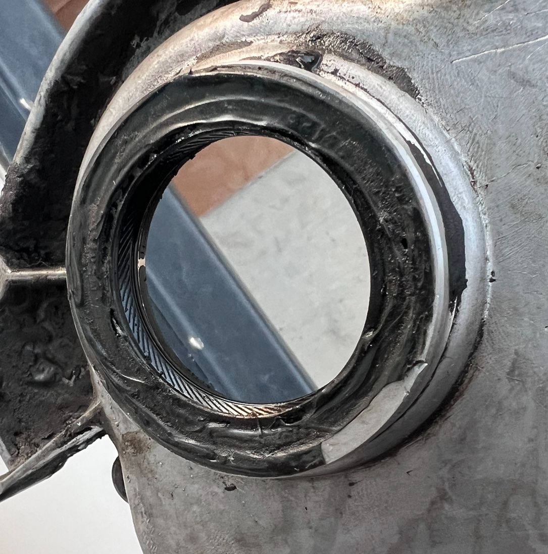

Don’t do what the PO did…sealant over the seal.
Notice the cracks…
Today:

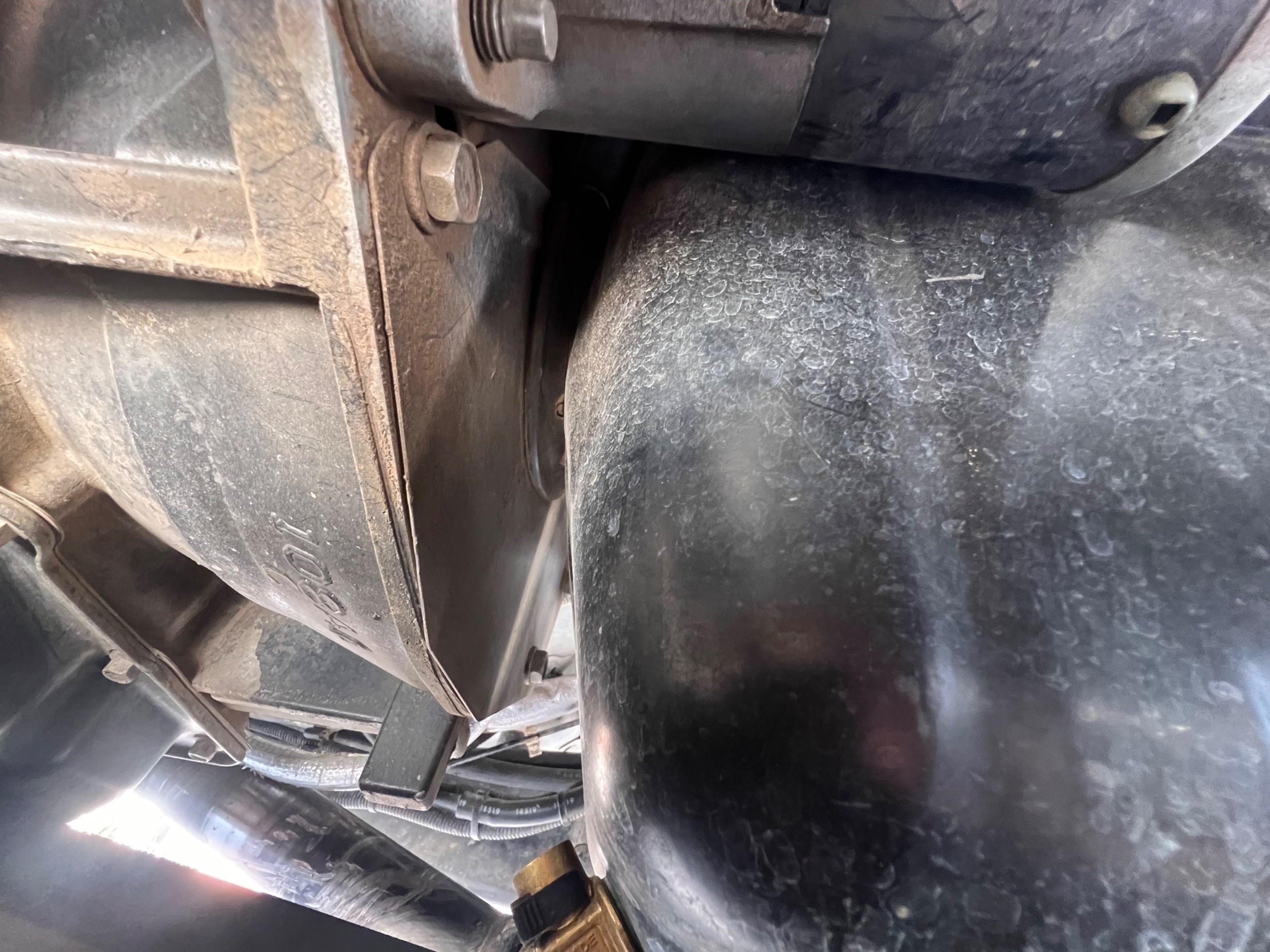

Bonus shot of the pan and RMS:
