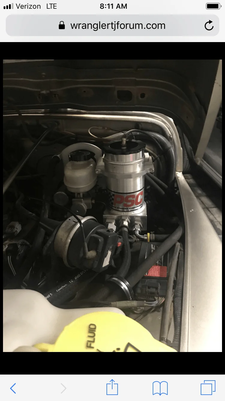

Could you elaborate on what you believe is difficult about installing the MP SC? The only thing that seems difficult is the HP Tuner. And from what I’m told that will be done by someone else, well if I could get him to call back.

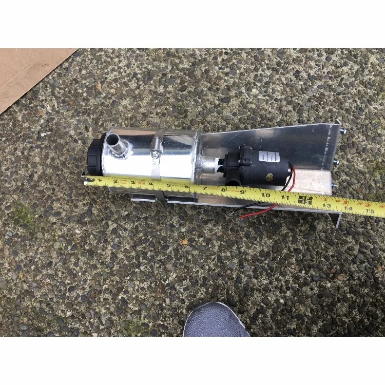

Isn't there a liquid to liquid heat exchanger involved?
I’m going off memory, which isn’t great, but yes.

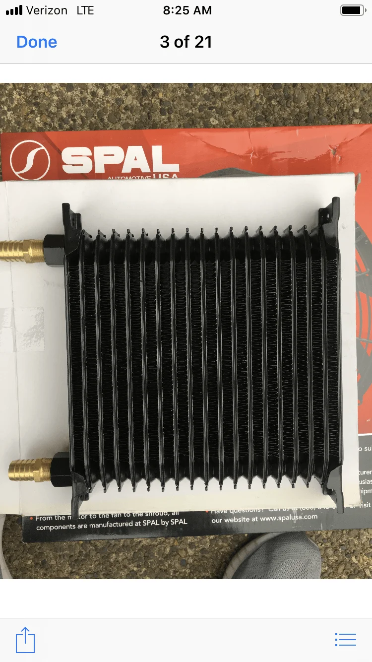

If that is accurate, there is a pump that circulates coolant. The pump has to be temp controlled somehow unless it just runs all the time. The plumbing for the coolant hoses has to be dealt with. There will or should be an exchanger for the charge air to blow through. That has coolant in it that will need to be sent to the cooling radiator with or without an electric fan on it. If it is in the grill, getting the coolant lines in and out will not be easy. If the radiator winds up under the tub, the length of the lines will need to be taken into account to keep the fluid circulation level correct.
The under tub version will need careful attention. I know beyond a doubt that the under tub trans coolers with a fan on them are only about 1/2 as good as the ones in the grill at anything above crawling speed.

Yes all of that is correct. I’m not sure if the pump is temp controlled but it will be mounted on the driver side battery tray. It is going to be a tight fit, really tight.
The cooler will be mounted behind the transfer case. If you have any suggestions on a fan it would be nice to know.
I would use anything Spal for the fan. The key will be to get enough room over it to allow the air to move easily through the exchanger. My preference would be a long skinny exchanger with 2 or 3 smaller fans in a row across the face. With the other stuff you are doing, that is going to be a challenge.
Good to know, that’s what they sent. Several, yeah that might be difficult.

After talking to Charles at length they have had some cooling issues in AZ. The issue is stacking the coolers in the front and the winch limiting air. The solution that worked was placing the SC cooler behind the transfer case with its own fan.

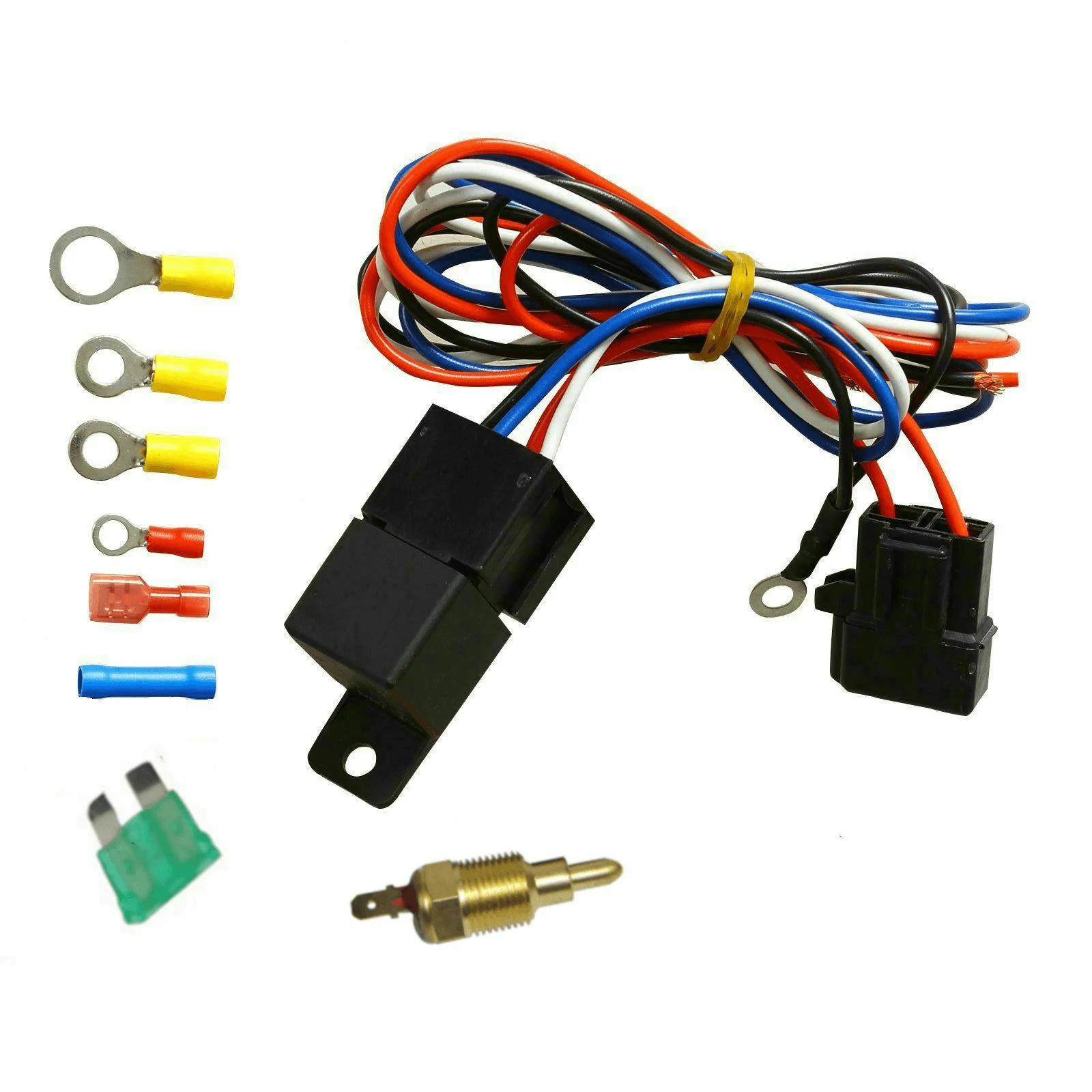

I am pretty sure that the electric fan Charles includes doesn't come with a temperature controlled wring harness. In fact, I know it doesn't. Charles told me he usually just has people wire the electric fan up to an ignition control power source, so it's either always on or always off with the ignition.
However, he had told me that if you want, you can get a wiring harness like this so that the fan comes on like the factory fan does, only when the engine gets hot enough.

Based on the info posted so far, the sensor in the kit is turning the fan on and off at specific temps. It will close the circuit to ground to trigger the relay that turns the fan on when a minimum temp is reached. If the fan is able to cool the system below that threshold, it will open the circuit and turn the fan off.
If it was on and off with the car's ignition, there would be no sensor.
For this kit I have to run the sensor ??? Or how do I connect it please the seller is so slow he wont reply until monday. I dont understand I can use the electric fan just when the car is off or on dont install temp sensor that had a wire connects to

So i used this originally. You need to wire to a constant (positive battery), Switch (aux), Ground(negative battery). The temp probe I made a T from some pipe fittings from lowes into the heater line. Left the factory temp sensor alone.

could I just leave the temp sensore alone? and just instal without thermostat
