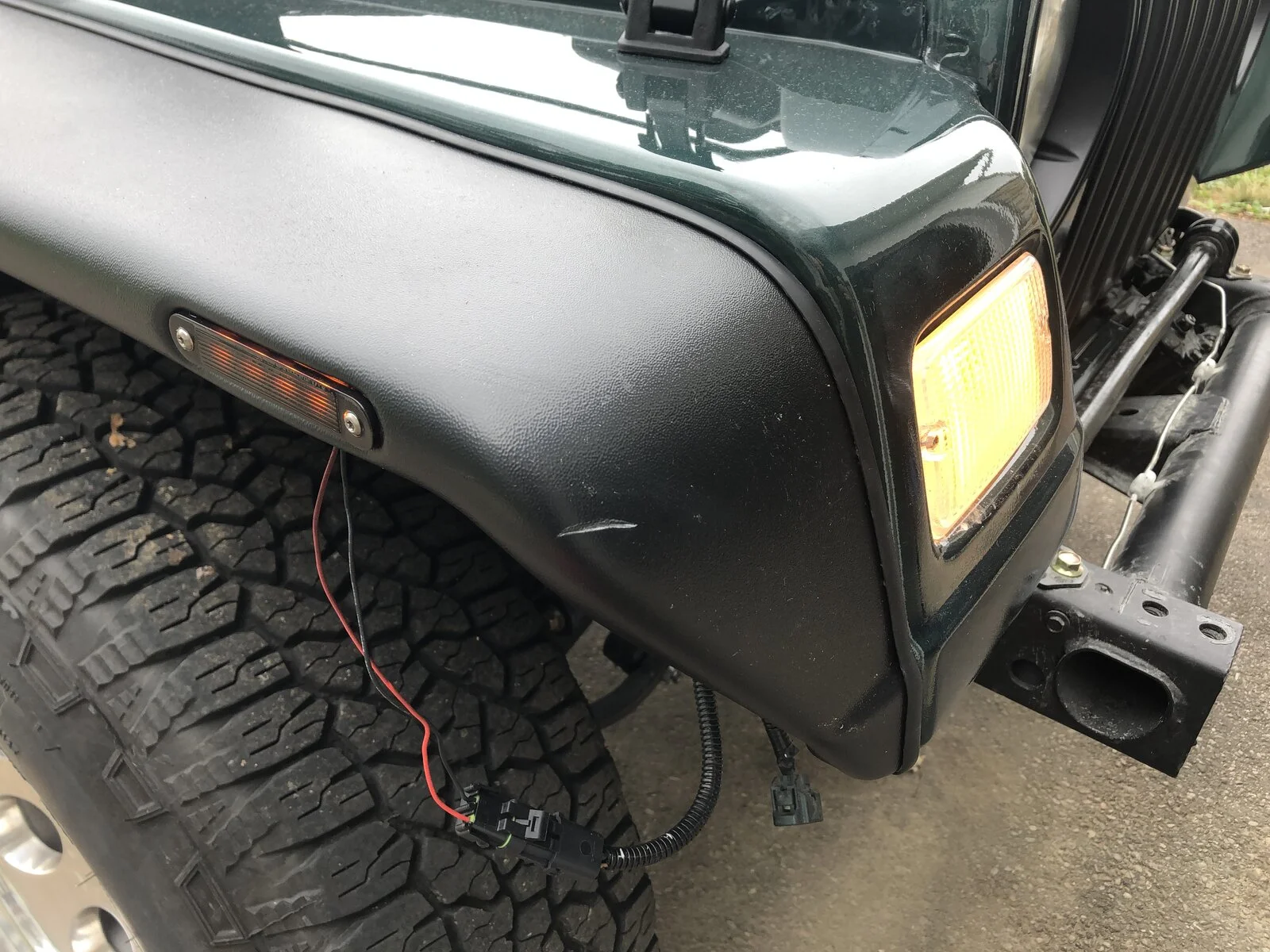

I am curious now if there is a difference in model year circuitry when it comes to the lighting. I have a 2000 Canadian market TJ and just put LEDs on every single piece of exterior lighting, and did the flasher relay mod instead of getting a new relay and everything works fine. No rectifiers or resistors, just plug and play mostly with no hyperflash and nothing seems dimmed. The front turn signals or some cheapo amazon switch back LEDs, the sides are I believe LEDs that came with my EAG fender flares that I put some smoked tint paint over, and the tailights are Rugged Ridge.

Ill pay more attention with headlights on and off with the fender flare markers, but I can say for sure no issues on the front facing signals. Could also be these are not LEDs? As heavy as I went with the smok tint im suprised they are as visible as they are in daylight. They are more noticeable in person and I think will be plenty visible to other drivers.
