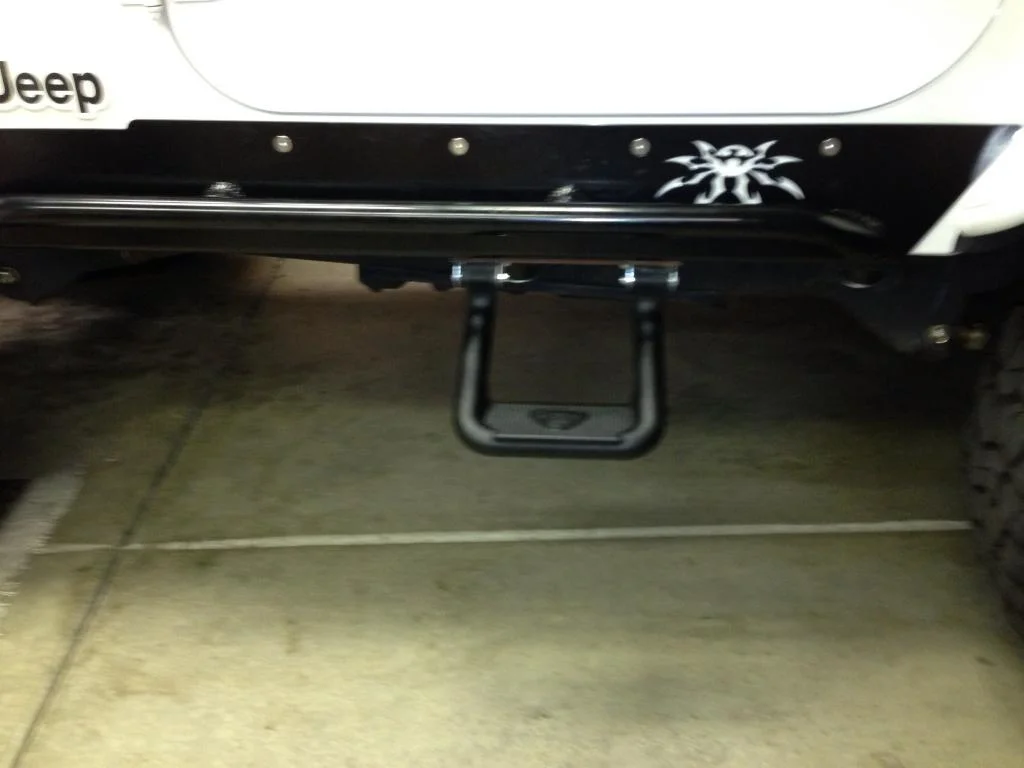

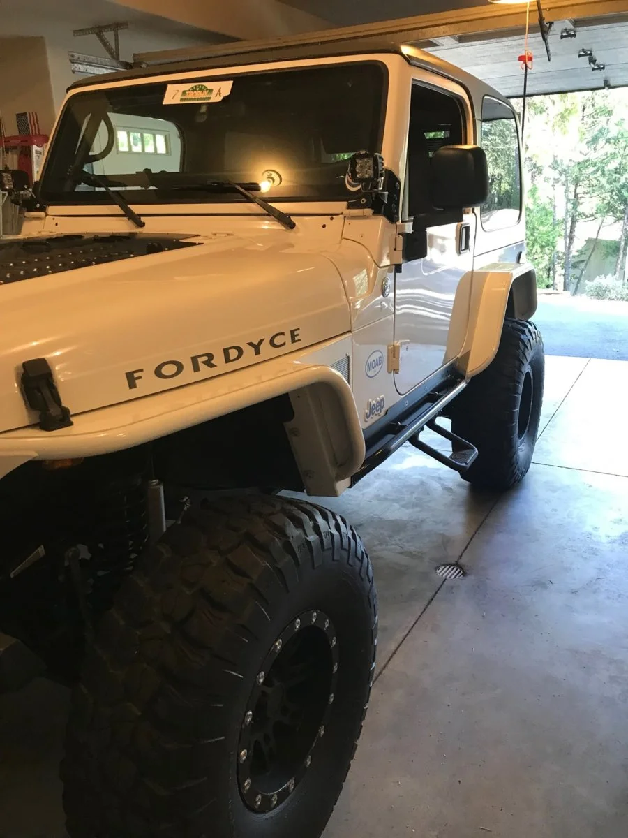

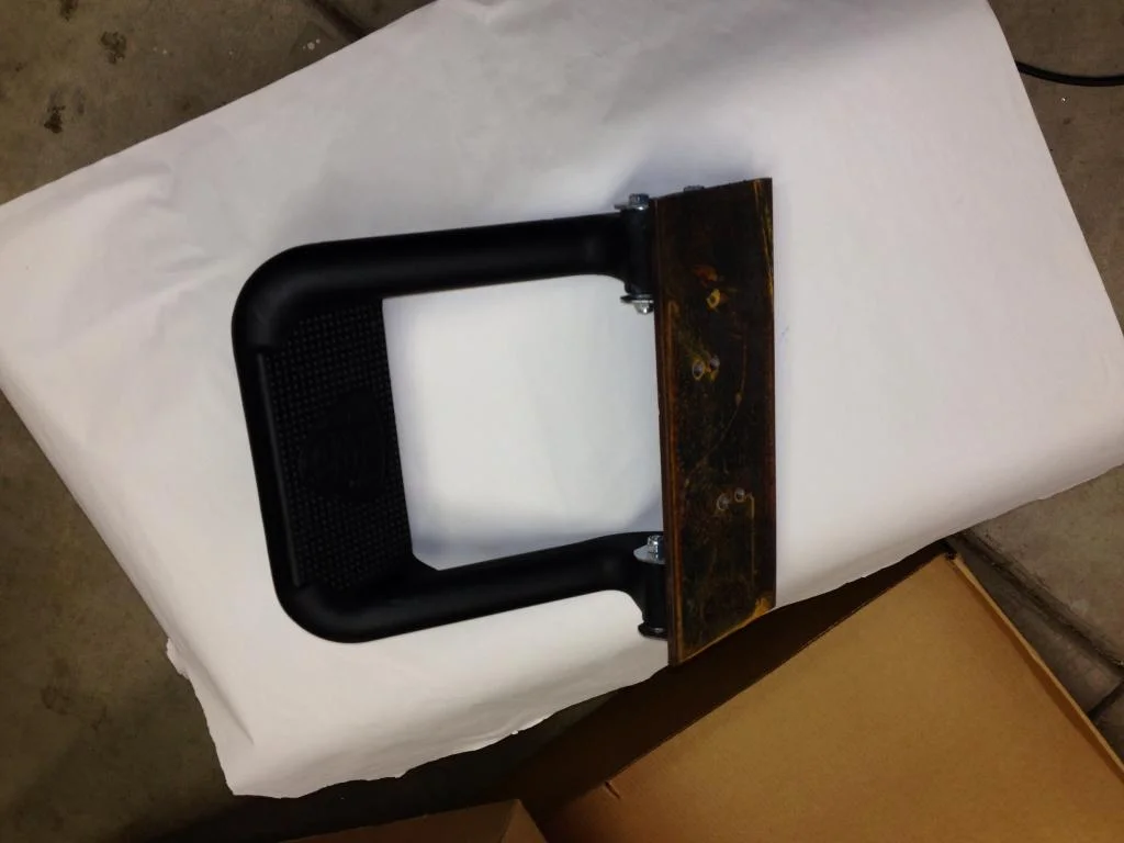

You can do a combo like I did for the wife. I added steps to my rock sliders that a very easily removed for trial use. I welded the brackets to a piece of flat plate, then drilled and tapped the underside of m sliders. They are held in place with two 3/8" bolts and when removed nothing hangs down below the sliders.

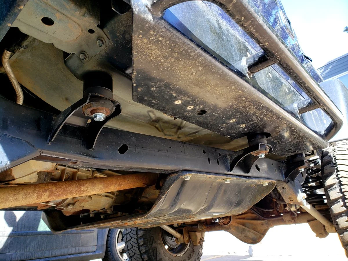

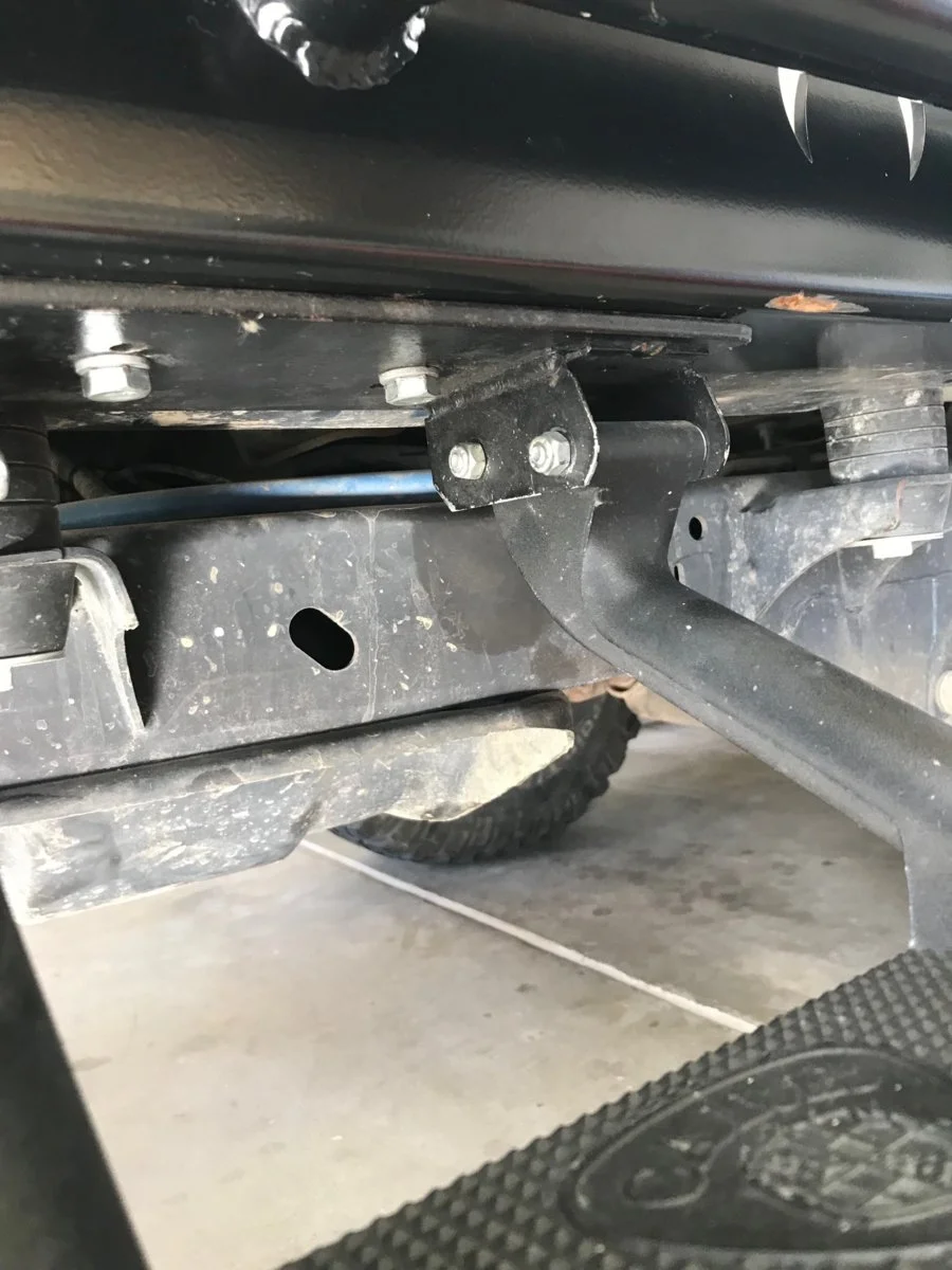

Something tub mounted for sure. Avoid tying into body mounts.

I would say that the reason you wouldn’t want to is because you want the slider mounted against the face of the tub in order to relieve stresses. They should be surface to surface.

Any designer that ties into the body mount using a mount with a hole in it that sits on top of the OEM body mount does not in fact know what they are doing.
