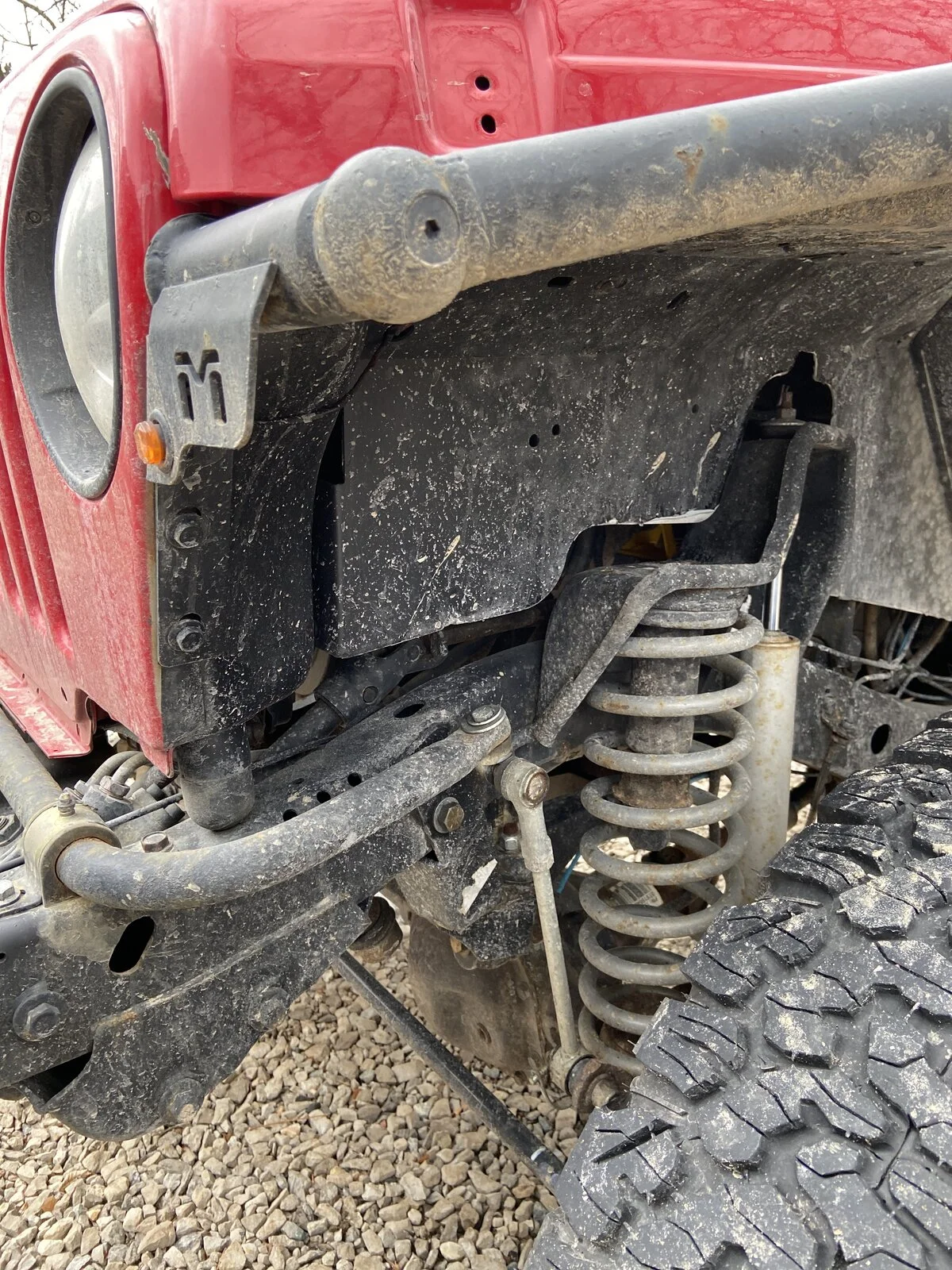

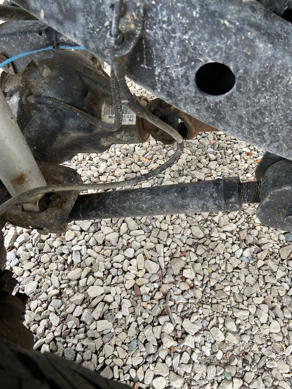

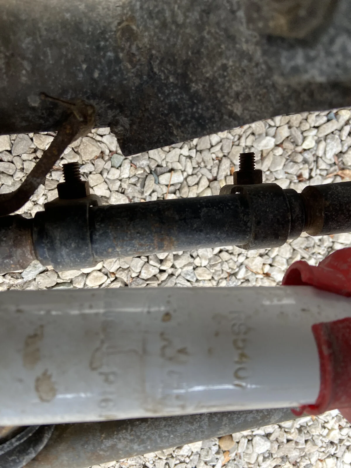

Look closer. He has a dropped track bar so a drop pitman has to be run as well or he will have bump steer.
Okay, looking at the one pic closely, appears to be the case. There’s no need for either. If his TJ is driving like crap, I would simplify and not use all the extra that is not needed.

What are the extras not needed?
Unless someone corrects me, for a 4” lift you do not need a drop Pitman and Drop Track bar mount on the front . Adjustable track with the stock location and a stock Pitman is all you need.
I have a 4” lift and replaced the drop Pitman that came with the Jeep, and went to stock. There wasn’t a bracket, but either way neither are necessary.

Well damn, I literally just removed the stock Pitman arm a month ago but had to cut that sucker off 🤦🏻‍♂️. Do you think I’ll be OK by just removing the drop-down mount for the track bar on the frame and getting a factory Pitman? Also I dropped my tire psi down to 25 and it’s a little less bumpy but still all over the road.
Is the drop pitman the one that came with the lift? If it is just run it and do not worry about taking it and the track bar off. Spend the time just getting things dialed in and drop that tire pressure and things will be better.

Yes it came with the lift. I did drop the tire pressure to 25, the ride was definitely not as bumpy but it’s still all over the place 🤦🏻‍♂️😂
And she’s off the tank. Found a Currie mount on marketplace for $55
Reactions: SvtLdr
That looks much better.
