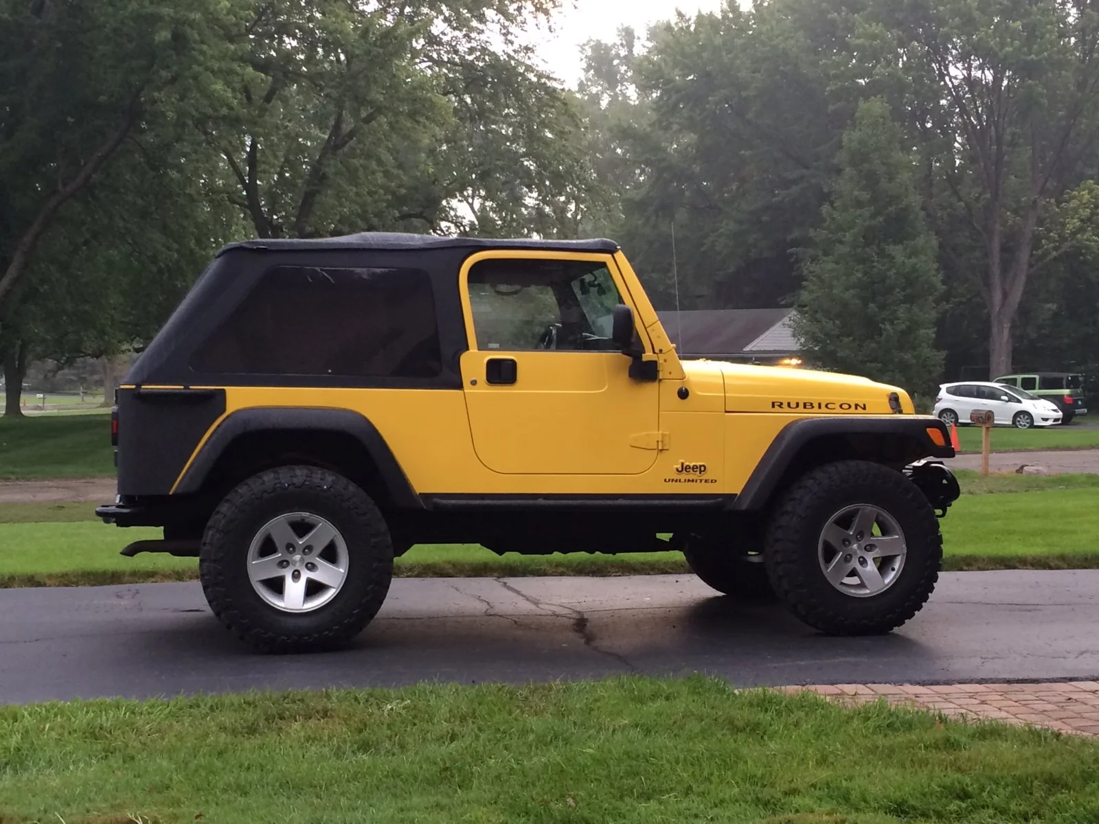

That being said, if you're looking for a 2 1/2" lift you can't go wrong with an Old Man Emu lift. If that's not quite enough lift, then you can add a 1" body lift. The benefit of going this route, especially with an LJR, is you won't have to change out driveshafts or worry about driveline angles. If you're wondering how that will look here is my '05 LJR with that exact setup running on a set of 255/85R16s (33x10).

Looks great. So that's a 2.5 suspension with a 1 in body lift setup?

It's going to be a pavement and trail rig, nothing hard core. I'm just surprised that the dealer who is a jeep enthusiast, decided put a set of 285/75R16 's on stock rims with no lift. I reviewed a few lift and fitment guides and they both say that a lift is mandatory. Besides, it pretty easy to tell from the picture alone.
Chances are your front tires will rub the lower control arms and your front sway bar at full lock. Your rear tires will rub the inner fender well if the suspension is flexed. A 2.5" lift and 2" bumpstop extensions will cure that. The OME lift is good stuff. I'm 10 years, 100k miles on mine and it's still going strong.
