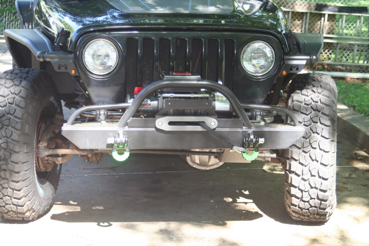

Look into Dirtworx bumpers. The dude builds strong bumpers that do not hurt your wallet. I had one of his rear bumpers 13 years ago and recently saw one on a local jeep.
Oh yeah....made right here in the states if that matters to you.

I have the pair of those on my Rubicon, and they are seriously stout. Robert @ Dirtworx will put whatever you need on the front to accommodate a winch.

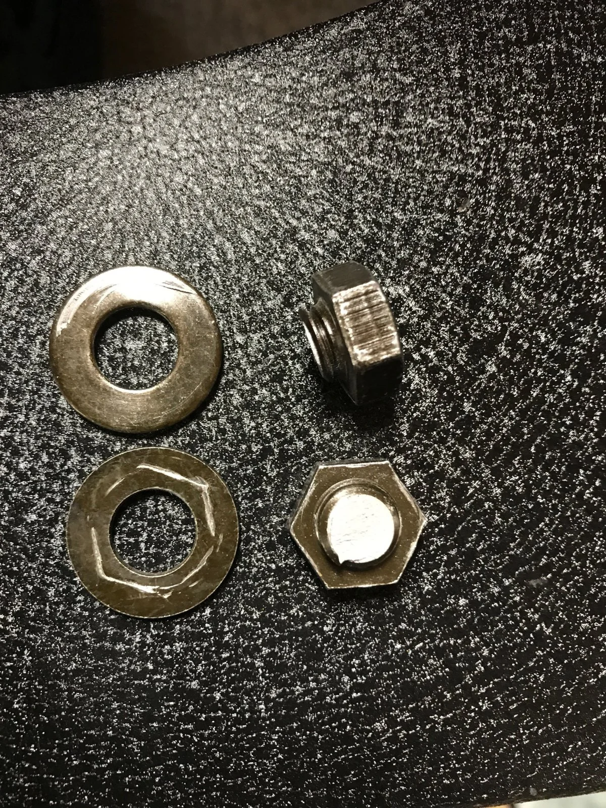

Guys I am new here and I don't want to start out bashing a product but I just got my first jeep and one of the first things i researched was a a new bumper so I can flat tow behind my truck and camper. I went with the smitty built XRC because it mounts right up to their tow bumper and had good reviews. I put the bumper on yesterday and was disappointed when jsut sitting it on the garage floor it scratched the paint. I was in the garage this morning working on something else when I heard a loud ping and a nut and washer bounced across the floor, it was easy to recognize as I had just put in the smitty bilt supplied bolts. It snapped off just sitting in the garage. I went to the hardware store to get grade 8 replacements and when I got home a second one had already snapped off. Thoroughly disappointed and will not look at anything else smitty built.

This also happens to me. My first bolt fly out on the middle of downtown CLE, you can imagine my face...
My stepson install mine bumper as a birthday surprise but he did not notice the bumper mount are is 3/16" wider than the frame. Pulling tension is a key on any hardware. We get all grade 8 and put a thick flat washer on the bottom side between bumper and frame. Issue fix. We have been abusing from this bumper especially pulling others jeeps using the shackle points during the last months and no issue whatsoever.
I do respect your point and your decision. Just be aware that mostly everything you get for out TJ 's comes with inferior hardware.

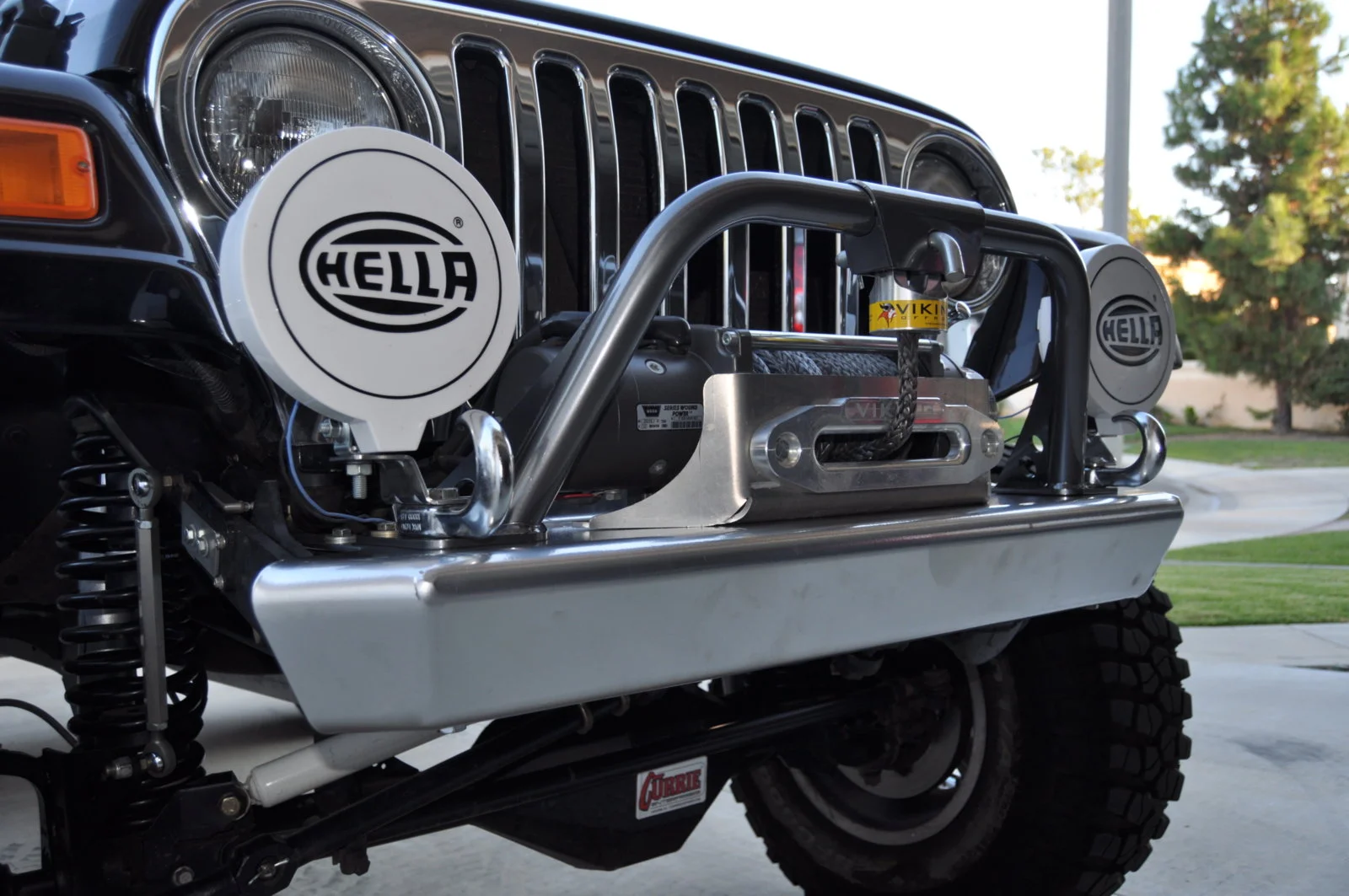

I like my genright front bumper
I don't usually run a rear bumper, but have been looking at the dirtworx rear because it has a similar profile to the front I already have

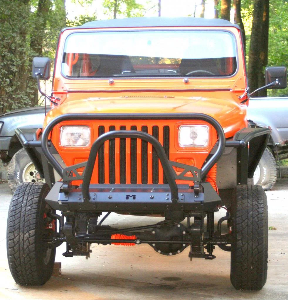

I also have a metalcloak on the YJ that I like since you can build it up as fancy or as plain as you like

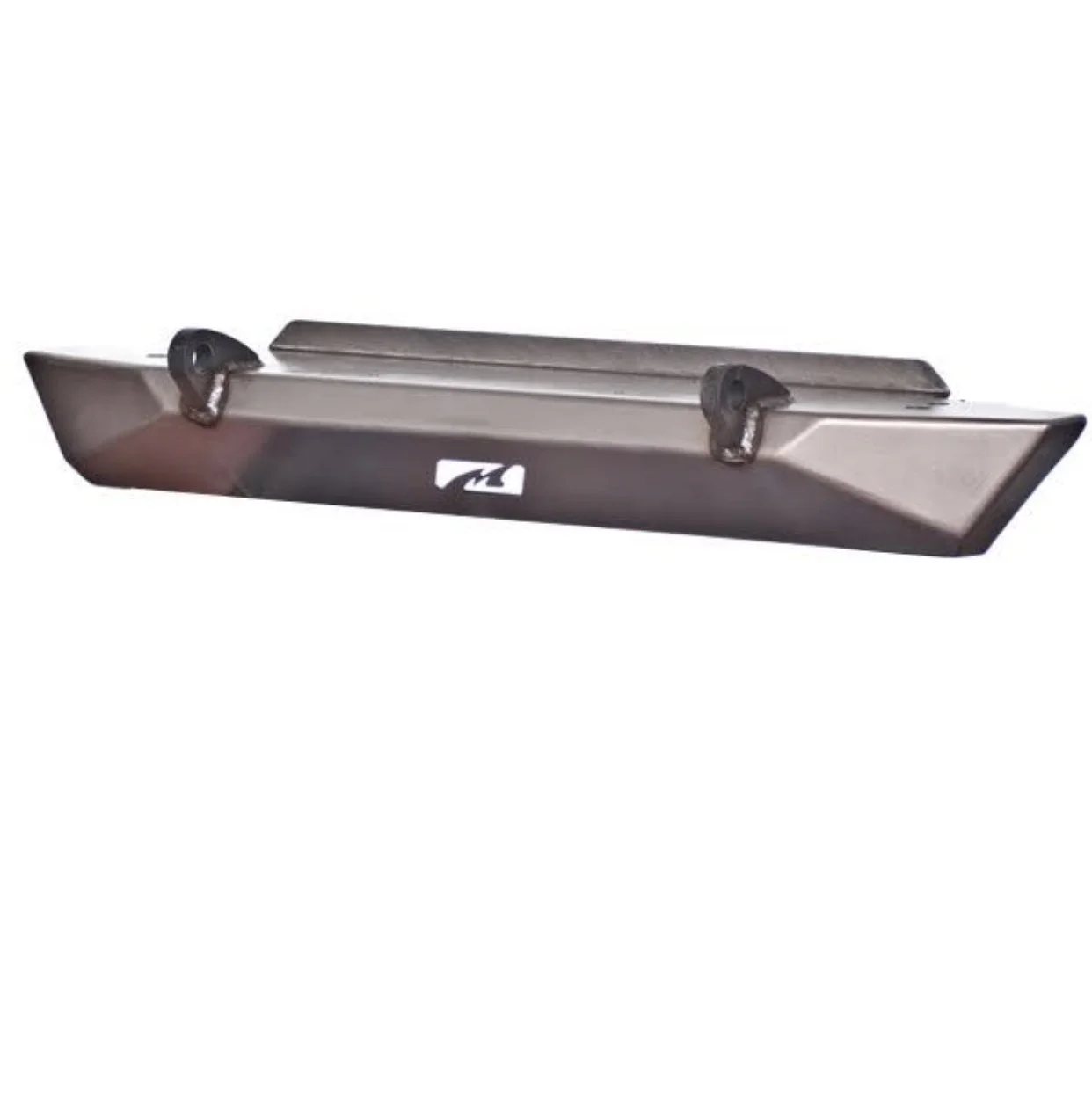

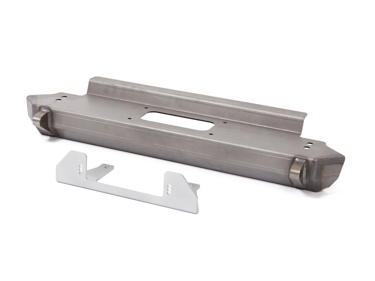

Based on this thread, I have sent an inquiry to Dirtyworks for a back bumper. They seem reasonable, and look heavy duty. Also have loops for safety chains so probably have a decent tow rating. Probably cost too much to ship, but worth an ask! Best back bumper I have see so far.
