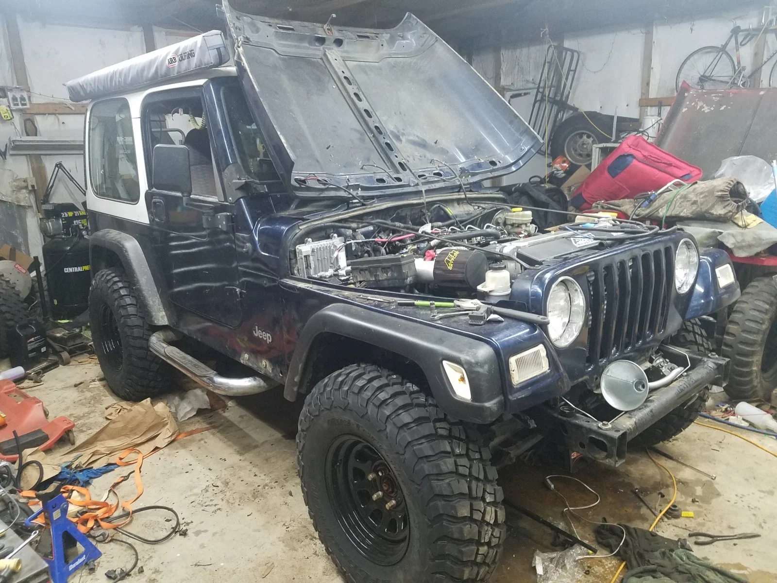

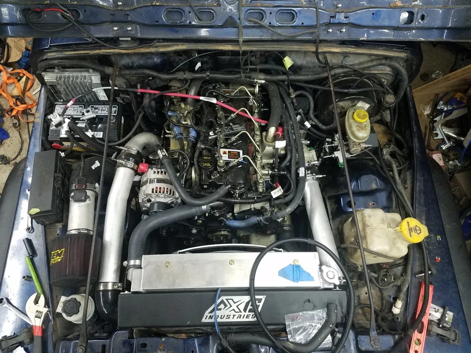

That's a fairly recent photo before I added a cheap coolant overflow tank. I do really like it but it wasn't cheap. I bought a kit from Axis Industries. I'm still waiting for some parts. The radiator and intercooler etc are from axis. I kept the stock ax-15 just put in a new clutch and new oil.
I'm not running ac. It's probably another $3k for it at the moment and I typically have my top and doors off over the summer.
I have no exhaust on it at all currently and at various rpms on the road it's noisy, but it wasn't quiet before the swap. I've only put about 220 mi on it so far which is an educated guess using Google maps and filled up 8.667 gal the other day. That was highway, backroads, a lot of idling to check stuff, some 4x4 stuff on the farm when I had a bunch of tools with me to work on 2 tractors, an f150 my dad has and to possibly have to work on something I forgot to address on the Jeep.
I'm not a lead foot kinda guy and find when offroad if I can't idle through something I should back up and try another route or use a winch.

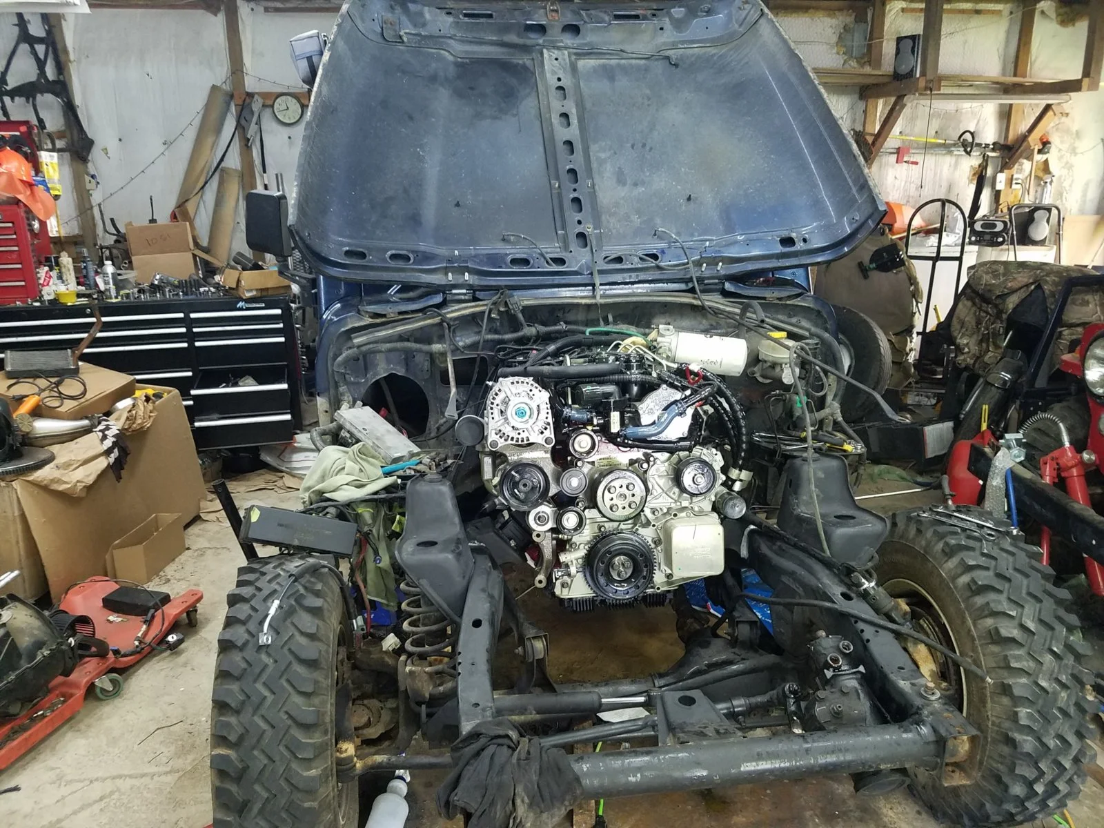

wow that's impressive...looks like you needed a shoehorn to squeeze it in. :D The torque on that would be amazing I bet ?
The torque is great which was the major draw for me. HP is irrelevant imo for a normal Jeep, but that depends on your driving style. This engine reminds me of a large V8 that doesn't require changing the entire drive train, but the fuel economy (early indicators) of some kind of small crossover hybrid.
The fit is a bit tight, but it's not terrible. In time with the EGR removed fitment will be much better. The EGR and DOC are the problem trying to cleanly route everything. The DOC forces your hand practically on engine placement. They do make brackets so you can squeeze in an AC compressor, but it was just too much money on top of everything else, considering I like to take the top off and the doors off during the summer and pick my trips.

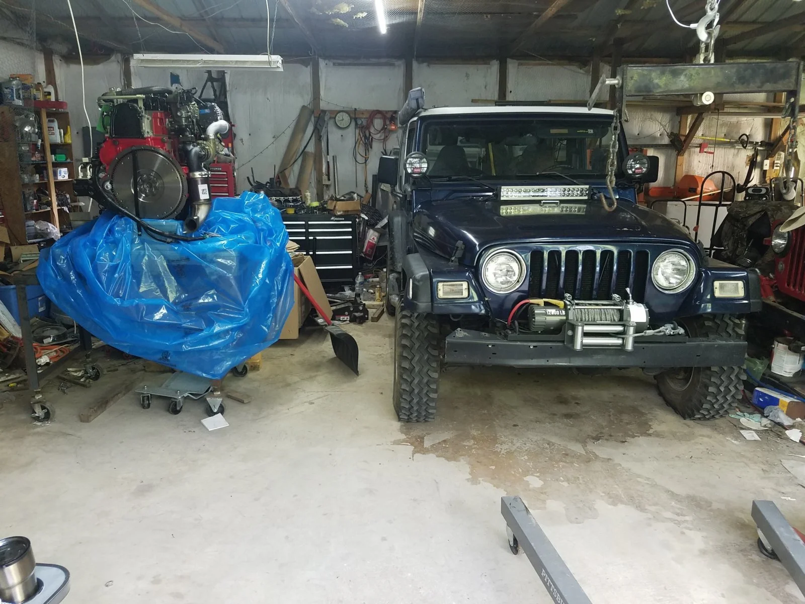

Here's a couple more. One of these days and it likely won't be until December when I'll have the time, I'll try to put together some videos of the install. It's mostly of me being an idiot and doing stuff more than once, but I was trying to explain stuff because in a few years there isn't going to be a service manual for what I've done.

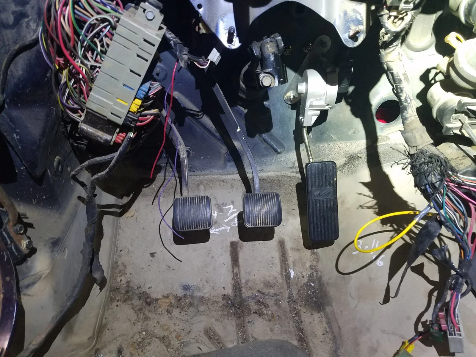

Next big task for documentation is a wiring diagram. I've removed handfuls of wiring and more to come since removing the PCM. I'm also looking into one of the SPOD HDs to try and simplify some wiring, but the price tag is keeping me away for a bit until I can address several other areas like axles, exhaust, need to relocate front turn signals, because I destroy them and I guess an Atlas transfer case to slow me down a bit in 4Lo.
