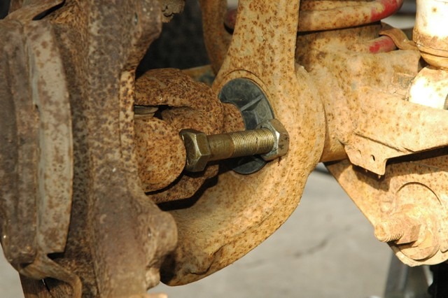

You may want to put new hubs in while you are in there, it’s not much extra work. I know some here say don’t use a ball joint press for u joints but my 97 TJ would have not been possible without one. Getting them out was a real challenge. Getting the new ones in was easy. I used a Dremel with a small flap wheel to polish up the bores a little.
Not a good idea. Those u-joints are often a LOT of pressure trying to pull them free and polishing what they're seated in can just make that easier and more likely to happen. They depend on a good friction fit to remain seated in some situations.
So install with a socket and hammer? Any good ideas? How is it getting them out, the old ones? On my rear shaft they were pretty stuck, they were the originals. After almost 2 hours and no succes I brought the shaft to a shop and they got them out. So anyone’s past experience would be helpful. Thanks again
I've only used a hammer and sockets on the axle shafts. At this point, I find it easier than using a ball joint press. The first time, I did it with the unit bearings still attached. The second time, I had the big 36mm socket needed to pull everything apart.

We only say that because of the several bent yokes folks have sent us so we can try to straighten them back out to get the clip groove exposed enough to get a clip in. Also, as stated, the bore needs to be the correct dimension to retain the interference fit to support the cap properly under load when they are pressed in. You really don't want to remove any material at all from them.
