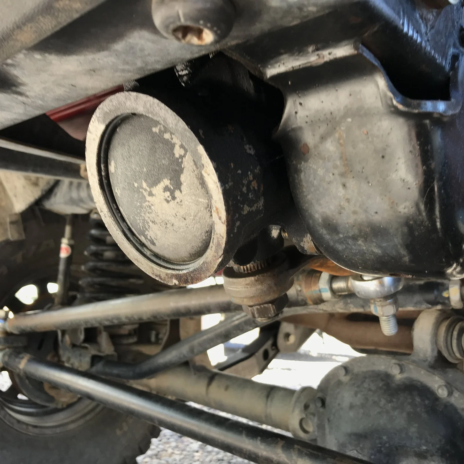

Steering gear box has a slowly dripping leak. From the pic, I can see those are not the original bolts mounting it to the frame. Not sure if the PO tried to fix it or not. I’m assuming since it has been pointed out in other posts that “steering and brakes” are prolly the most important, I think I should start there.

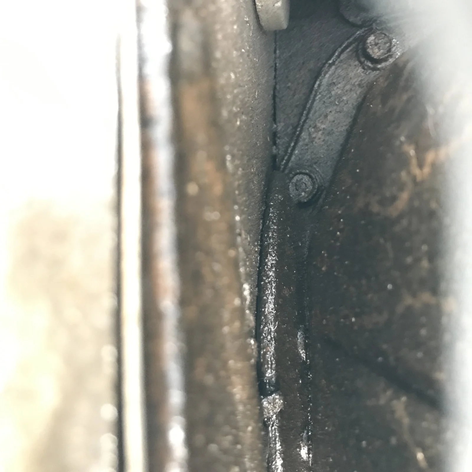

Next, I think there is a leaking RMS or oil pan gasket. There is also a soaking, slowly dripping leak. As you can see from the pics, it doesn’t look like anything out of the ordinary for a 19 year old vehicle. I could be wrong though.

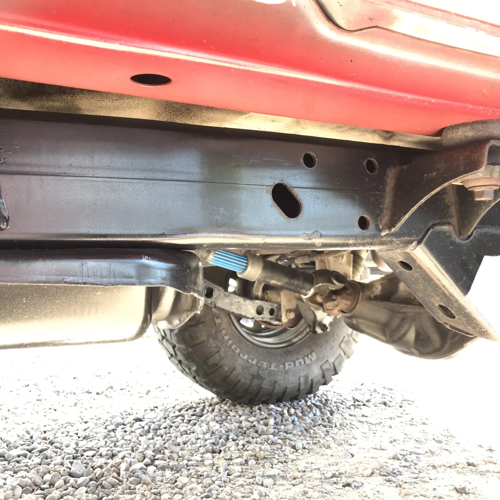

There is NO rust on the frame as it is an AZ only vehicle, except for when it was born.

Where should I put my priorities first. Steering, or rms/oil pan?
As always, thanks for the input!
If more pics are needed, say the word. Taking them is FREE...
First off...Congratulations on your new Jeep! I like it!
I would do the steering first...want to be safe. Also on the RMS....check the back of the valve cover gasket, they have a tendency to leak and run down by the RMS, making it look like the RMS is leaking. Just to be sure before your tear into the RMS.
