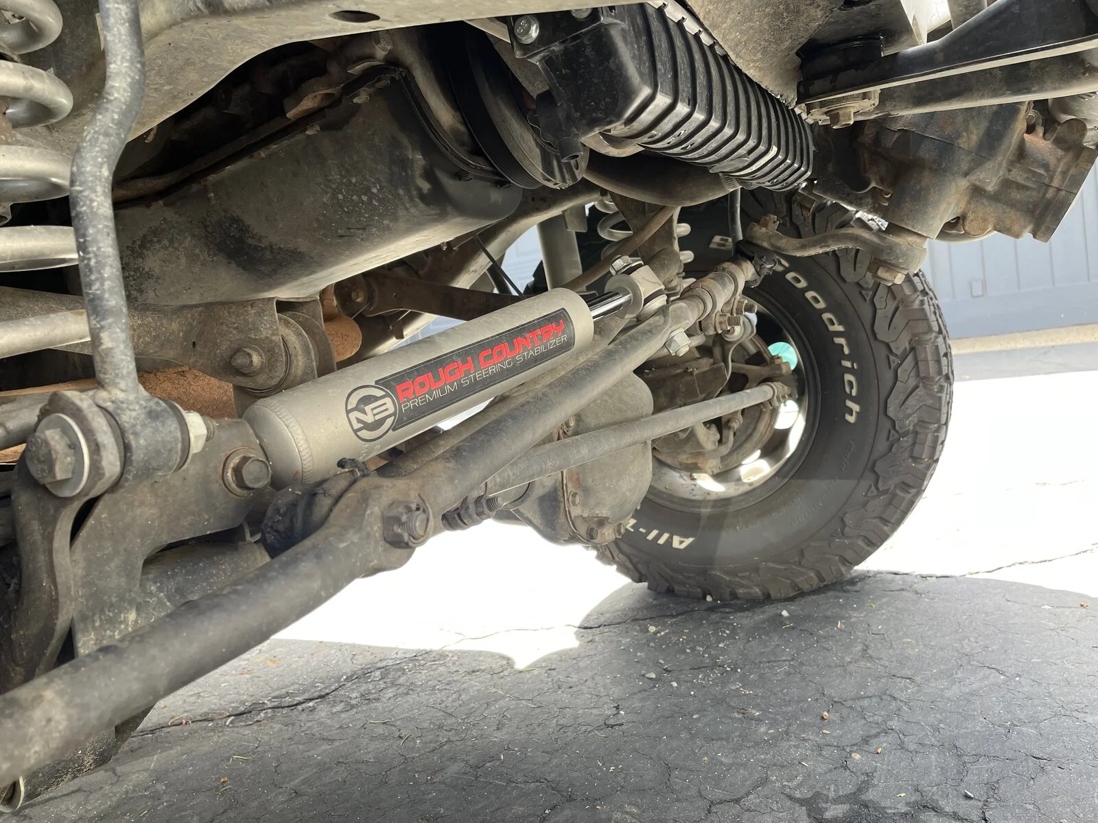

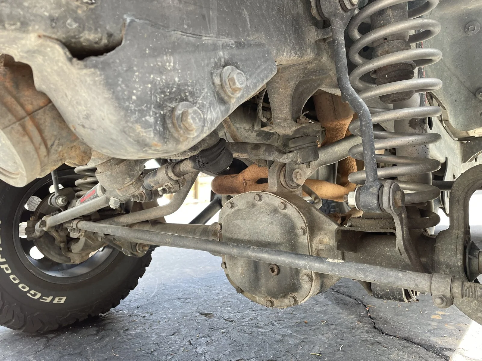

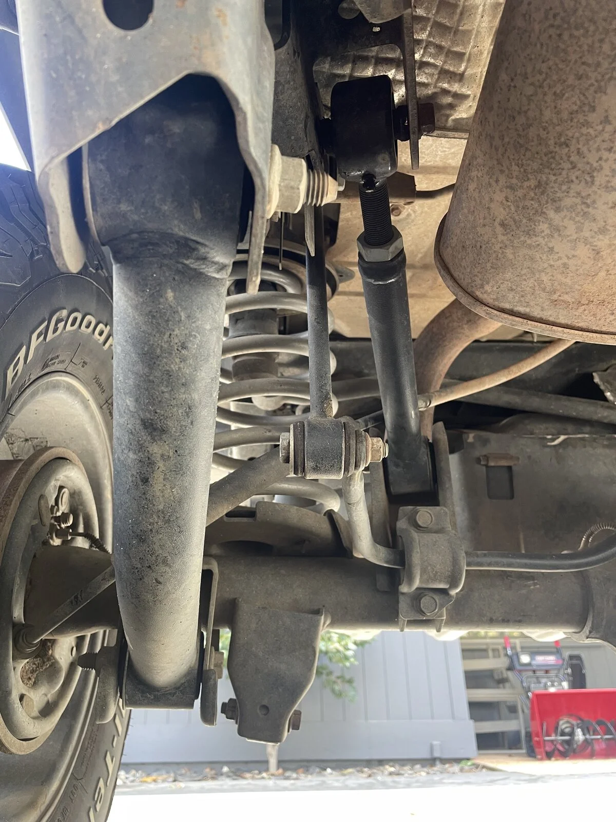

Get us a picture of the SYE and control arms.
And welcome from Bama!!!!
Here you go...front stock uppers with non adjustable lowers, rear adjustable uppers with none adjustable lowers. Not looking to keep any of it to be honest. The adjustable currie arms seem to be popular.

Measure your springs. 12 and 8" are stock. For 35s you want 4" suspension and 1 - 1-1/4" body lift. We need pics of the steering and track bar in front to help with the bumpsteer
It measures to a 4" lift, front is about 15.5" rear is 12." I took a look at that thread from 2016, curious if anyone on here has packaged something with a lower lift height since then. 5" + of lift and 35's is something id like top avoid if possible. Id like to go down to a 2 inch spring, I don't have a problem with losing the stock fenders or trimming some things.

Is the jeep scary offroad now? Is it driving odd onroad? If it has bad manners we can help. Looks like stock pitman arm and factory mounts for the trackbar.it won't have bumpsteer like that.
Proper toe setting and 6* of caster or more will tame the wander.so long as the shocks are good and the joints/steering/steering box are tight. It doesn't take long for rough country junk to wear out.
