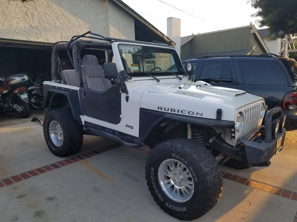

The TJ is a 2003 Rubicon that had a trashed rear diff and a front bent housing, so bent the axles were pulled. I rebuilt the rear with an ARB and replaced the front with another Rubicon Dana 44 then put 35s on it. Drove that for a while then went to Johnson Valley and while on Resolution I broke an axle (yes playing with the big boys). That was it, I decided to go all in. Made plans to convert to a TJ6 researched the heck out of everything I could find (including this forum) and went to work. 8 months later I was able to get back on the trails.

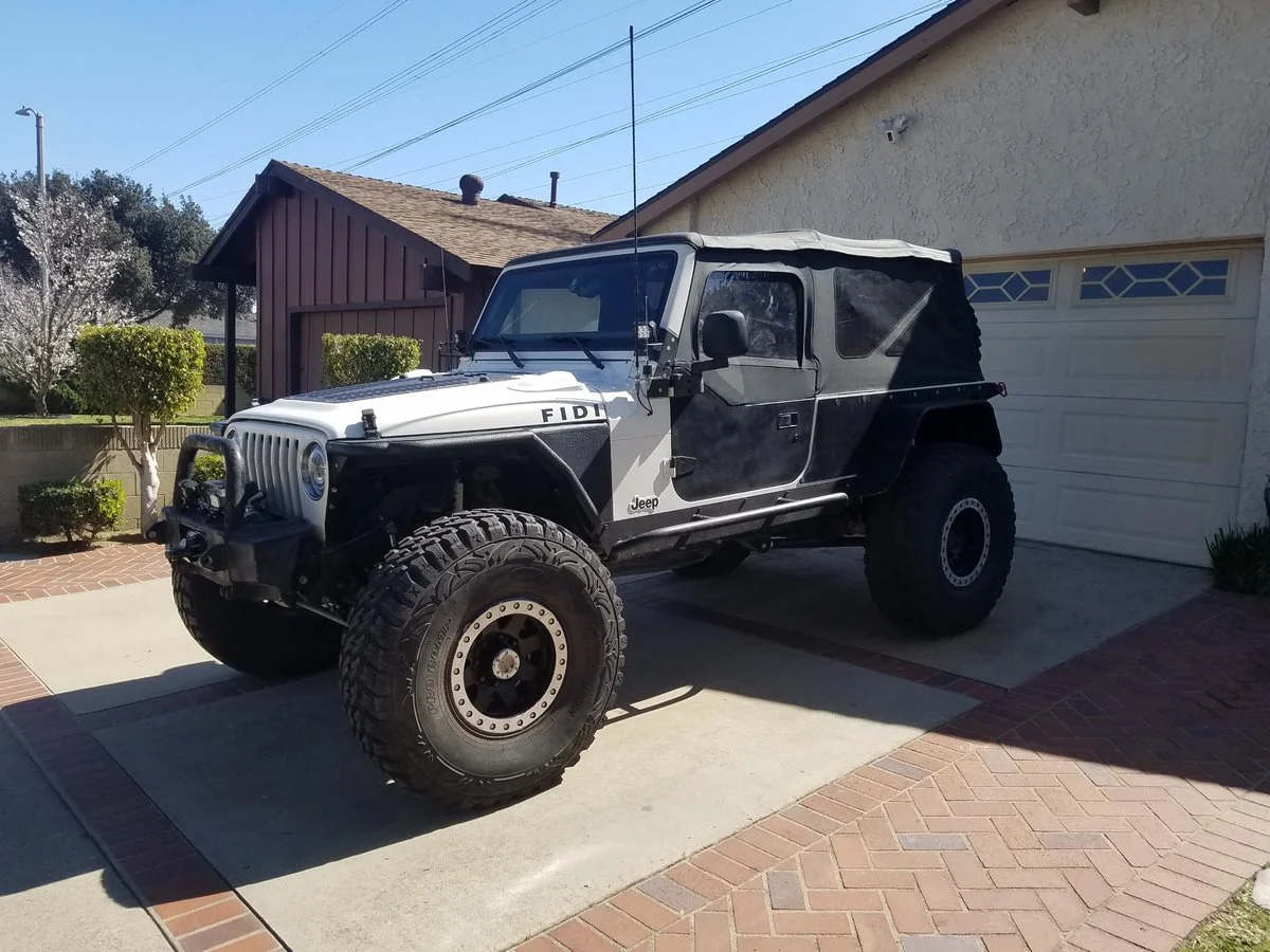

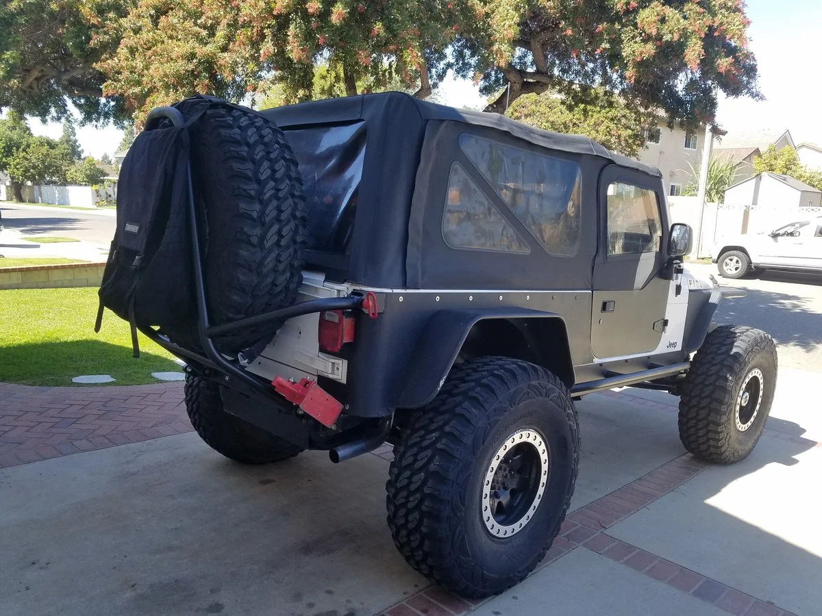

The reason for the TJ6 build was to put 40s on it and 40s on a TJ isn't the right wheelbase. I didn't want a stretched TJ since I would need to get a fuel cell and I wanted to keep the back seat and still have room to carrying my gear. I went with a shaved 14 bolt in the rear and a Dana 60 king pin in the front. I left them full width so now I have a very solid platform.
I can share a lot of details on what I did (am still doing). My solutions are probably quite different from someone else who would do this kind of build.

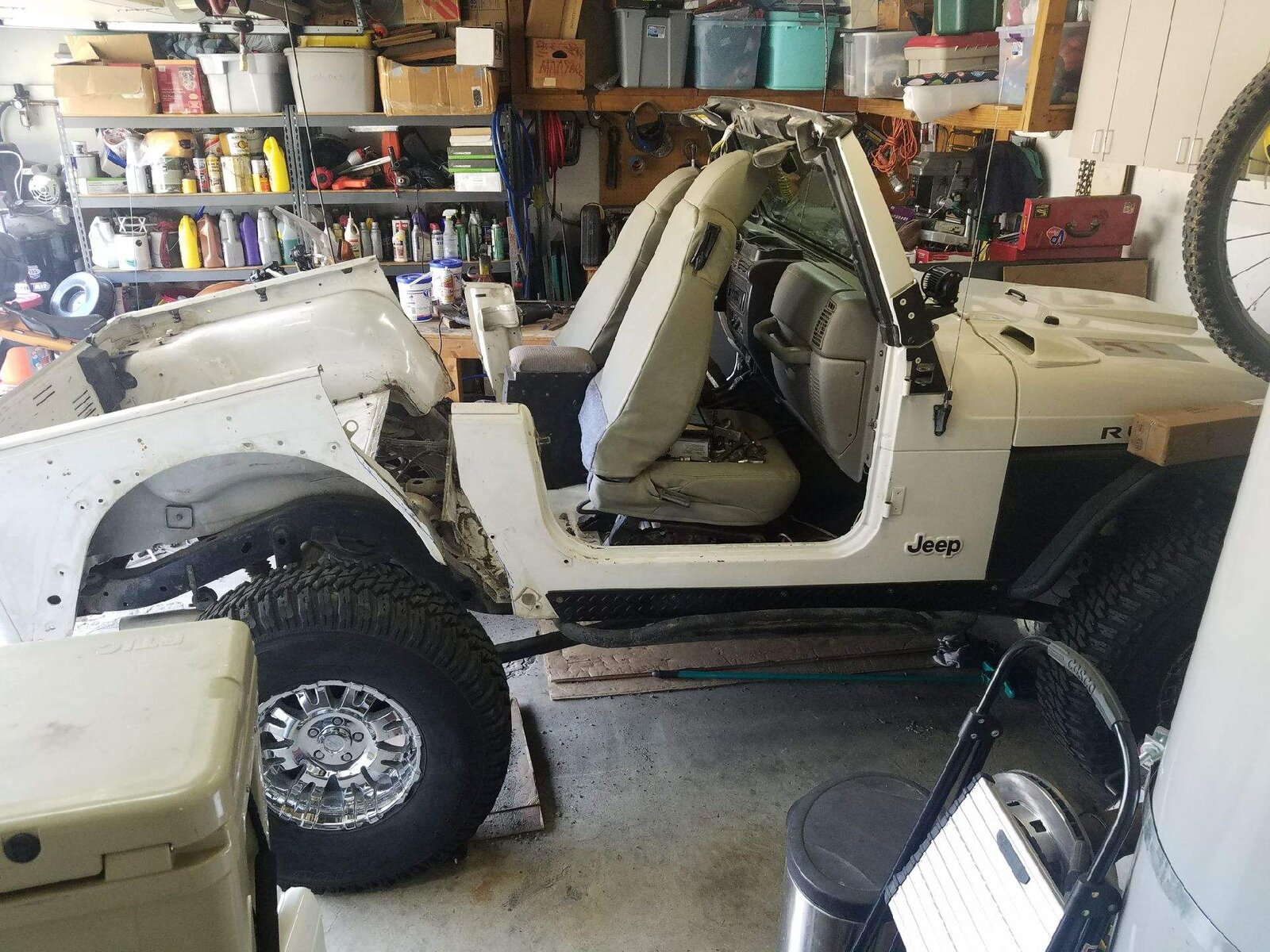

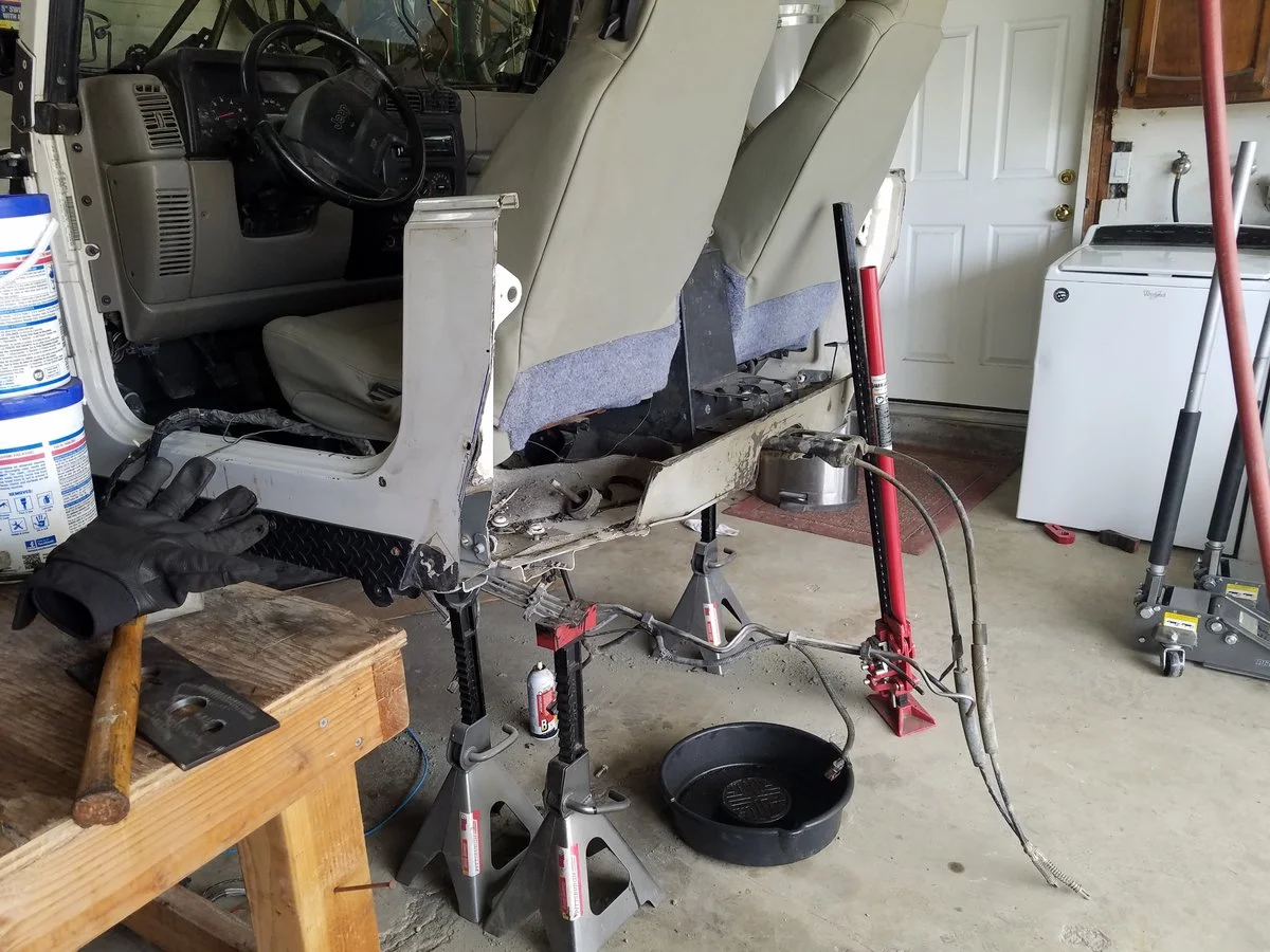

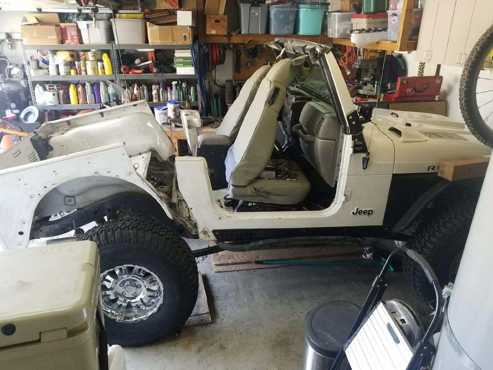

Here's a better pic of where I started

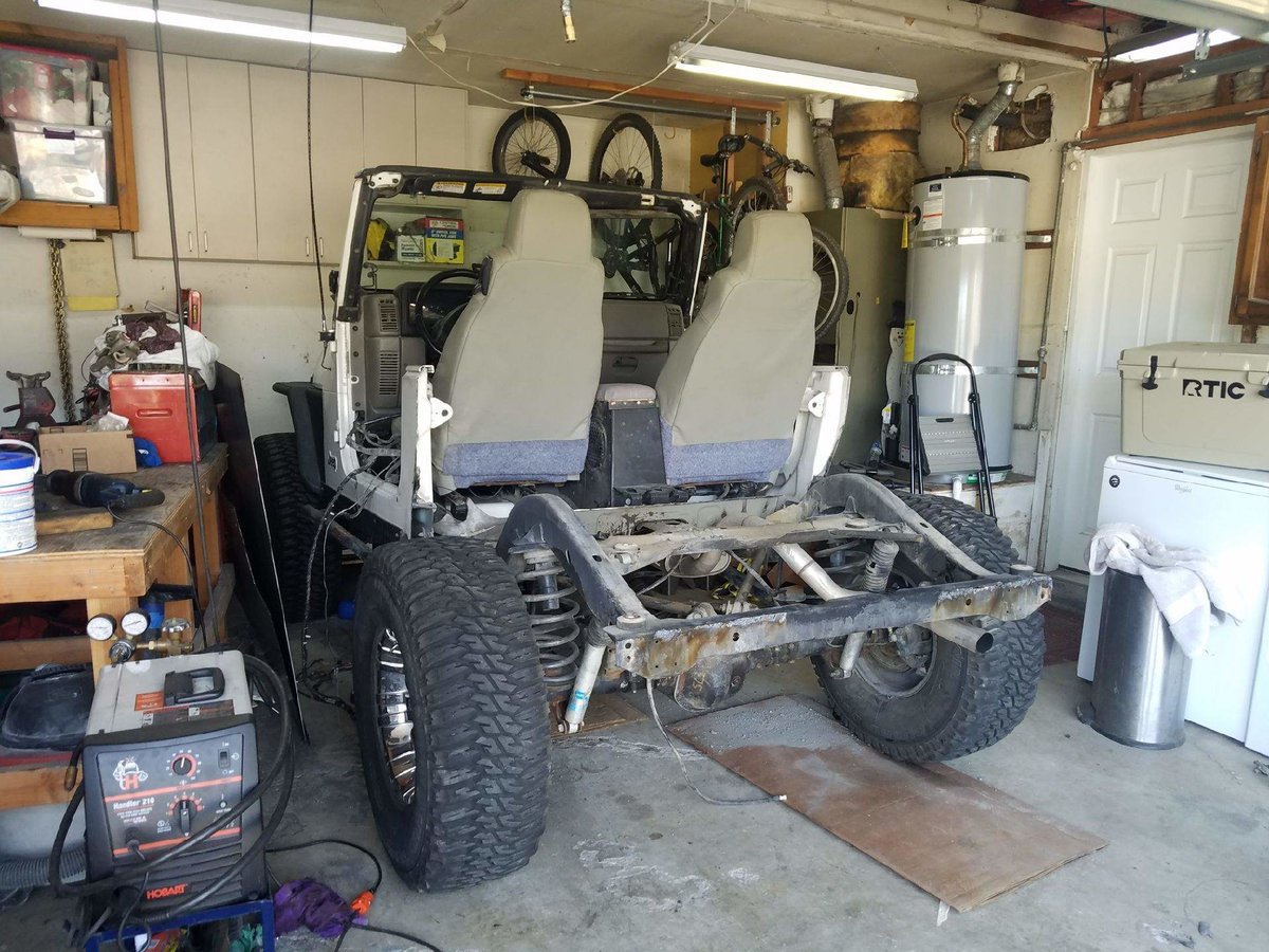

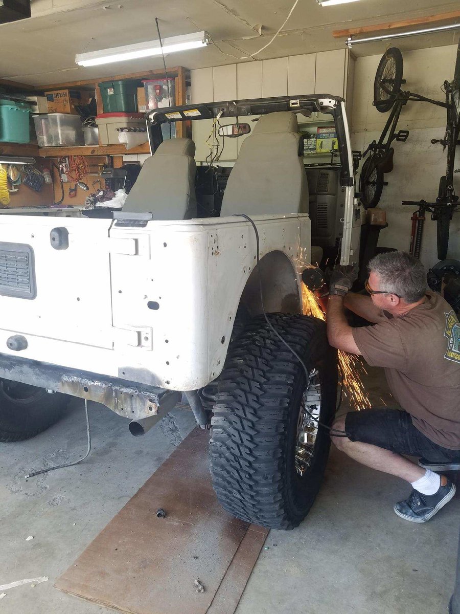

After making the "cut".

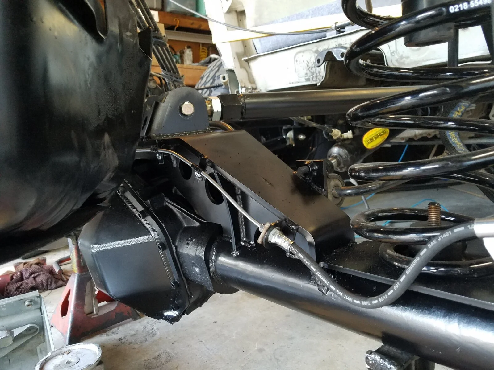

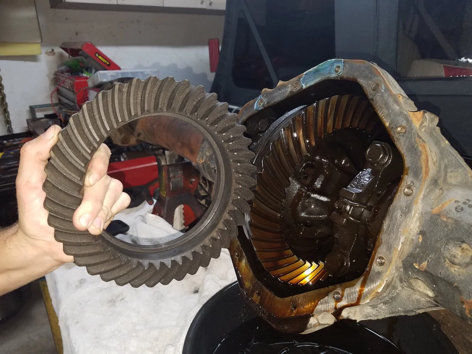

The the 14 bolt had already been worked on before this stage. You can see the difference between a Dana 44 and the 14 bolt ring gear.

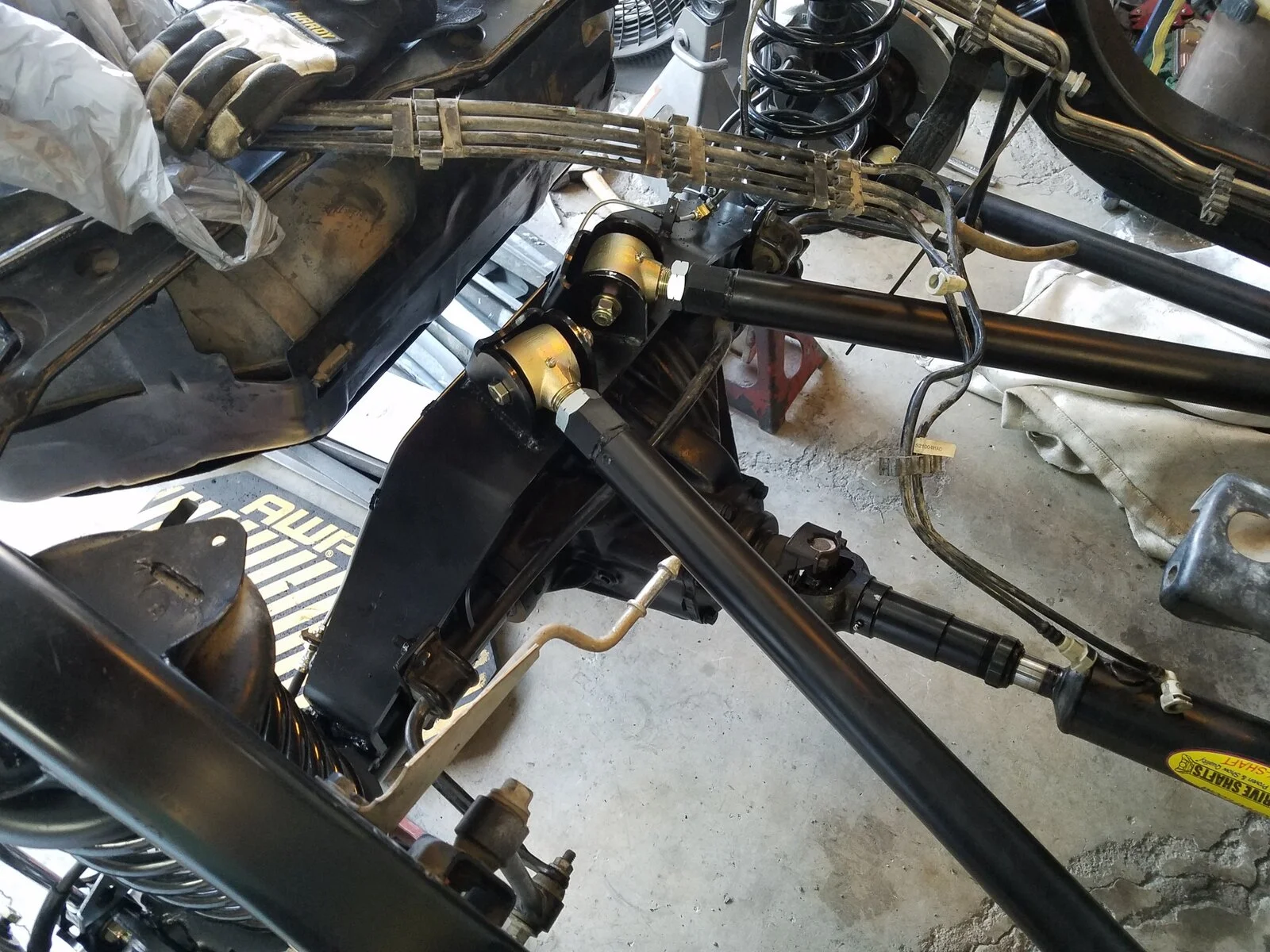

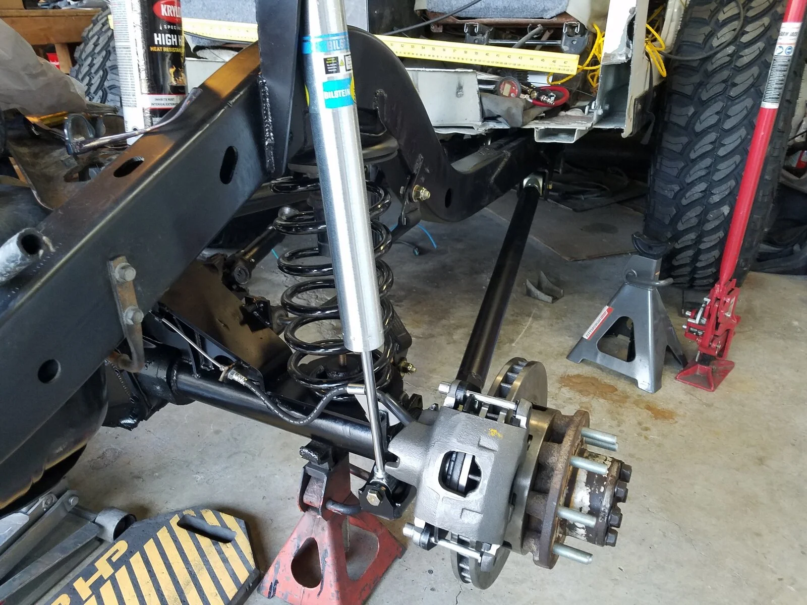

The shave kit was put in, gears set up, and discs brakes were added. There's an advantage having the tub out of the way to work on rear end including building arms, outboarding shock, and other various pieces.

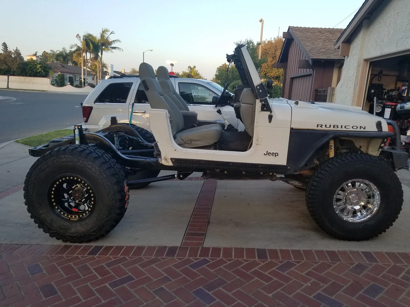

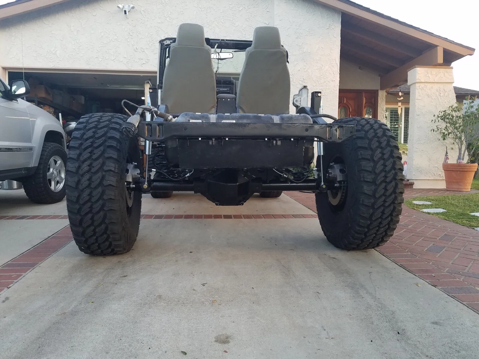

Once that's done you have a frankenstein. The 8 lug hubs requires a different wheel. You can see the difference between 35 in the front compared to the 40 in the rear.
Here's a pic from the rear showing the shave kit installed. You can see the difference from the early 14 bolt pic.
I was able to test drive it around the block to make sure everything went well. Next was putting the tub back on.

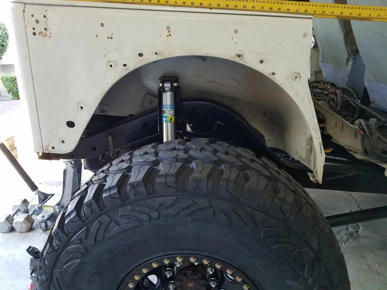

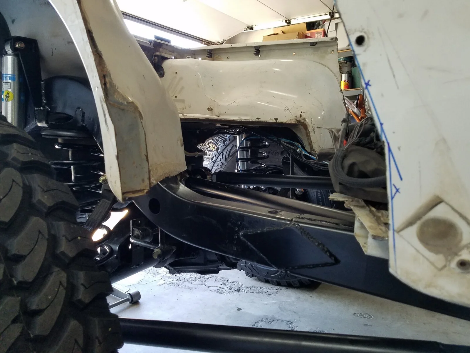

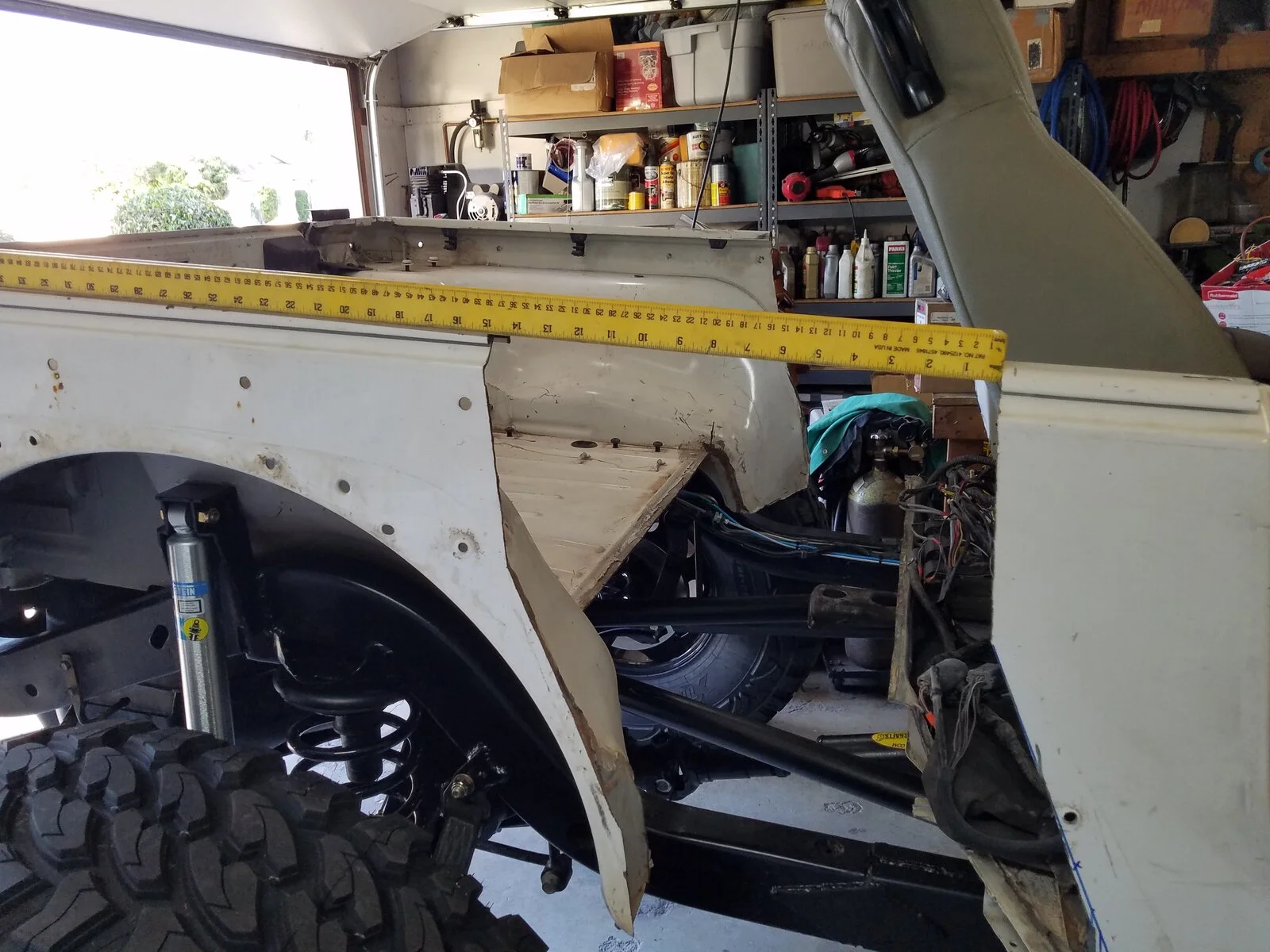

Right at 15" which will allow the LJ top to fit.

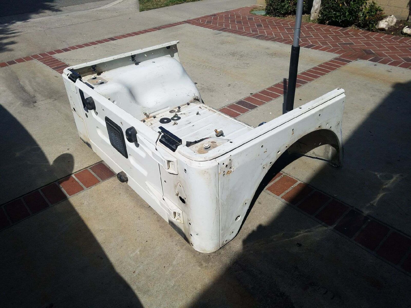

Had to cut the tub to fit the new 40s.
Unfortunately, I don't have pics of the body work that had to be done. Making the tub strong enough for sliders to attach to and support the weight was needed. Butt welds on sheet metal had to be done everywhere and it took me a little while to get it right. I also got sections of top rails cut from donor tubs so the LJ top would fit correctly. I also had to do a lot of spot welding. Automotive joint sealer did a great job as well. I'll get some pics of the finished product so you can see how the 15" gap was filled. I have a feeling no two TJ6's are the same when it comes to this area.
