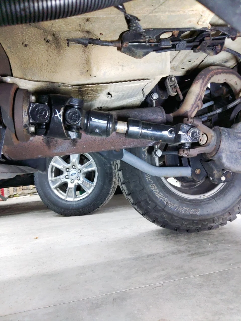

2. It has a 3 inch RC lift with new front and rear Adams driveshafts. It has 1 inch spacers on the skid plate, are they needed with the new CV shafts and should I adjust the rear axle to make the input yoke u-joint on the rear axle point towards the t case in a "nuetral" position?

Whether or not you need the skid plate spacers depends on the type of driveshafts the previous owner installed. Can you post a photo of both ends of your rear driveshaft so we can see its angles and type of front u-joint(s) the driveshaft has? Once we see that then we can determine if the spacers can be removed. Or at least look closely at the rear driveshaft. Its rear will have one u-joint, how many u-joints does its front have, 1 or 2 u-joints?

2 u-joints at the rear of the t case and 1 at the axle input yoke. I can get some pics shortly.

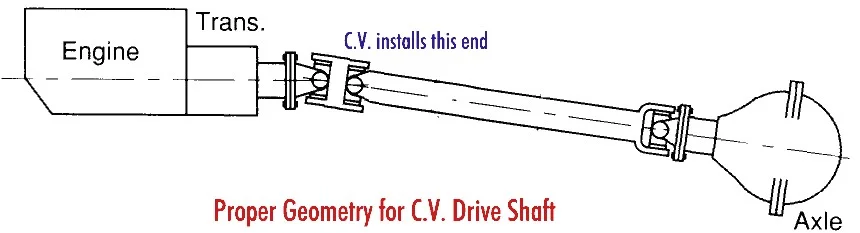

Ok that means it's a DC (double-cardan) also known as a CV (constant velocity) rear driveshaft which is good and means you can get rid of the spacers the transfer case skidplate is bolted to. If your rear axle is held in place with adjustable length control arms yes you just need to adjust them so the rear pinion angle points directly up the driveshaft and at the front DC joint. It's important the rear pinion angle not point any higher than the driveshaft's angle, it can be slightly below it like .5 or 1 degree. Like shown here...

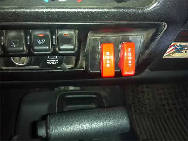

You're certain there's no Overdrive switch on the dash just above the shifter? It says O/D Off.

Now the question is can I put the OD off switch in and get it to work.

Maybe. Open up the center dash where the switches are and see if there is an unused plug that isn't locker or hardtop related. If so, then find an OD Off switch.
I recently replaced my nv3550 with a 42rle which is a very invasive swap just to make it work. Some 03-06 manual TJs will come from the factory with the dash harness wired for the OD switch. If not, then you get to find and change out the entire dash harness. Fortunately, mine was wired from the factory for the switch.

I took the center panel off, got the lower switch panel out and there was a plug not being used next to the locker switch. 4 wire flat plug that looks like it will be the OD off harness according to what I see on the back of the OD switches I see online. The block off plug for the other 3 plugs were never messed with judging by thye amount of dirt in all the little crannies.
Am I at least pretty close to assuming that is the OD harness?

If the Jeep has one locker switch, one rear wiper switch and one rear defrost switch and they are currently all plugged in, then you have the plug for the OD Off switch.
