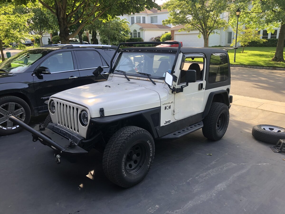

Hey everyone, so I bought a 2002 Wrangler X about a month ago. And let’s just say it’s already been a ride. *pun intended*. The previous owner(s) did a bunch of stuff to it to make it look “nice” (some things I liked most I didn’t) but neglected to really take care of it. So far I’ve had to get the rear U-Joints replaced, back driver frame welded, purchased a used exhaust that needs to go in, the list goes on. Basically I’ve been having a few problems that maybe someone can point me in the direction of peace and resolution to them. They are:
  • It has had a check engine light since I’ve bought the car with two codes reading P0442 & P0445, both EVAP leaks. Do you guys know what some of the solutions have been to fixing this issue? I know it can be a plethora of things, but I’m reaaaally hoping I don’t have to replace the fuel tank.
  • Theres some ticking noise that comes and goes it sounds like a high pitch tap as if you were bouncing a metal ball on a metal surface. It’s not a knock as the mechanic confirmed but we can’t figure out what it is. Any ideas?
  • Most of the time when I step on the brakes (which work well) there is a noise that is like a rattling and I can kind of feel it on the brake pedal when I step on it. It doesn’t feel like it’s a big deal it’s just a nuisance.
The Jeep is basically a “rig” and it runs like one. While I understand that it’s not going to be like a brand new car, more so than mods like tires and lifts, I like the idea of having a smooth, comfortable, safe, vehicle to drive everyday and then later on can come all the fun Jeep things I want to do.
As a new Jeep owner it’s exciting to be a part of this community and I hope it leads to lasting friendships!
Thanks for reading!
